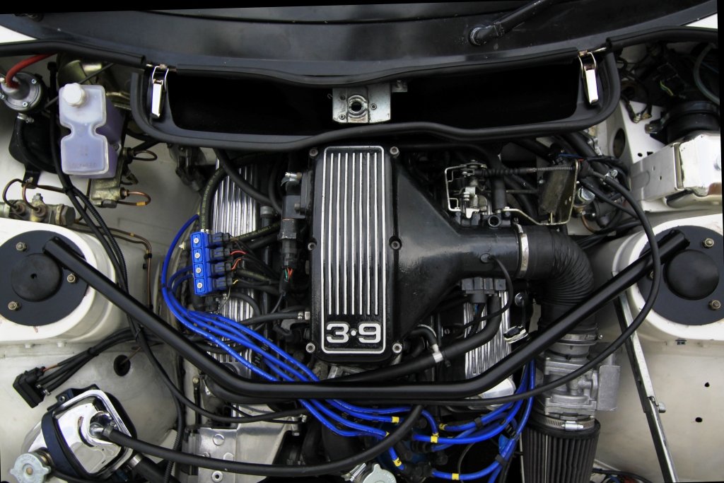

Overview of improvement: - Strut tower brace
Relative merits: - Reduced understeer
Observations: - There were two low cost upgrades that I researched that could reduce the understeer caused by flexing forward of the firewall. The first involved a strutbrace that fixed across the towers and then triangulated against the firewall but this system limits what type of fuel induction system you can run and also eliminates the possibility of using the fresh air plenum. The second less effective system is a brace that just connects the two strut towers, (this is the option I chose). I was really sceptical of this upgrade as it had ‘boy racer’ written all over it but the reduction in understeer and corresponding improvement in cornering was quite exceptional.
Summary: - Put away your prejudice and fit a brace
Summary scoring
Safety/security:                2
Reliability:                          N/A
Performance:                    3
Comfort/aesthetics:        N/A
Cost:                                    1
NOTE: Image shows the strut brace (photo taken after the LPG and EFI upgrades were complete)
Edited by BizMan
