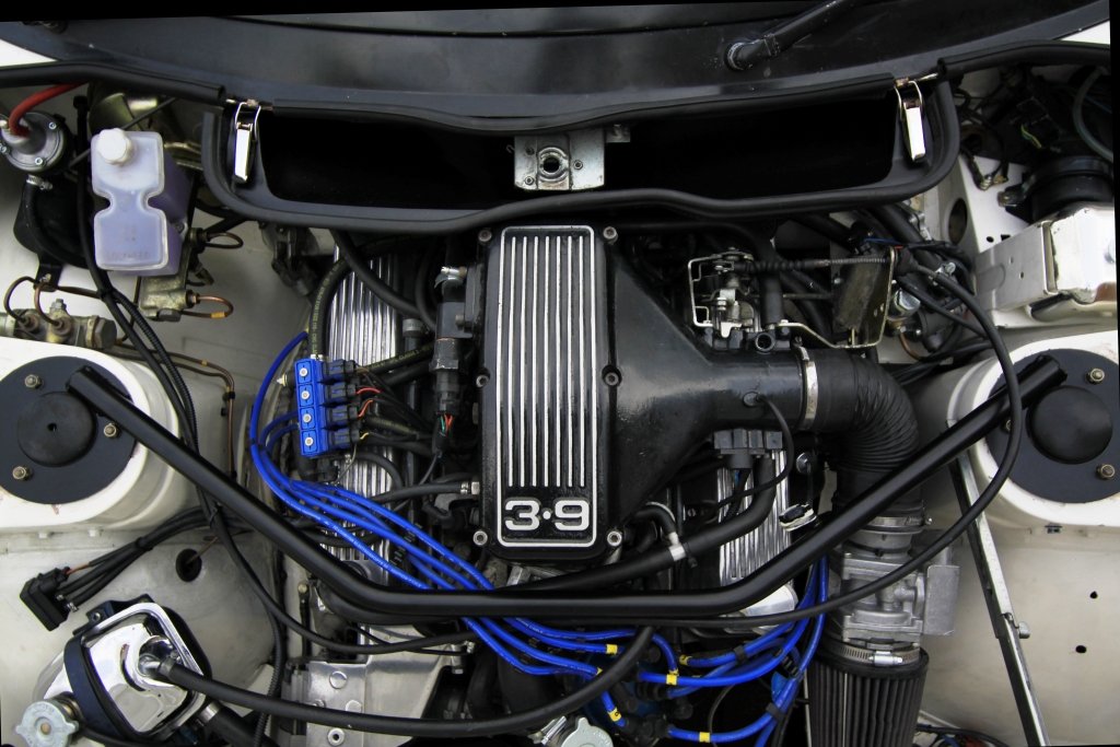

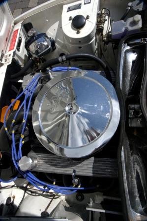

Overview of improvement: - 14CUX ‘hotwire’ fuel injection
Relative merits: - Increased power and fuel economy, improved cold start performance and reduced emissions
Observations: - A donor system from a 3.9 engine was transplanted over by a ‘specialist’ and to ensure clearance between the plenum and the bonnet, spacers were added between the subframe and the chassis. Finding a suitable location for the ECU took a little time and ultimately it ended up with the harness being threaded through the bulkhead and the ECU being mounted on the underside of the glove box.
However, bonnet clearance and ECU location were the least of my worries as it became apparent (too late for me) that bolting the bits on is one thing, being able to set it up and fettle it is another. The ‘specialist’ spent ages trying to optimise the system but try as they might, they could not just make the system run reliably. In the end I sought the services of JE Engineering in Coventry who had, as a Rover Group subcontractor, worked on the development of many of the Rover V8 engines and who had much of the original Rover test equipment in their workshop. Several further modifications to the EFI install were required to optimise the system (covered later).
Summary: - Once it was running correctly, the difference in performance, economy and general operation over the AFB was superb. However, this is not a 'plug and play' installation and if you are lacking a local 'expert' on the Hotwire system then I urge you to stay on a carburettor- yes you will be down on power and usability but your wallet will be heavier and your hair a little less grey.
WARNING: This is not an upgrade to be entrusted to anyone other than a company with a proven track record of installation/set up. Don’t just accept their own rhetoric, get some testimonials!

PS. Not only did the company that fitted this system fail to fit and fettle it properly, they were also very abusive when I complained. To pour oil on the fire, I discovered that, without my permission, they had taken the car on a 'photo shoot' to generate some publicity shots and furthermore, they are using these pictures on their website without my consent. I have requested that they remove theses shots as their association with my car suggests that I endorse their work which I do not. I would not recommend this company nor would I recommend that they go anywhere near your car.
NOTE: Images show a 'before' and 'after' view of the engine bay.

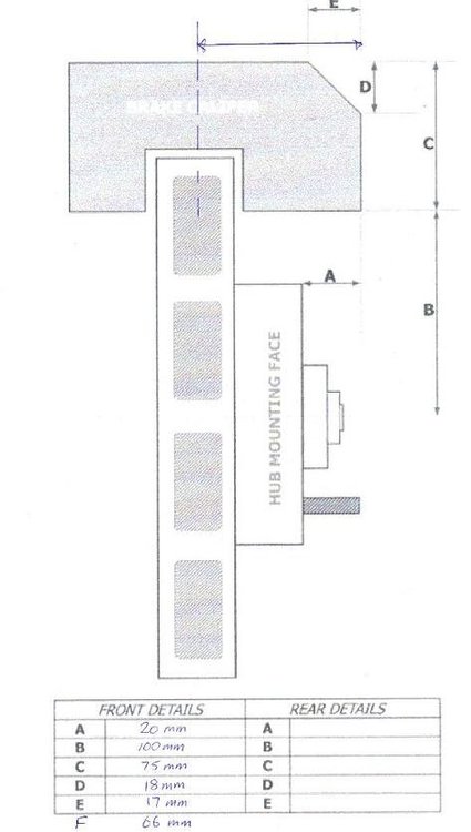

Overview of improvement: - 15 x 7 wheels running 205/50 tyres
Relative merits: - Enabled the fitment of larger front discs and calipers, increased tyre footprint on the road
Observations: - The front brakes, mediocre with a standard V8 car, were now way beyond their capabilities with the upgraded TR7. To fit bigger brakes required wheels with a larger ID to accommodate them and as I wanted to keep the car looking as period as possible, I decided against the MGF and other ‘off the shelf’ modern wheels that were available and had a set of replica Wolfrace type slot alloys made.
The inner lip of the rear arches were removed to allow unrestricted movement of the wider tyres.
Summary: - No noticeable improvement in either dry or fully wet conditions but as with the previous wheel/tyre upgrade, traction and road holding were improved slightly in damp conditions.
Over time, the bespoke wheels became the defining feature of the car and they are often commented upon. I am glad so many other folk like the modification.

NOTE: Hi-Spec specified that the Monster 4 300mm disc and caliper set that were to be fitted had to be under a 16 inch rim as a minimum due to the clearances required. I did not want to fit 16 inch wheels as I think they make the car look too modern. Hi-Spec provided me with a set of drawings that gave the dimensions of the brake components and from this I deduced that it should all fit under a set of 15 inch wheels (if the wheels were custom made to my specifications). I produced the rudimentary drawing as shown below and gave them to the wheel manufacturer who made the wheels against a non refundable order. I am no draughtsman nor engineer but I trusted my schoolboy maths, placed the order and held my breath. Thankfully, everything fitted and with enough clearance to enable efficient cooling too!

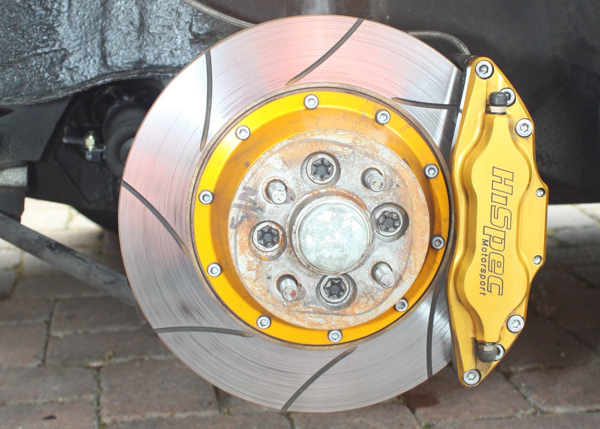

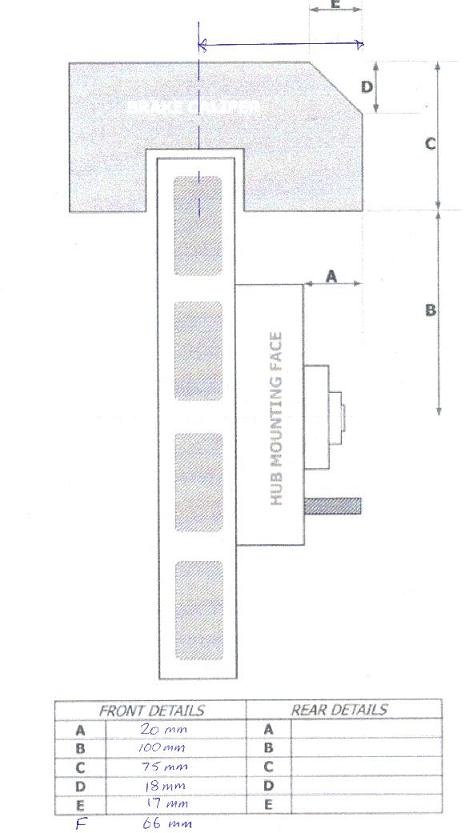

a
Overview of improvement: - Hi Spec performance brake conversion with red stuff pads
Relative merits: - Eliminate brake fade and increase braking capacity
Observations: - Bringing the car to a safe halt from motorway speeds and eliminating brake fade were critically important now that the car was not only more powerful but also more competent through the twisty stuff. I elected to fit a set of Hi Spec Monster 4 calipers and two piece 300mm discs as it increased the surface area of the pistons by 10%, doubled the pad surface area and considerably reduced front end unsprung weight.
Furthermore, this upgrade changed the brake balance to almost the ideal 69/31 front to rear and the brake torque was sufficient to not only stop the car within a safe distance but also relative to the modern cars we now share the roads with! (see post #82 for the maths).
One really annoying problem with the discs however was that there was quite a bit of run out which manifested itself as a vibration through the steering under braking. I found a local company that used the Pro Cut computerised disc skimming system and I had them skim both discs and the difference is astounding! No matter what speed I brake from the steering wheel stays as steady as a rock; no wobbles, no shakes and zero vibration.
To get an idea of how the process works then you can see it happening to my car in the you tube video (you can clearly see the high and low points on the disc as it rotates. The operator ran a further two passes to take out the imperfections). The other link takes you to the companies website which also has some useful information too.
http://youtu.be/8_IazzhN8Ow
https://brakelathe.co.uk/why-skim-discs/drivers/
Summary: - Once the disc run out was fixed, these brakes delivered just what I wanted, fantastic stopping power and zero brake fade. However, the brake peddle remained long on the first depression and despite further bleeding and a change of the seals in the master cylinder, the problem remained. Before I rushed out and purchased an upgraded master cylinder I spoke with the owner of a track car that used Hi Spec Monster 4 brakes and he gave me a hint which fixed the problem.
The Monster 4 calipers have two bleed nipples (top and bottom) that are there for no other reason than to reduce manufacturing costs for Hi Spec (it saves them having to produce a left and right hand caliper). First of all bleed the front n/s brake via the top nipple and then remove the caliper, invert it and clamp the caliper back onto the disc and re-bleed via the 'new' top nipple (it previously was the bottom one before you inverted the caliper). Then refit the caliper the right way up and bleed again via the top nipple. Repeat this process for the offside front.
I found that although it made for a slightly tedious process, the outcome was just what I wanted, a rock solid brake peddle!

Overview of improvement: - Enlarged EFI plenum and air intake trumpets
Relative merits: - Increased torque and BHP
Observations: - To adequately feed the big valve heads with enough air and in readiness for the short motor upgrade, the standard Hotwire throttle body/plenum was bored out to a diameter of 70mm (standard is 65mm) , 45mm bore inlet trumpets were fitted (38mm standard) and the inlet manifold and heads were matched and ported. I also took this opportunity to have the Idle Air Control Valve (or stepper motor) relocated from the bulkhead side of the plenum to a new mounting position on the offside face of the plenum thus allowing the fitment of the fresh air scoop back onto the car.
Summary: - The extra volume of air gave an improvement in performance at the bottom end of the rev range but the real difference was at the top- it never runs out of breath! However, after a while I became aware of misfires when under load at high revs and after seeking advice, I changed the spark plugs to a set that would work under higher compression and with higher octane fuel (LPG is 110 versus Shell V-Power at 99). The V8 now runs B7ECS plugs from NGK which is a 'cooler' plug and this has cured the problem.
Summary scoring
Safety/security:                N/A
Reliability:                          N/A
Performance:                    4
Comfort/aesthetics:        2
Cost:                                    4
Edited by BizMan
... I also took this opportunity to have the Idle Air Control Valve (or stepper motor) relocated
It would be nice to see a picture of your stepper motor move, just to compare it with how I fitted mine back in 2007...:
