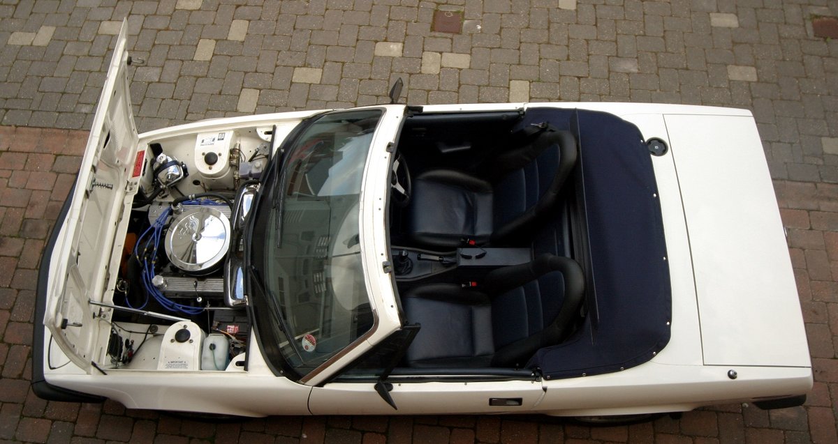

BizMan Posted May 12, 2011 Author Report Posted May 12, 2011 (edited) a Overview of improvement: - Fitment of modern seats Relative merits: - Lumbar and lateral support Observations: - When I first purchased the car I had every intention of keeping the original seats and I even had them and the door cards re-trimmed in leather. However, after my first 10,000 miles I had developed a very painful lower back so I decided to capitulate and fit modern seats. My wife owns a 2001 model Toyota MR2 roadster which I knew to have great seats so after careful measurement I decided to buy and re-trim a set. The height of the base cushion from the floor is exactly the same height to floor measurement as the 7, the overall width of the seat is comparable and the top of the seat back has plenty of clearance between it and the roof. The only modification required was the base frame needed modifying to fit to the TR7 mounting points. Summary: - These seats give great lateral/ lumbar support so miles pass by in comfort. The driver’s seat also has height adjustment which helps to accommodate my six foot three frame. Summary scoring Safety/security: N/A Reliability: N/A Performance: N/A Comfort/aesthetics: 4 Cost: 2 Edited June 13, 2019 by BizMan Quote
Simon Oliver Posted May 12, 2011 Report Posted May 12, 2011 Summary:[/u] - These seats give great lateral/ lumbar support so miles pass by in comfort. The driver’s seat also has height adjustment which helps to accommodate my six foot three frame. It'd be great to see what these seats look like in the car. was it a lot of modification??? Quote
BizMan Posted May 12, 2011 Author Report Posted May 12, 2011 (edited) a Update as requested on the modified seats The only picture I have that shows the seats installed in the car is not a great picture but I am sure you get the general idea. Regarding modifications for fitment, as with many of the upgrades involving a degree of engineering, S&S undertook the fabrication so perhaps it is better for S&S to comment in detail. In simple terms, the original MR2 mounting points were removed and original TR7 mounting points were welded onto the frame in a position that corresponded with the mounting points on the chassis. All in all it was a mornings work. Edited June 13, 2019 by BizMan Quote

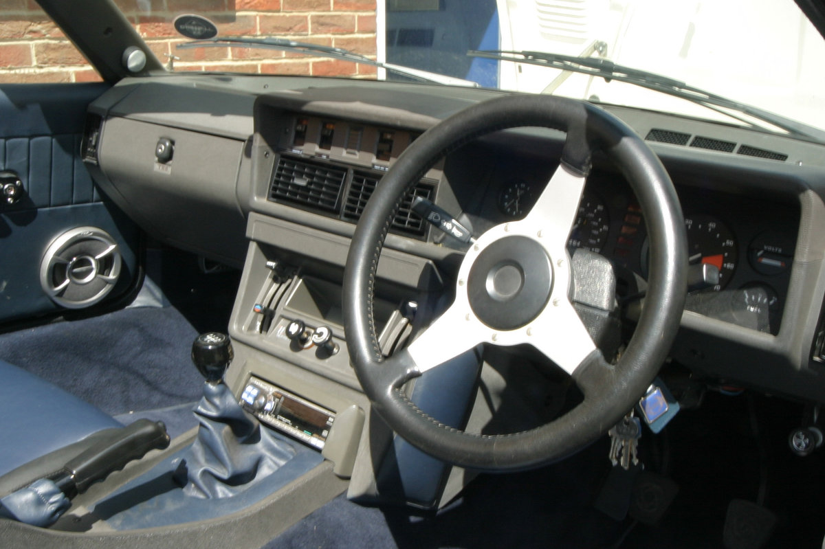

BizMan Posted May 20, 2011 Author Report Posted May 20, 2011 (edited) a Overview of improvement: - Modern stereo header unit Relative merits: - FM, CD and MP3 playback Observations: - With respect to in car entertainment, the 7 was developed in one era and sold on the cusp of another. Trying to retrofit the more modern technology that incorporates CD/iPod formats into a car that was designed to mount a cassette playback unit is a problem as modern units are deeper than the radio aperture which results in the unit sitting proud of the console. This not only looks a little awkward but it is also exposes the unit as easy pickings for any opportunistic thief. Eager to have modern in car entertainment that was accessible whilst driving, aesthetically pleasing and was thief resistant I purchased an Alpine header unit that not only supported multiple formats (FM, CD, MP3 and iPod) but also had a ‘tilt’ function on the removable display screen. This system was mounted on a foam pad that sat atop the transmission tunnel and extended out of the base of the centre console and wired in to a pair of 6 inch Infinity Kappa speakers mounted in the doors. I fabricated a surround that encapsulated the header unit which was flush whilst the screen was fitted and in the maximum tilt position but that also hid the header unit once the display screen was detached. Summary: - The system worked really well, developed great sound and looked good in the car. I removed it several months ago and replaced it with a period unit that had been adapted to playback music from my iPhone- a retrograde step in sound quality but a step forward in period aesthetics. Summary scoring Safety/security: N/A Reliability: N/A Performance: N/A Comfort/aesthetics: 2 Cost: 2 Edited June 13, 2019 by BizMan Quote
Odd Posted May 21, 2011 Report Posted May 21, 2011 Nice'n compact looking solution there, mate. Another alternative is to MAKE a modern unit fit... Quote

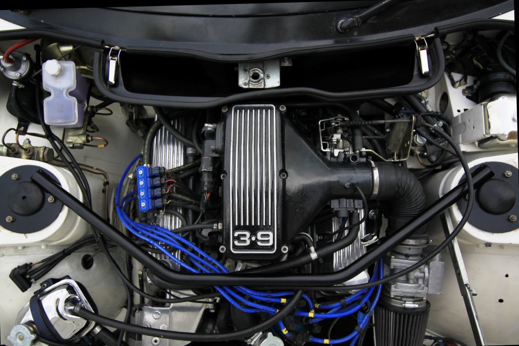

BizMan Posted September 17, 2011 Author Report Posted September 17, 2011 (edited) I have been asked where I got the strut brace from that I describe in post #16 and the answer is that I had it made using one I had purchased previously as a template. I originally purchased a brace from eBay that was fabricated for a V8 running a Holley AFB carburettor. However, when I fitted the 14CUX ‘hotwire’ injection, the brace fouled the plenum. I therefore mocked up an alternative and then took the original brace and the mock up to a local company who fabricated the unit you see fitted to the car. This rather amateur (but practical) method of product design means I don’t have a drawing to share with you but if there is a calling for it, I can make one. When I was researching the brace, I found a number of alternatives which suit different variants of the ‘7 so I include these links for you to make your own choice. http://www.thewedgeshopstore.com/strut-tower-brace-tr8/ http://vitessesteve.blogspot.co.uk/2013/11/tr7-strut-braces.html http://www.tsimportedautomotive.com/struttower.html Edited June 13, 2019 by BizMan Quote
