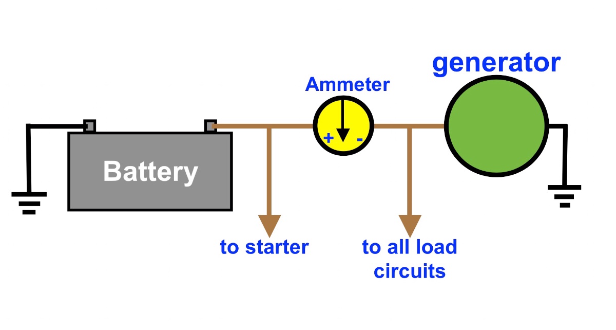

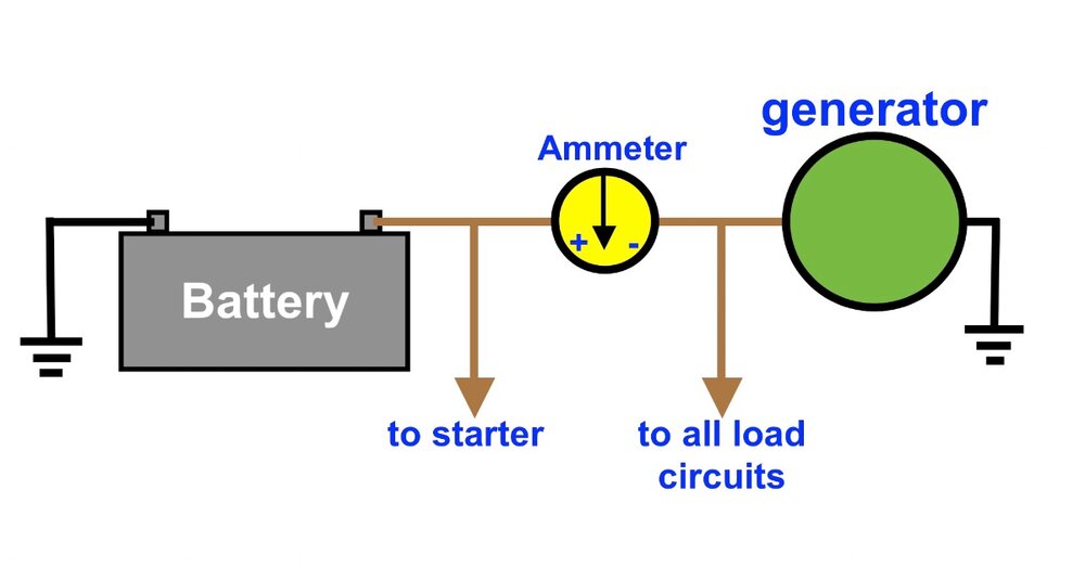

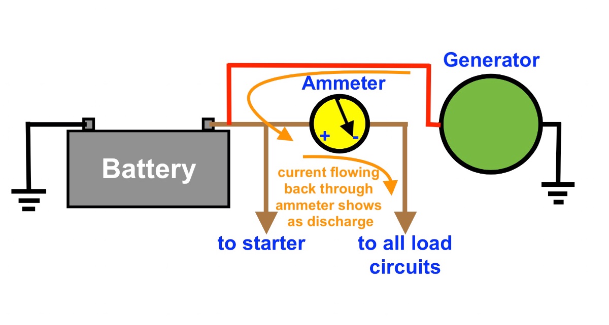

RobH Posted October 15, 2023 Report Posted October 15, 2023 (edited) 10 hours ago, rwillfly said: my tr3A ammeter shows +20 with ignition switch on, lights on and engine not running. While driving, lights on, the ammeter shows the same +20. That isn't right. Firstly the ammeter sounds to be wired the wrong way round. With the engine off, any current drain should show as a discharge. It sounds like the ammeter wiring is totally wrong. I think it may be like this ( with the addition of the ammeter being wired backwards so it shows charge ): when it should be like this. The cure should be as simple as just re-arranging the connctions at the rear of the ammeter. : (Note. There are simple sketches to show what is happening - they are not circuit diagrams for any particular car. The dynamo connection here is shown direct for clarity, rather than via the control box as it actually is. Full screed here: https://www.tr-register.co.uk/forums/index.php?/topic/84514-ammeter-wiring-and-operation/) Edited October 16, 2023 by RobH Quote
