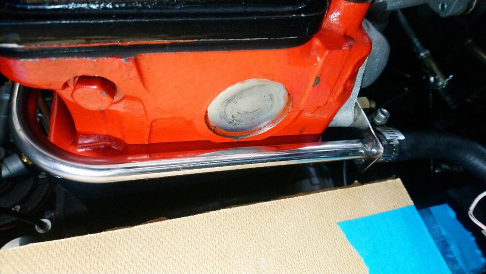

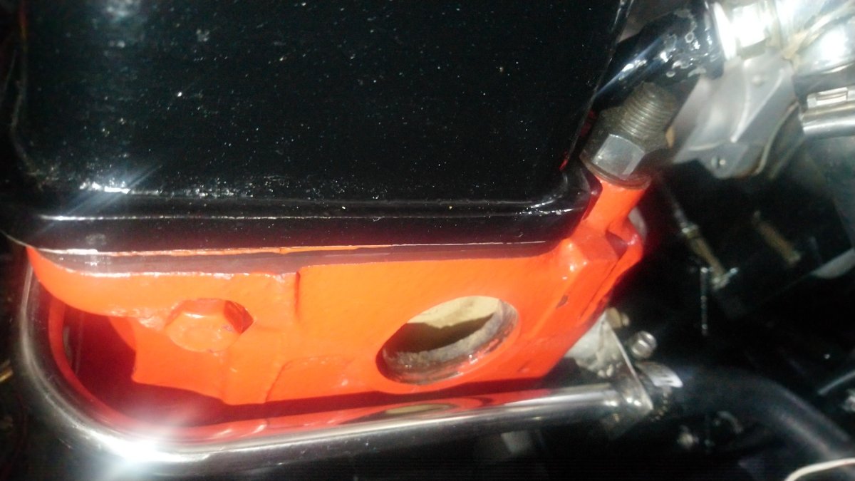

qkingston Posted June 26, 2023 Report Posted June 26, 2023 On the drive down to the Moffat Show yesterday I was suddenly enveloped in white steam from the engine bay; pulled over and popped the bonnet; after a little searching water could be seen running out of the rear cylinder head core plug. Having called out the RAC and returned home, I found that the (almost new) core plug was now actually missing!! (still, solves the removal issue). I can only assume that the disc hadn't been properly peened/flattened during the restoration, nor had it been sealed (my bad). So now I will attempt to fit a replacement plug in situ. Any other further advice/experience to that above gratefully received Many thanks David Quote

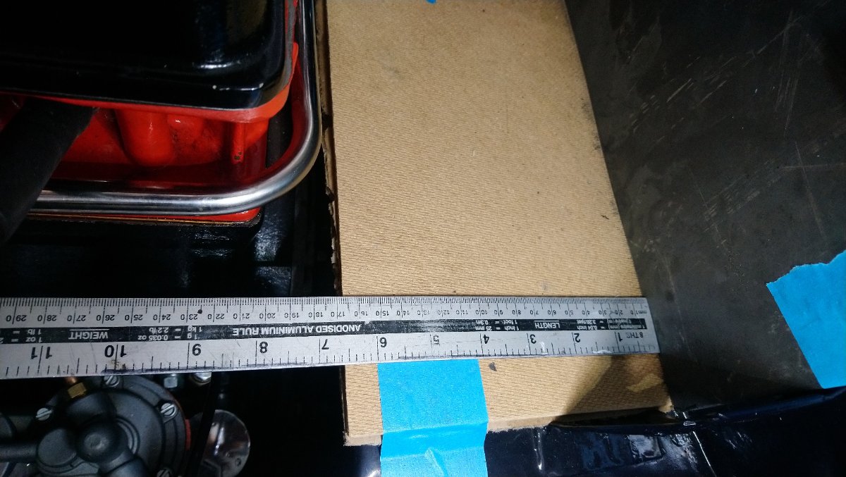

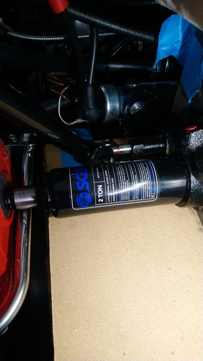

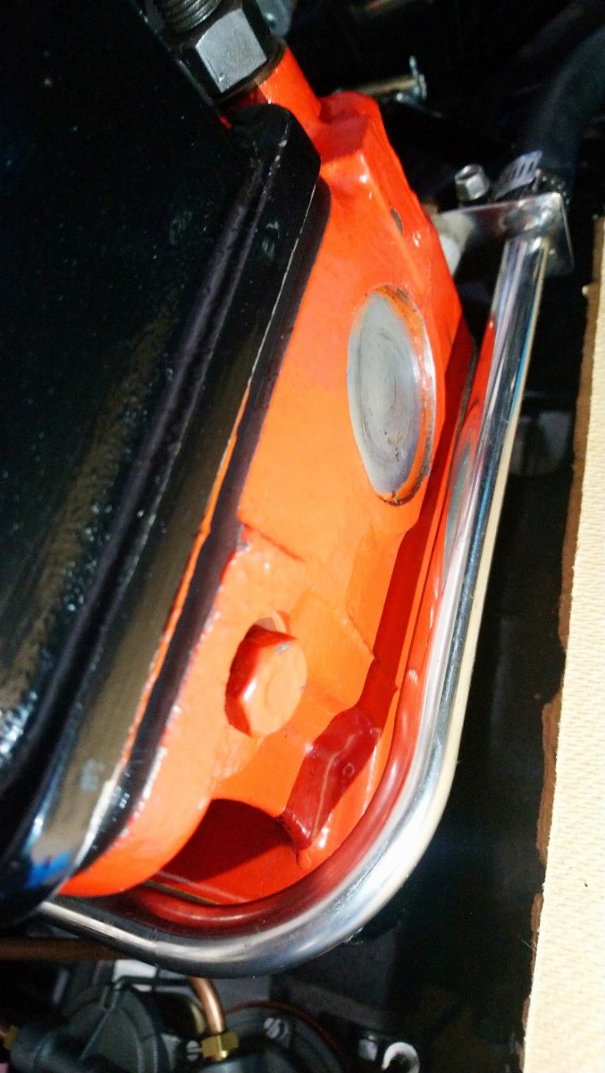

qkingston Posted June 28, 2023 Report Posted June 28, 2023 (edited) New core plug fitted. For info, there is sufficient space with the battery removed to swing a lump hammer and suitable short drift to flatten the disc; I also tried a small bottle jack with a 5mm steel plate across the rear bulkhead to spread the loading, that would have worked too. Red Hylomar to seal PS I also now carry a spare Rgds David Edited June 28, 2023 by qkingston Quote
