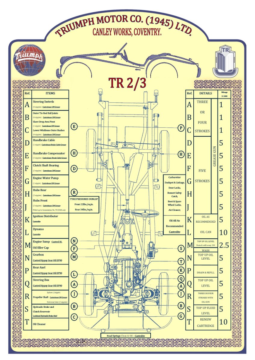

Rocketman Posted May 20, 2024 Report Posted May 20, 2024 (edited) My latest Edited May 24, 2024 by Rocketman Quote

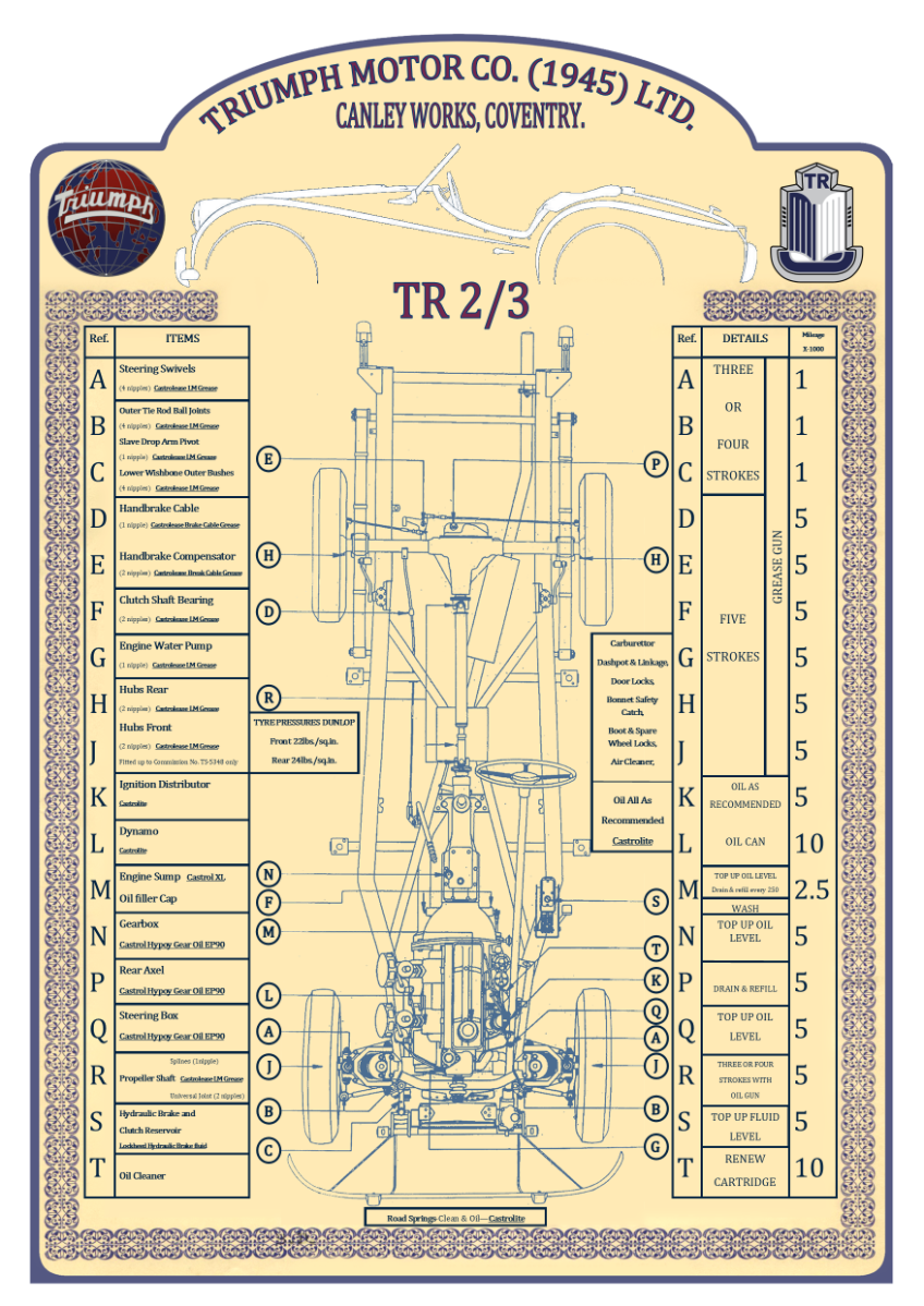

Rocketman Posted May 23, 2024 Report Posted May 23, 2024 (edited) I just Edited May 23, 2024 by Rocketman Quote
Rocketman Posted May 23, 2024 Report Posted May 23, 2024 (edited) Another Edited May 23, 2024 by Rocketman Quote

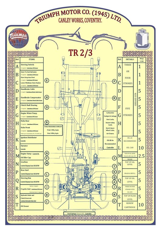

Hamish Posted May 23, 2024 Report Posted May 23, 2024 (edited) I’d go with the lighter “cream?” one with the black text. last one is too dark and not a fan of blue on blue but they are very smart. Edited May 23, 2024 by Hamish Quote
Rocketman Posted May 23, 2024 Report Posted May 23, 2024 (edited) last Edited May 23, 2024 by Rocketman Quote
Hamish Posted May 23, 2024 Report Posted May 23, 2024 2 hours ago, Rocketman said: last version, digitally repaired and colour corrected to the best of my ability. A very close colour match to the original. That’s the one. Quote

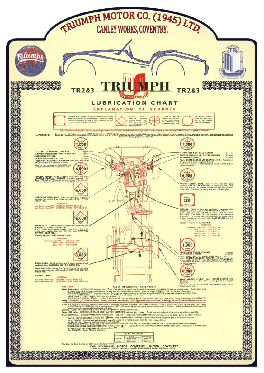

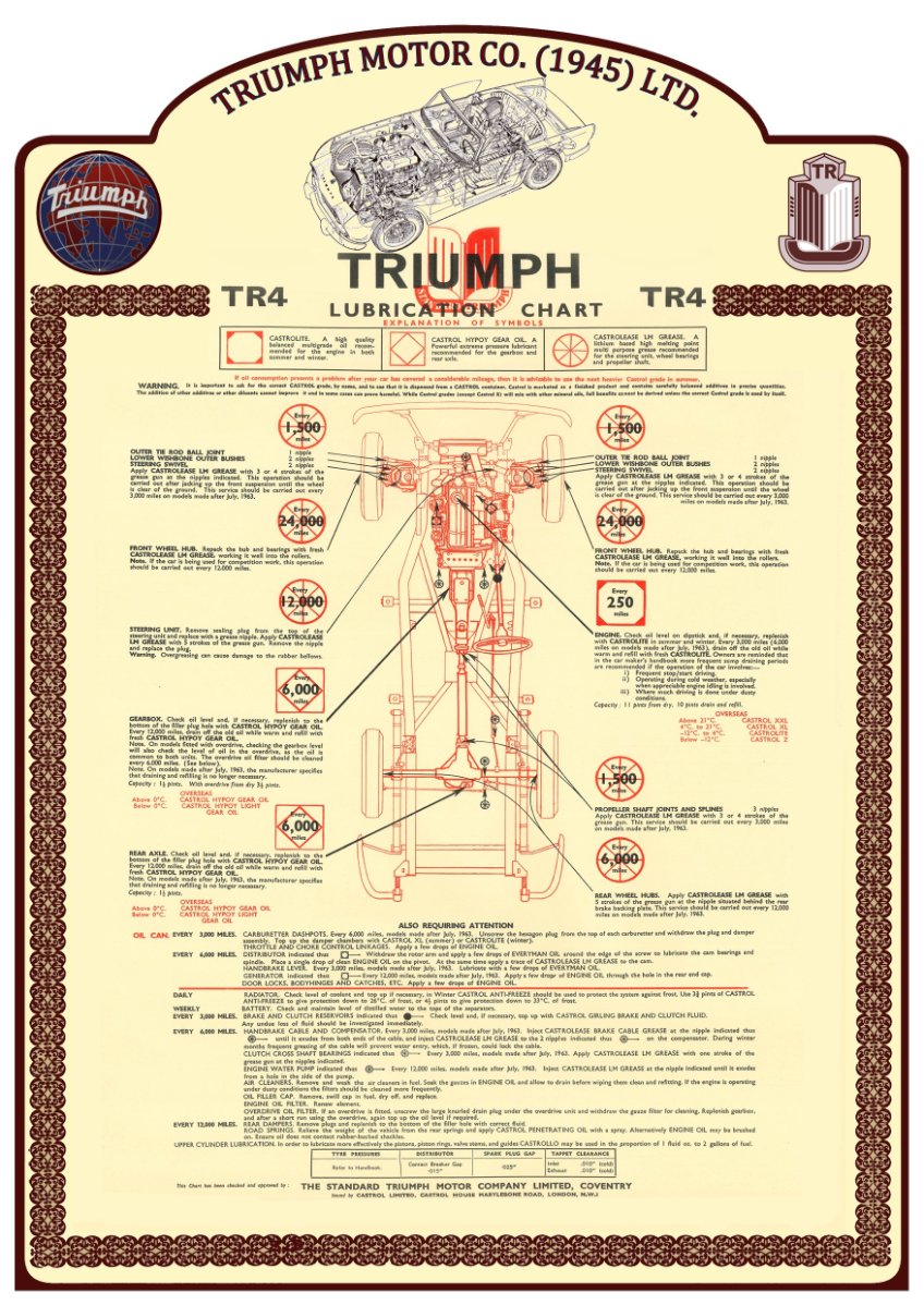

Rocketman Posted July 16, 2024 Report Posted July 16, 2024 (edited) my version of the tr4 lubrication chart Edited July 16, 2024 by Rocketman update Quote
Rocketman Posted August 8, 2024 Report Posted August 8, 2024 Just an update on the lubrication charts I have been working on. These are available as mentioned in the latest edition or the TR Register magazine. Each is available as a PDF print ready version on request from the TR Register Quote
