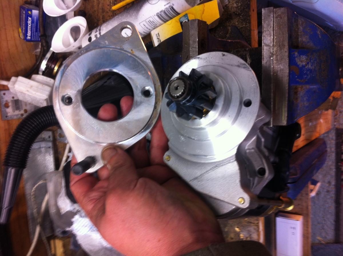

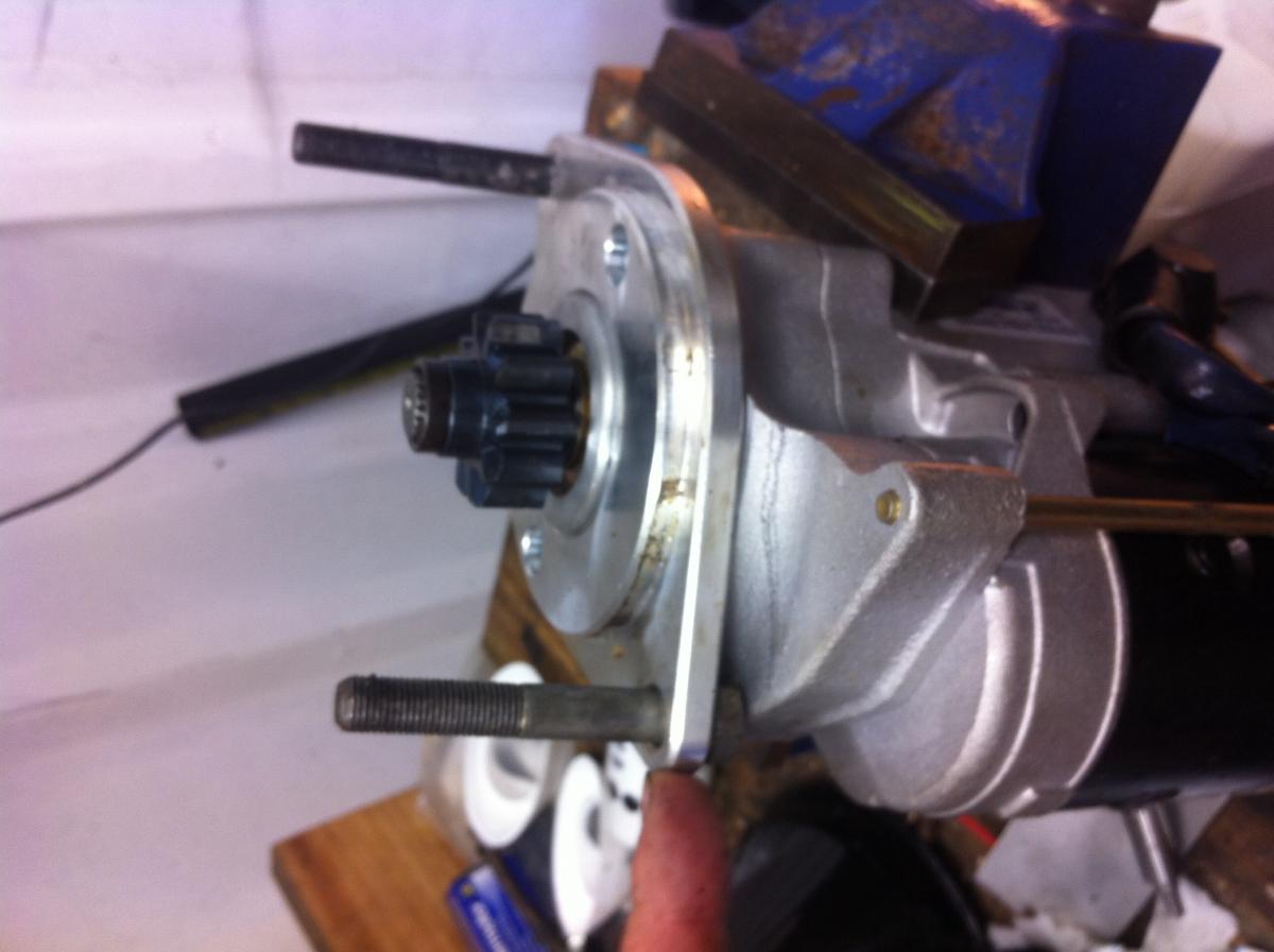

Hamish Posted January 28, 2017 Report Posted January 28, 2017 Hi Tony I struggled to fit mine in situ with 4 branch manifold etc. Thus I turned the plate 180 degrees and the bolt cleared the starter body and slotted home easier. It's recommended on here to loctite the plate to starter fixing bolts in case they work loose. These pics may help. H Quote

RogerH Posted January 29, 2017 Report Posted January 29, 2017 Hi Tony, I can understand not wanting to cut holes here and there. The fixed bolt in the Hi-torque SM can be removed. If you look at Hamish's pics - the end plate can be removed and the bolt knocked out. Just make sure that you get the correct SM for your flywheel. Roger Quote
