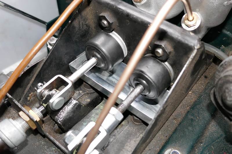

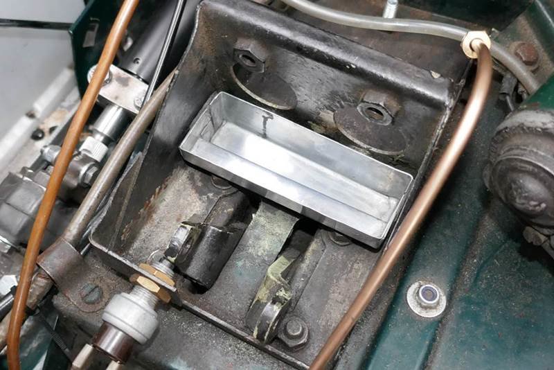

To see how long the old seals works I made a brake fluid leak container to set under both master cylinders.
Checked last week everythink was dry,
checked today I realised flies like brake fluid - and I'm so sorry for that - die from brake fluid.
If wanted: I have 2 more containers in my workshop, would like to have 10 GBP + 5 GBP for shipping.
To fit you have to unfasten both master cylinders, the container sticks in between the bracket.
If any interest please send me a PM.

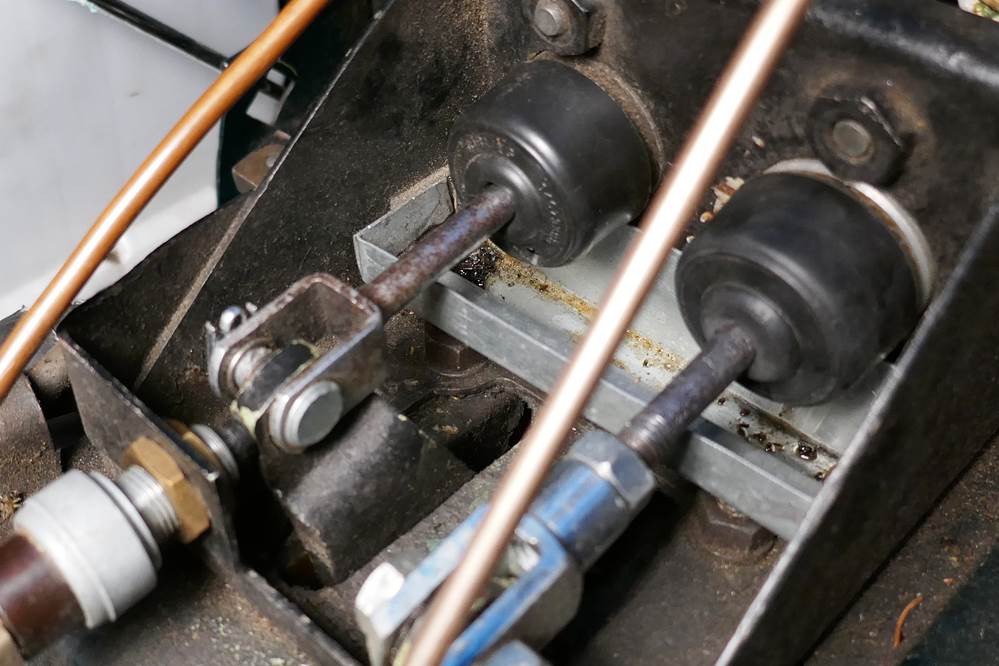

Hi,
after a very nice drive today a look in the leak container told me I should fit a new seal on the clutch master cylinder?
1449899278_TriumphTR4Abrakefluidleakcontainer10-2018.JPG.95c94565675bbe5c1e9b84e18dcd1a63.JPG
Brake cylinder is dry, so there is no hurry, the container allows me to stay calm.
Ciao Marco

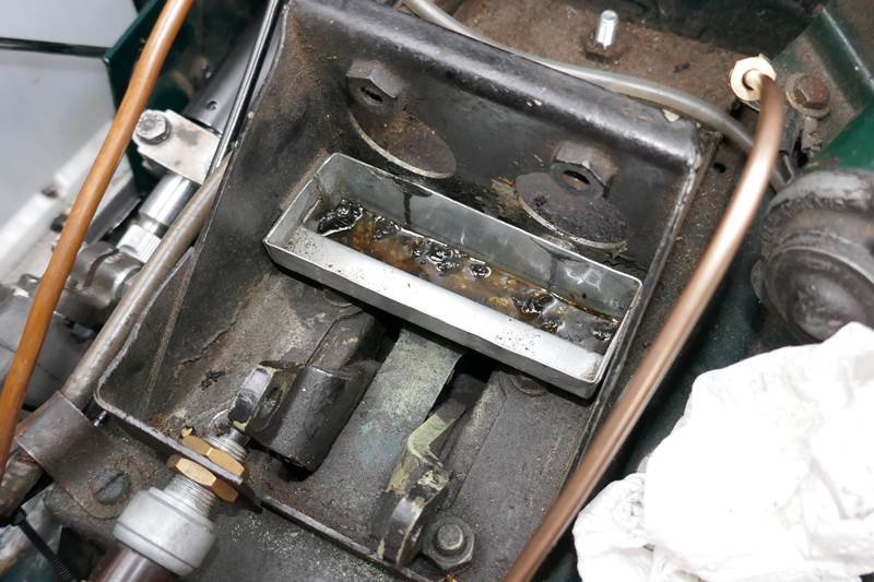

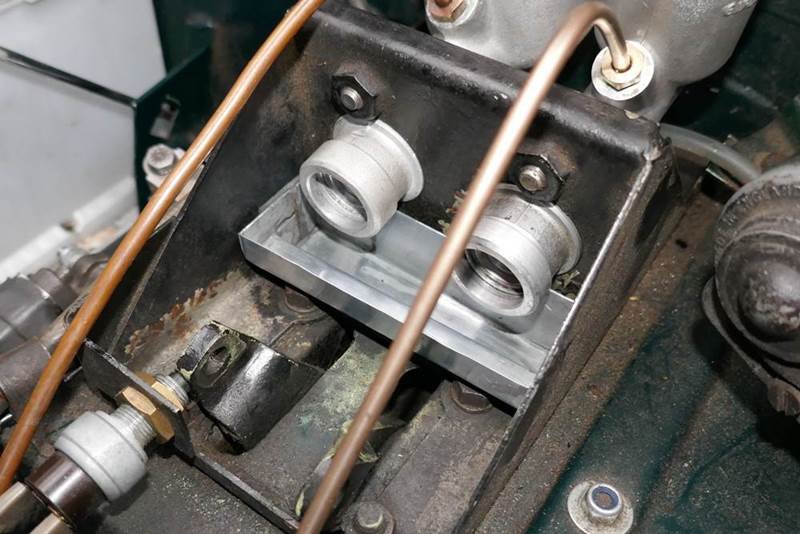

Time to clean and put new seals in.
all out
back cleaned container
cylinders back with new seals
next spring can come, I'm relaxed

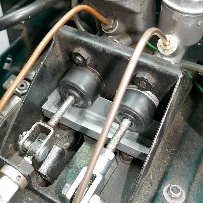

Hi there,
7 years later I'm again very pleased about my leak container!
Yesterday I noticed the brake cylinder is leaking - not on my trousers and not on the carpet!
AP1GczNSf5rlpLU5pttCRmkNeYhnreDWr3uNYTBE
A new rubber cap in the clutch cylinder also could be "nice"
Ciao, Marco

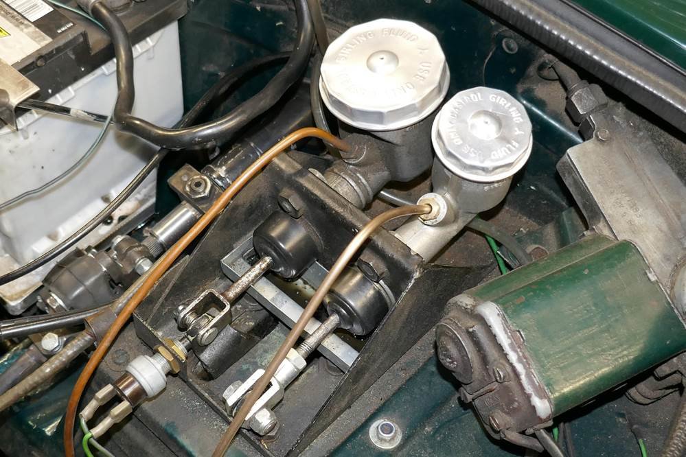

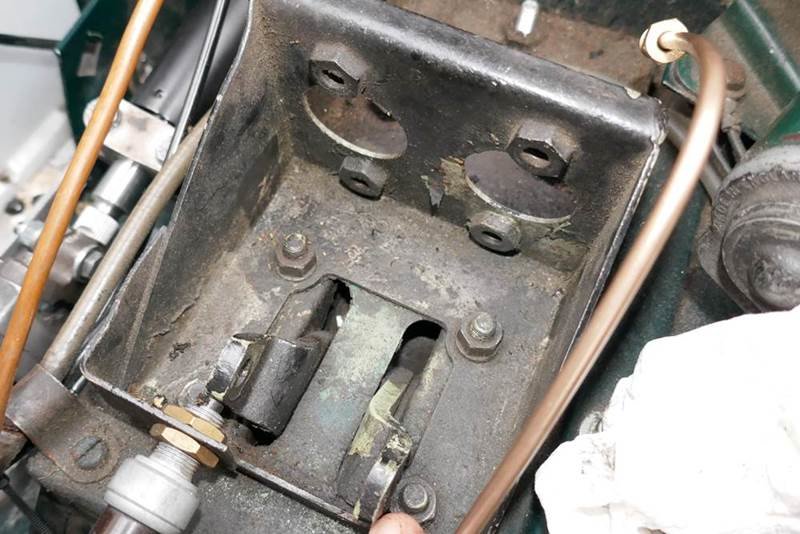

Hi,
there was no reason to hurry, but it was raining, I had time and spare seal sets.
To clean the tray I put the clutch master out too and noticed it was also leaking.
AP1GczNaE-Sd_tvr_r6UxjQ9MWJIKkmYv30qj3uA
All cleaned in the ultrasonic bath  and together again and before I filled brake fluid in
I had the idea to let the pipes bolted off and fill a small amount of fluid in until it comes out the threads!
That worked lovely! No bleeding issue at all (—> made the final bleeding easier), test drive will be tomorrow - or whenever the rain ends.
 AP1GczNlJ7LVfauxiXIIu9sSXc5B4T13Oth-I9im
Ciao, Marco
