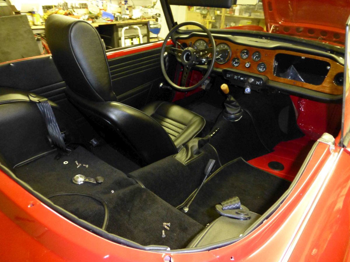

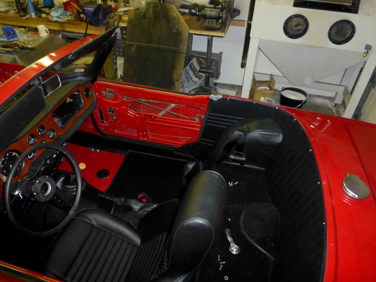

graeme Posted November 28, 2018 Report Posted November 28, 2018 Hi John, Here a couple of photos of my TR6 during restoration. Not ideal, but I think you will get the idea. Cheers Graeme Quote

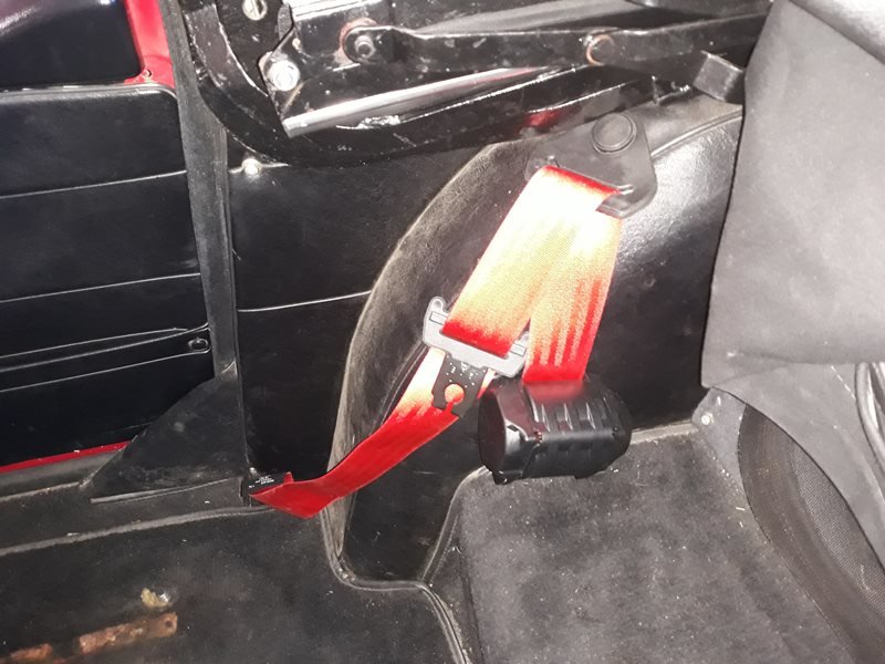

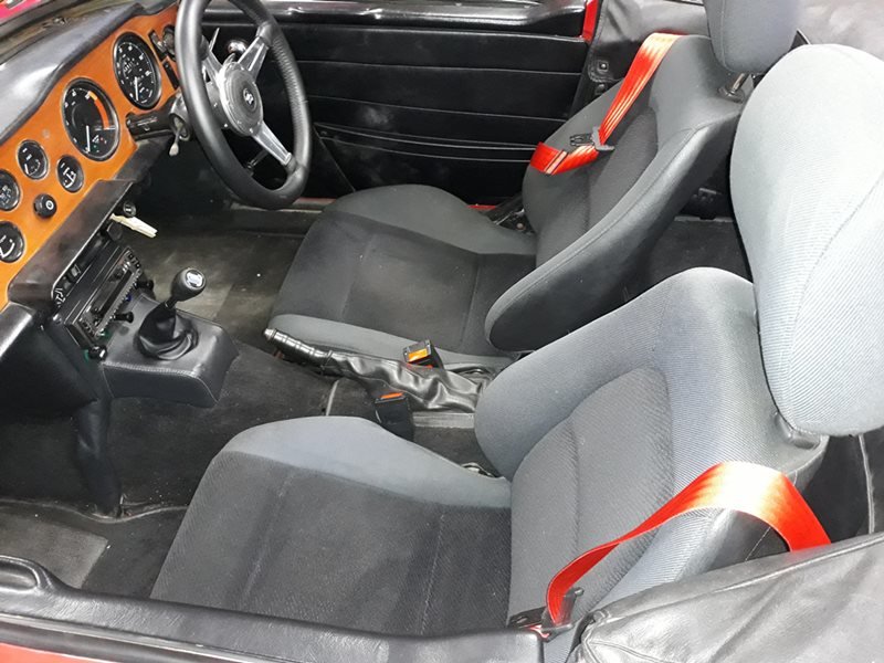

TRsixchris Posted November 28, 2018 Report Posted November 28, 2018 Hi John, Here are a couple of pictures of mine. All mounted in original fixing points using the bolts etc supplied with the belts. The original inertia reals were mounted on the lower wheel arch mounting point at an angle and did not use the top wheel arch mounting these were terrible. The new ones are great, operating smoothly and more comfortable in use. My car is a 1972 CP -well actually a CC so I suspect the mounts were all present from early on. Chris Quote
