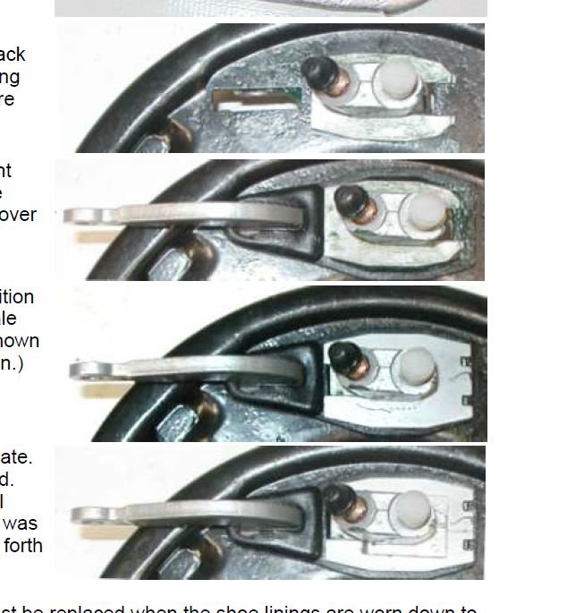

rvwp Posted February 12, 2020 Report Posted February 12, 2020 Hi Guys. Advice needed on how to fit/secure the pesky dust cover to the back plate that comes with the cylinder retaining kit. It can't be held under the clips as the cylinder would not be able to float? There is no lip to hold it over the three clips when in position? Other that being held at one end where it passes through the handbrake lever, it's just left to float which does not seem to be correct. Advice wanted. Thanks Rich Quote

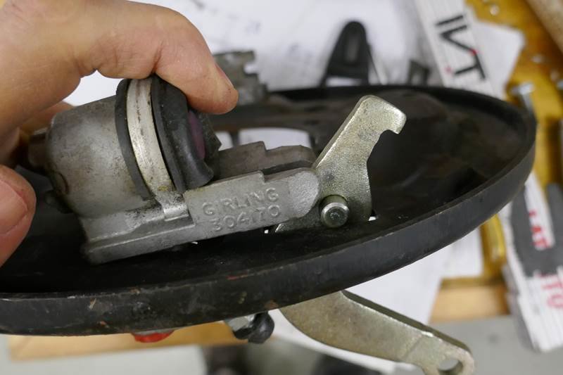

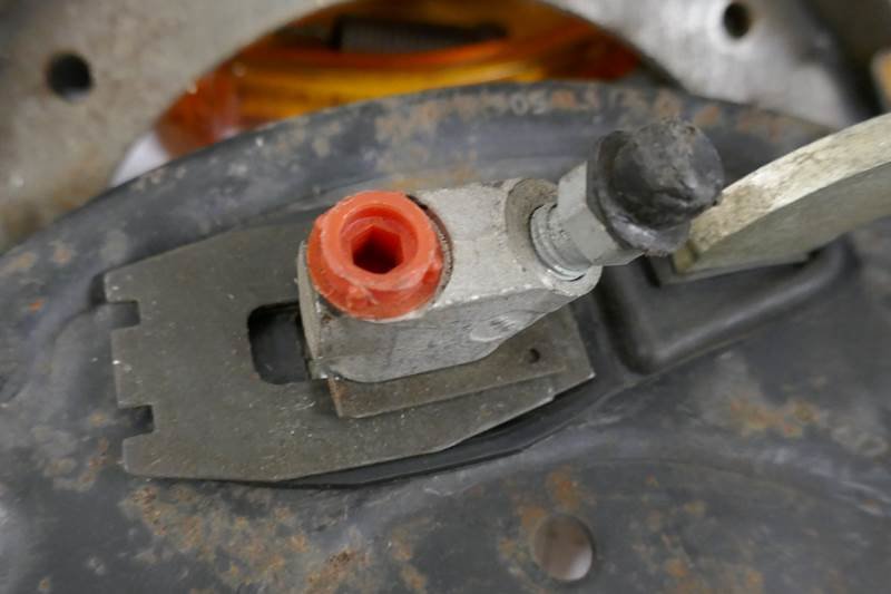

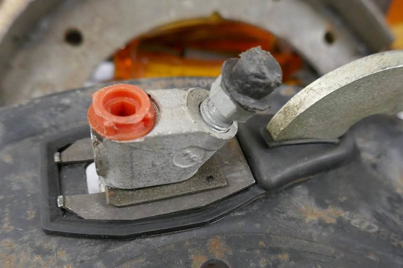

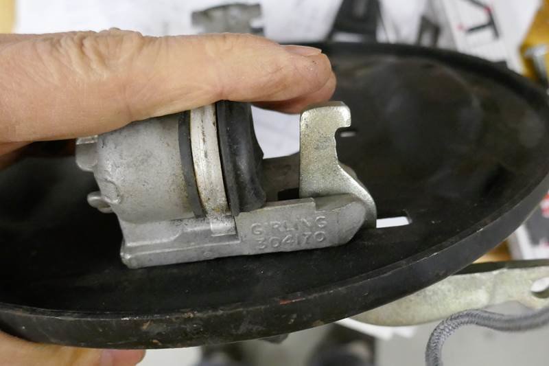

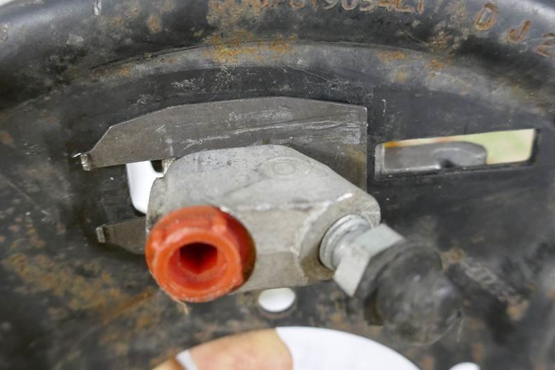

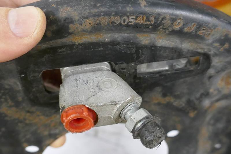

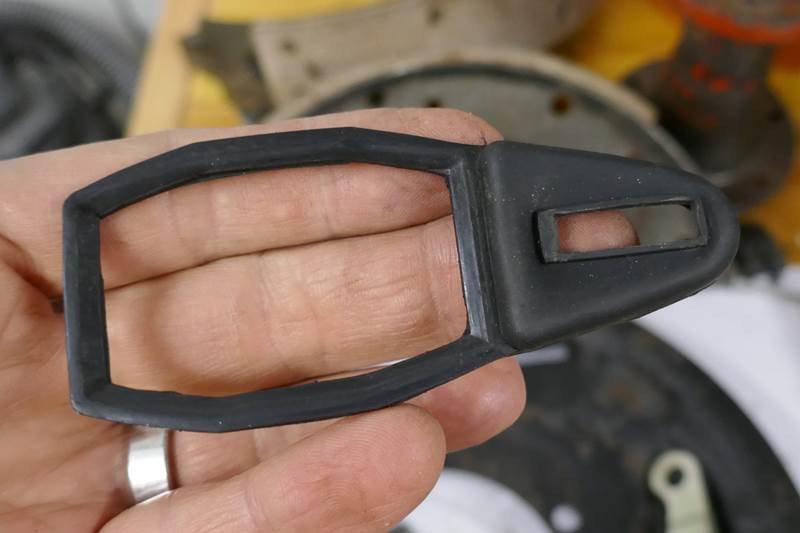

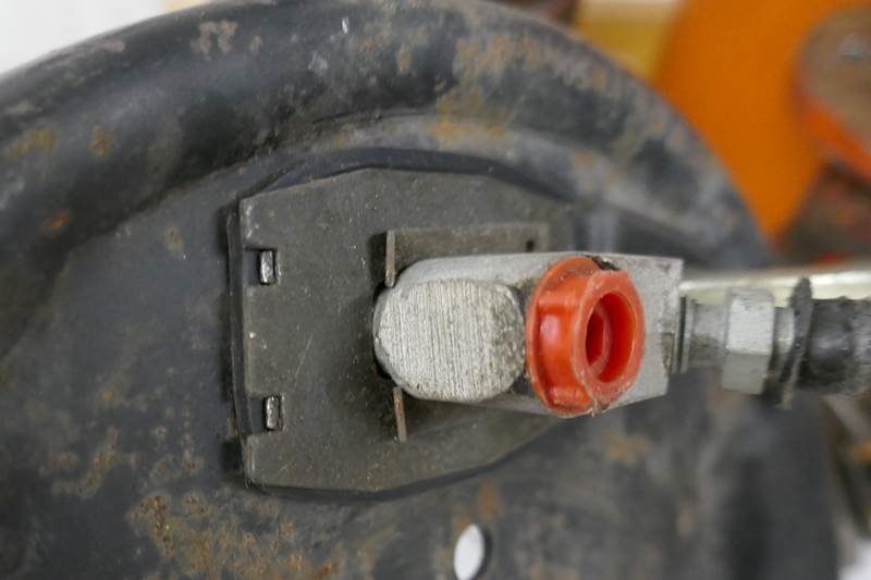

Z320 Posted February 12, 2020 Report Posted February 12, 2020 (edited) Hi Rich, I'm just working on that (seal unsealed), I can show you how I do this. First make shure your seal looks like this (the one on the photo, 10 years old, I had to prepare with a scissors) Put the brake cylinder through the back plate and fit the medium sized, bended spring plate with the tooth outwards. This gives you enough play to tip it and to put the leaver in its position. Next put the the "distance washer" in its postion and the rubberseal around the spring plate: The spring plate slides on the back plate and the locking plate covers / holds the seal when you slide the locking plate it between the others, slide it until "click" To open it I always press down the bendeded spring washer and pull out the locking plate. When ever I do this I think a small drill in the locking plate may be useful to pull it - but I never made one. I never give any punch on the "distance washer", in my opinion it is not the locking washer or safety washer as often told, it is a retaining washer and slack part of the cylinder, otherwise you don't get the cylinder through the back plate. Have much success, Marco Edited February 12, 2020 by Z320 Quote
rvwp Posted February 13, 2020 Author Report Posted February 13, 2020 Thanks Marco for spending time to give a very detailed explanation on how to do it. The WS manual gives no explanation at all. I see where I am going wrong, its in the sequence of installing the 3 locking plates. I will have a go today and report back. Again thanks Rich Quote

ianc Posted February 13, 2020 Report Posted February 13, 2020 (edited) The description in the TR2/3 Workshop Manual is superior to that in the TR4 WSM - so I have made a copy and placed it in my TR4 Manual. Excellent blow-by-blow guide from the ever-helpful Marco! Ian Cornish Edited February 13, 2020 by ianc Praise for Marco Quote

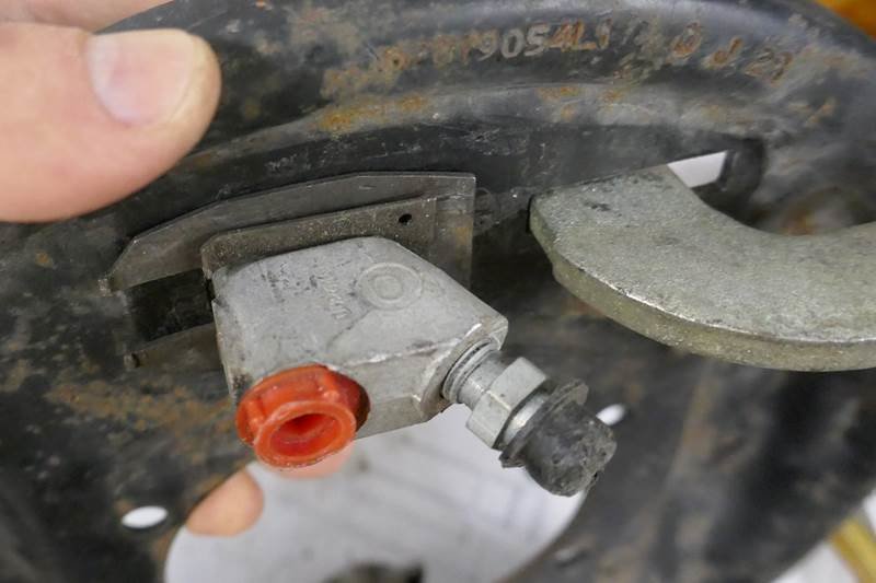

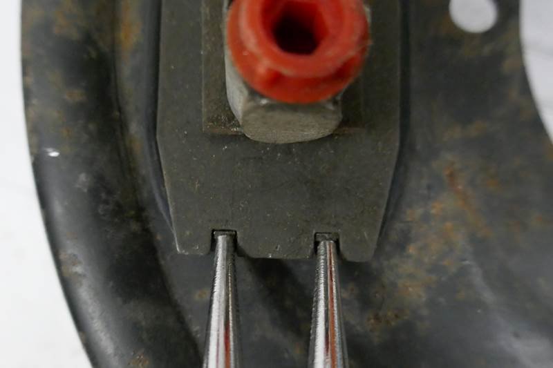

Z320 Posted February 13, 2020 Report Posted February 13, 2020 (edited) You are welcome, last one is how to open this §$%&/?! mechanism, because this can make a strong man desperated Stick two small screw drivers between and with this you have two "ramps" to slide the locking plate over the tooth Take a pliers and pull the lock plate out Here a small drill and a hook would be helpful Edited February 13, 2020 by Z320 Quote

Ralph Whitaker Posted April 4, 2020 Report Posted April 4, 2020 I had all mine done before reading this. Took a bit of head scratching to work out the correct sequence for the plates, and one of the new items was that hard it shattered whilst fitting, luckily still had the originals which seem a bit "bendier" than the new items. I fitted the rubber seal last, and was able to stretch it over the plates and tuck it into the groove at each end OK. so it didn`t get in the way whilst fitting the plates. What ever works for you I guess. Quote
Z320 Posted April 5, 2020 Report Posted April 5, 2020 Hi Ralph, great if you found yourself the way how it works best! With the seal you can go both ways, I fitted it earlier because I did not want to stretch the old rubber to much. Ciao, Marco Quote
JochemsTR Posted April 5, 2020 Report Posted April 5, 2020 Little bit confused....before I saw Marco's post I already installed the rear brake plates.. Buckeye Website installs the top locking plate from the non-lever side.... Marco's installation is from the lever side.... any particular reason for this difference? Do both work? Quote
Z320 Posted April 5, 2020 Report Posted April 5, 2020 (edited) Hi Jochem, you can use it both ways around, for me the way I do the whole thing it works better my way. Indeed I know this description from Buckeye since years and I have a different look on that. They punch in / out the "locking plate" and this in my opinion is both "disadvantageous". 1st this damages the alloy of the brake cylinder and the "locking plate" itself and to work this way is a pain. I'm shure at the factory they did it not this way. 2nd the "locking plate" locks nothing, it only safes itself from self sliding out. The whole assembly works without it but it will be slack. So in my opinion - it is a distance washer / plate.... needed because of the way you have to tip the cylinder with the bended spring plate already on it to get leaver still under it. The real locking mechanism are the both big plates made of spring steel. So I not do this due to the Buckeye description with punch and hammer. Edited April 5, 2020 by Z320 Quote
Andy Moltu Posted April 13, 2020 Report Posted April 13, 2020 I would put the “distance washer” in first then the spring plate. You will still have enough play to fit the lever but much less of a struggle to get the small "distance" washer in. The ends of these are curved up quite a bit on some of the kits which makes sliding them in once either of the other two retaining clips are in place quite tricky. Quote
michaeldavis39 Posted June 7, 2020 Report Posted June 7, 2020 (edited) I have just used these instructions--there needs to be a slight ammendment - you cannot fit the spring plate with the lever in position! So order of assembly should be: 1.distance washer 2. spring plate 3. lever 4. rubber seal 5. locking plate with liberal amounts of copper slip applied to it and then you will need a punch and hammer to tap it into place as its a very tight fit! Michael Edited February 11, 2021 by michaeldavis39 Quote
