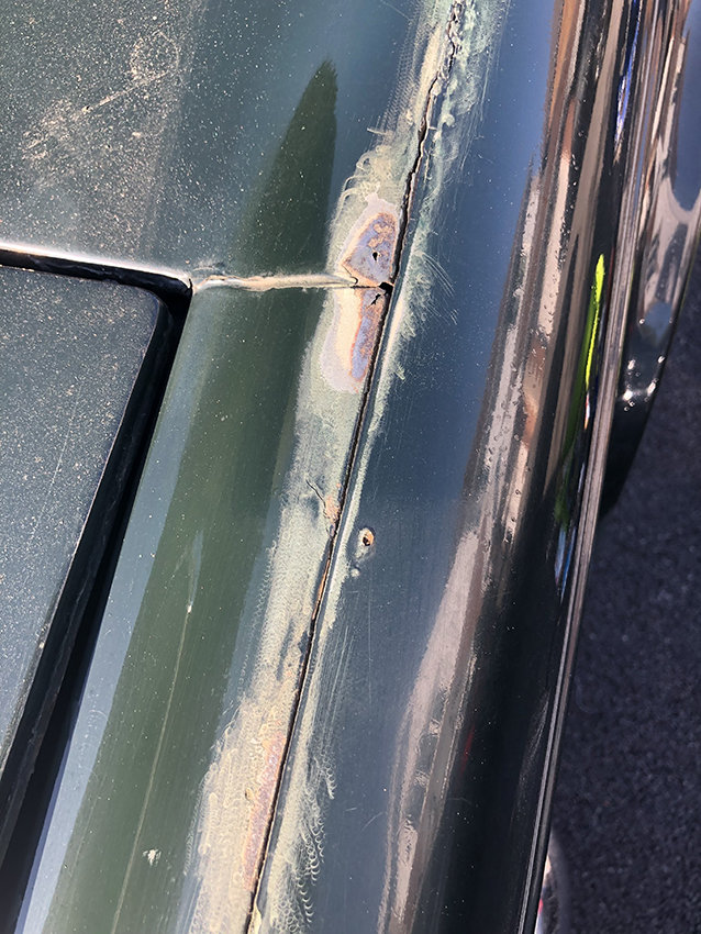

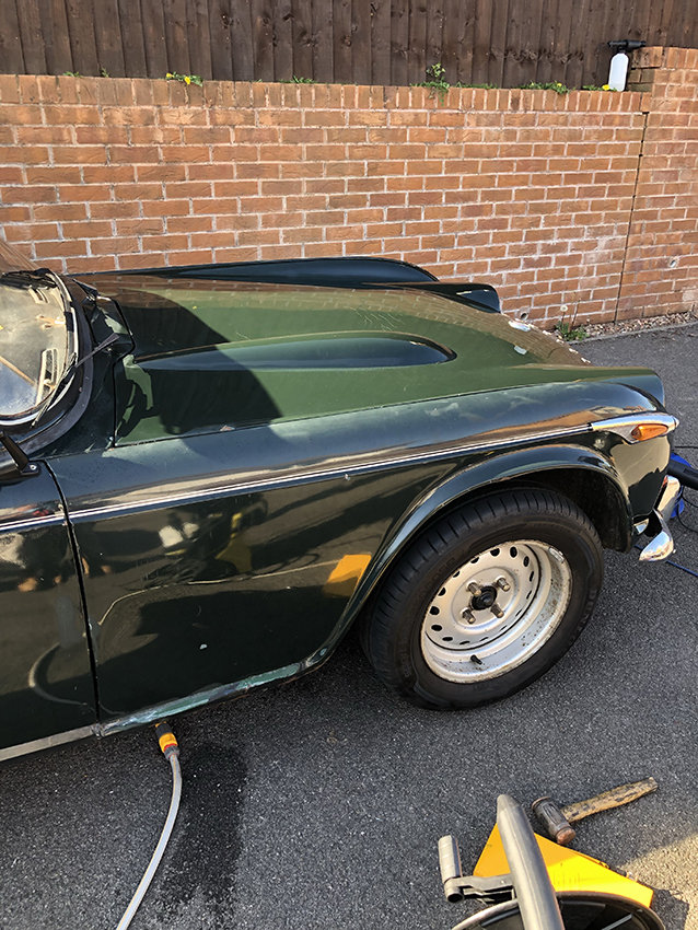

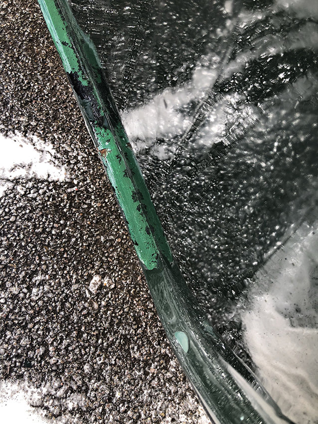

The car hadn't really been polished for a while and was looking very flat so just for fun I ran a DA polisher over her. Also rubbed down the sills as the paint had flaked off and there was quite a bit of surface rust but all solid. That's not to say that these panels will not be replaced into the future.
The bodywork looked a lot worse in the pictures, again under no illusions about the amount of work involved here but very pleased with the lack of rust, was expecting it to be a lot worse.

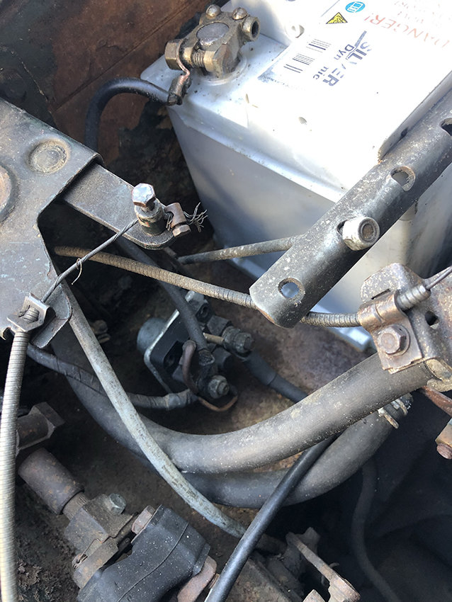

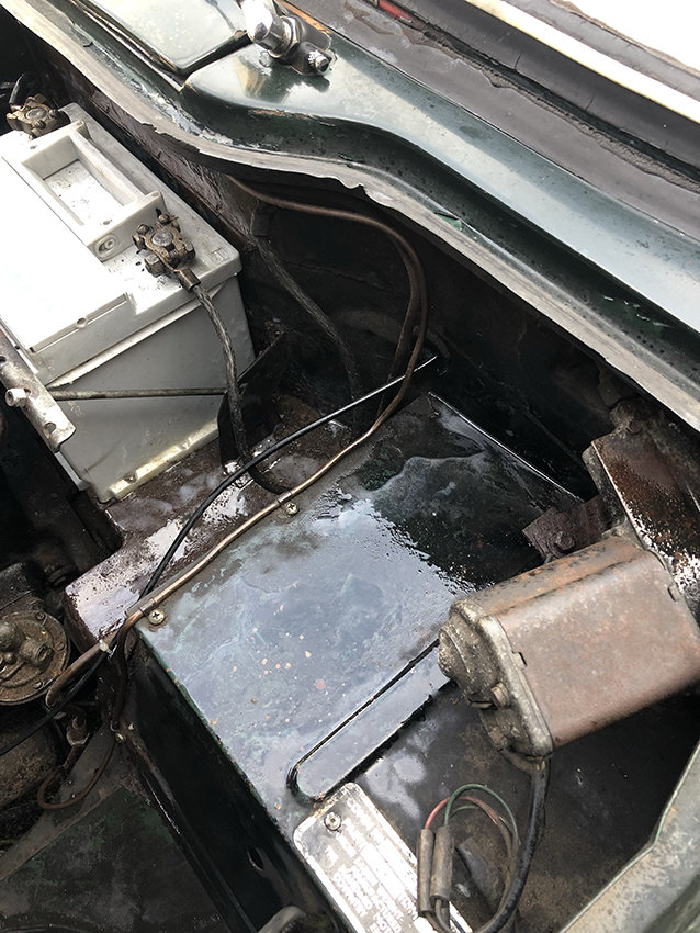

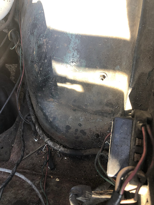

The bulkhead has a lot of surface rust around the battery and will need to be cut back, thinking about CO2 blasting, not sure yet.

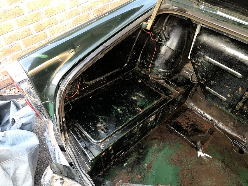

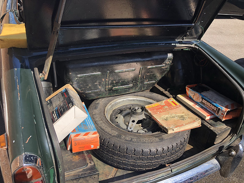

The boot floor and interior looks solid from top to bottom and at some point had a Moss complete stainless exhaust system fitted.

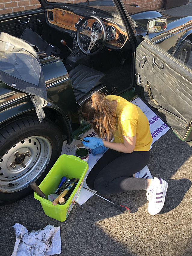

It's a good opportunity to get the whole family involved so my daughter has a brush in hand and is giving the sill a good coat of paint just to protect it after what looked like a few years of no paint at all.

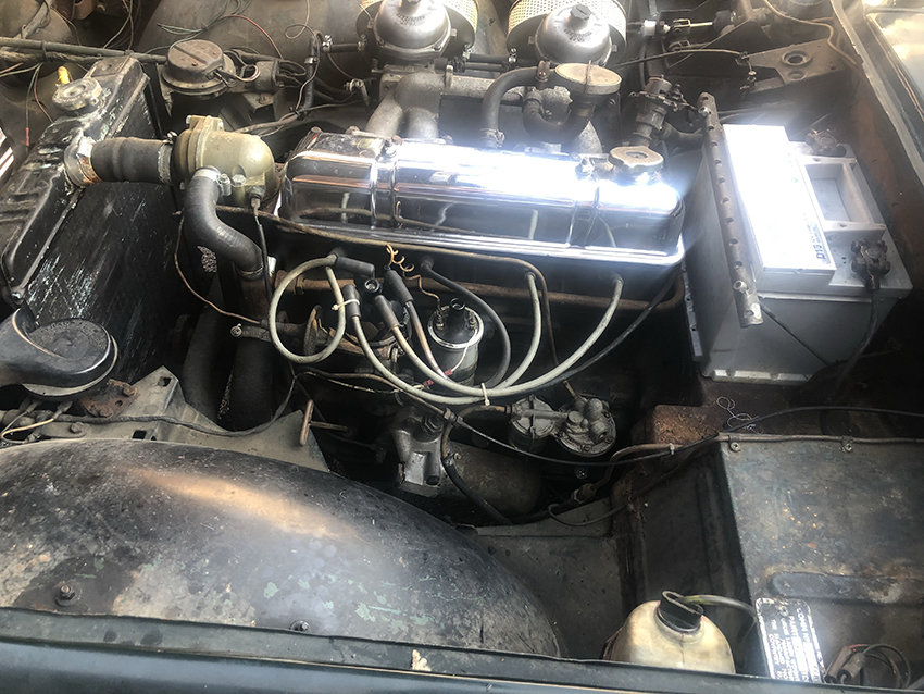

The engine, suspension etc have all been well maintained, service records for every year and MOTs dating back to 76. I've just changed the basics including new leads etc. Will fit electronic ignition and the spin on oil filter once I have started to use the car.

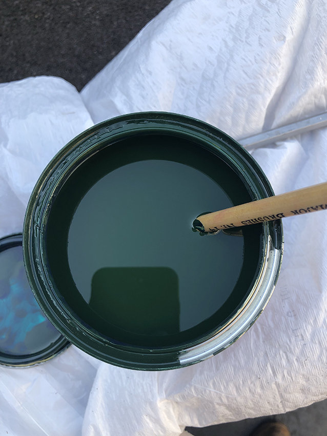

So today I've spent some time painting over the rust that I sanded back having etch primed it. Just using enamel for the time being. Unfortunately the colour looks more like Brooklands green on the car so waiting for the paint chap to come back to me.

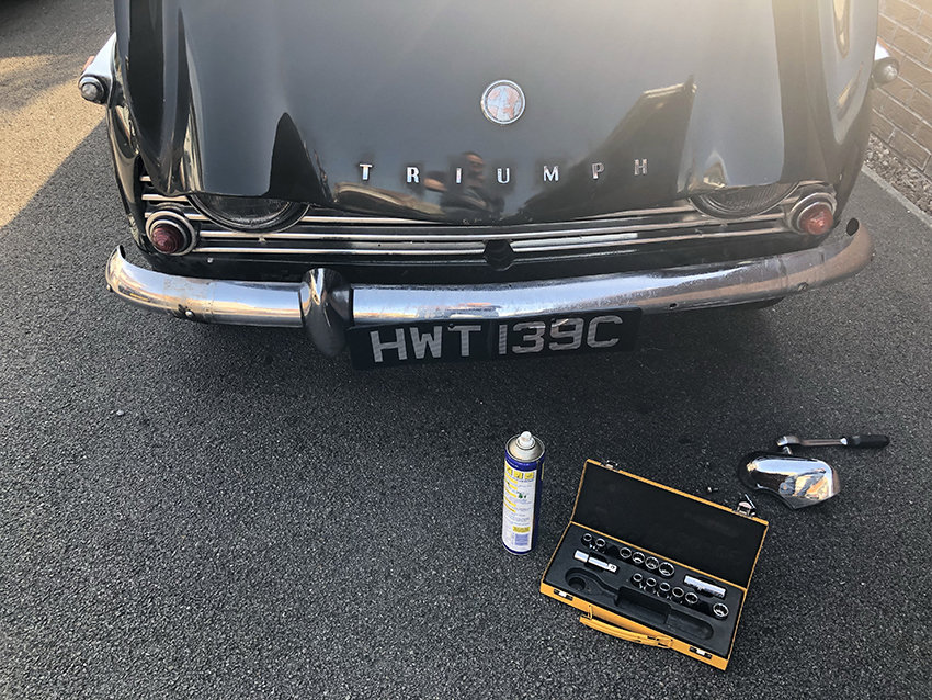

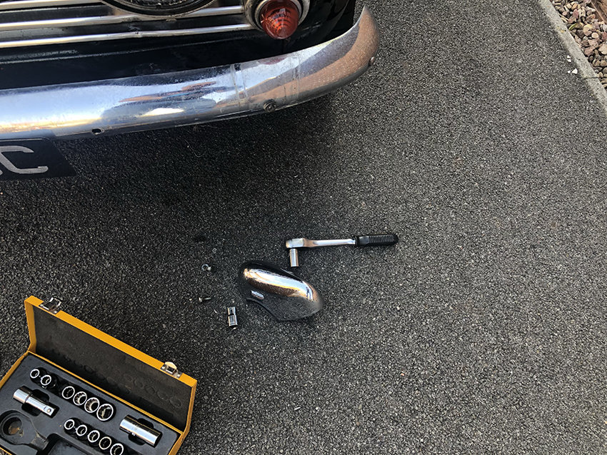

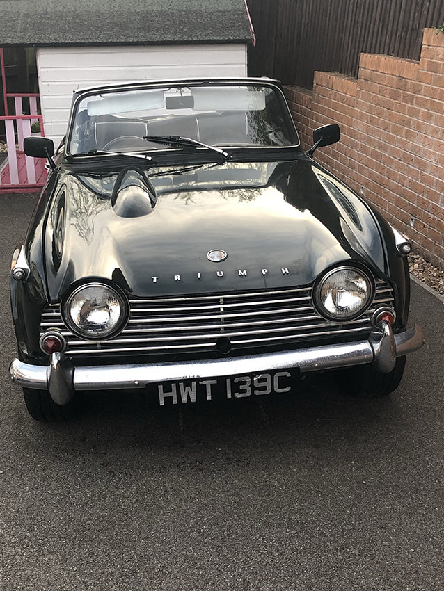

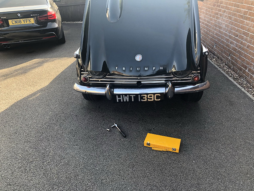

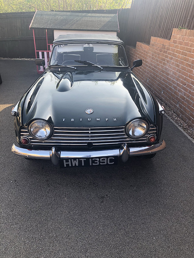

An aesthetic update today, decided to look at the front bumper as the over riders were in the wrong place. Sort of dreaded it as every other Triumph bumper over rider I have tackled in the past has been rusted together. You can imagine my surprise when it all came off without any trouble. Pics speak a thousand words:

Number plate needs replacing but the bumper polished up really well considering I only spent 10 mins on it. May pop the DA polisher on it to see what that does. Any recommendations for a traditional number plate supplier?

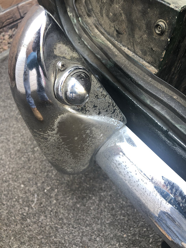

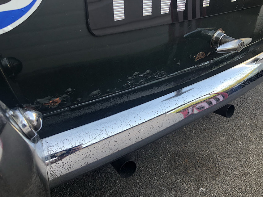

I then had a look at the back bumper which is quite pitted but a little elbow grease made a huge difference. There is no rust on the reverse of these bumpers and they are in good straight condition so will look to having these re-chromed into the future:
As you can see the bumper is okay, the bootlid has the dreaded tin worm across the bottom although this looks very repairable and has not affected the frame behind. I'll be rubbing this down to slow down the rot.

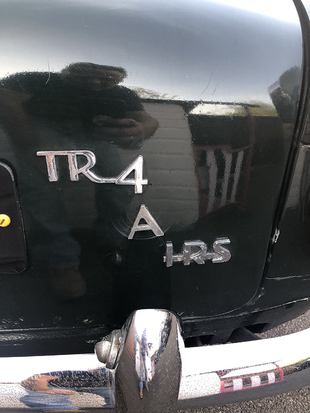

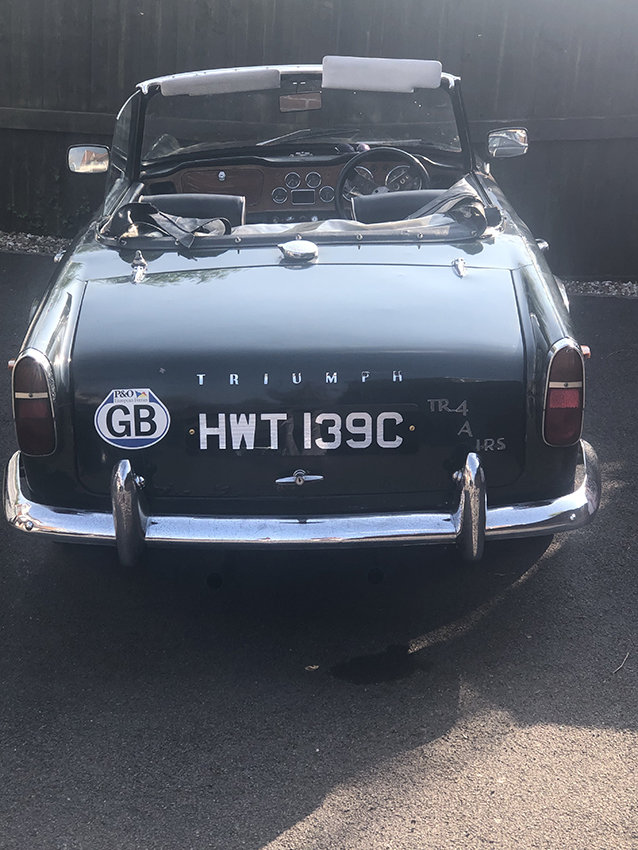

Finally (for today) what is the official position of the boot badge? As you can see the A is swinging from one arm at the top :) Shouldn't it be next to the 4? Thanks
Jase
looks like you have a TR4 bumper as the overiders are now to close to the middle ,
nice sound basis for a good car
graham
Jason
What made you think your front overriders were in the wrong place? 4A over riders are on the outside of the headlight whereas TR4 ones are inside where you have moved yours to!  Normally you can't do it wrong as the correct bumper for the model has the holes in the right place and the bumpers for a 4 and 4A are different but only in their holes..
Having said that,  something looks a bit wrong with the original locations - they look a bit too far out, looking like they are in front of the indicators - no doubt someone will be along with a definitive photo

Graham beat me to it!
Cheers Rich
I know, it is throwing me, it is a 4A and I thought they were closer to the centre. Where they were seems to obscure the indicators. Any ideas greatly appreciated, nice and easy to move back if needed to .
Could they be the wrong over riders?
Edited by Jase
As they were they were too close to the indicators? Bizarre, could it be a bumper from a TR5?
I'll move them back, at least the bumper is now clean :)
So looking at some TR4 pictures, I think the bumper is slightly different and I have a 4 bumper which is why my over riders are a little too close to my indicators. Not sure but that's my best guess. Shame as the bumper is superb.
Edited by Jase
You have a TR4 front bumper definitely. The boot script should read TR4A in one line and the IRS in another below it.

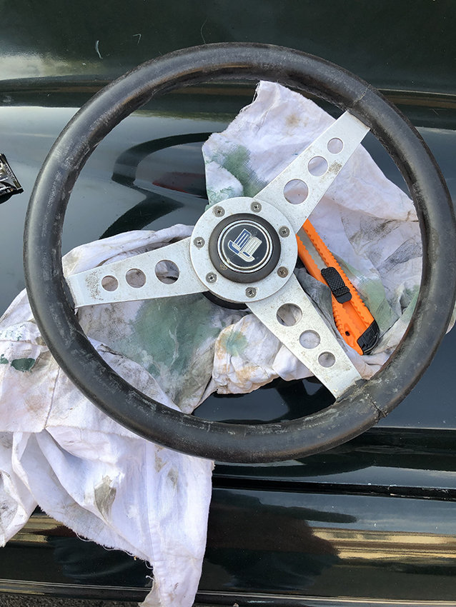

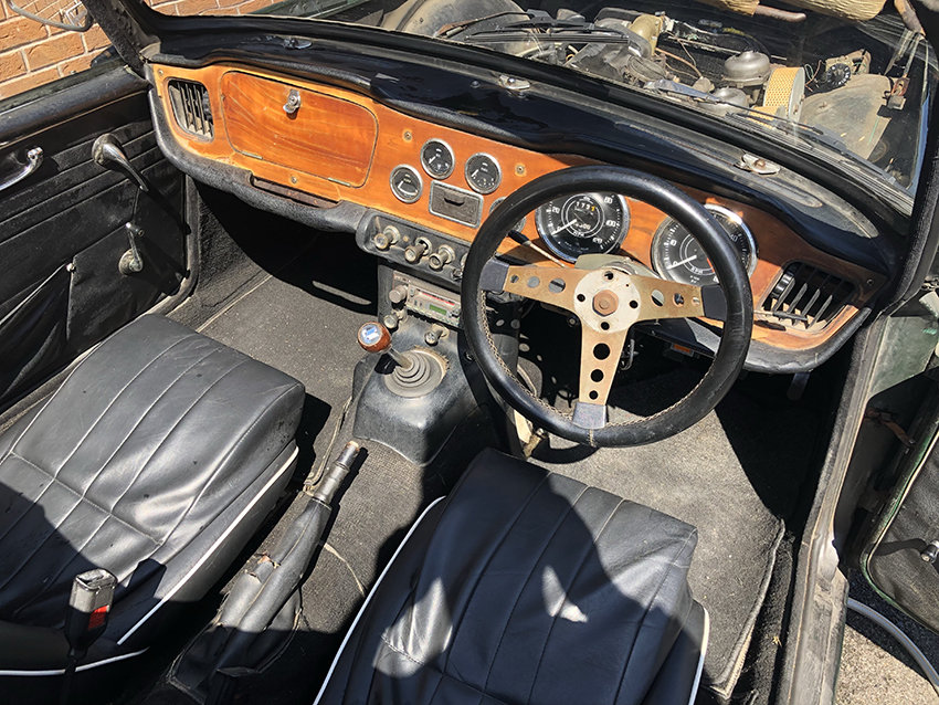

A few more updates from today, found the original steering well tucked away in the boot, guessing it isn't th e'original' but it does have a horn push, will clean up and dig out one of my old Spitfire steering wheel push springs.

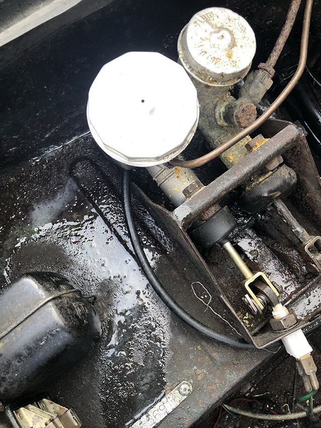

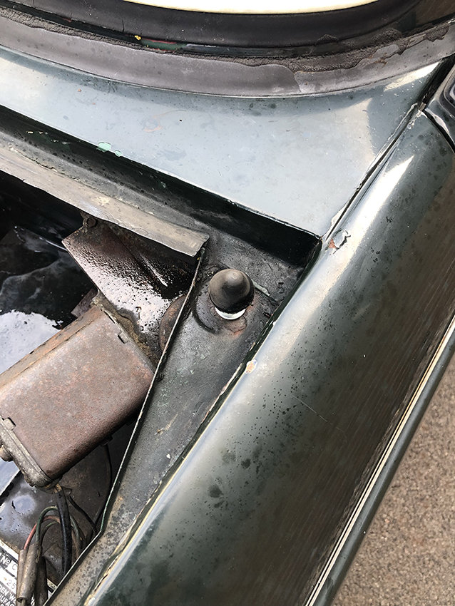

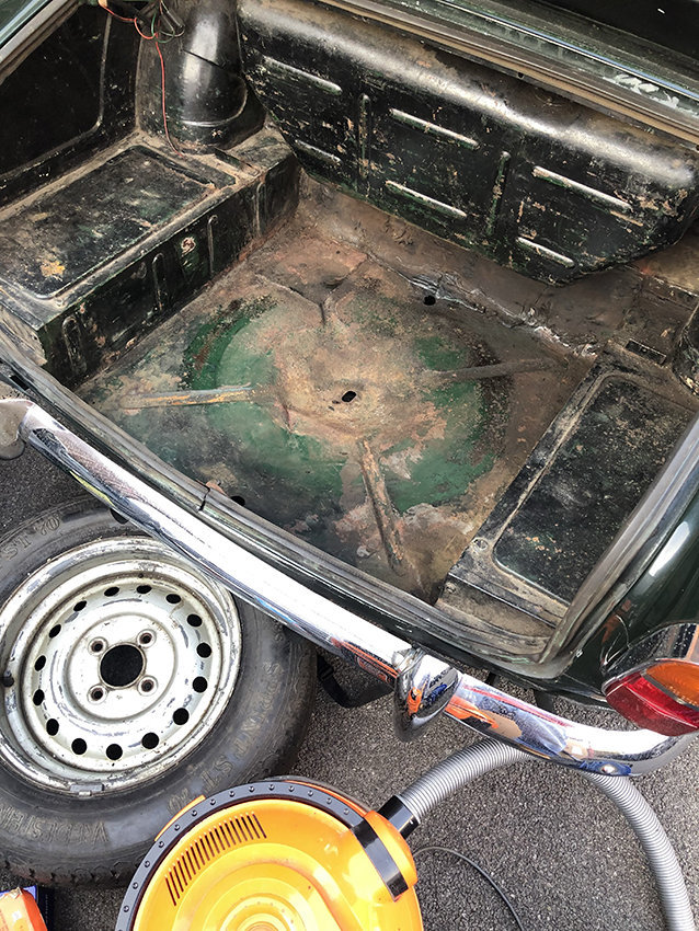

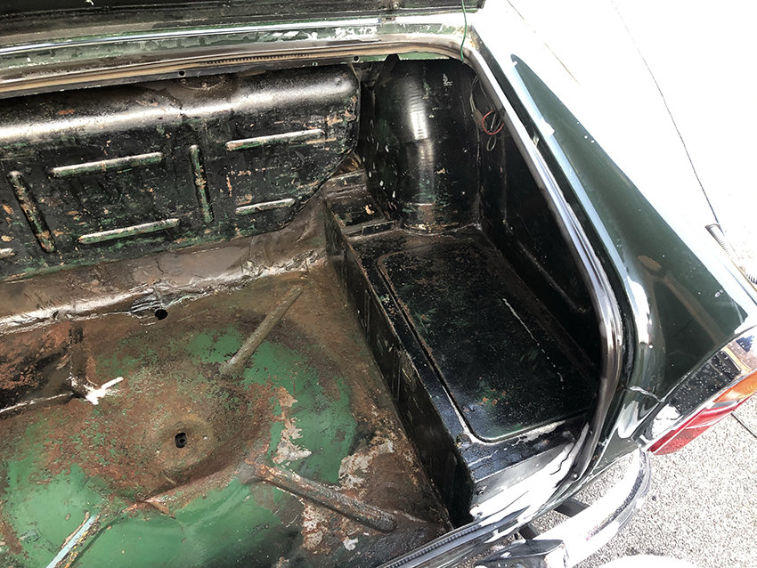

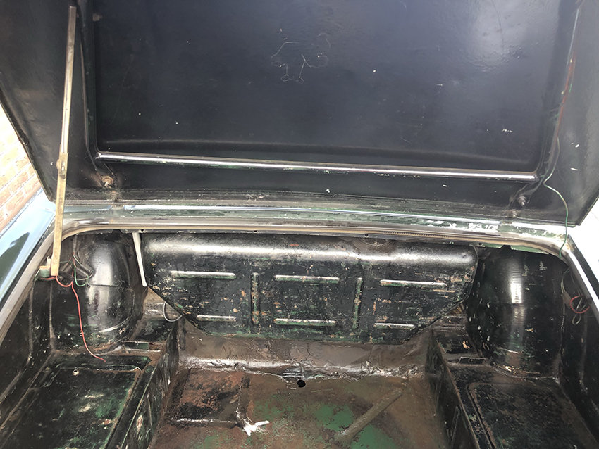

Had a poke around in the boot, before a wash down and hoover:
And a couple of photos after a quick wash and hoover, a little bit of surface rust, will start to clean this up and coat it in brush on to protect it over the next few weeks. Also included an image of the inside of the bootlid.
I would make that red wire hanging down in the boot safe as thats a side light feed.

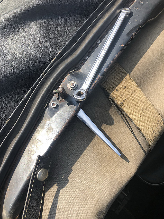

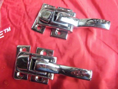

Thanks Stuart, I'll take a look at that tomorrow. A few more jobs today, handles fitted to the soft top instead of a brake bleed spanner, Need to take them back off as they aren't locking in the right place but that's an easy job.

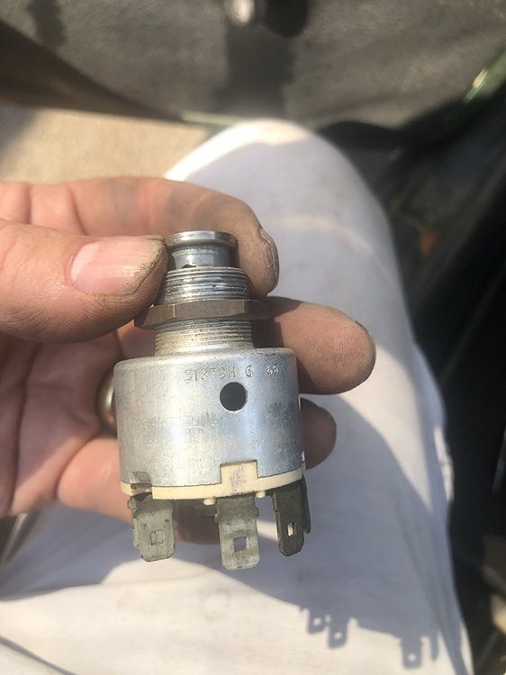

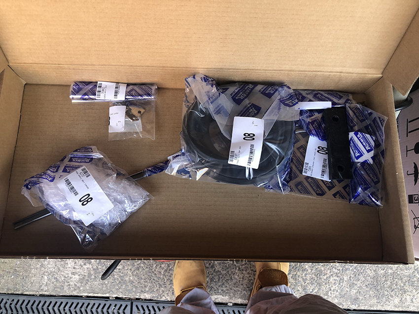

These all arrived in an order from Rimmers this morning which also included a new ignition lock:

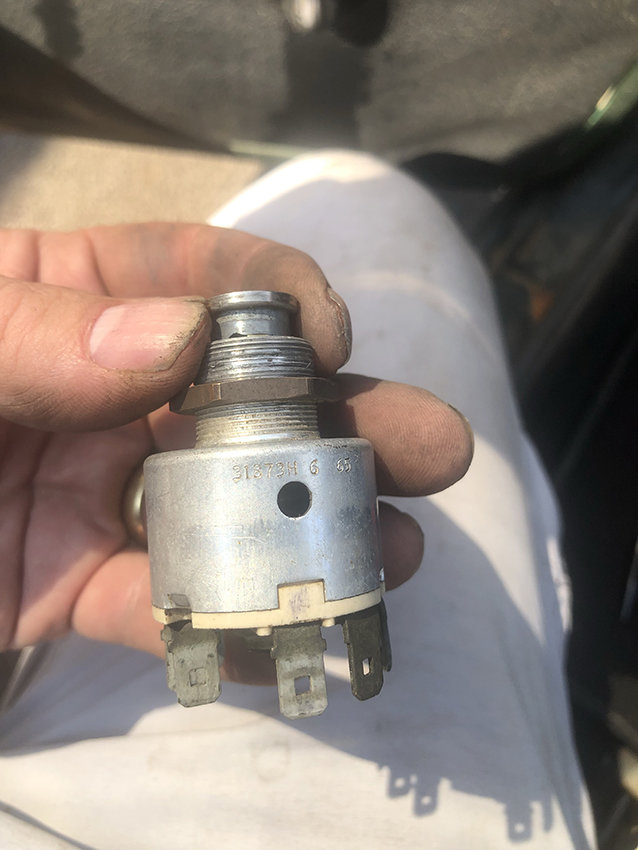

This was really straightforward to change, if you haven't done one before a small scriber through the hole just depresses the lock and it pops out. Thought it would be much more difficult. I also expected the next job to be a pain but to my surprise all of the bolts just undid?? Is this a Triumph?

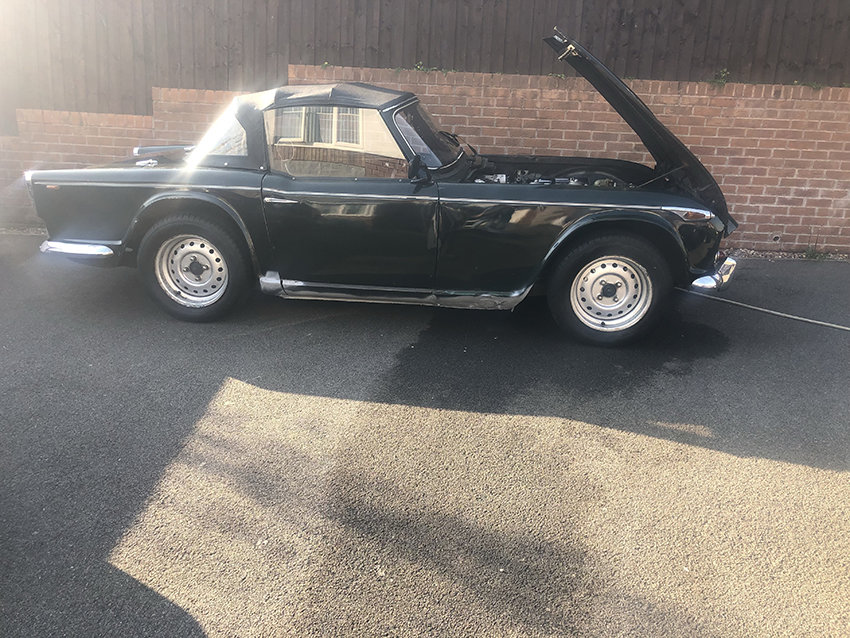

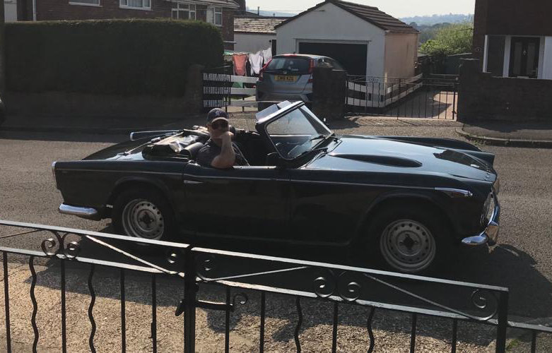

Having spent quite a lot of time going through the car I decided to do an essential run today and drive it for the first time and pick up some petrol, just a few shots back on the drive and my essential food drop off point:
And wow, everything I was expecting, it does need to be tuned properly and I'll organise this once we are out of lock down. If anyone has any recommendations for the South Wales area I would be grateful. A couple of days off now as I don't want to burn to many bridges with the boss :)

That is a TR5/6 hood front hood rail. The TR4A has a different arrangement with over centre clips.

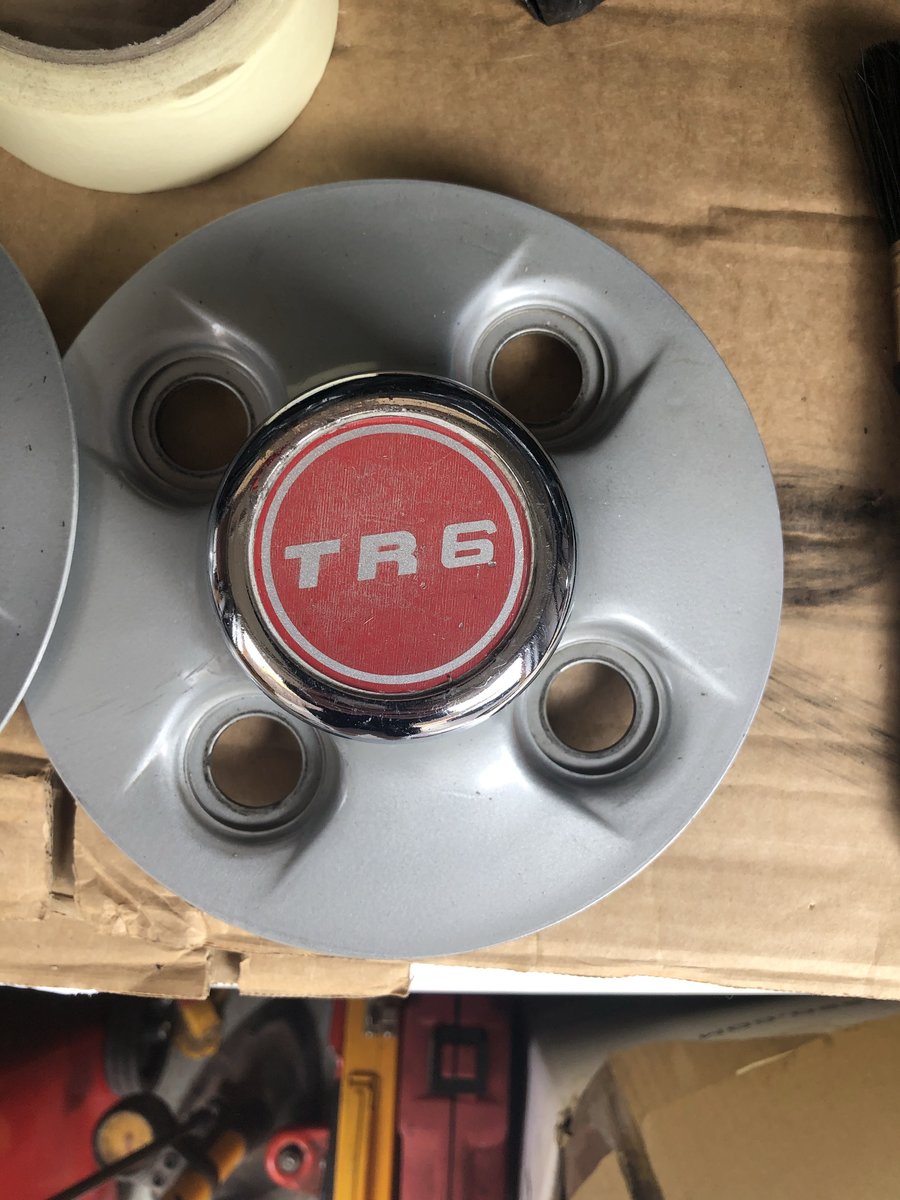

Just received some TR6 wheel centres. Going to replace the centre badge with a TR4A badge, should start to make the wheels look complete. Just need my paint factors to open so I can match my paintwork and pick up some aerosols for the wheels.
