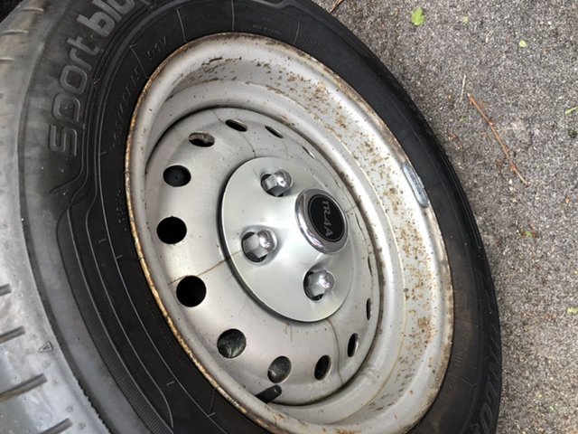

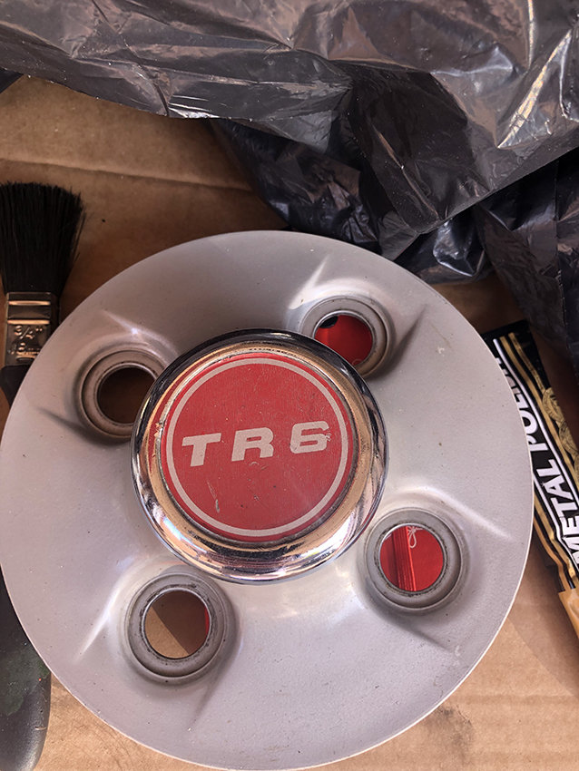

Just had a play about in Illustrator, will get these thermal printed tomorrow to stick over the TR6 logos.:

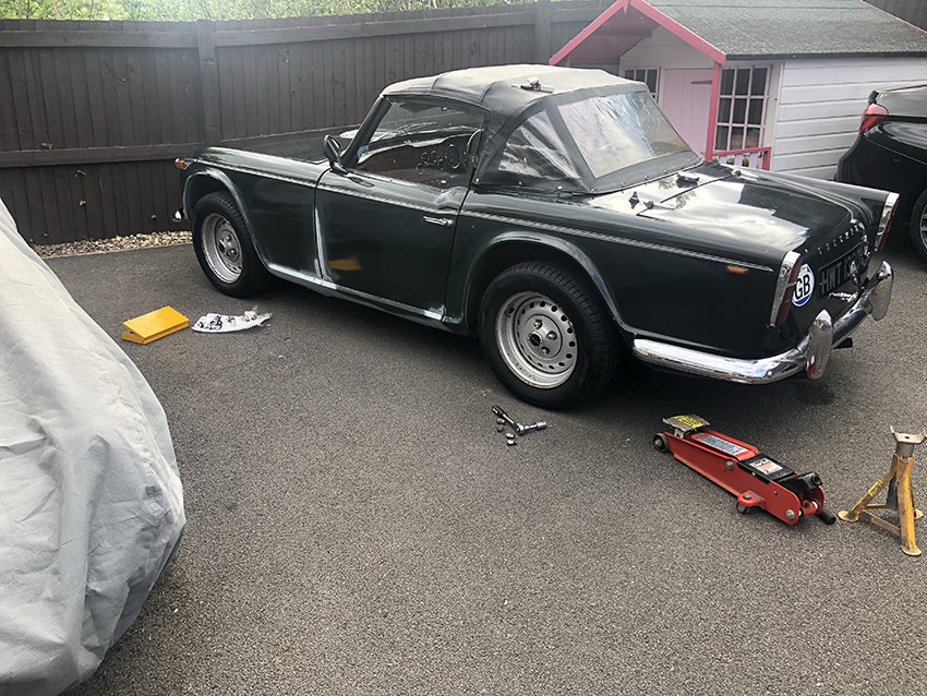

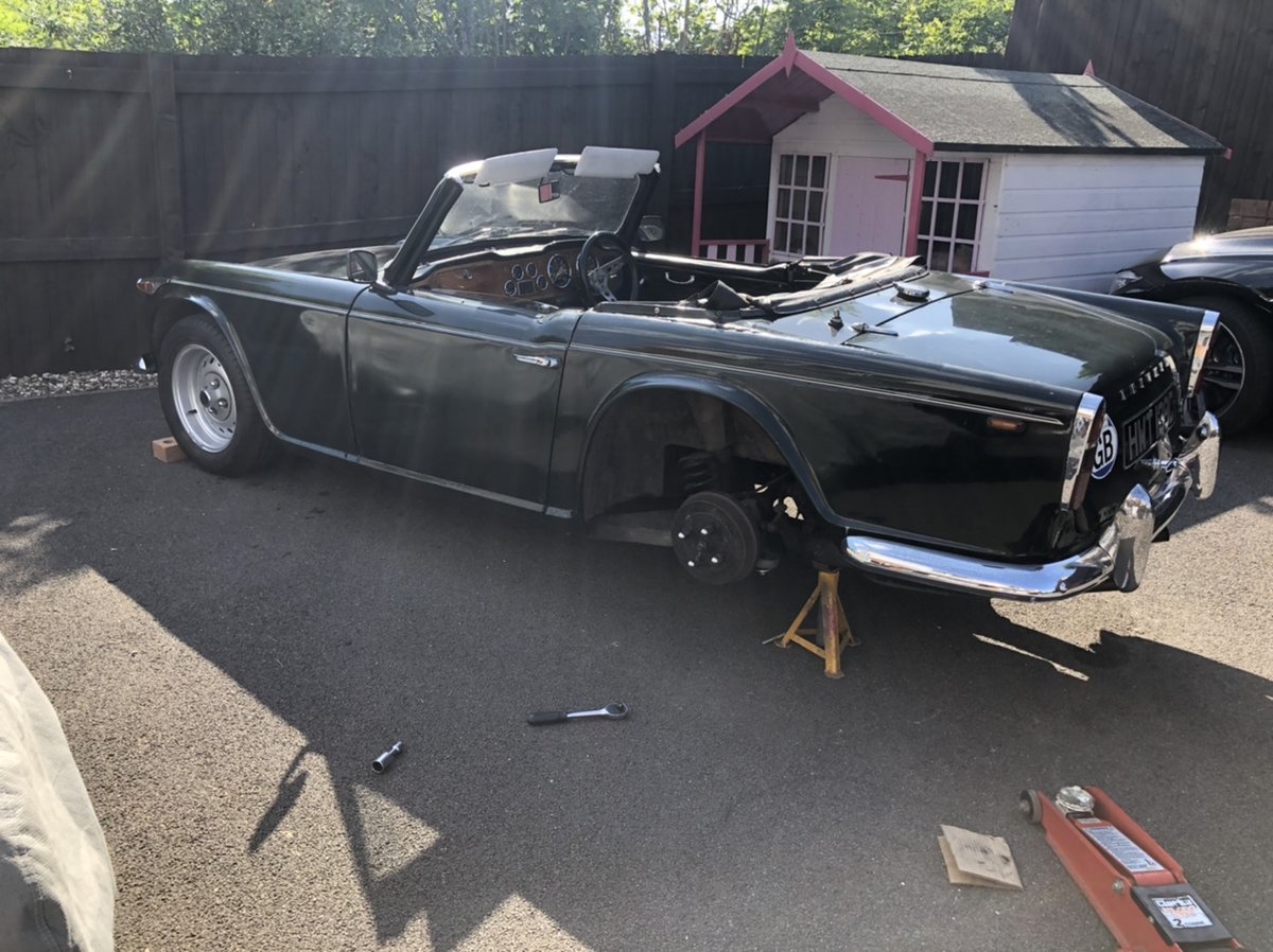

Did quite a bit today, printed the wheel centres:
Unfortunately the wheel nuts aren't the right size for my hubs :( Ordered replacements from the TR shop, stainless with new washers.

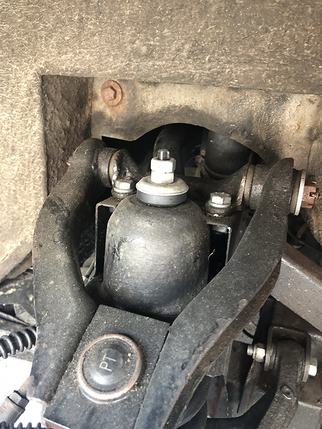

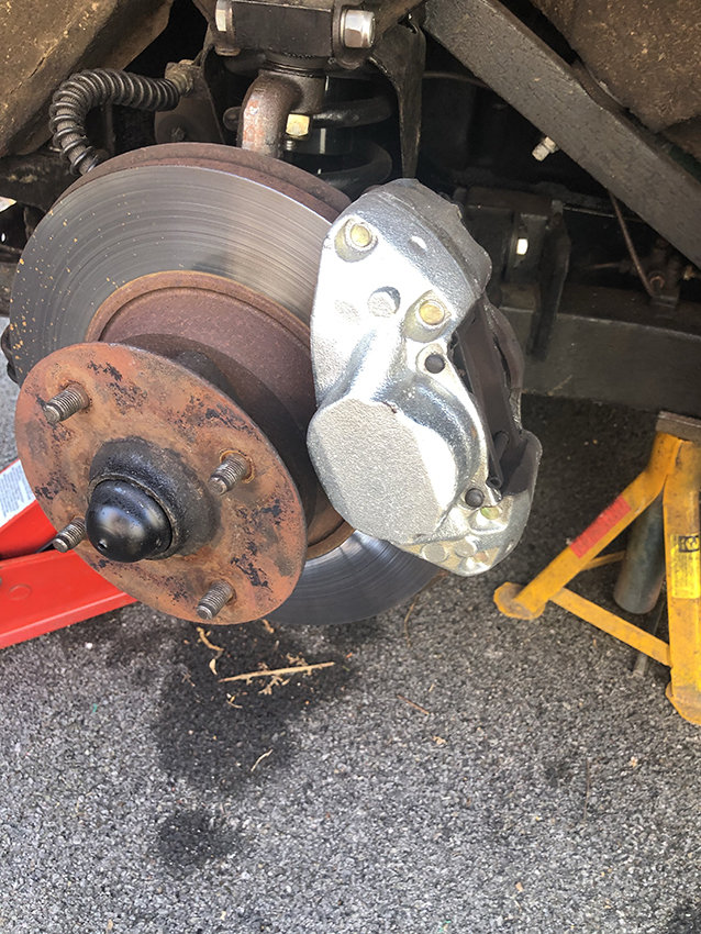

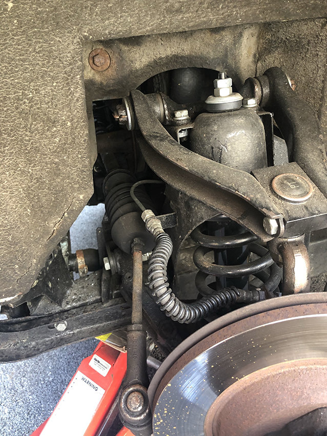

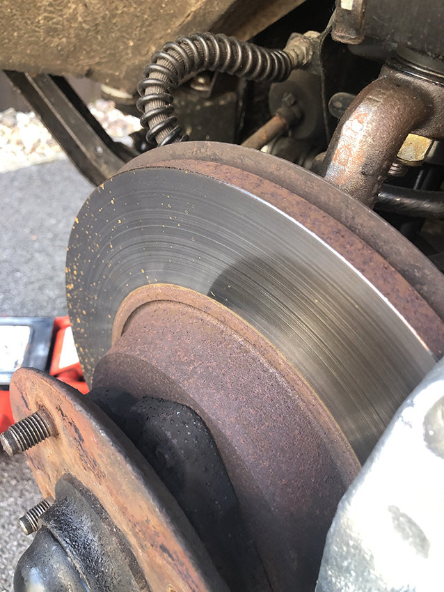

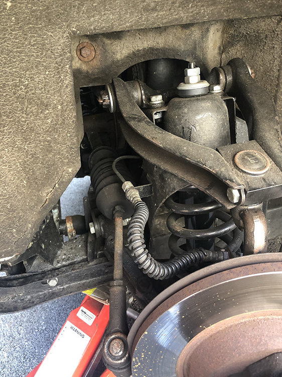

Also had a very pleasant surprise when I removed the front wheels, new suspension all around and discs and calipers, no rot on the inner arches.

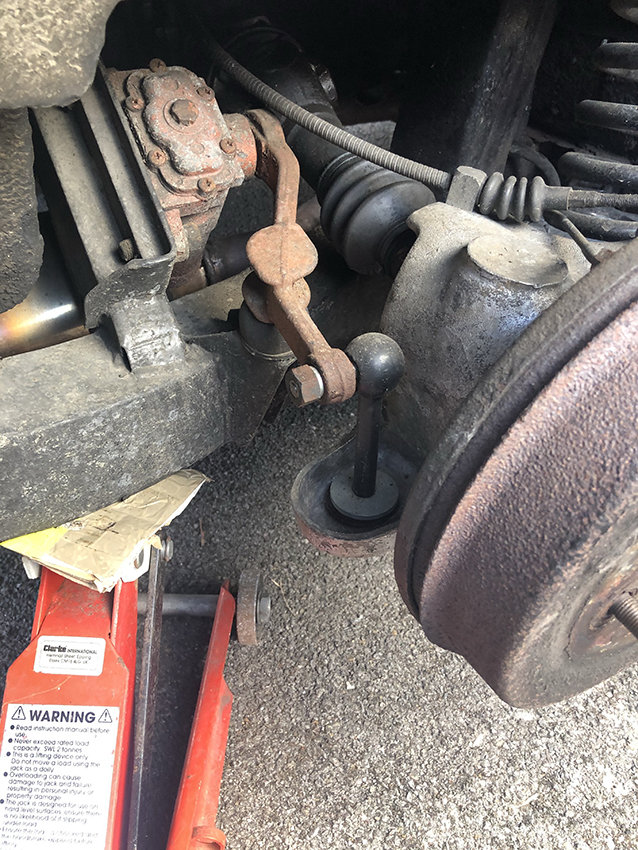

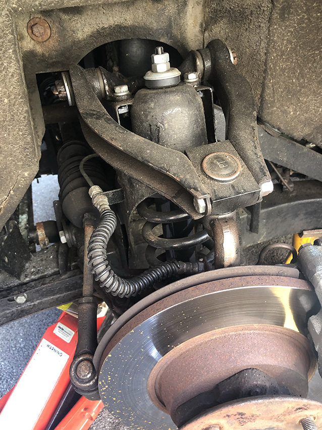

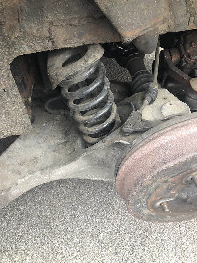

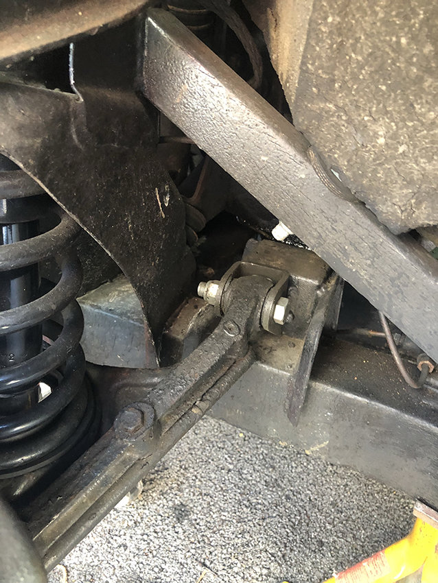

Plus a few more of the suspension.
Edited by Jase

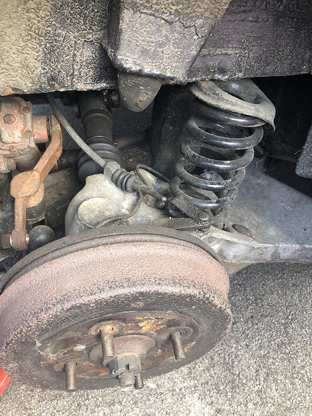

1 hour ago, Jase said:
Its not completely clear, but I wonder if your upper fulcrum pins are wrongly oriented...its a common issue as the workshop manual uses a TR4 example and they switched the orientation on the IRS chassis...it goes the 'illogical' way round:
I borrowed this photo from http://www.nonlintec.com/tr4a/suspension/#fulcrumpin there's a section on Fulcrum Pin Orientation about 1/3 down that page.
Edited by ctc77965o
38 minutes ago, Jase said:

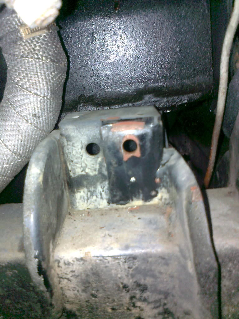

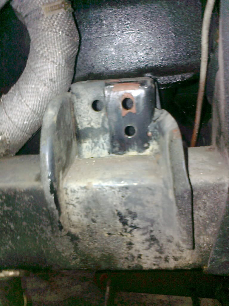

You might also like to have a look at the lower inner wishbone brackets where they are bolted to the chassis to see if they have been converted to 2 bolt fixings as opposed to the original and flimsy single bolt fixing.
Thanks, will check when I fit my new wheel nuts. Lots to learn on this car.

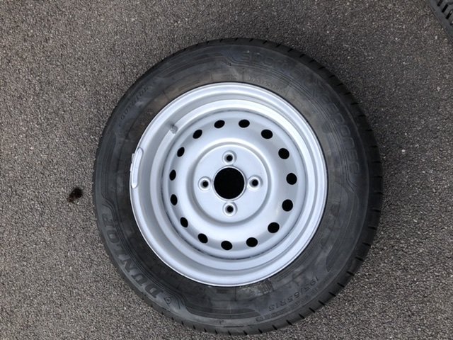

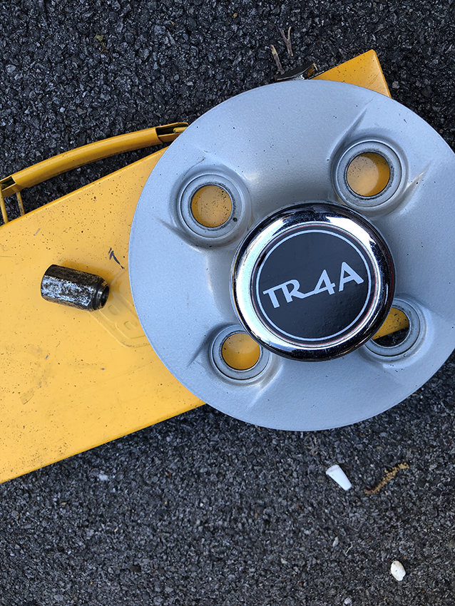

Just some more updates, new Stainless wheel nuts and washers arrived today, slightly larger socket 3/8 so I managed to fit my 'new TR4A' wheel covers. Superb quality on the wheel nuts:

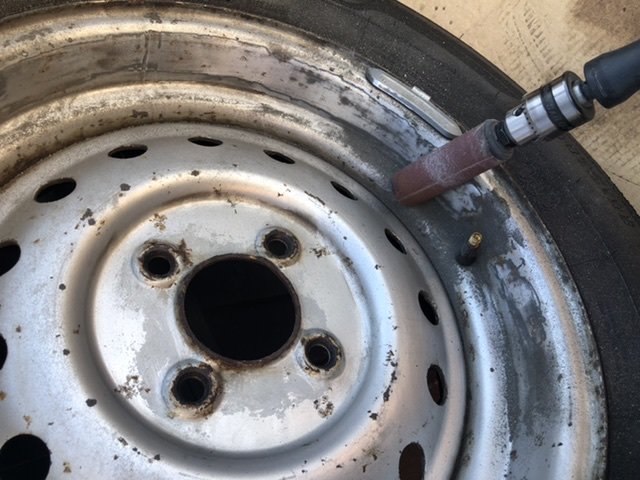

Once I can get my hands on some silver wheel spray I'll refurb my wheels, have an inflatable sander which is superb for cleaning these up. Also had a chance to look at the chasis and wheel arches around the whole car today:

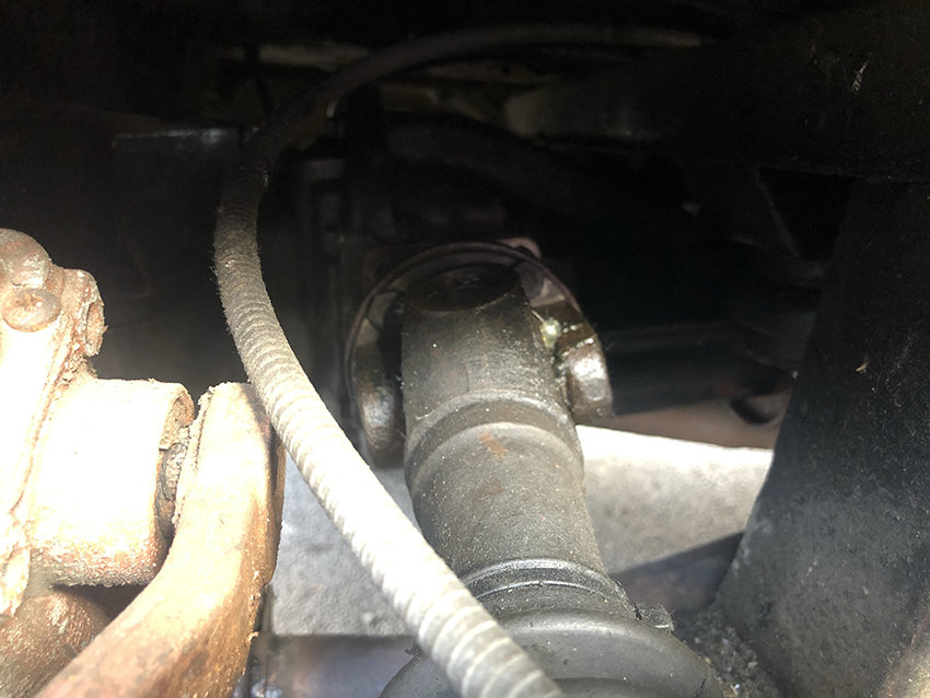

Need to swat up on this rear suspension. It does look like there have been new UJs fitted and the grease nipple has been recently used so a mechanically well maintained car.

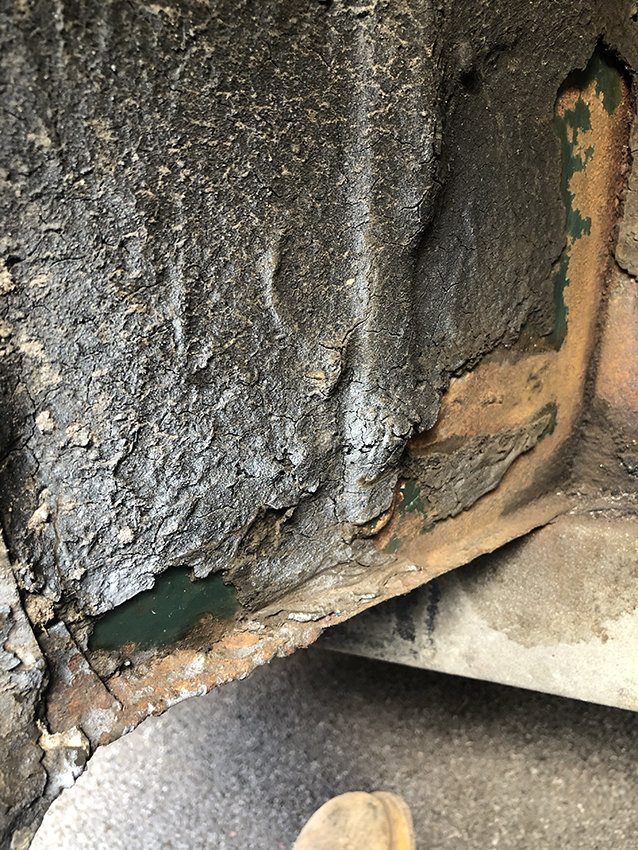

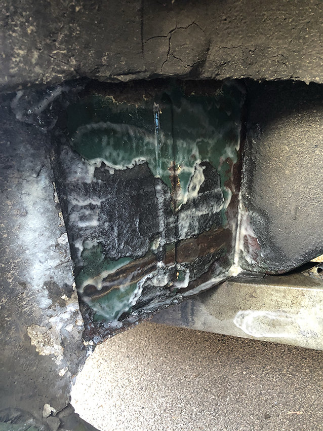

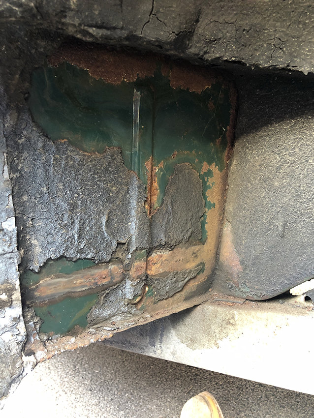

Thought I would have a poke around the driver's wheel arch, was a bit worried about the inner wheel arch as there was a lot of underseal slapped on it:
Not a fan of thick underseal, although when I started to pull it off I had a pleasant surprise.
Didn't want to dig too deeply so I just gave it a coat of clear Dinitrol to protec it for the time being.
Next job is to inject the chasis and spray Dinitrol over the underside of the car.

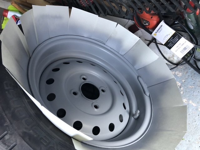

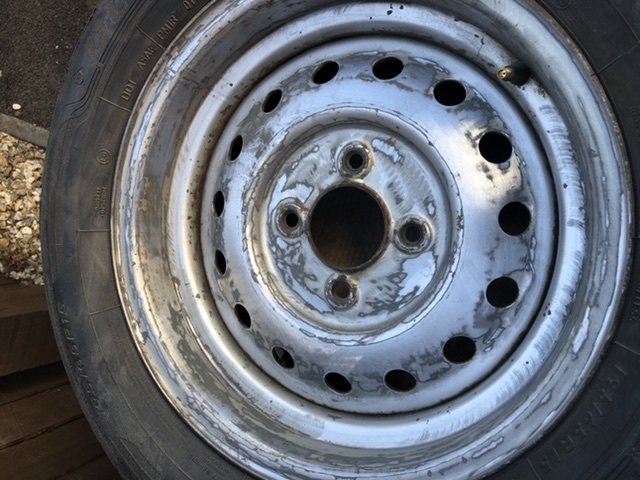

Started rubbing down the wheels to etch prime and paint. I’m just tidying these bits up to make it a little more presentable while I plan out my restoration. Prepped a few sets of wheels with this little inflatable sander, gets the rust off fairly quickly and it only costs the paint
2B0959F2-0104-44AC-9ECE-F6BB3166E354.jpeg.be7aa94b9336ab8253bed91d691d6c5b.jpeg1AC9C147-CF4A-4935-A1B9-F9A53AF9F32D.jpeg.20e08c2b12018543048b39ec966c407f.jpegBB21361C-FD41-4A4D-A7D5-5F50C700D60F.jpeg.22d0a5f84a32ebf5aa360d0873dbb727.jpeg
Pleased with the quick cleanup and paint. Only downside now is I have three more to go :)

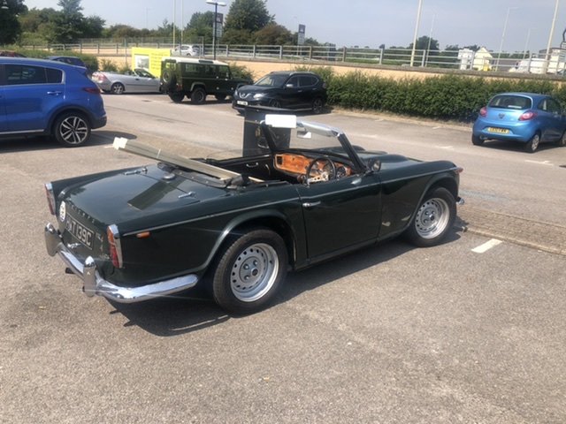

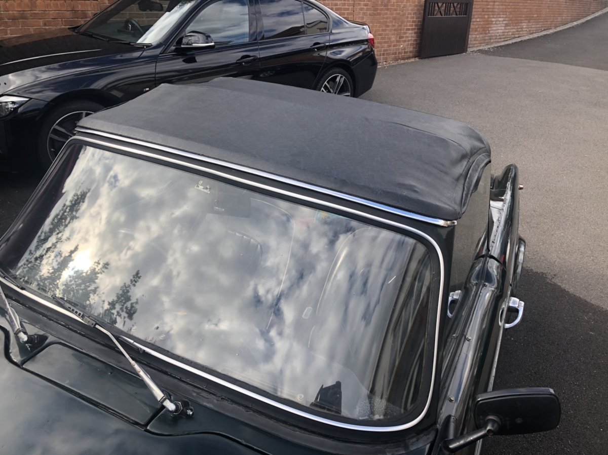

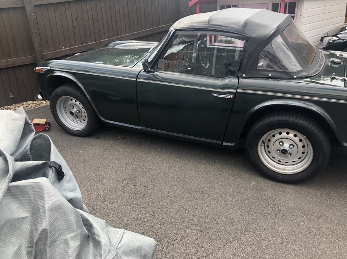

Just a few pics of the working car. Picking up some materials dor my spray booth today.
Excellent thread. You've really brought out the beauty of this car Jase,  and I'm delighted to see it being used as a car rather than treated as if a Faberge egg.
I'm similarly looking (and advertising) for exactly this sort of car, to likewise use as a driver - so should you happen across another then please drop me a line.
My best regards, Pete.
Thanks Pete, I'm slowly restoring but my intention is to use the car as I would have done in the 80s. Can't believe the smile on my face everytime I get in her.
I'd just keep an eye on the auctions and the usual TR restorers as they normally have cars that need work. I'd budget between £12-£14k for an example like this.
Good luck.
