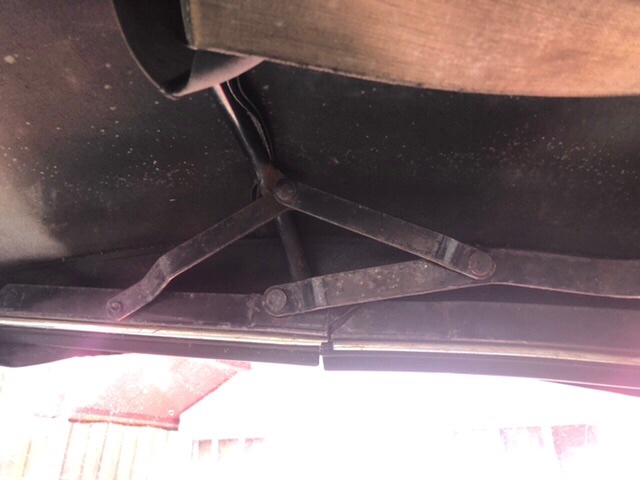

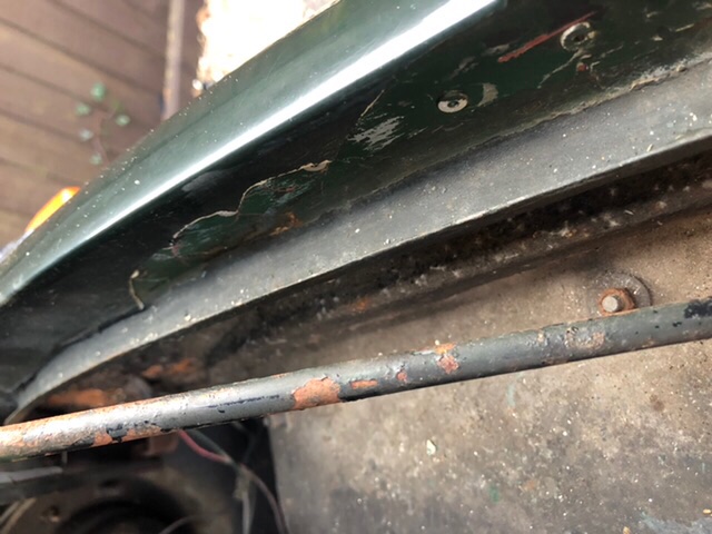

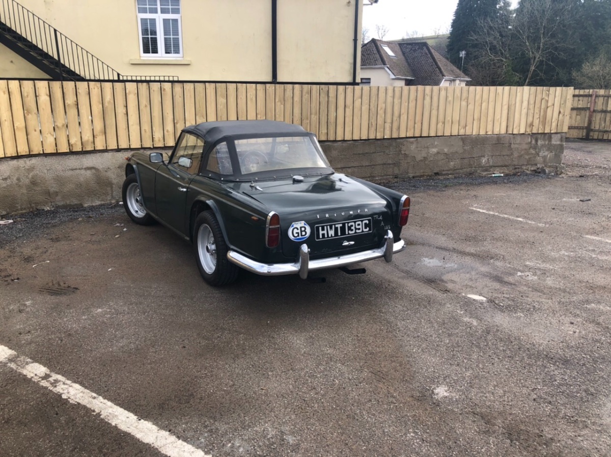

Jase Posted February 9, 2021 Author Report Posted February 9, 2021 (edited) Spent some time on the 4A today in the cold Started to chip away some of the body filler so I can get to the screws. 40 year old body filler seems to have held up okayish. Edited February 12, 2021 by Jase Quote

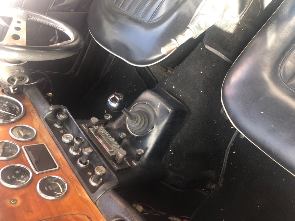

Jase Posted March 13, 2021 Author Report Posted March 13, 2021 Fitted the Revington Gear knob, not sure why anyone would replace with anything, great fit. Quote

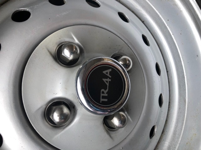

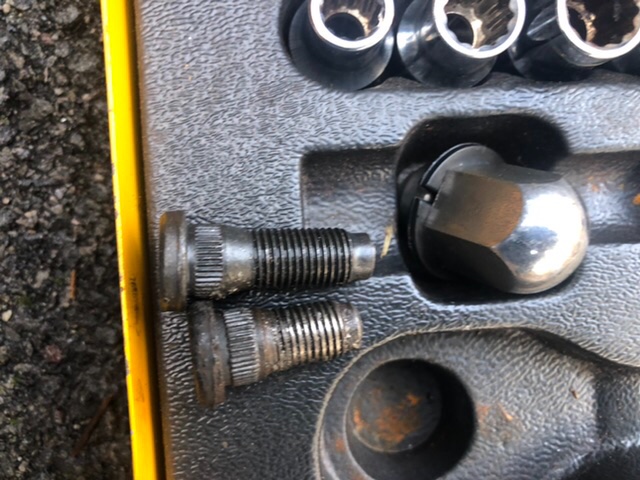

Jase Posted March 13, 2021 Author Report Posted March 13, 2021 Wheel studs replaced for the bew stainless wheel nuts Quote

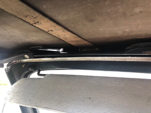

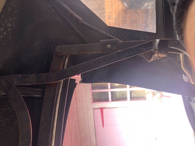

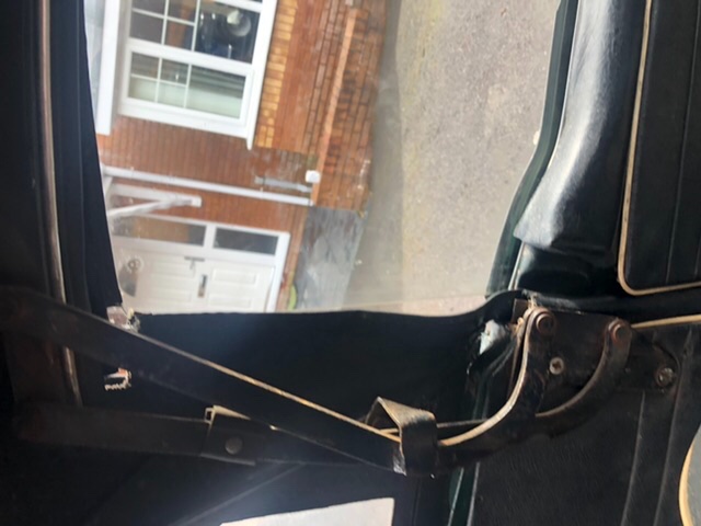

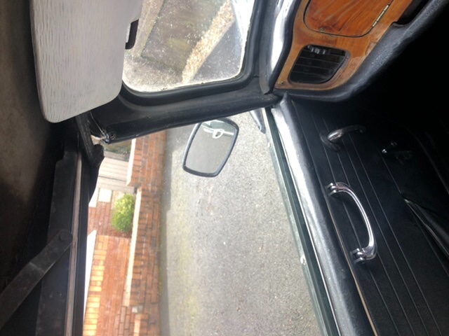

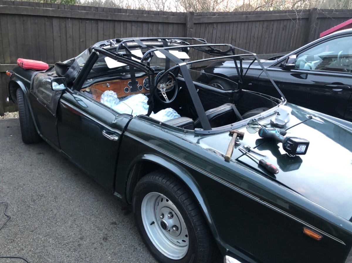

Jase Posted March 13, 2021 Author Report Posted March 13, 2021 Quick question, is this a TR6 hood frame? And what does the white strap do? Don’t seem to have these on my Spitfire soft top. Thanks Quote
Jase Posted March 13, 2021 Author Report Posted March 13, 2021 Finally, out and about, quick refill, food shop and home. Quote
Bfg Posted March 13, 2021 Report Posted March 13, 2021 Looks Great Jase, And I do like the wheel hubs. Can I have a set of 4A badges please as I'm likewise going back to pressed steel wheels. I'm told the TR6 hood has velcro on its side rails and I guess rubber seals, rather than the fabric coming down beyond the door glass. Your's looks much the same as mine, which I am told is TR6. But what and where is the white strap you are talking of ? Pete. Quote
Jase Posted March 13, 2021 Author Report Posted March 13, 2021 (edited) Hi Pete, PM me your adress and I’ll sort out a set for you. I have a pair of these on the inside: although I guess mine are no longer white Edited March 13, 2021 by Jase Quote
stuart Posted March 13, 2021 Report Posted March 13, 2021 Yes you actually have a TR5 hood frame. The straps are the webbings that are a fitment of all TR hood frames. Stuart. Quote
Jase Posted March 13, 2021 Author Report Posted March 13, 2021 (edited) Thanks Stuart, I need to replace this hood now, was wondering whether just to wait for the backlight and surrey but as I'm planning on painting the car a different colour (eventually) thought I would go with a new black mohair hood. At least that will go with any colour. I can confidently order this now from Don's hoods Cheers Jason Edited March 13, 2021 by Jase Quote
Bfg Posted March 13, 2021 Report Posted March 13, 2021 (edited) Black Mohair looks fantastic when new, but be warned it does fade if left out in the sun for much of the time, and they do hold dust very much more. The mohair tonneau cover on my car (not a TR) was used very much more than the hood, and it looked pretty faded and scruffy after three or four years. The hood lasted very much better ..but then it was rarely used in sunshine. Dust and sap are much easier to wipe off vinyl. That wouldn't stop me from buying Mohair again, but it may be a factor to you depending on where you might normally park the car. A half (car) cover over the hood and glass ought to protect it though. Pete. Edited March 13, 2021 by Bfg Quote
trchris Posted March 13, 2021 Report Posted March 13, 2021 Hi Jase Go along with Pete but add they are prone to shrinking also Chris Quote
Jase Posted March 13, 2021 Author Report Posted March 13, 2021 Thanks both, maybe worth going for the superior pvc instead. I have a mohair on another car which is always garaged and that can tend to leave creases in the hood when folded. I'm aiming to fit a mohair surrey in a few years so may go for the easier option. Thanks. Quote

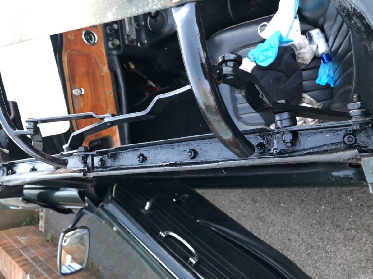

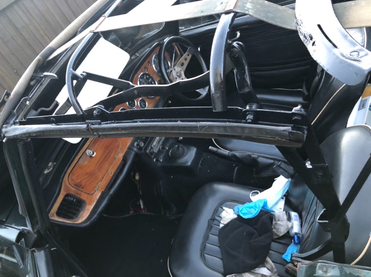

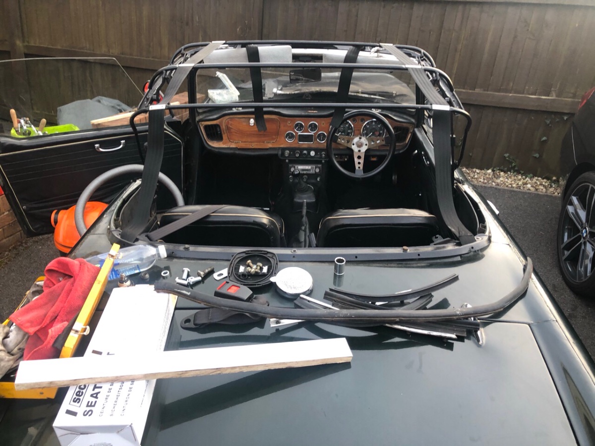

Jase Posted March 18, 2021 Author Report Posted March 18, 2021 (edited) Making progress Edited March 18, 2021 by Jase Quote
Efuentes Posted March 19, 2021 Report Posted March 19, 2021 The straps in my hood broke a couple of months ago. Their role seems to be to keep in position the arch just above the transparent “window”, as without them it goes a bit low and pushes on the transparent plastic rather than on the vinyl. I am replacing with normal straps that you can buy off eBay and will buy in black or grey (I never liked the white straps, they look like bandages and get dirty very easily) Quote
stuart Posted March 19, 2021 Report Posted March 19, 2021 11 hours ago, Jase said: Making progress You do really need to make sure you have the roof bars in the correct place to match the seams and also the internal pockets on the hood before actually affix the webbing. Stuart. Quote
Jase Posted March 19, 2021 Author Report Posted March 19, 2021 (edited) 1 hour ago, stuart said: You do really need to make sure you have the roof bars in the correct place to match the seams and also the internal pockets on the hood before actually affix the webbing. Stuart. I checked all of that, just waiting for the paint to dry. The TR6 video was quite useful, wouldn't have known otherwise. Edited March 19, 2021 by Jase Quote
Z320 Posted March 20, 2021 Report Posted March 20, 2021 it's your TR, but allow me to post here: the tools laying on the car make me creep Quote
Jase Posted March 20, 2021 Author Report Posted March 20, 2021 7 minutes ago, Z320 said: it's your TR, but allow me to post here: the tools laying on the car make me creep I know, working car, needs bodywork and once that has been done this won't happen. However, I do love the car as it is, whilst it is precious to me, it's not that precious not to have tools all over it Quote

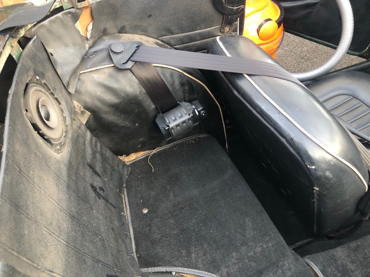

Jase Posted March 24, 2021 Author Report Posted March 24, 2021 (edited) New seat belts and new hood arriving tomorrow. Hope you all like the patina - 40 years of use Edited March 24, 2021 by Jase Quote
