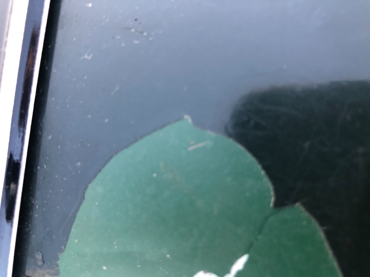

Bfg Posted March 25, 2021 Report Posted March 25, 2021 22 hours ago, Jase said: Hope you all like the patina - 40 years of use Only 40 years ? I've seen and much admired patina ..and I've seen cars so beautifully restored that they have absolutely no patina and the owner is too frightened to use it to go to a supermarket or even to leave it unguarded for ten minutes in a show of classic cars. All in all - yours could be tidied and refastened ..then it ain't so bad ..for an Englishman born in Germany Quote
Jase Posted March 25, 2021 Author Report Posted March 25, 2021 13 minutes ago, Bfg said: Only 40 years ? I've seen and much admired patina ..and I've seen cars so beautifully restored that they have absolutely no patina and the owner is too frightened to use it to go to a supermarket or even to leave it unguarded for ten minutes in a show of classic cars. All in all - yours could be tidied and refastened ..then it ain't so bad ..for an Englishman born in Germany Well I did clean it up today and popped some back to black on it My plan is to start picking up the interior at shows over the next few months (hopefully). I'm going for a full colour change on the car so fitting the interior needs to wait until I've finished. Still quite cold here in Wales so I've ordered a fan heater and will put that inside the car along with a heat gun and that should do it - I hope. Quote

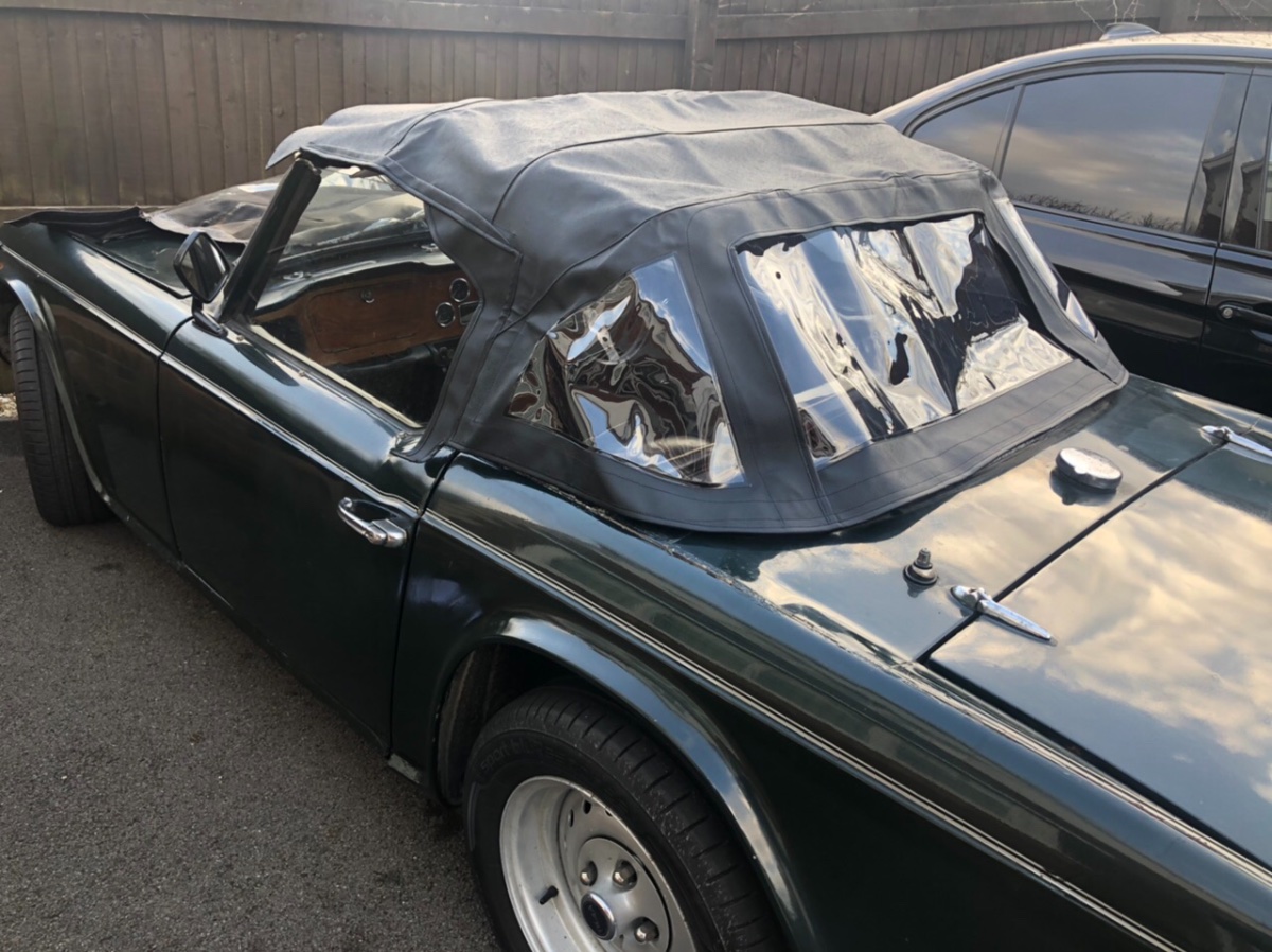

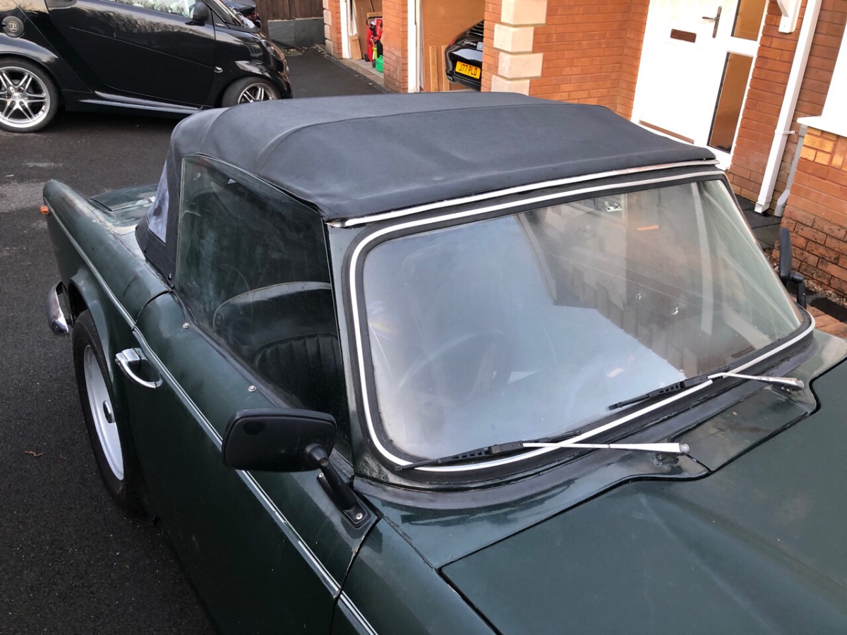

Jase Posted March 29, 2021 Author Report Posted March 29, 2021 (edited) Quite pleased with the TR6 soft top. Just ordered some black plastic poppers for the back of the hood and seals for the windscreen to windows and it’s all done. Very impressed with Don’s hoods. Edited March 29, 2021 by Jase Quote
Z320 Posted March 30, 2021 Report Posted March 30, 2021 Well done, not critics but allow me to tell you: from the distance your window seems to be to high up to me. And the aluminum cover on top of your window frame is from a TR4. You own "a all models" hood hybrid Quote
Jase Posted March 30, 2021 Author Report Posted March 30, 2021 12 hours ago, Z320 said: Well done, not critics but allow me to tell you: from the distance your window seems to be to high up to me. And the aluminum cover on top of your window frame is from a TR4. You own "a all models" hood hybrid I think I need to adjust the window slightly, seemed to be fine with the 4A hood but that should be an easy fix. The aluminium strip is a TR5 strip, the screen is from a 5 and the slots are in the correct place for a Tr5/6 soft top. Thanks for your thoughts though. Quote
stuart Posted March 31, 2021 Report Posted March 31, 2021 12 hours ago, Jase said: I think I need to adjust the window slightly, seemed to be fine with the 4A hood but that should be an easy fix. The aluminium strip is a TR5 strip, the screen is from a 5 and the slots are in the correct place for a Tr5/6 soft top. Thanks for your thoughts though. As I mentioned previously the ally capping is actually from a Surrey topped car hence why it protrudes forward slightly from the screen frame and why you had to adjust the catches to get it to pull down correctly. Stuart. Quote
Jase Posted March 31, 2021 Author Report Posted March 31, 2021 Thanks Stuart, missed that, probably assumed that the capping was the same on TR5 and 6 frames, is it different for a soft top? Guessing this will be okay when I eventually fit a surrey? Quote

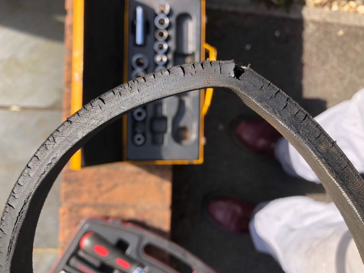

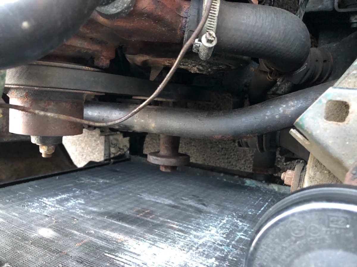

Jase Posted April 2, 2021 Author Report Posted April 2, 2021 New fan belt tomorrow, hoping just jacking up one side of the engine will give me enough space to swap this all out. Quote
trchris Posted April 2, 2021 Report Posted April 2, 2021 Hi Jase noticed no fan are you running an electric? if so why not get rid of the fan extension? Chris Quote
Jase Posted April 2, 2021 Author Report Posted April 2, 2021 12 minutes ago, trchris said: Hi Jase noticed no fan are you running an electric? if so why not get rid of the fan extension? Chris Hi Chris, yes I have an electric fan. Can I just unbolt this part? That would make life very easy. I thought it was needed as a 'harmoniser', think that is correct? Quote
Lebro Posted April 2, 2021 Report Posted April 2, 2021 Putting the steering on full lock will give you more space to squeeze the fan belt through the gap. Bob. Quote
stillp Posted April 2, 2021 Report Posted April 2, 2021 5 minutes ago, Lebro said: Putting the steering on full lock will give you more space to squeeze the fan belt through the gap. Bob. How? That won't move the engine or the cross tube. Pete Quote
Lebro Posted April 2, 2021 Report Posted April 2, 2021 Quite right, I was thinking TR3 & the steering center tie rod. Must try harder ! Bob. Quote
Geko Posted April 3, 2021 Report Posted April 3, 2021 Might be the shot angle but the engine mount looks stretched forward. I would investigate the condition of the gearbox mount. Quote
Jase Posted April 3, 2021 Author Report Posted April 3, 2021 Thanks, will check. Probably like everything else on the car it could do with being renewed. Just waiting for a car lift and I'll make a start on all of these more challenging jobs. Quote
trchris Posted April 3, 2021 Report Posted April 3, 2021 Hi Jase yep just remove its only an extension for the fan you will need a bolt kit from Moss I think about £25 Chris Quote
Lebro Posted April 3, 2021 Report Posted April 3, 2021 Better still change to narrow fan belt & pulleys. Bob Quote

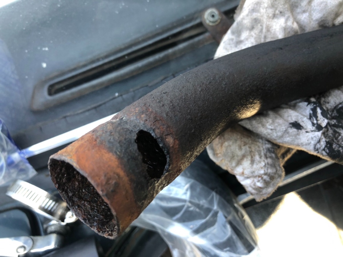

Jase Posted April 3, 2021 Author Report Posted April 3, 2021 Well, spot on with the engine mounts, onejust popped so ordered a new set, changing all of the hoses at the moment and a new peyrol pipe kit on the way to battle the old ethanol. Quote

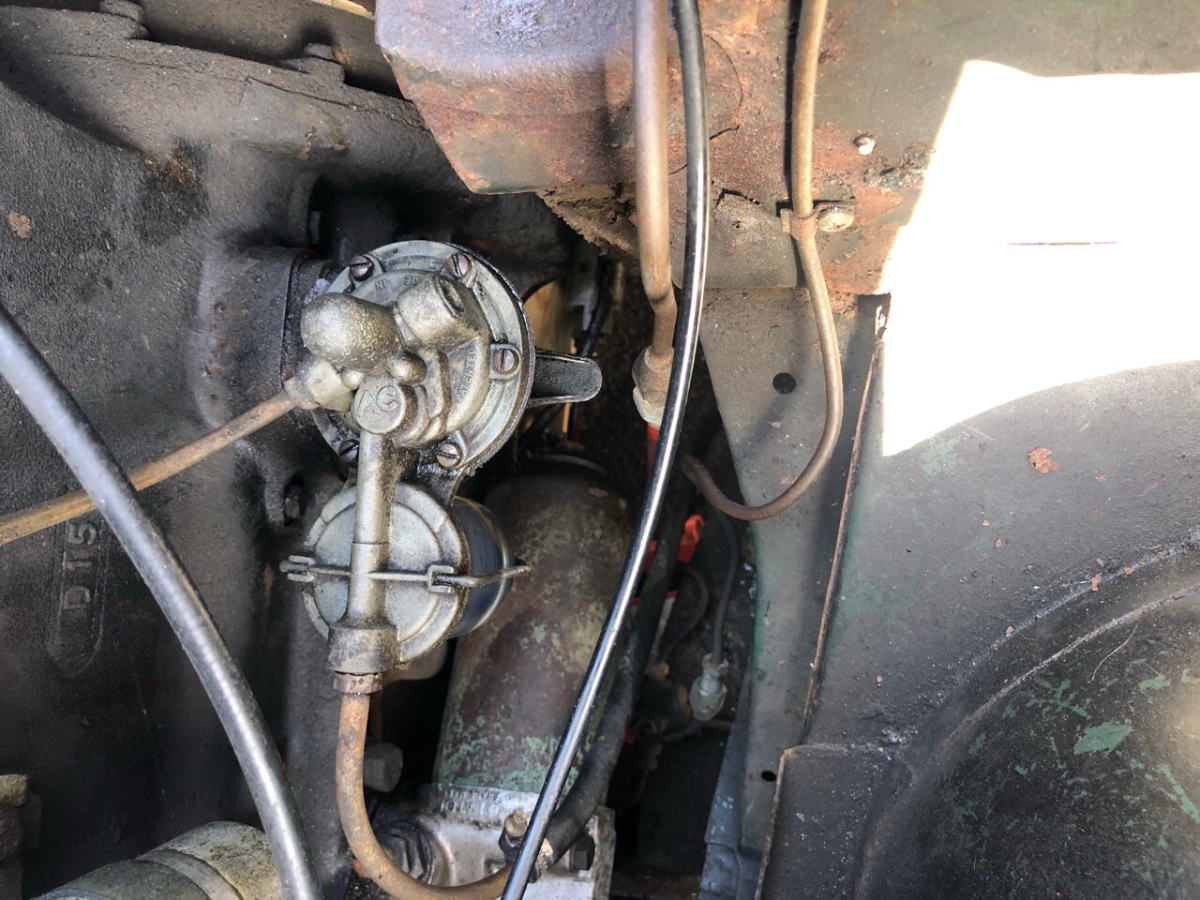

Jase Posted April 3, 2021 Author Report Posted April 3, 2021 Fitting a spare fan belt at the same time. Also going to overhaul the petrol pump just to make sure everything is tip top. Quote

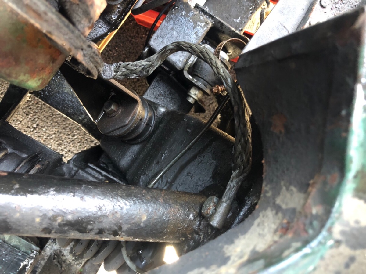

stuart Posted April 3, 2021 Report Posted April 3, 2021 26 minutes ago, Jase said: Fitting a spare fan belt at the same time. Also going to overhaul the petrol pump just to make sure everything is tip top. Wheres your oil pressure gauge pipe? That brake pipe join down by the chassis looks very suspect too. Stuart. Stuart. Quote
Jase Posted April 3, 2021 Author Report Posted April 3, 2021 (edited) Well spotted Stuart, looks like the pipe coming from the master cylinder was too short so they made up a joining piece. On the to do list Edited April 4, 2021 by Jase Quote
