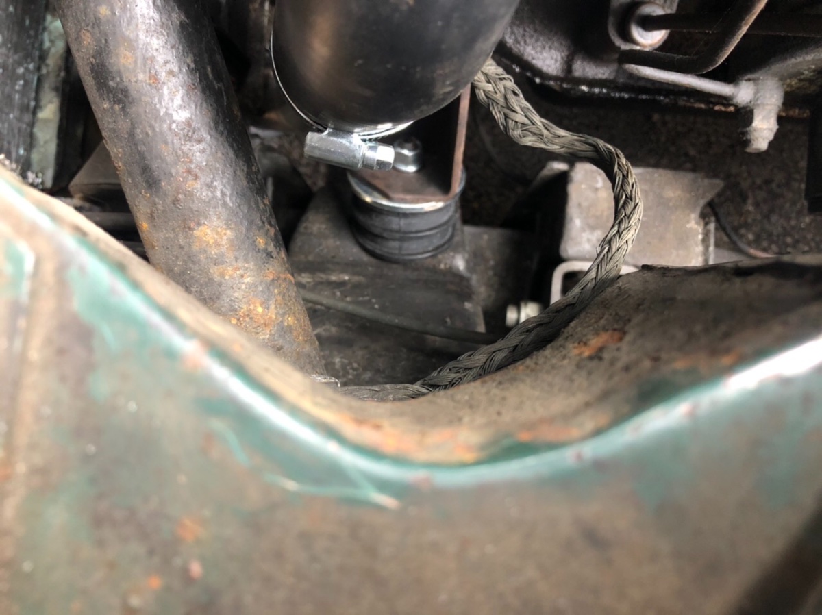

Geko Posted April 3, 2021 Report Posted April 3, 2021 3 hours ago, Jase said: Well, spot on with the engine mounts, onejust popped so ordered a new set, changing all of the hoses at the moment and a new peyrol pipe kit on the way to battle the old ethanol. I suspect you jacked-up the engine without loosening the engine mounts bolts and probably why it popped... Quote

Jase Posted April 3, 2021 Author Report Posted April 3, 2021 2 hours ago, Geko said: I suspect you jacked-up the engine without loosening the engine mounts bolts and probably why it popped... I didn't and I should have but to be honest they look like they need changing like every other rubber pipe on the car. I was going to do it this year anyway Is the engine mount under the carbs as easy to get to as the other side? I haven't investigated that side yet, tooo many jobs to do today Thanks Quote
Bfg Posted April 5, 2021 Report Posted April 5, 2021 On 4/3/2021 at 7:05 PM, Jase said: Is the engine mount under the carbs as easy to get to as the other side? I haven't investigated that side yet, tooo many jobs to do today I've not done it (..yet) but as I cannot even get a camera in there to see what sort of condition it's in.. I'm guess it would be easier to get to from under the car. Quote
stuart Posted April 6, 2021 Report Posted April 6, 2021 17 hours ago, Bfg said: I've not done it (..yet) but as I cannot even get a camera in there to see what sort of condition it's in.. I'm guess it would be easier to get to from under the car. No it wouldnt, its done from the top. Stuart. Quote
Bfg Posted April 6, 2021 Report Posted April 6, 2021 Cheers Stuart. I reckon it's a job I won't be looking forward to doing then. I'm going to get rectangular mounts again. I'm advised Land Rover ones are very similar but have slightly larger studs, and so the chassis holes need to be redrilled for the next size. Easy enough when the engine's out but not something I want to struggle with in-situ. I guess all of the principle suppliers offer appropriate ones, but is there anything I ought to know before ordering or in fitting. Thanks, Pete Quote

stuart Posted April 6, 2021 Report Posted April 6, 2021 35 minutes ago, Bfg said: Cheers Stuart. I reckon it's a job I won't be looking forward to doing then. I'm going to get rectangular mounts again. I'm advised Land Rover ones are very similar but have slightly larger studs, and so the chassis holes need to be redrilled for the next size. Easy enough when the engine's out but not something I want to struggle with in-situ. I guess all of the principle suppliers offer appropriate ones, but is there anything I ought to know before ordering or in fitting. Thanks, Pete Theyre a straight swap no drilling required IIRC. Stuart. Quote
stillp Posted April 6, 2021 Report Posted April 6, 2021 4 hours ago, Bfg said: I'm advised Land Rover ones are very similar but have slightly larger studs, and so the chassis holes need to be redrilled for the next size. 8mm instead of the original 5/16, so not a problem, but you'll need to change the nuts of course. Pete Quote

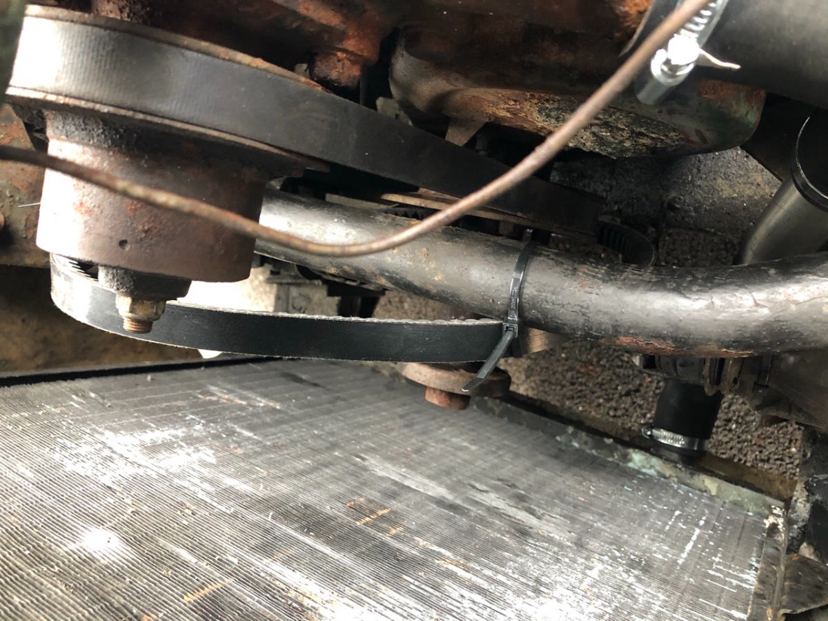

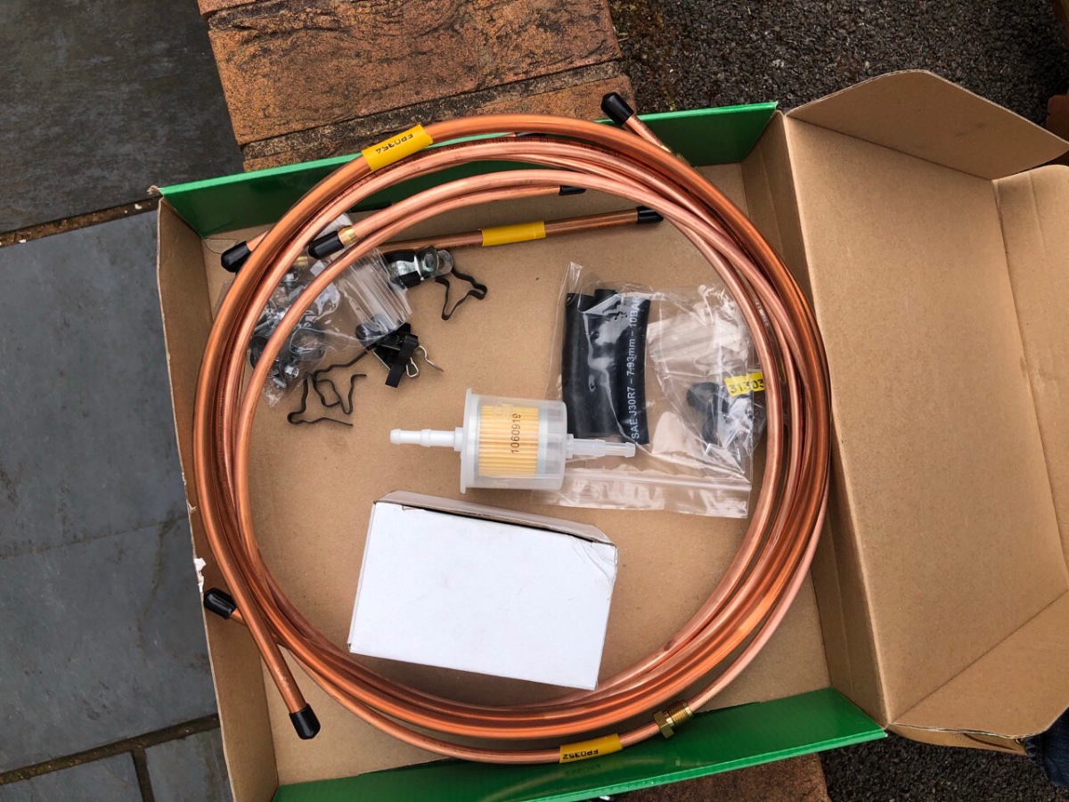

Jase Posted April 7, 2021 Author Report Posted April 7, 2021 (edited) all my goodies arrived today, going to wait for a warm day before I fit the petrol pipes and also less fuel in the tank, hoping that when I jack her up on the side it won’t all run out. Question, if you do this where do you secure your spare fan belt? Engine mounts and rad hoses fitted today, water test tomorrow. Edited April 7, 2021 by Jase Quote
Geko Posted April 7, 2021 Report Posted April 7, 2021 (edited) 12 hours ago, Jase said: Question, if you do this where do you secure your spare fan belt? A bit iconoclastic but my emergency stretchable fan belt was... in the boot. Edited April 8, 2021 by Geko Quote

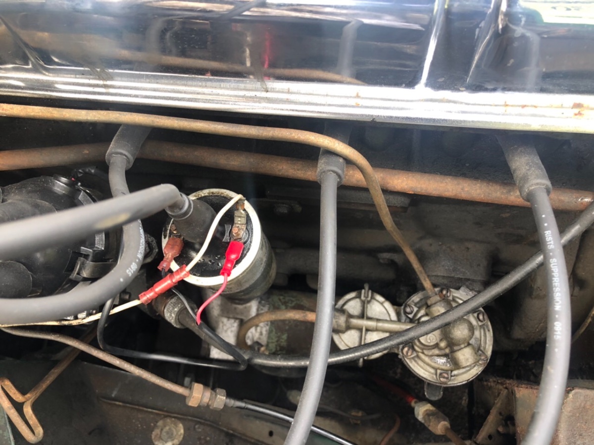

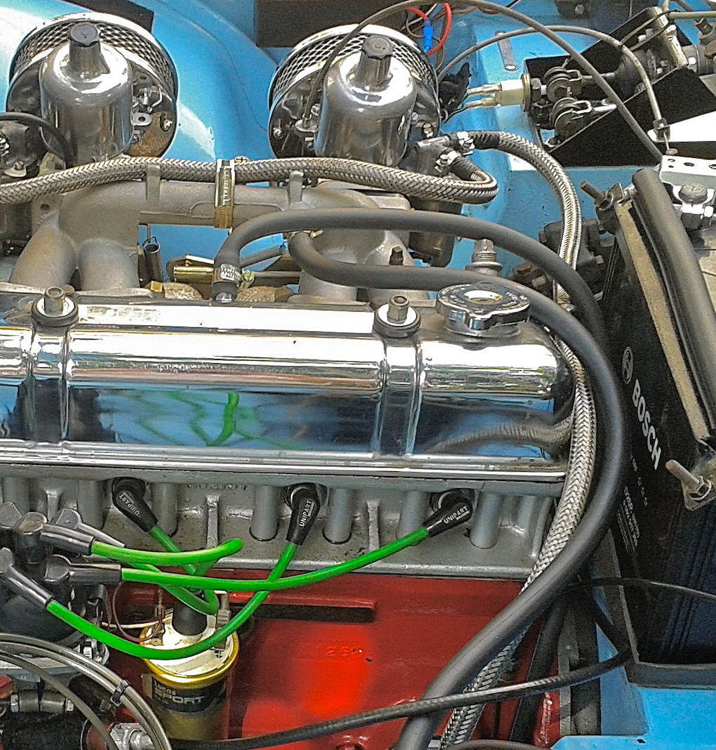

Jase Posted April 8, 2021 Author Report Posted April 8, 2021 Is this the correct route for a petrol pipe? Seems to be fouling the ignition leads. Thanks Quote
Lebro Posted April 8, 2021 Report Posted April 8, 2021 Should be a tad higher I would say. 90° plug caps would sort that out. Bob. Quote
stuart Posted April 8, 2021 Report Posted April 8, 2021 60 degree plug caps would help. Stuart. Quote
Jase Posted April 8, 2021 Author Report Posted April 8, 2021 Thanks Bob, good idea, will pick up some new plug leads shortly. Thanks Quote
Jase Posted April 8, 2021 Author Report Posted April 8, 2021 Any tips for bending the fuel pipe neatly? Thanks Quote
mrehke Posted April 8, 2021 Report Posted April 8, 2021 17 minutes ago, Jase said: Any tips for bending the fuel pipe neatly? Thanks Jase - Try something like this - https://www.frost.co.uk/brake-pipe-and-tube-bender/ - other pipe benders are available too... Mark Quote
BRENDA1 Posted April 8, 2021 Report Posted April 8, 2021 Mine is just a bit higher than yours. Mike Redrose Group Quote
Geko Posted April 8, 2021 Report Posted April 8, 2021 Or re-routing the fuel line (flexible) behind the engine swap the lids of the fuel bowls if you have have SUs and plug the fuel inlet on the rear carb. Quote

RobTR3 Posted April 9, 2021 Report Posted April 9, 2021 On 4/6/2021 at 1:50 PM, Bfg said: Cheers Stuart. I reckon it's a job I won't be looking forward to doing then. I'm going to get rectangular mounts again. I'm advised Land Rover ones are very similar but have slightly larger studs, and so the chassis holes need to be redrilled for the next size. Easy enough when the engine's out but not something I want to struggle with in-situ. I guess all of the principle suppliers offer appropriate ones, but is there anything I ought to know before ordering or in fitting. Thanks, Pete Pete Don't buy the updated engine mounts, they are too harsh for road use. I tried them and immediately swapped them out for standard mounts. There is too much resonance which will be very noticeable compared with well worn and softened rubber on the old mounts. Access is mainly from above, but you can get at the lower steady bracket from below (TR3) for additional access. I also removed the dynamo and disconnected the hose/steel pipe on the nearside from the water pump housing and pushed it towards the water pump clear of nearside mount. Both give you a better chance to get spanner access. Rob Quote
