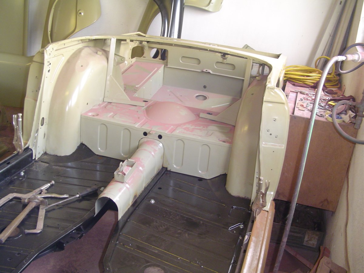

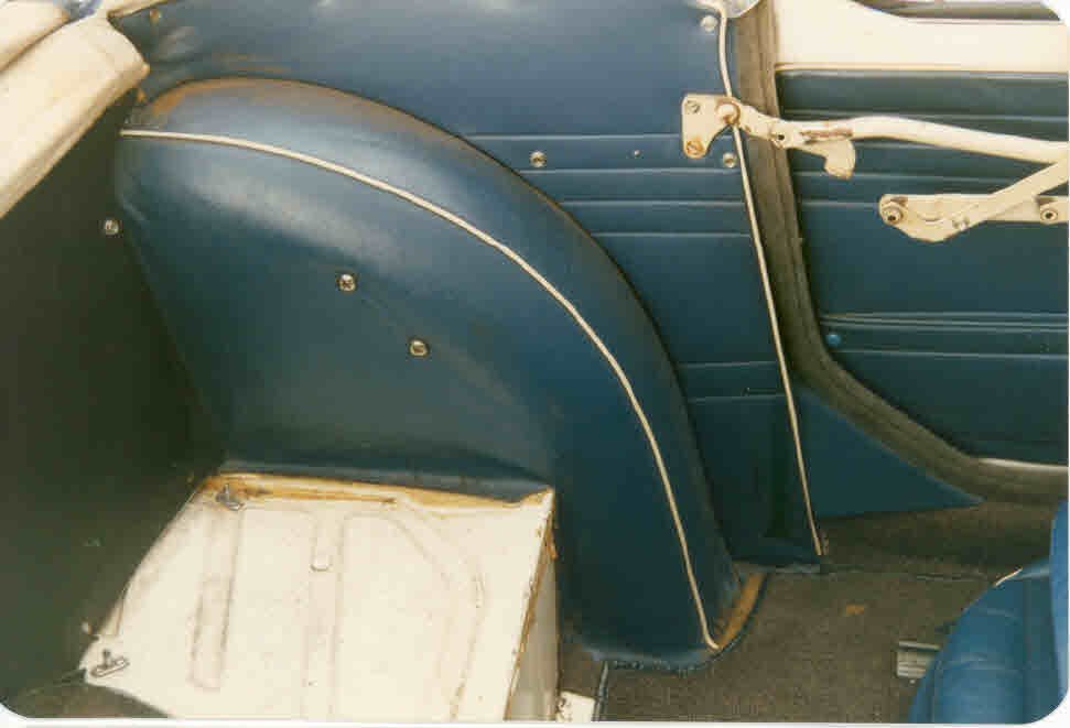

stuart Posted April 26, 2021 Report Posted April 26, 2021 5 minutes ago, Jase said: I'm guessing a TR6 would have had inertia seatbelts? How was this problem resolved? The top of the rear arch has a slight dish down where the belt mount sits Stuart. Quote
Jase Posted April 26, 2021 Author Report Posted April 26, 2021 Thanks Stuart, that's a nice touch. I'm guessing the TR5 didn't have inertia belts? Quote

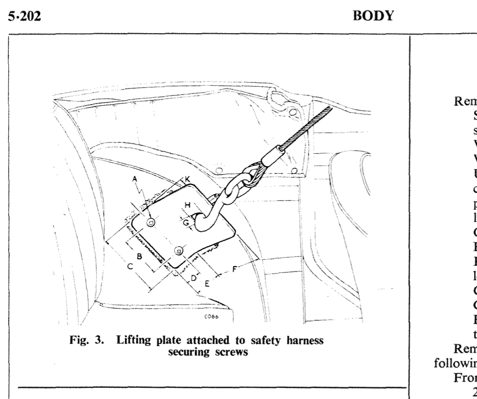

Geko Posted April 26, 2021 Report Posted April 26, 2021 I had a look at the WSM TR4 and indeed it shows the lifting points on the side of the wheel arches but that's 1962. Is that to say that there was no holes for seat belts at the time and that these were added later on TR4A body specifically for the seats belts? My 4A never had 3 points seat belts until my ownership but the holes were there but covered by the trim, so my assumption was that these were the actual new lifting points. Quote
stuart Posted April 26, 2021 Report Posted April 26, 2021 18 minutes ago, Geko said: I had a look at the WSM TR4 and indeed it shows the lifting points on the side of the wheel arches but that's 1962. Is that to say that there was no holes for seat belts at the time and that these were added later on TR4A body specifically for the seats belts? My 4A never had 3 points seat belts until my ownership but the holes were there but covered by the trim, so my assumption was that these were the actual new lifting points. Those two holes in the arch are where the seat belt mounts were on TR4 models Stuart. Quote

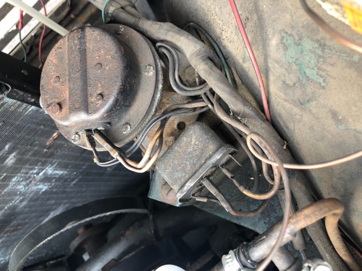

Jase Posted June 6, 2021 Author Report Posted June 6, 2021 Horns, stopped working?? The PO fitted an aftermarket switch just below the steering column, seems to have two wires feeding to it, you can hear the click of the 'current' when you switch it on but no horns. I may well have damaged it whilst trying to reset the tacho. First port of call is to replace the switch, just wanted to check that I'm not missing a wire. Haven't had a chance to look at the wiring diagram yet but is there a fuse box for this I'm thinking Spitfire here so forgive my ignorance, still getting to know this car. Quote
john.r.davies Posted June 6, 2021 Report Posted June 6, 2021 (edited) Electricty doesn't "click", at 12V anyway! It may at 50,000V If there is a click then the switch is operating a relay, which originally was on the bulkhead inside the engine bay. And if that clicks, but no horns then the relay isn't making contact or another fault is present. Out with the multimeter, and follow the volts! JOhn Edited June 6, 2021 by john.r.davies Quote
Jase Posted June 6, 2021 Author Report Posted June 6, 2021 32 minutes ago, john.r.davies said: Electricty doesn't "click", at 12V anyway! It may at 50,000V If there is a click then the switch is operating a relay, which originally was on the bulkhead inside the engine bay. And if that clicks, but no horns then the relay isn't making contact or another fault is present. Out with the multimeter, and follow the volts! JOhn Thanks John, must be the relay as I can definitely hear something, time to dust off the multimeter. Quote
stuart Posted June 7, 2021 Report Posted June 7, 2021 22 hours ago, Jase said: Thanks John, must be the relay as I can definitely hear something, time to dust off the multimeter. On 4a the relay should be down by the right hand horn and there is a fuse next to it. Check that. Stuart. Quote
Jase Posted June 7, 2021 Author Report Posted June 7, 2021 Thanks Stuart, is that the driver's side? Jason Quote
stuart Posted June 7, 2021 Report Posted June 7, 2021 9 minutes ago, Jase said: Thanks Stuart, is that the driver's side? Jason Err yes as your not left hand drive sorry its because I often have left and right hand drive cars in. Stuart. Quote
Jase Posted June 7, 2021 Author Report Posted June 7, 2021 Thanks, I guess I'm so used to nearside or offside. Thanks Quote

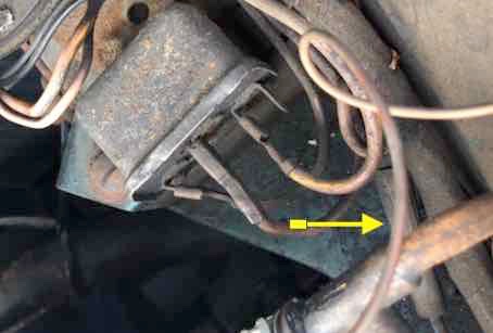

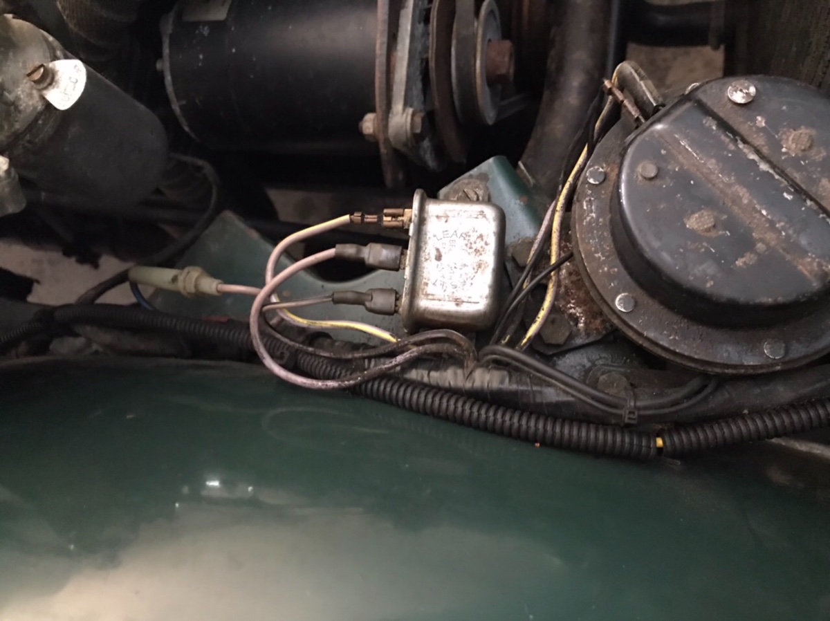

Jase Posted June 24, 2021 Author Report Posted June 24, 2021 Horn woes, so I’m guessing this is the relay? Quote

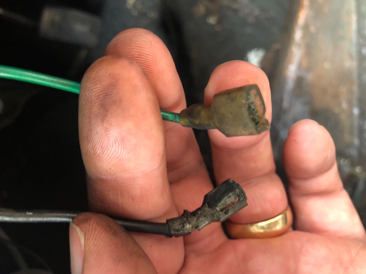

Jase Posted June 24, 2021 Author Report Posted June 24, 2021 The horn was wired to a toggle switch, thought I would dismantle and check. Am I right in thinking if I tap these two wires together I should get a horn? When I do nothing, ignition is switched on. Quote

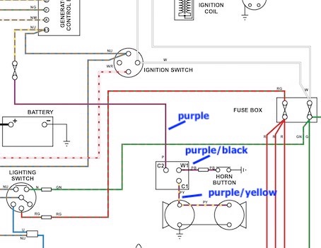

RobH Posted June 24, 2021 Report Posted June 24, 2021 26 minutes ago, Jase said: Am I right in thinking if I tap these two wires together I should get a horn? Who knows if someone has 'been at' the wiring. As standard there is no green wire in the horn circuit. Best to see how it compares with this, and start from there..... Quote
Jase Posted June 24, 2021 Author Report Posted June 24, 2021 Thanks Rob, I can see it goes to a purple bullet connector and it has been earthed to the back of one of the instruments, it was working, I’ve checked connections. I can’t find the inline fuse as per the haynes manual either. Thanks Quote
stuart Posted June 25, 2021 Report Posted June 25, 2021 (edited) 15 hours ago, Jase said: Thanks Rob, I can see it goes to a purple bullet connector and it has been earthed to the back of one of the instruments, it was working, I’ve checked connections. I can’t find the inline fuse as per the haynes manual either. Thanks Just been through this with customers car as I had all the column out to rebush. You should have purple from the slip ring under the wheel down the cable tray and then to purple under the dash out of the loom, under the horn push you should have the pencil (part number 53 here Horn pencil ). You need to make sure that the inner column earth works all the way up so it needs an earth off the rack to chassis, then earth jumper wires through each of the rubber donuts (or not if you have TR6 type metal UJ`s) the horn relay is a 3 wire version down by the right hand horn and the fuse for it is right by it looped out of the loom. So when you press the horn push it earths the relay out. The purple at the relay is permanent live. Stuart. Edited June 25, 2021 by stuart Quote

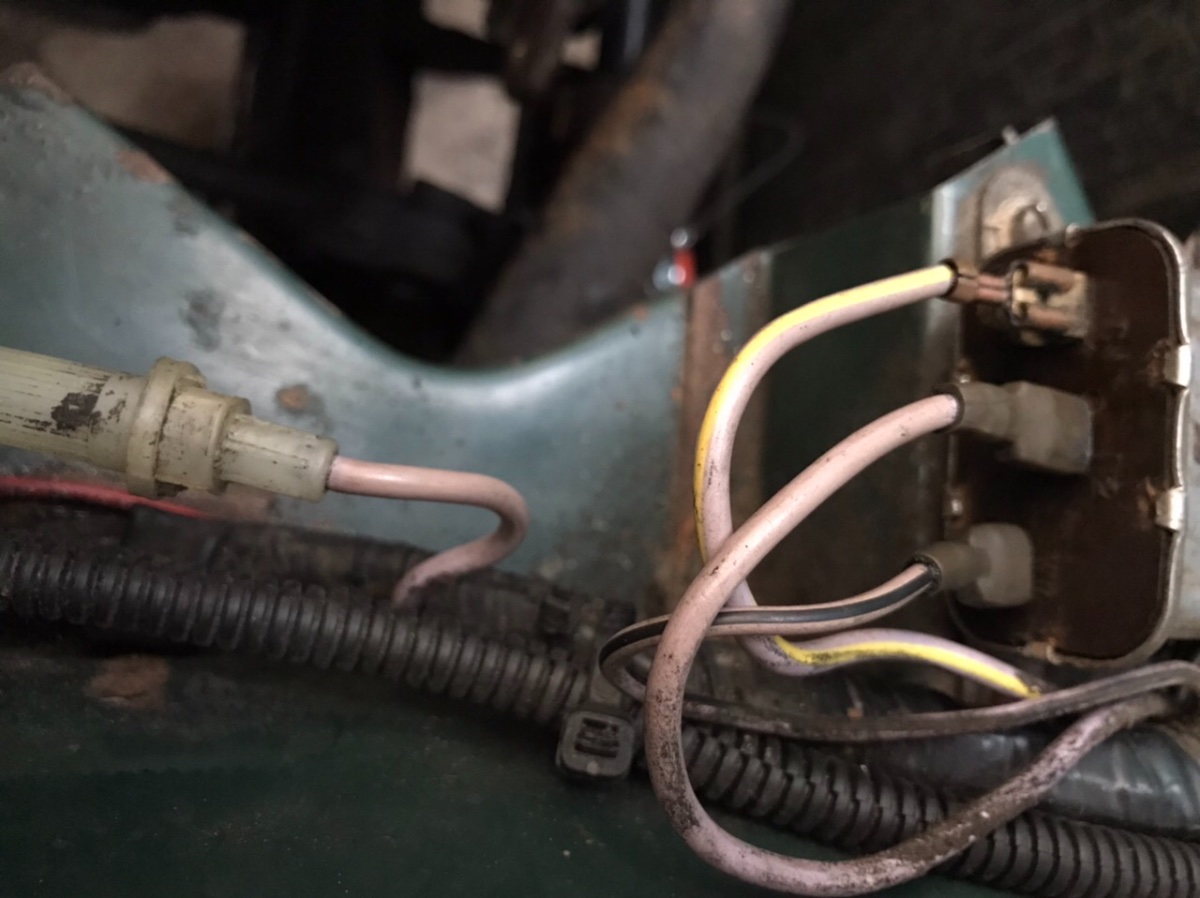

RobH Posted June 25, 2021 Report Posted June 25, 2021 Is that not the fuseholder under the wiring Jase? Quote
Jase Posted June 25, 2021 Author Report Posted June 25, 2021 Thanks both, Stuart, unfortunately the PO has the horn wired to a separate toggle switch below the dashboard. It just stopped working after I reset the odometer, thought I had knocked a wire off, don't think so though. I missed that inline fuse I was looking closer to the fuse box, will change just incase. It could all do with a clean up so next job Thanks Quote
stuart Posted June 25, 2021 Report Posted June 25, 2021 50 minutes ago, Jase said: Thanks both, Stuart, unfortunately the PO has the horn wired to a separate toggle switch below the dashboard. It just stopped working after I reset the odometer, thought I had knocked a wire off, don't think so though. I missed that inline fuse I was looking closer to the fuse box, will change just incase. It could all do with a clean up so next job Thanks Try using a meter to see if your column has an earth through it as thats a good start, take the horn push out and see if the pencil is OK then you could re-instate the horn where it should be though the usual reason for them being on a switch like yours is the earth jumpers up the column are broken. Stuart. Quote
