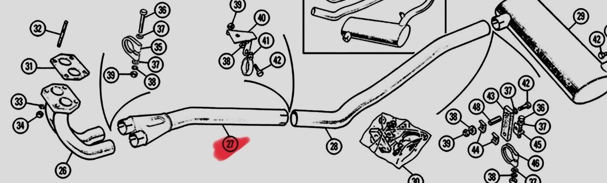

BlueTR3A-5EKT Posted February 8 Report Posted February 8 (edited) 10 hours ago, adriantr4 said: Hello I plan to do something similar: I have acquired a TR4a exhaust manifold and the twin down pipe. I need suggestions to join this to my existing system at the cross point in the chassis of my '4. A brief look on-line shows a generic Y piece - if I bought this could I get an exhaust shop to weld it to a pipe length if I specify it? Or would it be easier to buy the TR4a front Y piece & cut it? Or ....? Anyone have a 4a Y piece that I could have for some cash? Thanks, Adrian I think I have a new mild steel one up in the rafters of the garage. I will touch it and confirm if you are interested. Harmo number SU 1358. Item 27 Edited February 8 by BlueTR3A-5EKT Quote

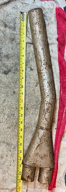

BlueTR3A-5EKT Posted February 8 Report Posted February 8 (edited) 12 hours ago, adriantr4 said: Hello I plan to do something similar: I have acquired a TR4a exhaust manifold and the twin down pipe. I need suggestions to join this to my existing system at the cross point in the chassis of my '4. A brief look on-line shows a generic Y piece - if I bought this could I get an exhaust shop to weld it to a pipe length if I specify it? Or would it be easier to buy the TR4a front Y piece & cut it? Or ....? Anyone have a 4a Y piece that I could have for some cash? Thanks, Adrian I think I have a new mild steel one up in the rafters of the garage. I will touch it and confirm if you are interested. Harmo number SU 1358. Yes I have it. New unused, bit scruffy but not rusted through see photo for its length. By the looks of it about 2” has been cut from the rear end. Yours for £25 including UK mainland postage. pm me your address if you want it. Edited February 8 by BlueTR3A-5EKT Added photo Quote
adriantr4 Posted February 8 Report Posted February 8 Hi. Yes that's exactly it. Shortly after my last post it occurred to me I have part of the solution, my TR4 downpipe that has the slight jog to connect to the next section at the X in the chassis. So, all I need to do is graft the Y section to my original pipe. Easy! (I hope!) My thanks to BlueTR3A-5EKT. Will pm soon. Cheers, Adrian Quote
