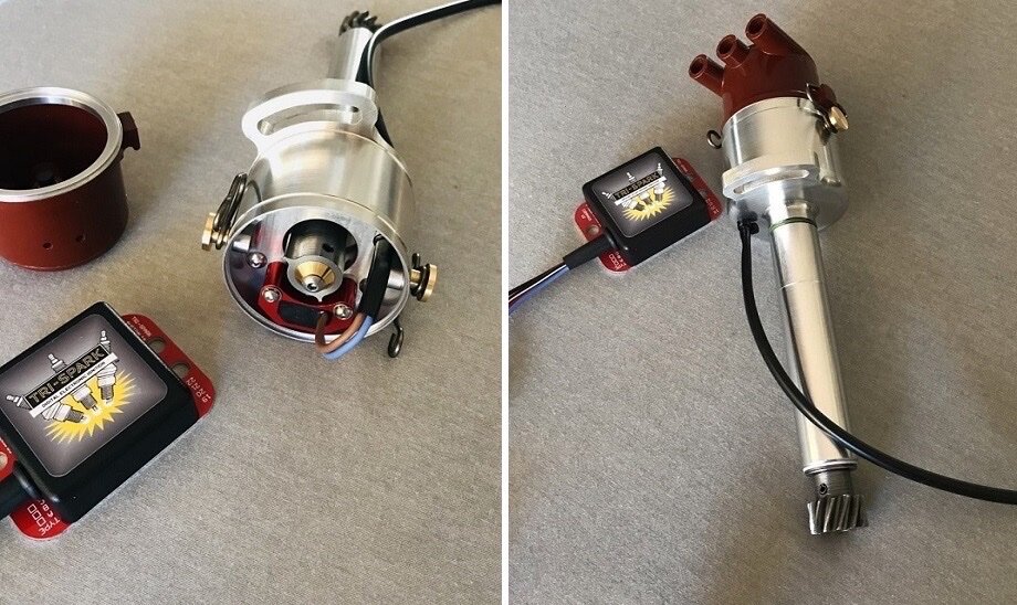

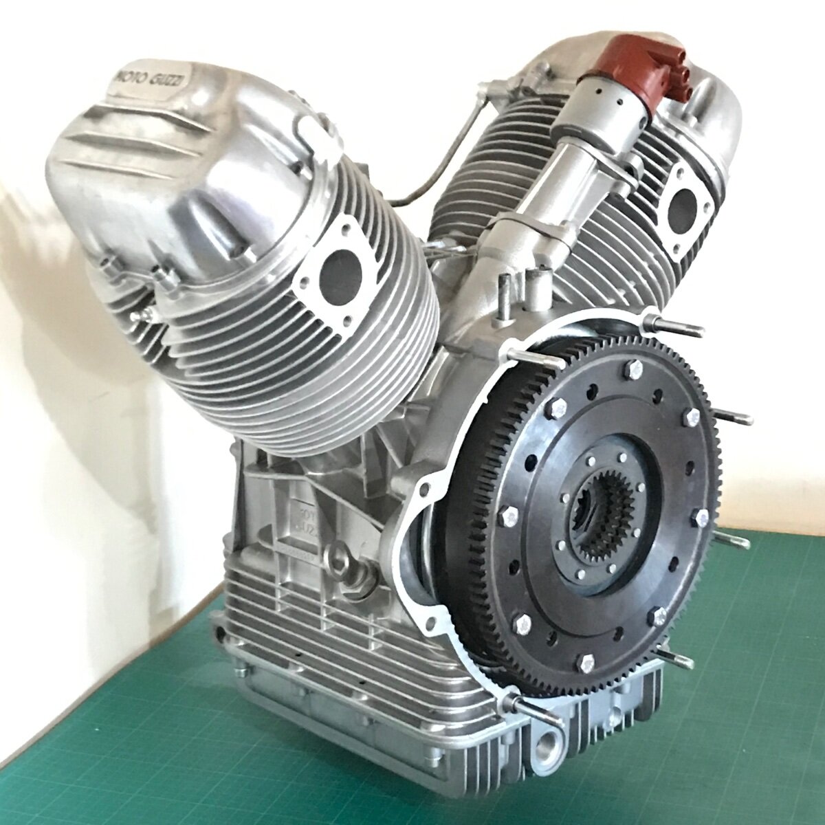

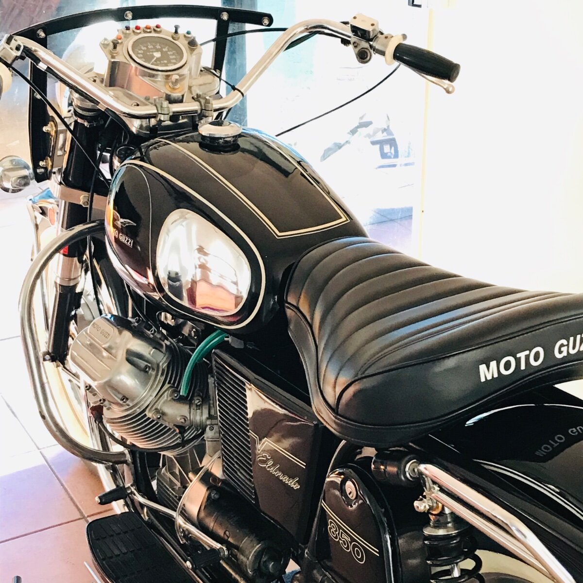

PriceLes Posted April 5 Report Posted April 5 (edited) That Tri-Spark digital ignition was for a dual point Moto Guzzi distributor (Tonti) I have a 1973 Moto Guzzi Eldorado which has a single point distributor and even with a new trigger mounting plate it was was to big to fit inside that distributor so I machined that new body that had a 8 mm bigger inner diameter which allowed the unit to fit (with the new mounting plate) A 3.6 kg bar ended up weighing under 300 grams after machining, a cap was retained so it looked stockish. I will machine a new distributor for the TR4A to suit the Patton Machine ECU controlled distributor internals as per the TBI kit. Edited April 6 by PriceLes Quote

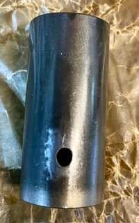

BlueTR3A-5EKT Posted April 13 Report Posted April 13 Tight cam followers. Resolved by polish with scotch brite and stoning the burr around the oil drain hole. Now a nice slip fit. Here is one after stoning but before polishing. All 8 needed the same treatment to get the desired smooth fit. Quote

Chilliman Posted April 13 Report Posted April 13 1 hour ago, BlueTR3A-5EKT said: Tight cam followers. Resolved by polish with scotch brite and stoning the burr around the oil drain hole. Now a nice slip fit. Exactly what I do with new followers to get a nice rotating fit Quote
Ian Vincent Posted April 13 Report Posted April 13 I polished mine by making an expanding mandrel out of a long bolt and a rubber cork and then fitting them in my bench drill, running them at a slow speed and polishing them with 1200 W & D. Rgds Ian Quote

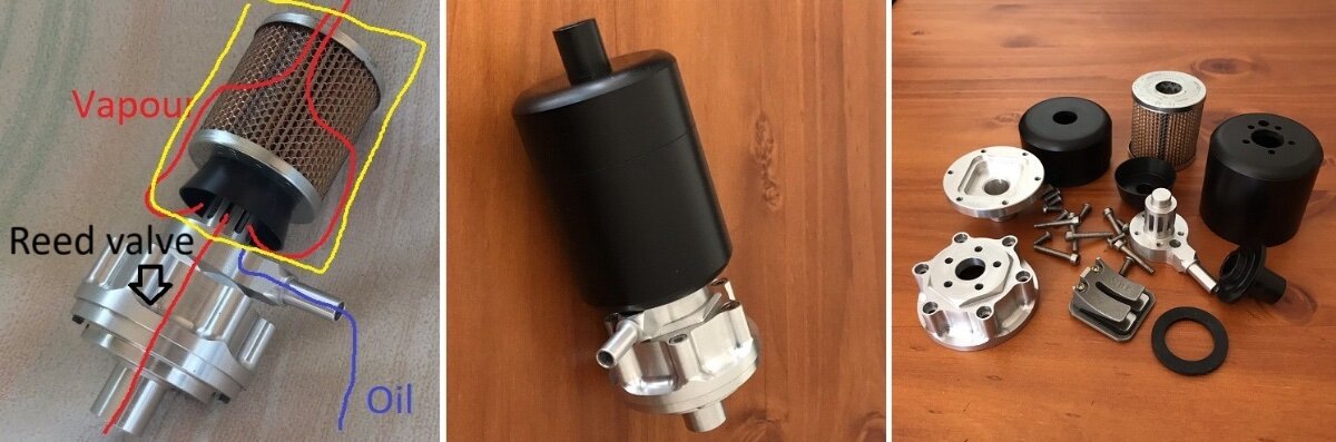

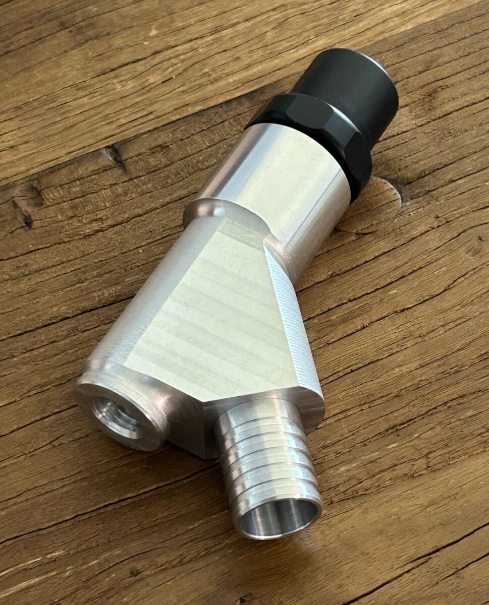

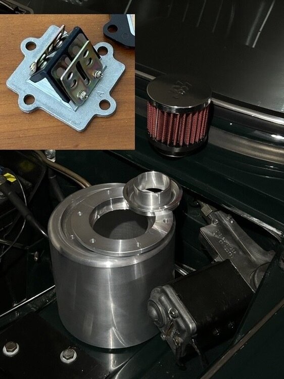

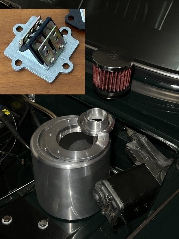

PriceLes Posted April 24 Report Posted April 24 Another 20 days of work completed and the weekend tomorrow. I had cobbled up a reed valve crankcase breather oil separator for the Moto Guzzi so only fair the TR gets something also, fully machined of course. Quote

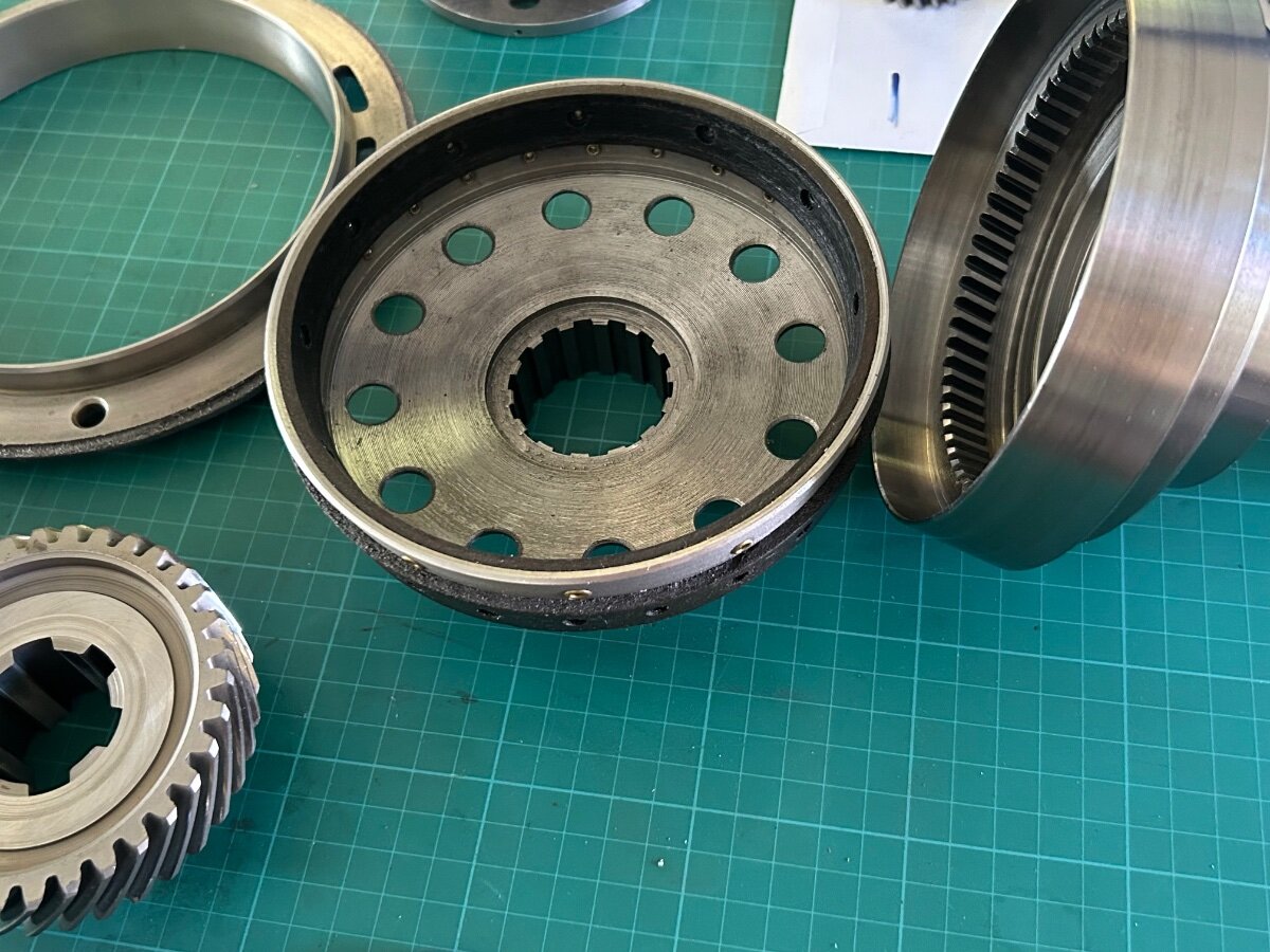

PriceLes Posted April 27 Report Posted April 27 (edited) My sliding drum arrived at Overdrive Repair Services a few days ago so hopefully it will be relined and on its way back to Australia asap. Edited May 7 by PriceLes Quote

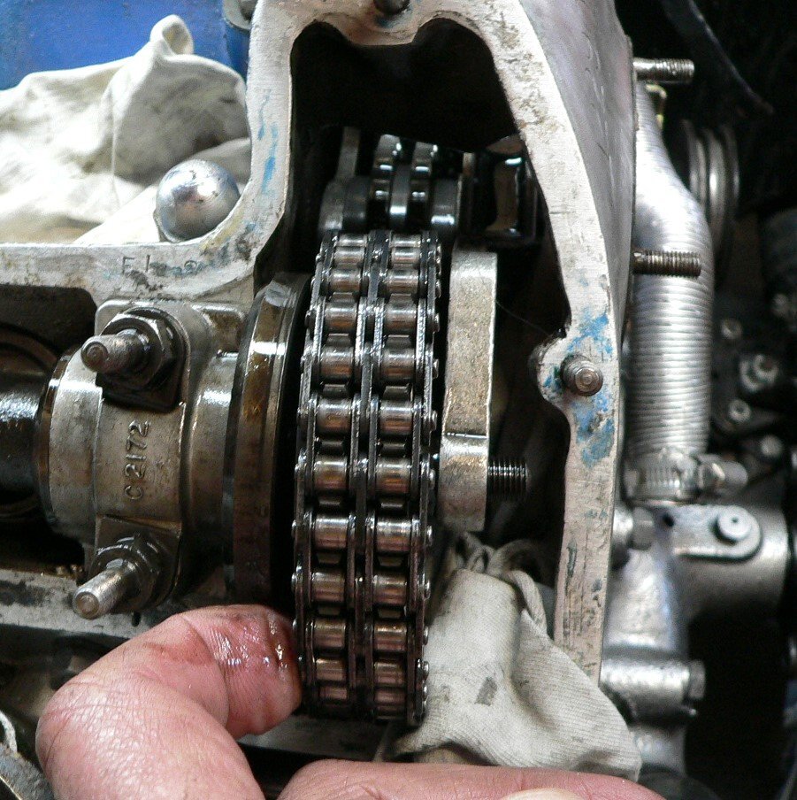

BlueTR3A-5EKT Posted May 9 Report Posted May 9 Using a linked timing chain to set the cam timing sped up the on off on off move link, turn gear malkarky. Just unloop the chain from the cam sprocket and do the adjustment. Ended up with the cam advanced by 3° measured on the crank, so half that on the cam. Measurement 107° instead of 110°, alternative placed the cam at 112 after TDC). We like advanced as the chain will stretch and retard the cam in service. The equal at TDC is within 0.002” lift. Quote
Bfg Posted May 10 Report Posted May 10 23 hours ago, BlueTR3A-5EKT said: Using a linked timing chain to set the cam timing sped up the on off on off move link, turn gear malkarky. Just unloop the chain from the cam sprocket and do the adjustment. Ended up with the cam advanced by 3° measured on the crank, so half that on the cam. Measurement 107° instead of 110°, alternative placed the cam at 112 after TDC). We like advanced as the chain will stretch and retard the cam in service. The equal at TDC is within 0.002” lift. I was talking with a specialist Jaguar engine, gearbox and diff rebuilder last week, about my wanting to replace the upper timing chain on my XK 3.8 (standard camshaft) engine. And that I've heard that it is do-able without removing the cylinder head ..when one uses a new split-linked chain. To which he emphasised his distrust of the split link chains and that, in his 50 years of experience, these chains will go on for hundreds of thousands of miles without issue. My own experience of duplex chains is very limited, from my days riding Norton motorcycles.. to which he replied that these are not motorcycle engines. The 750 & 850 Commando's primary drive was duplex, but I don't recall my ever having seen a split-link one. Possibly it was simply not necessary because their sprockets are easy enough (engine in frame) to remove anyway. I note that well known Jaguar parts suppliers ; David Manners and SNG Barratt, sell split-link timing chains for these engine. The latter say theirs are made by Iwis, Germany. I see also that Reynolds chains similarly offer Duplex chains in this size with split links, so clearly they seem to think it's okay for some applications. There are contributors on the Jag-Lovers forum who have fitted split link chains, but then ask why does someone want to replace their timing chain.? Why change the timing chain on my car ? Well firstly because it was running very loose, and I have no way of knowing whether part of that was because of excessive stretch or poor adjustment. The tappets are x2 greater than they should be (new shims on order to correct these). Even if the engine had been prepared for racing.. they're still excessive ... so I don't really trust what has been done before. ^ the sprocket teeth do not appear to be hooked, and still have some meat at their tips (I don't know how fat they should be), but the chain rollers are well polished from use, which suggests - the chain was not replaced a thousand miles ago when the engine was rebuilt (according to file invoices). I did noted sideways slack in this chain, but then also recognise that some sideways slack is necessary for the sprockets to be pushed forward off the camshafts. What are your thoughts Gents ? Am I just over-thinking the issue and this chain is likely to be good for another 60,000 miles (of normal road use) or would I be prudent to replace the chain, even though that necessitates the use of a split link.? Thanks for your thoughts, Pete Quote
