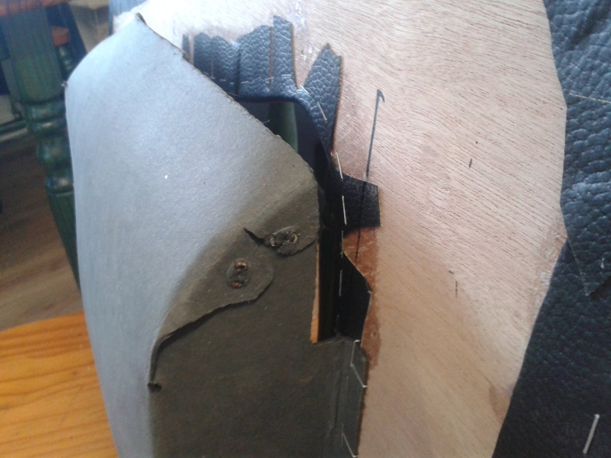

stuart Posted January 7, 2021 Report Posted January 7, 2021 51 minutes ago, Ralph Whitaker said: Thank you both. Todays task is to cover both door cappings. I will post pictures later, unless I make a complete hash of them. Ralph Dont forget you need to allow for the sidescreen bracket Dzeus fastener spring to sit into the backing boards and the door pulls need to go through the pockets. Stuart. Quote
Ralph Whitaker Posted January 7, 2021 Author Report Posted January 7, 2021 4 minutes ago, stuart said: Dont forget you need to allow for the sidescreen bracket Dzeus fastener spring to sit into the backing boards and the door pulls need to go through the pockets. Stuart. Thanks Stuart, I had forgotten about the Dzus fasteners poking through, but I guess once I have determined their location I will be able to cut some clearance holes. The door pockets are open at the top which I think is to allow the cable to drop through. Quote

MilesA Posted January 7, 2021 Report Posted January 7, 2021 1 hour ago, Ralph Whitaker said: The door pockets are open at the top which I think is to allow the cable to drop through. My old pockets had been cut into by the cables when used to open the doors, so I slipped pieces of slit windscreen washer tubing over the new pocket edges to protect them. In practice I use the external handle to open the door except on the rare occasions when the sidescreen is in place. Miles Quote

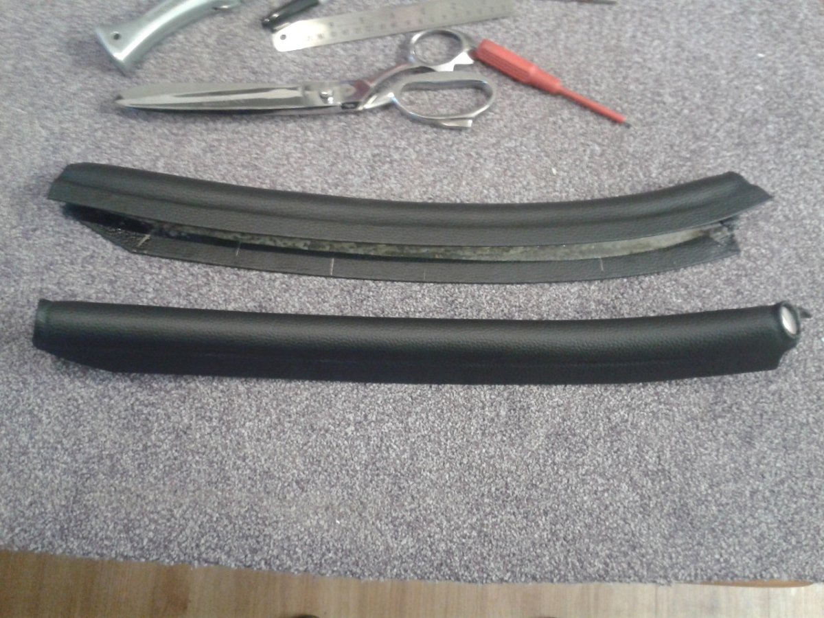

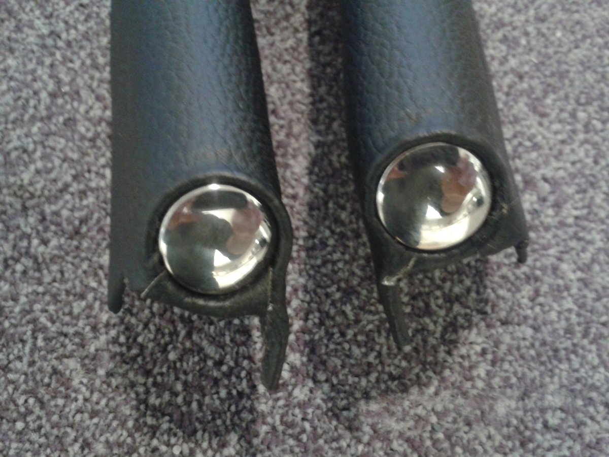

Ralph Whitaker Posted January 7, 2021 Author Report Posted January 7, 2021 5 hours ago, Ralph Whitaker said: Thank you both. Todays task is to cover both door cappings. I will post pictures later, unless I make a complete hash of them. Ralph As promised here are the pics of the finished items. Not my most favorite job I have to say. Great difficulty getting the ends to look right. I tried covering the buttons for the ends and gave up as it made them too big to get in, however I think they may be stainless so I have left them uncovered for now. Running out of jobs now. Need to get the doors painted next when there is some half decent weather. It has been freezing outside for the last couple of days which is why I have been doing trim, inside on the kitchen table, where it is nice and warm. Quote
stuart Posted January 7, 2021 Report Posted January 7, 2021 54 minutes ago, Ralph Whitaker said: As promised here are the pics of the finished items. Not my most favorite job I have to say. Great difficulty getting the ends to look right. I tried covering the buttons for the ends and gave up as it made them too big to get in, however I think they may be stainless so I have left them uncovered for now. Running out of jobs now. Need to get the doors painted next when there is some half decent weather. It has been freezing outside for the last couple of days which is why I have been doing trim, inside on the kitchen table, where it is nice and warm. The buttons arent meant to be covered, its only on TR2 where there is no end caps, they have a circle of material stuck to the ends. Stuart. Quote
Ralph Whitaker Posted January 8, 2021 Author Report Posted January 8, 2021 Oh good, don`t have to worry about those then. Waiting for my boot mat and tank cover now which should be here any day. Ralph.. Quote
roy53 Posted January 8, 2021 Report Posted January 8, 2021 19 hours ago, stuart said: The buttons arent meant to be covered, its only on TR2 where there is no end caps, they have a circle of material stuck to the ends. Stuart. How about TR 3 Stuart ? [ not 3a ] Quote
