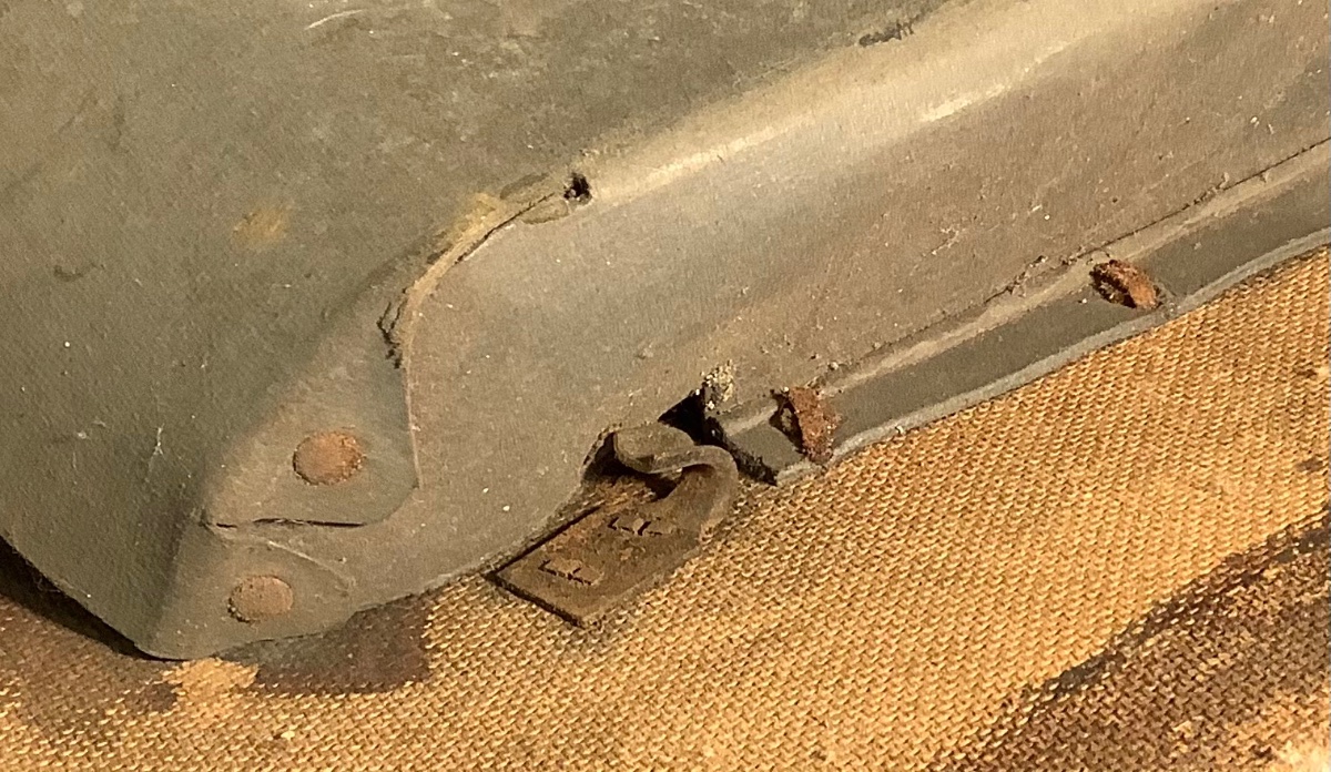

BlueTR3A-5EKT Posted January 8, 2021 Report Posted January 8, 2021 On 1/7/2021 at 12:53 PM, MilesA said: My old pockets had been cut into by the cables when used to open the doors, so I slipped pieces of slit windscreen washer tubing over the new pocket edges to protect them. In practice I use the external handle to open the door except on the rare occasions when the sidescreen is in place. Miles Should be a metal hook riveted to the trim panel inner face to support the cable so it does not cut the door pocket. Peter W Quote

BlueTR3A-5EKT Posted January 8, 2021 Report Posted January 8, 2021 My kit came from Roadster Factory and included the metal hook. Peter W Quote

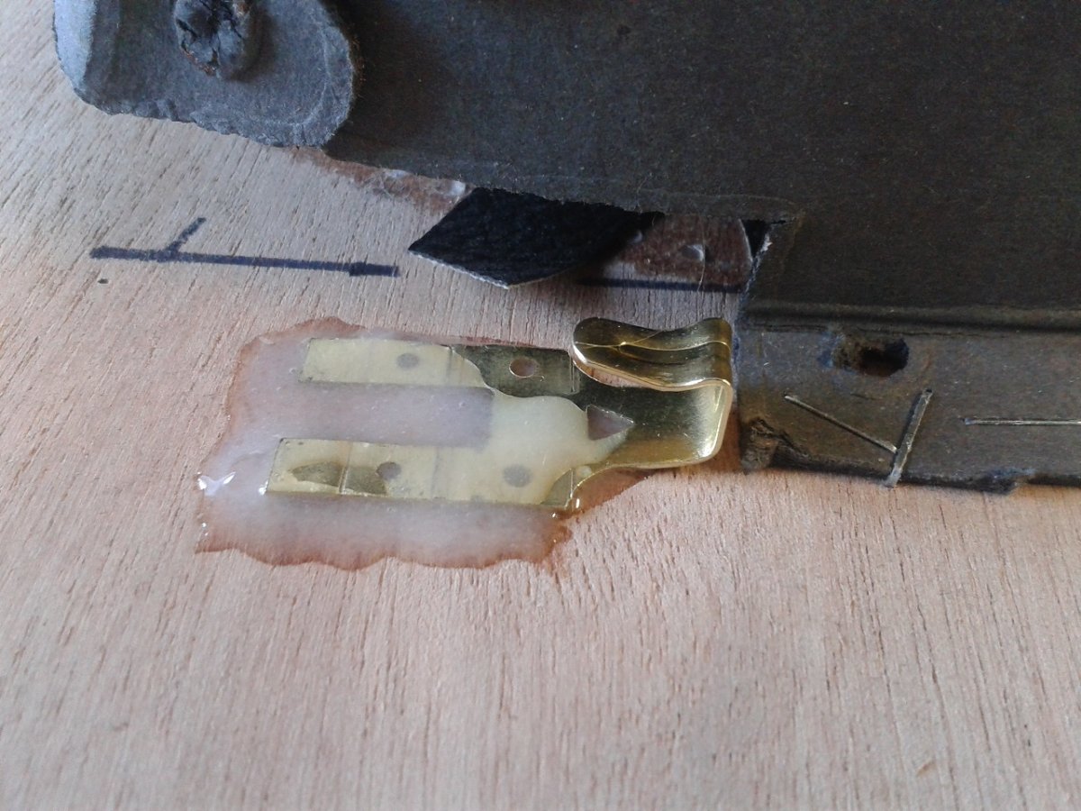

Ralph Whitaker Posted January 9, 2021 Author Report Posted January 9, 2021 Taking note of the mention of the metal hook to prevent the door release cable cutting into the cardboard pocket, I modified a couple of picture hooks and have attached these to the back of the door panels with epoxy glue. I have not seen any originals, so this is my best guess at shape and placing on the panel. Ralph Quote
BlueTR3A-5EKT Posted January 9, 2021 Report Posted January 9, 2021 10 minutes ago, Ralph Whitaker said: Taking note of the mention of the metal hook to prevent the door release cable cutting into the cardboard pocket, I modified a couple of picture hooks and have attached these to the back of the door panels with epoxy glue. I have not seen any originals, so this is my best guess at shape and placing on the panel. Ralph Looks good. here is a photo of my old door casing. Hook is at the back only. Quote

Ralph Whitaker Posted January 9, 2021 Author Report Posted January 9, 2021 2 hours ago, BlueTR3A-5EKT said: Looks good. here is a photo of my old door casing. Hook is at the back only. Not a bad guess then, I got it pretty much spot on by the look of yours, and almost the same shape. Quote

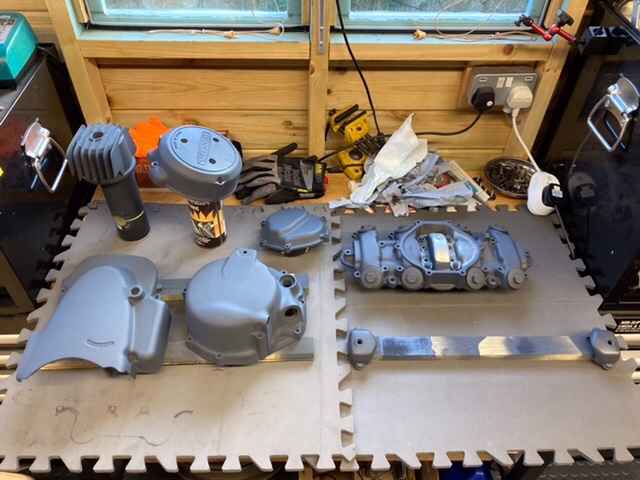

Steves_TR6 Posted January 9, 2021 Report Posted January 9, 2021 I’ve decided to have Scruffy’s engine out for paint, being as lockdown not set to end anytime soon. so today cleaned and primed the removable covers tomorrow will have the engine cases out and bolt them to engine stand for prep and paint Quote
