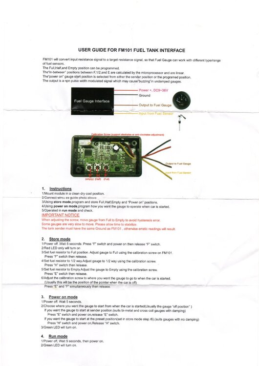

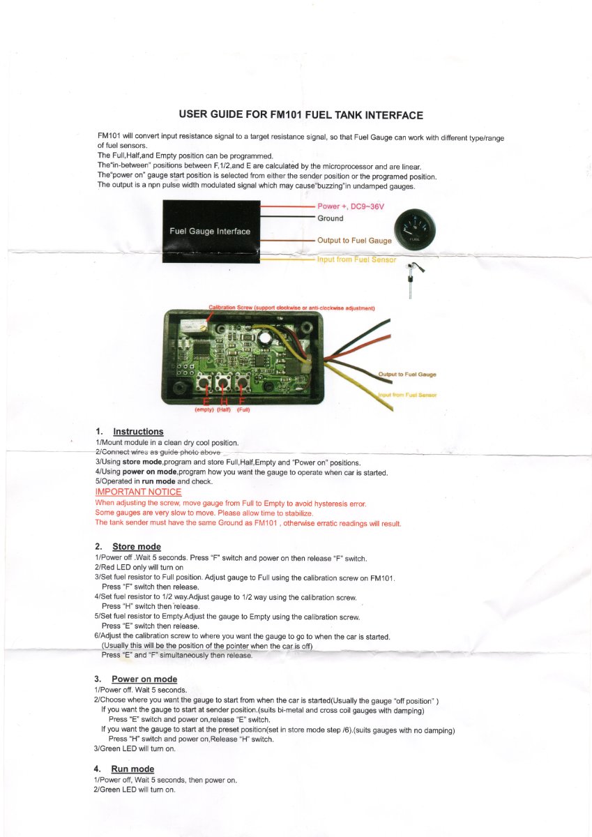

Hi,
 Why fiddle with the gauge and/or sender when you can use one of these?
Cheers,
Iain.
Hi Was this an easy swap over for the TR ? Did you have to replace the gauge as well
