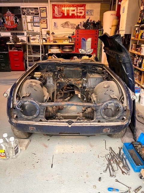

dblenk Posted August 4, 2021 Report Posted August 4, 2021 (edited) Well after 28 years off the road, two tr6 builds, covid, oil price and anything else life has thrown my way its started going great then bang 1969 car bites back those screws into the wings two are rock solid even using my torque driver i have put some liquid spanner and WD40 for overnight soak any useful hints David how do you get the photo to rotate Edited August 4, 2021 by dblenk Quote

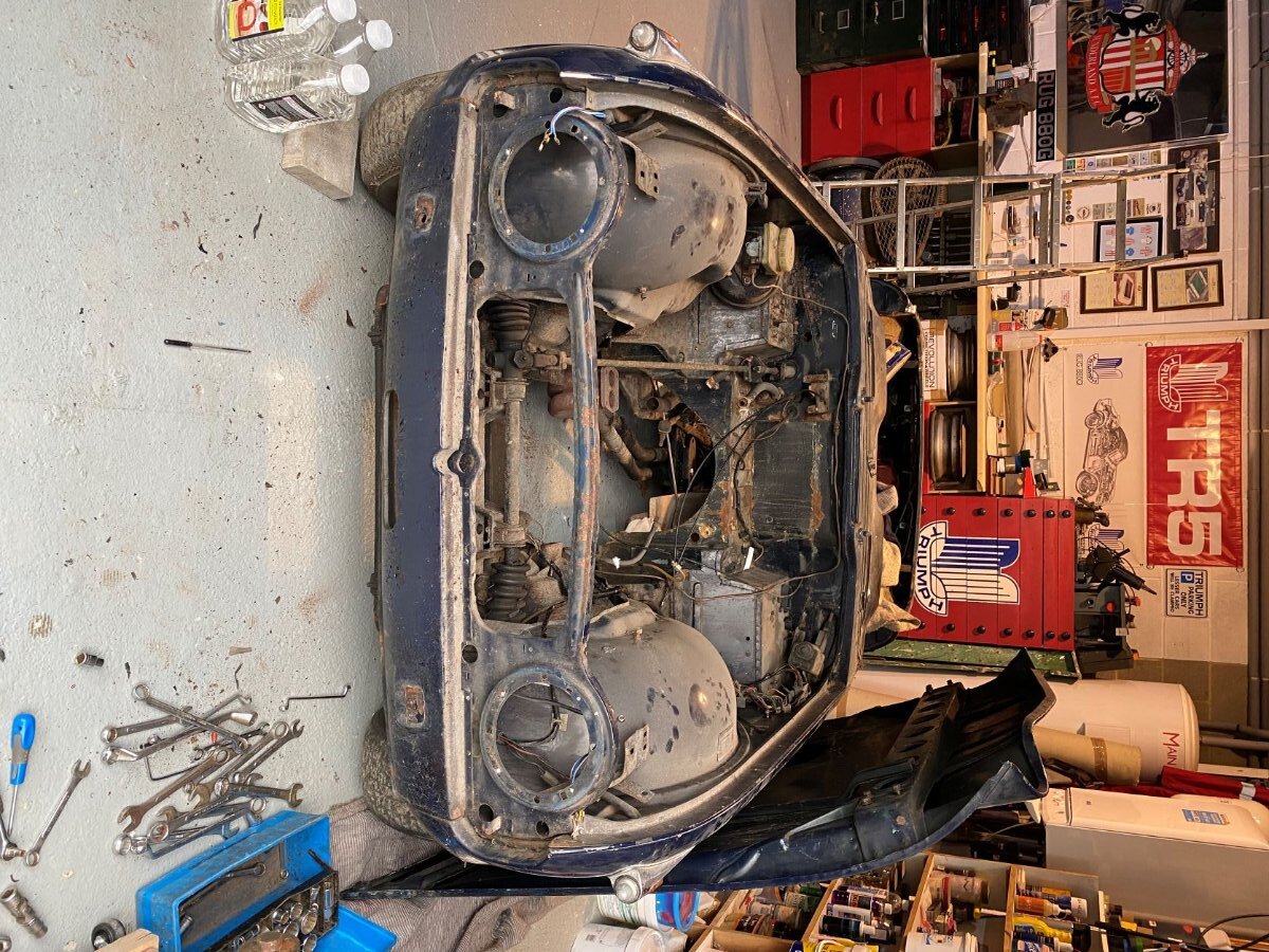

harrytr5 Posted August 4, 2021 Report Posted August 4, 2021 Very nice David, Looking forward to seeing rebuild it. here you go right way up Regards Harry TR5 Nutter Quote
dblenk Posted August 4, 2021 Author Report Posted August 4, 2021 6 minutes ago, harrytr5 said: Very nice David, Looking forward to seeing rebuild it. here you go right way up Regards Harry TR5 Nutter thanks Quote

Rob Salisbury Posted August 5, 2021 Report Posted August 5, 2021 Hi, From the look of things you are not going to be worried by a bit of burnt paint, so cook the screws with a fine nosed flame, just about any stuck nut or screw will yield if heated to cherry red. Cheers Rob Quote
glasgow4a Posted August 5, 2021 Report Posted August 5, 2021 As discussed earlier make your own penetrating oil, 50% Acetone 50% ATF. works well cheers Ian. Quote
dblenk Posted August 5, 2021 Author Report Posted August 5, 2021 Cheers everyone bolts are out great stuff interesting making your own penetrating oil !!!! David Quote
