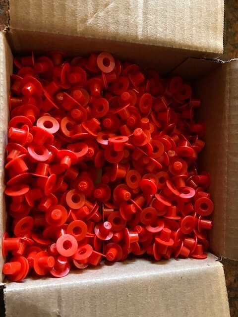

dblenk Posted October 17, 2021 Author Report Posted October 17, 2021 on this forum again rebuilding is much harder than bodging things to keep it running hahahaha anyway little black plugs that go in the front lower suspension arms i have kept mine as didnt see them listed on the moss diagram however i only have three any thoughts david Quote
stuart Posted October 17, 2021 Report Posted October 17, 2021 19 minutes ago, dblenk said: on this forum again rebuilding is much harder than bodging things to keep it running hahahaha anyway little black plugs that go in the front lower suspension arms i have kept mine as didnt see them listed on the moss diagram however i only have three any thoughts david Theyve been unavailable forever Dave. Some hydraulic/brake fittings use similar plugs. Stuart. Quote
dblenk Posted October 17, 2021 Author Report Posted October 17, 2021 4 hours ago, stuart said: Theyve been unavailable forever Dave. Some hydraulic/brake fittings use similar plugs. Stuart. ok i have a hydraulic supplier i use will ask them tomorrow dave Quote
Waldi Posted October 17, 2021 Report Posted October 17, 2021 Hi Dave, I missed a couple too, but found that some of the plugs I had to plug the holes for a chassis rail wax(ML) treatment fitted wel. Waldi Quote
Kenrow Posted October 20, 2021 Report Posted October 20, 2021 To bad I'm in California, I just picked up a 1000 of these for $10 US. If you need some and in the US let me know... Quote
stuart Posted October 21, 2021 Report Posted October 21, 2021 15 hours ago, Kenrow said: To bad I'm in California, I just picked up a 1000 of these for $10 US. If you need some and in the US let me know... Maybe a good idea to sell them to Moss they can ship them back to the UK then we can all get them. Stuart. Quote
dblenk Posted October 21, 2021 Author Report Posted October 21, 2021 found some in black on ebay dave Quote

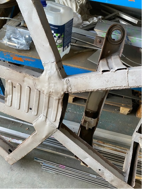

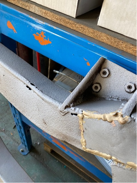

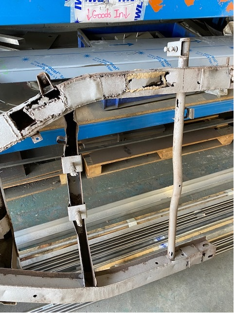

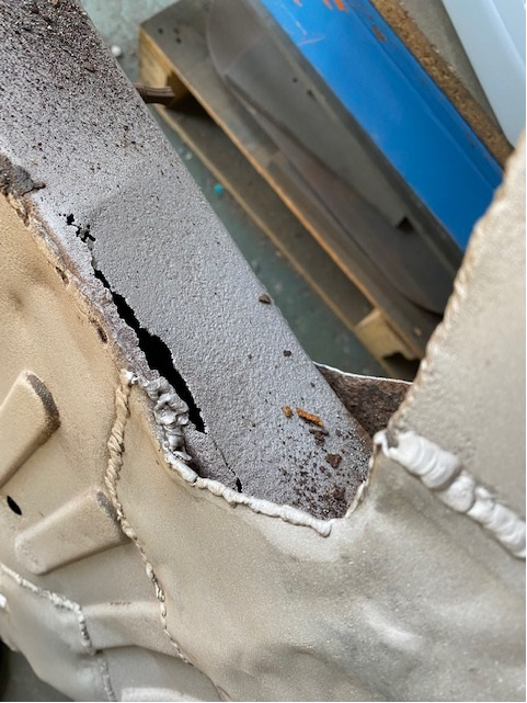

dblenk Posted December 11, 2021 Author Report Posted December 11, 2021 HI All been manic with work so havent had time for anything bit of an update had chassis blasted was worse than i thought with previous repairs using braze and proof the body has been off to do some of them so pre 1984 anyway got another chassis yesterday so need to get that blasted will post pics later havent started the body tub repairs but xmas hols coming up and the work contract needs to be complete by 17th so hope to make some progress cheers David Quote

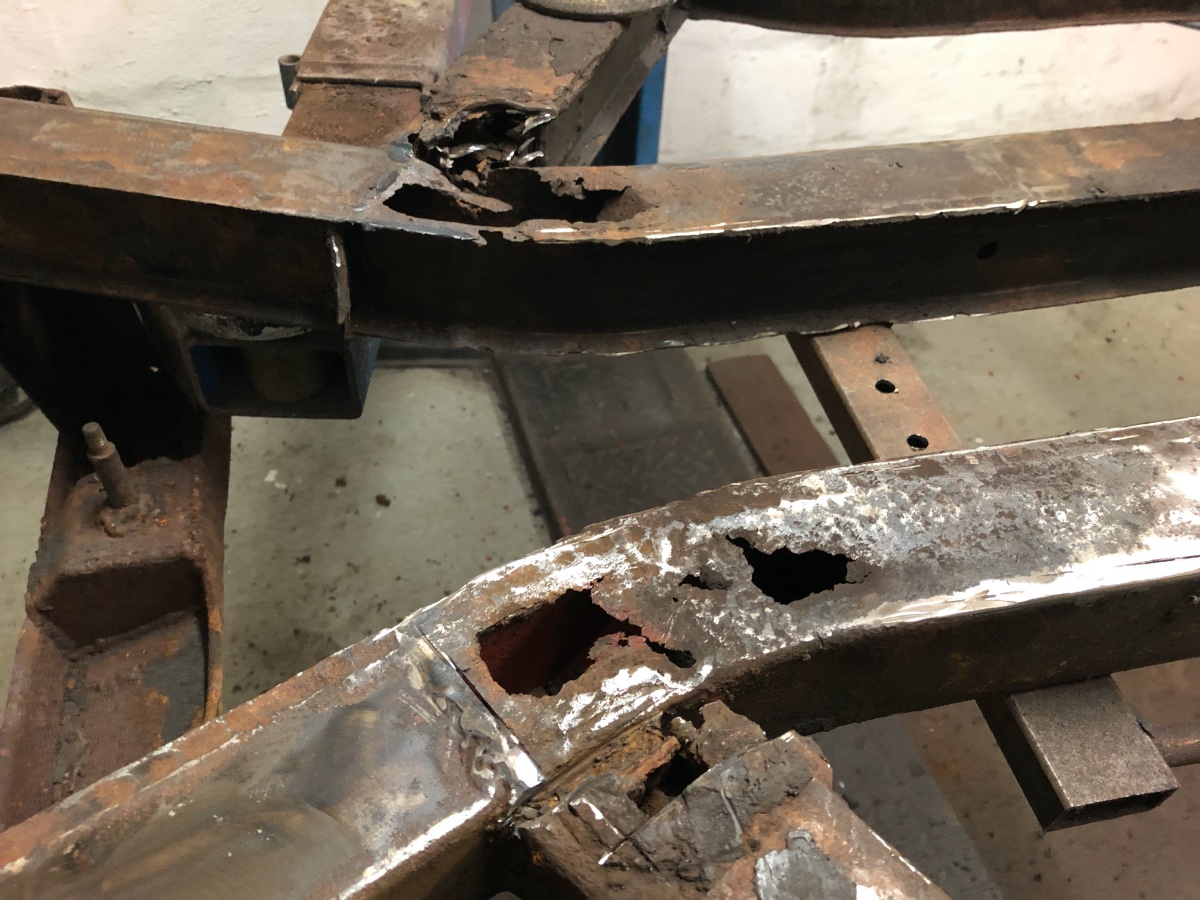

dblenk Posted December 11, 2021 Author Report Posted December 11, 2021 new chassis photos will follow david Quote
Waldi Posted December 12, 2021 Report Posted December 12, 2021 (edited) I hope the other chassis is better indeed David, this one looks really bad. The little holes indicate there is quite some metal-loss in that area. Waldi Edited December 12, 2021 by Waldi typo Quote
Paul J Posted December 12, 2021 Report Posted December 12, 2021 I thought I had problems, just the area under the T shirt panels, the rest seems very sound thanks to very heavy Ziebart application. I think yours has not faired well at all. Quote
DenisMc Posted December 17, 2021 Report Posted December 17, 2021 Hi David, I am very much enjoying the progress of your TR5 restoration. However, on seeing your recent photos of the chassis that show very questionable repairs, I am pleased that when my TR5 was restored 20 years ago it was fitted with a new CTM chassis! I am also pleased that I avoided several cars in my search for a TR5 that most probably would have had the same sort of repairs to the chassis. Regards, Denis Quote
dblenk Posted December 28, 2021 Author Report Posted December 28, 2021 Denis glad you enjoy the photos the repairs also show the bodu has been off at some point so not quite sure what has been done i think everything is original in some shape or form hopefully get some more photos on but the iphone dosent let me drag and paste anymore due to an upddate i have to use the cloud starting after xmas on the new chassis david Quote

John Morrison Posted December 29, 2021 Report Posted December 29, 2021 Ouch David, those chassis photos are a little concerning! You would have been a skilled welder if you had tackled that lot! John. Quote
