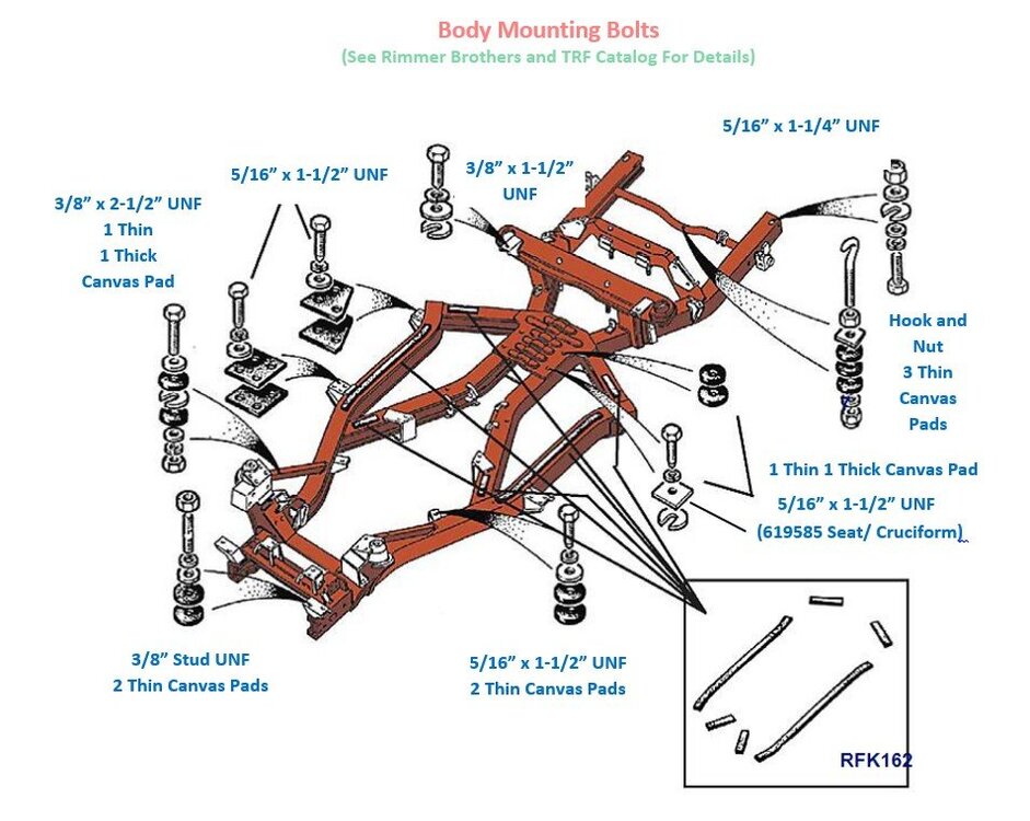

Kenrow Posted January 3, 2022 Report Posted January 3, 2022 (edited) This is something I put together to sort out the mounting kits: Edited January 3, 2022 by Kenrow edit file Quote
Rob Salisbury Posted January 3, 2022 Report Posted January 3, 2022 On 12/29/2021 at 12:19 PM, stuart said: For the body mounting as youve had a TR Shop voucher for Christmas Dave I would use some of it to buy their body mounting kit as it contains all the right size bolts nuts washers and plates as well as all the rubbers/spacers that you need to mount it properly. I use them al the time plus I have a slave set that I use for the "In build" time that will get covered in Bondarust so when I do the final build its all with nice clean bolts/nuts/washers etc. Stuart. + 1 For the TRShop body mounting kit, everything you need in a nice package, almost (but not quite) building by numbers!! Cheers Rob Quote

stuart Posted January 6, 2022 Report Posted January 6, 2022 Go for Poly but dont buy cheap poly. Superfex or Superpro are the best. Stuart. Quote

Dave McDonald Posted January 7, 2022 Report Posted January 7, 2022 I wasn't impressed by the TR Shop body mounting kit. Most of the set screws were far too long and the long bolts through the 2 front sloping turret braces were set screws threaded full length instead of part threaded bolts. I also had to buy extra rubber pads, thick and thin, just to fit the minimum as shown on the diagram. Ended up buying new set screws of suitable length from my local Nut and Bolt supplier.. Dave McD Quote

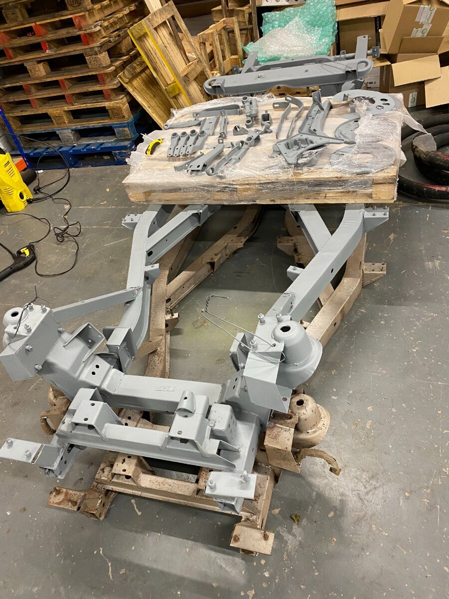

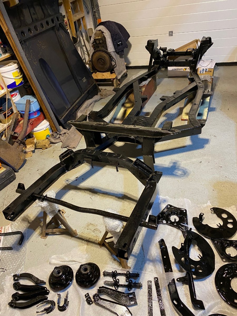

dblenk Posted January 17, 2022 Author Report Posted January 17, 2022 new chassis blasted and zinc etched ready for welding trailing arms diff strength kit etc old (chassis underneath) Quote
dblenk Posted June 24, 2022 Author Report Posted June 24, 2022 Well after work and other things getting in the way (wembley etc) the chassis is back and the bits i am months behind but hey no rush really need to order all the new parts now and start building it looks very shiney thought the original finish was a bit more dull Quote

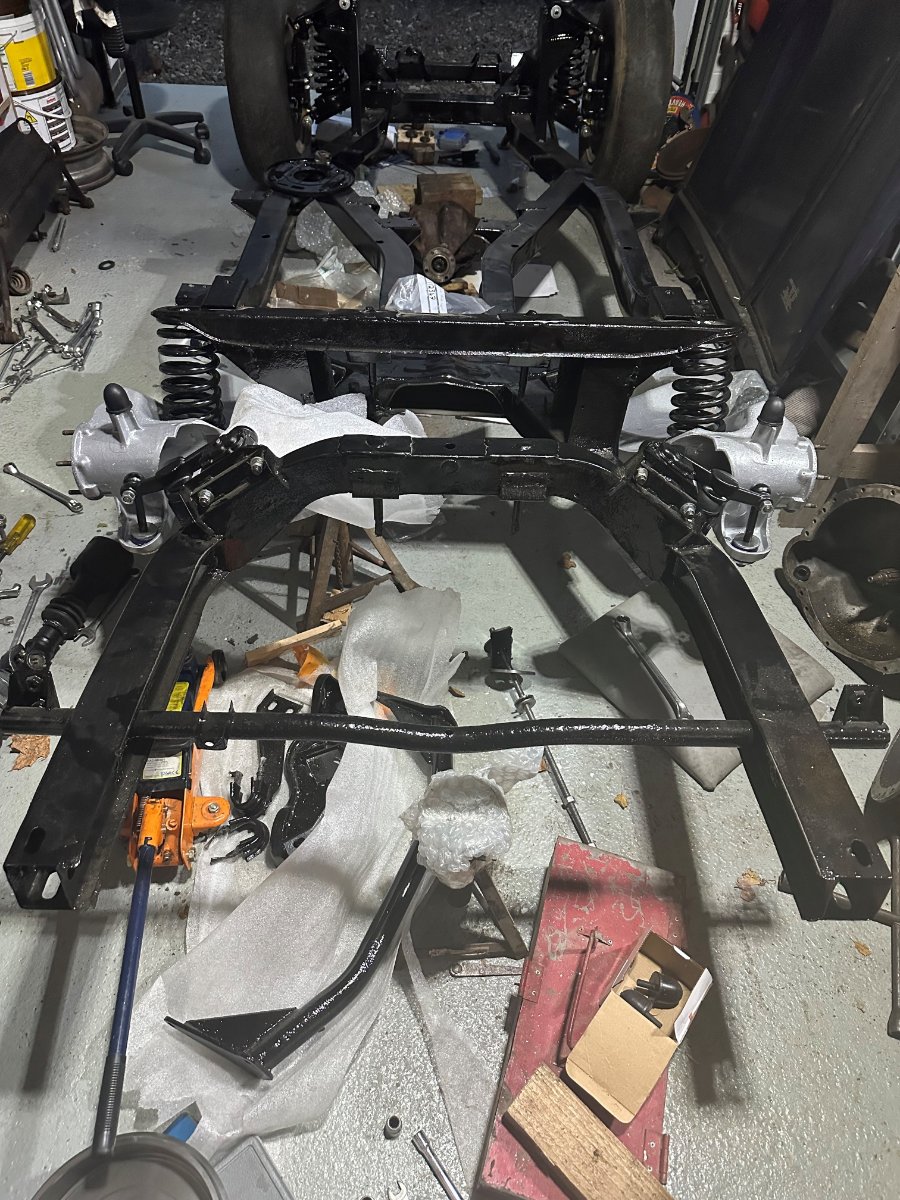

dblenk Posted December 22, 2023 Author Report Posted December 22, 2023 I cant believe its been this long since i posted The 5 chassis is now progressing and hope to have 4 wheels on by the end of this year now i have time off a little TR6 got in the way but it seems to be nearly sorted now Merry Christmas and a happy New Year to all regards David Quote
