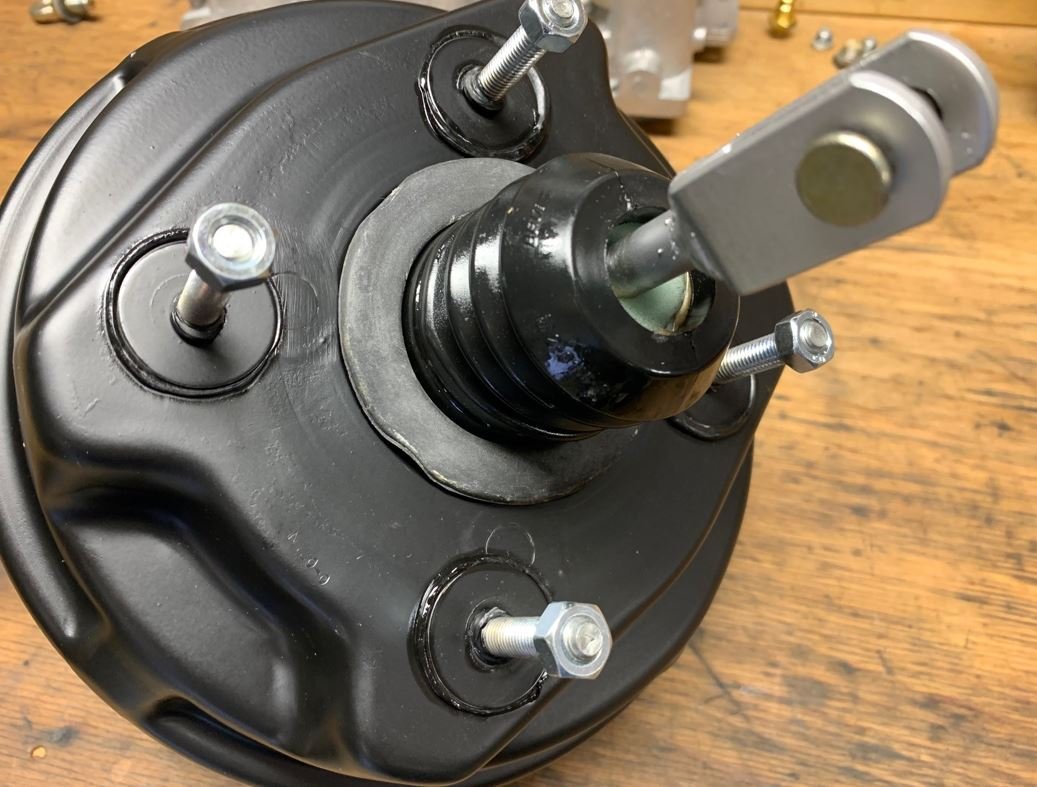

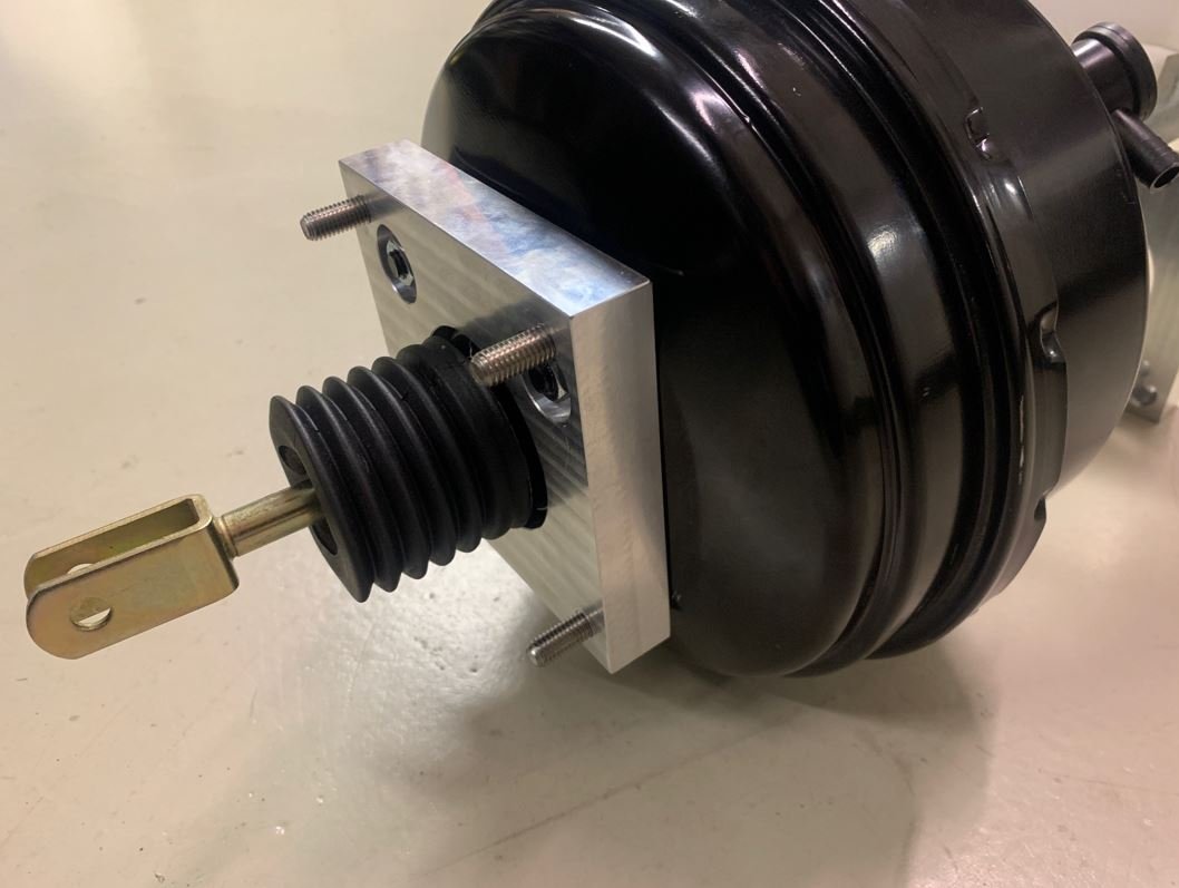

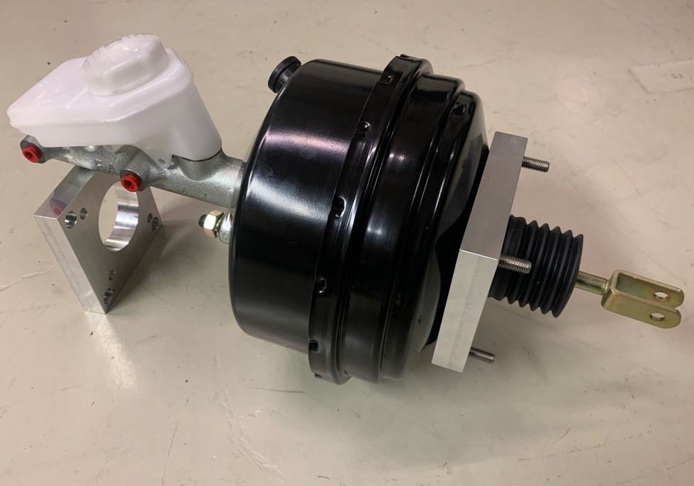

JochemsTR Posted September 7, 2021 Report Posted September 7, 2021 (edited) something like this? Edited September 7, 2021 by JochemsTR Quote

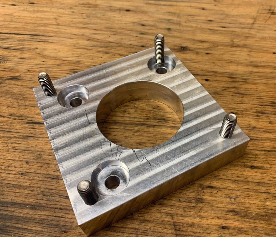

JochemsTR Posted September 7, 2021 Report Posted September 7, 2021 (edited) There are two options (1) Modifying the volvo brake servo to fit TR (2) Modifying the TR to fit Volvo Brake servo In the first pictures I posted, I made an adapter block which would fit onto the volvo brake servo (2). For a RHD the dimensions need to be checked. The installation I also have, the volvo brake servo was modified to fit onto the TR. Edited September 7, 2021 by JochemsTR Quote
JochemsTR Posted September 7, 2021 Report Posted September 7, 2021 In this particular case (1) The volvo brake servo was taken apart, new studs welded and fork slightly offset welded. This is not something easily done, and can only be done with older brake servos. Quote
FatJon Posted September 7, 2021 Author Report Posted September 7, 2021 Thanks for the detailed info and pictures Jochem. I think I will make the adapter plate, maybe easier than taking the servo apart and welding on new studs. I don't think the fork offset is needed on the RHD cars as the clutch servo is not obstructing the larger servo so I hope I can get the position just right. I will post back some pictures for everyone as I do this mod in the coming weeks. Quote

FatJon Posted September 7, 2021 Author Report Posted September 7, 2021 Jochem, what are dimensions of the adapter plate? I'm going to order a chunk of aluminium ready cut to save me some work. Quote

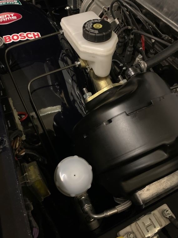

Waldi Posted September 7, 2021 Report Posted September 7, 2021 I have the Volvo servo, and was contacted by someone on the forum, I think last year. Because of the much bigger diameter it did not fit on a RHD car is what I understand. Waldi Quote
FatJon Posted September 7, 2021 Author Report Posted September 7, 2021 I just ordered one so soon we will know for sure. I certainly have enough space between servo and the intakes but servo to inner wing may be close. Quote

JochemsTR Posted September 8, 2021 Report Posted September 8, 2021 (edited) On 9/7/2021 at 3:58 PM, FatJon said: Jochem, what are dimensions of the adapter plate? I'm going to order a chunk of aluminium ready cut to save me some work. let me know if you end up changing any dimensions so I can update my drawing if required. Note: this drawing was removed due to proprietary reasons. Contact me if interested. Edited November 21, 2021 by JochemsTR Proprietary Quote
Z320 Posted September 8, 2021 Report Posted September 8, 2021 (edited) Good morning Jochem, you know I "only" own a TR4A (for shure the more pretty car ), and this is why I suffer from having no benefit from the informations you post here. Anyway I want the say "thank you very much" for doing this with so much details, this is VERY generous! Ciao, Marco Edited September 8, 2021 by Z320 Quote
FatJon Posted September 8, 2021 Author Report Posted September 8, 2021 Thanks Jochem, It gets no better than this, an engineering drawing Quote

JochemsTR Posted September 8, 2021 Report Posted September 8, 2021 (edited) 16 minutes ago, harrytr5 said: Would still be interested if this Volvo mod makes a difference and does it? one of the best upgrades you can do to your car....I have it in combination with a modern master, larger rear, vented discs and Ferodo pads. Edited September 8, 2021 by JochemsTR Quote
harrytr5 Posted September 9, 2021 Report Posted September 9, 2021 18 hours ago, JochemsTR said: one of the best upgrades you can do to your car....I have it in combination with a modern master, larger rear, vented discs and Ferodo pads. Thanks Jochems, Is the servo from a 940 volvo unit and will it fit a right hand drive do you know. Drawings are excellent. Regards Harry Quote
JochemsTR Posted September 9, 2021 Report Posted September 9, 2021 19 minutes ago, harrytr5 said: Thanks Jochems, Is the servo from a 940 volvo unit and will it fit a right hand drive do you know. Drawings are excellent. Regards Harry Volvo 960-940-740-760 with 8" diameter and 2 membranes. if mounted onto a RHD, you need to check my adapter. it probably needs mirroring. Cut a piece of wood and make a template out of my drawing. Take a piece of cardboard and make a 8" volume. Believe it or not, this is how I did it. Jochem Quote

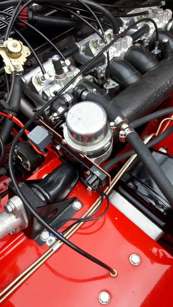

KiwiTR6 Posted September 9, 2021 Report Posted September 9, 2021 On 9/8/2021 at 8:28 AM, Richard71 said: The brakes are fine now, I changed the supplied Wilwood pads for Mintex 1144 pads, recently passed an MoT. But even after all my efforts I doubt the brakes are any better than standard. Having said that, it's been so long since I've been on standard brakes so I can't say for certain. I should let another TR6 driver have go in my car and get their opinion. Richard. I went a slightly different route. Mintex 1144 pads on new drilled discs, Morgan rear wheel cylinders, braided hoses and DOT5 fluid. The main change though was fitting a 12V Audi brake vacuum pump controlled by a small switch designed for automatic transmissions in older American cars which allows me to adjust the vacuum to the servo. I'm currently running at 13 inches and the brakes are superb. The only downside is I can hear the vacuum pump running at standstill and low speeds. Gavin. Quote
Steves_TR6 Posted September 9, 2021 Report Posted September 9, 2021 19 minutes ago, KiwiTR6 said: I went a slightly different route. Mintex 1144 pads on new drilled discs, Morgan rear wheel cylinders, braided hoses and DOT5 fluid. The main change though was fitting a 12V Audi brake vacuum pump controlled by a small switch designed for automatic transmissions in older American cars which allows me to adjust the vacuum to the servo. I'm currently running at 13 inches and the brakes are superb. The only downside is I can hear the vacuum pump running at standstill and low speeds. Gavin. I like your setup Gavin could you let me have the part numbers as i might try something similar ! steve Quote
FatJon Posted September 9, 2021 Author Report Posted September 9, 2021 I've got one of those Audi vacuum pumps sat on the shelf from an unfinished project 10 years ago. If the Volvo servo doesn't fit I'll give that a try. Maybe mount it on rubbers somewhere further away though. Lovely engine bay Gavin. Quote
Richard71 Posted September 9, 2021 Report Posted September 9, 2021 50 minutes ago, Steves_TR6 said: I like your setup Gavin could you let me have the part numbers as i might try something similar ! steve I'm liking that idea too, more info please Gavin. Richard Quote
JochemsTR Posted September 9, 2021 Report Posted September 9, 2021 I like Gavin's setup too, but it still needs a functioning brake servo. Most issues are not with the amount of vacuum but with the brake servo itself. Quote
