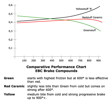

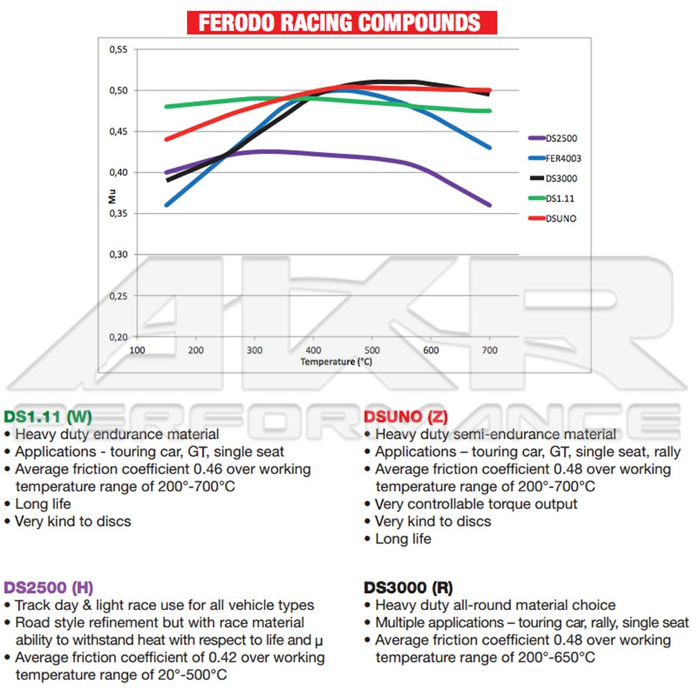

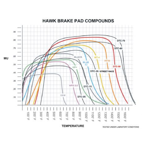

Waldi Posted November 18, 2021 Report Posted November 18, 2021 Is there objective data (tests) available for comparison of different brake pads? Cheers, Waldi Quote
Tim D. Posted November 18, 2021 Report Posted November 18, 2021 2 hours ago, Waldi said: Is there objective data (tests) available for comparison of different brake pads? Cheers, Waldi You can find some tests online of friction vs brake temp. but generally these do not compare the pads we mostly use against each other. There is an interesting graph showing Hawk pad performance and another separate one showing Greenstuff similar data for ferodo Quote
Z320 Posted November 18, 2021 Report Posted November 18, 2021 (edited) Hi, I use a pair of the cheapest brake pads from a common supplier on my TR4A and I'm pleased with the result, not impressive, but well pleased. But this post reminded me I have a set of Mintex 1144 brake pads in my workshop (!) to test and compare - 5 times more expensive for me at Germany than the standard ones! So I just hurried in my workshp to look for them and have them ready to fit! And - in the box - I found the already used standard ones!!!! @§$"!!9?@ the Mintex 1144 are already on the car! Edited November 18, 2021 by Z320 Quote
Waldi Posted November 18, 2021 Report Posted November 18, 2021 Thanks Tim for collecting the data! The graphs show (to me, far far from an expert) there is not a "huge" (like 50%) difference between the 3 suppliers for similar types of pads. But selecting the wrong type of pad is. Like using EBC's Greenstuff for race track days; here the difference becomes more pronounced, "Green" being up to a factor 2 lower than the "Yellow", just as an example. My TR6 is mainly used for normal touring (but I like some spirited driving every now and then, but never long), so I guess my pads will not reach temperatures beyond 300 degr.C for most of their use. I have measured my front disk temperatures in summer conditions after some driving/braking, they never exceeded 300 C. I realize that pad temperatures may be higher but these are difficult to measure for the hobbyist. So "standard grade" pads are the obvious choice for me. Assuming the vendor data are correct and comparable (friction also depends on the disk material and surface profile): EBC shows some 20% difference in their range for my use (I have Greenstuff in the front side, rear shoes are "standard, not specified". Ferrodo shows a spread of only 15% in coëfficiënt of friction between their listed pads. Hawk green and black apperar to be slightly better (black only after being warmed up). I hope other more seasoned TR-ers can provide a better insight than my simple analysis above. I stand to be corrected. Cheers, Waldi Quote
