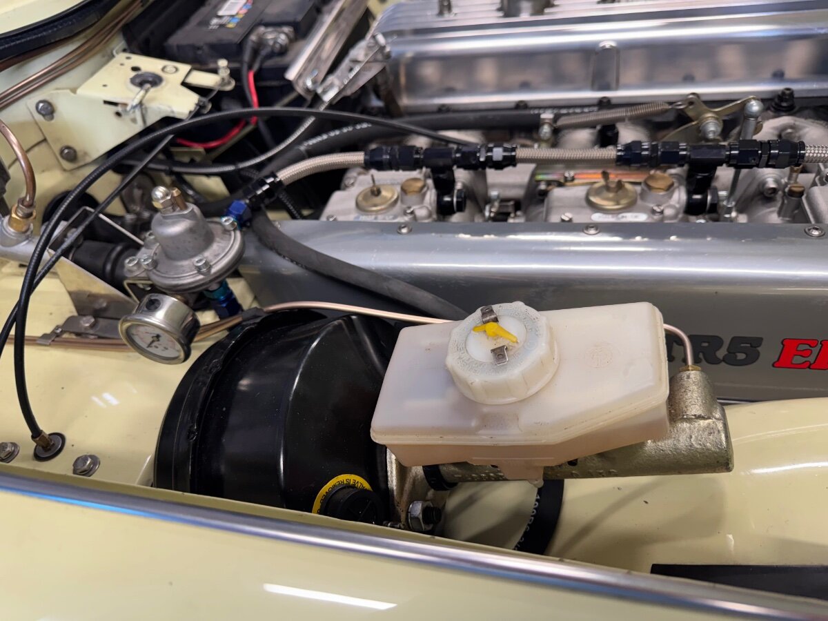

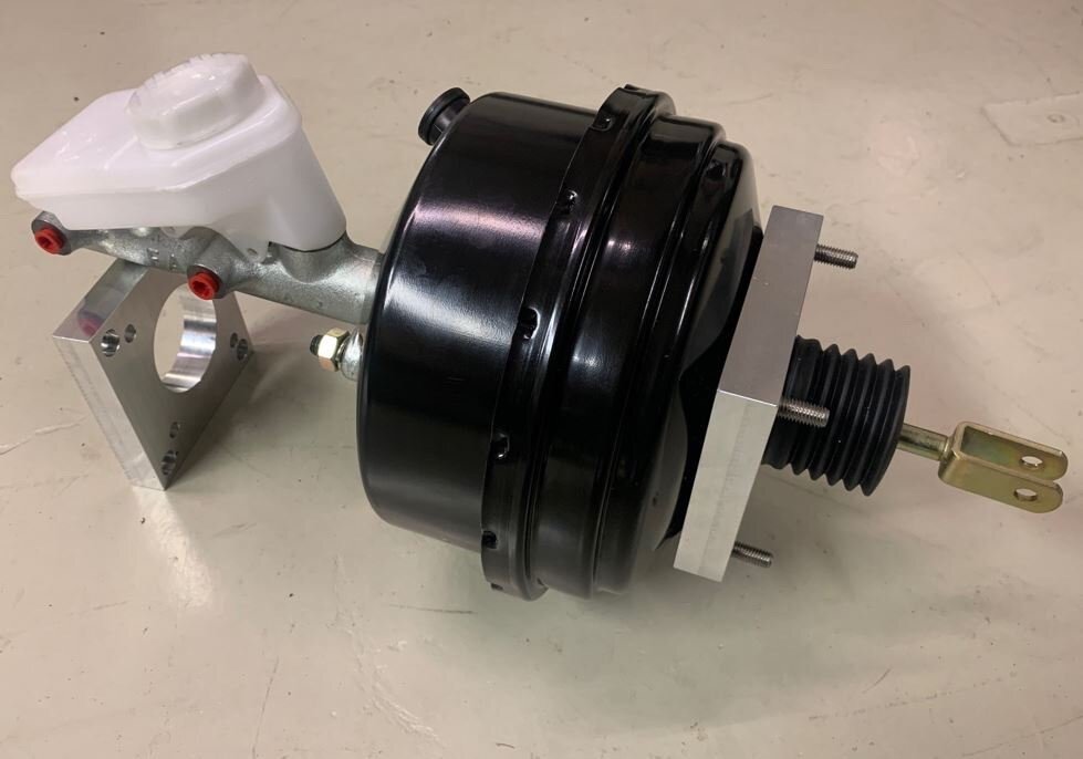

harrytr5 Posted June 19 Report Posted June 19 10 hours ago, Richard71 said: Keep us posted Harry. Does this MC omit the tipping valve? Richard. Yes it does Richard and the bore is 22.5mm which suits the Volvo servo. The fly in the ointment could be they no longer stock it and I will not know till Monday morning 22/06/26 What I can not understand is why no one else has had this problem with the standard brake master cylinder and Volvo Servo. My rebuilt master cylinder does seems suspect but I would not know unless I fitted one that has proven it works to try (doesn't look like that will happen as no offers) I will keep you posted after I have solved it which I will. Regards Harry Quote
Malbaby Posted June 19 Report Posted June 19 (edited) Time to replace your "rebuilt" M/C which has not been rebuilt correctly...Probably the tipping valve is not functioning. Edited June 19 by Malbaby Quote
harrytr5 Posted June 21 Report Posted June 21 I now have an original brake master cylinder and will fit new seals in and if it works then great, if not my Saab mc will hopefully been on its way to me if they can locate it. Regards Harry Quote

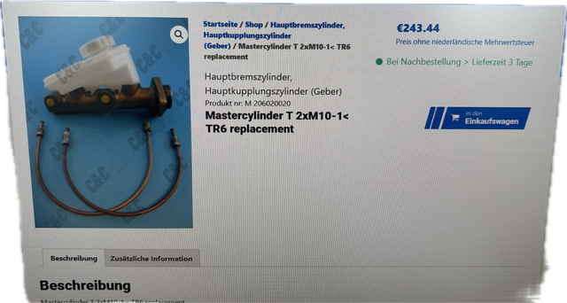

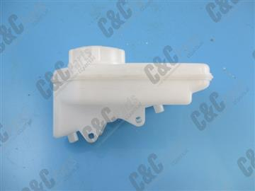

Waldi Posted June 25 Report Posted June 25 Hi Harry and Richard71, I called today with C&C Parts in the Netherlands (C&C.nl), they do NOT have the alternative master cylinder (with reservoir), part no 206020020 on stock and do not expect it will be available soon. I have informed them there could be more interest from the UK TR-drivers. The lower-height reservoir would be available but does NOT fit the standard TR6 MC so that’s not an option. I understand they had a similar request from a mr. Dent in the UK😀. Here is a direct link to the article: https://ccparts.nl/winkel/?s=206020020 So I’m afraid I cannot help you at the moment. Cheers, Waldi Quote

harrytr5 Posted June 26 Report Posted June 26 I ordered and paid for the TR6 replacement to then be told today they will refund me. You would think that if someone was switched on they could order it from the manufacturers and make a few sales. I did inform them of our master cylinder problems and we are looking for an easy replacement that works. Shame the person I have been emailing does not use their initiative and do something about it apart from the computer says NO. Search goes on. I have refitted my Volvo servo and rebuilt (past parts ) original brake master cylinder and even though it really shows up why we do this as it is really a game changer and I will persevere to my satisfaction. When looking into the reservoir and a mate pressing the brake pedal I get a small bubble coming up from the tipping valve area can this be normal or is the tipping valve letting go? Regards Harry Quote

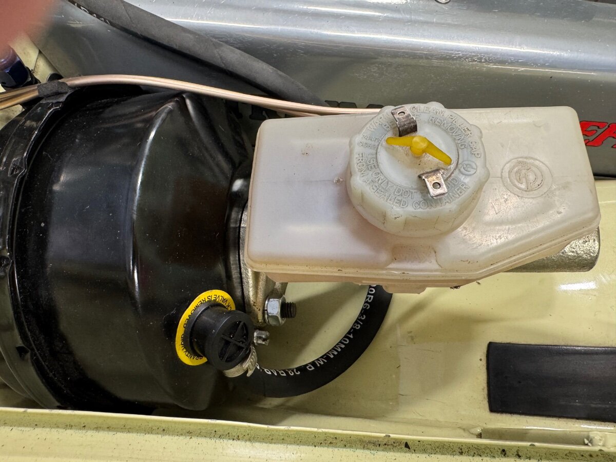

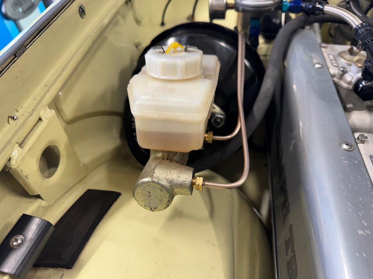

harrytr5 Posted July 3 Report Posted July 3 Just fitting a SAAB 99/900 new old stock (Girling) master cylinder and the reservoir with it fits under the bonnet with clearance. I now have to replumb new brake lines in the engine bay. Remains to see if its all worthwhile! My uprated brakes, stub axles, bigger bearings still needed shims to take up play which I am experimenting with and hope that solves that issue. Regards Harry Quote
harrytr5 Posted July 8 Report Posted July 8 Now I am cooking! Works as it should and just got to bleed some more air out of it. Now a happy bunny. Thanks for putting up with me. See you in Car Fest and in the modified class hall Quote

stuart Posted July 9 Report Posted July 9 12 hours ago, harrytr5 said: Now I am cooking! Works as it should and just got to bleed some more air out of it. Now a happy bunny. Thanks for putting up with me. See you in Car Fest and in the modified class hall Time to utilise the level indicator in the cap there Harry, Im sure another warning light wouldnt go amiss Stuart. Quote
harrytr5 Posted July 9 Report Posted July 9 Thanks Stuart I may do this or change the reservoir which I have now, which is this one. Quote
