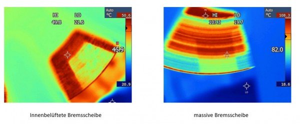

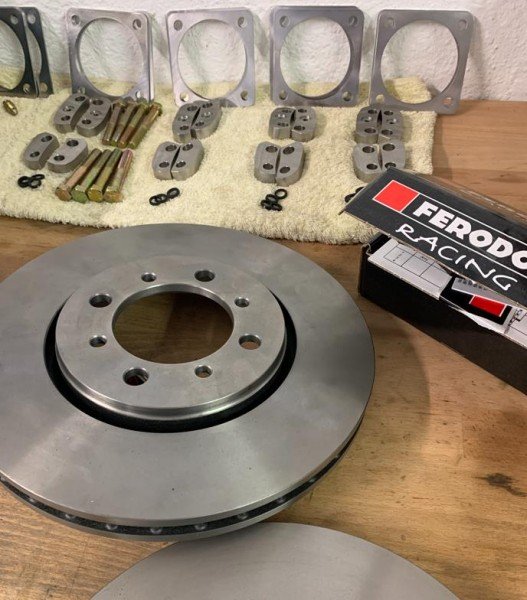

JochemsTR Posted December 16, 2022 Report Posted December 16, 2022 This is the kit I sold in germany/austria. I installed a normal disc and a vented disc parallel on my car. a 50% temperature reduction. This is for me the most significant front brake upgrade you can do. 4 piston calipers etc. won't help you and not necessary. The TR brakes are easy upto 200 HP. Quote

Andy Moltu Posted December 16, 2022 Report Posted December 16, 2022 9 hours ago, JochemsTR said: This is the kit I sold in germany/austria. I installed a normal disc and a vented disc parallel on my car. a 50% temperature reduction. This is for me the most significant front brake upgrade you can do. 4 piston calipers etc. won't help you and not necessary. The TR brakes are easy upto 200 HP. Which disc did you use? I have one of the older vented disc conversions. These use spacers in the standard calipers and work well with Mintex 1144 pads. Want to do the same with the 4A, however the kits haven’t been sold for years. The calipers spacers are not a problem as they are sold for contemporary fast Fords. The alternative disc is an issue. Pretty sure ECB supplied them originally but when I spoke to them they denied they were the suppliers (in spite of coming in an ECB box with a set of their crappy pads) None of the TR suppliers recalled where the kits were from. Did you use an off the shelf disc or did you modify one. I so which car was it originally fitted to? Quote

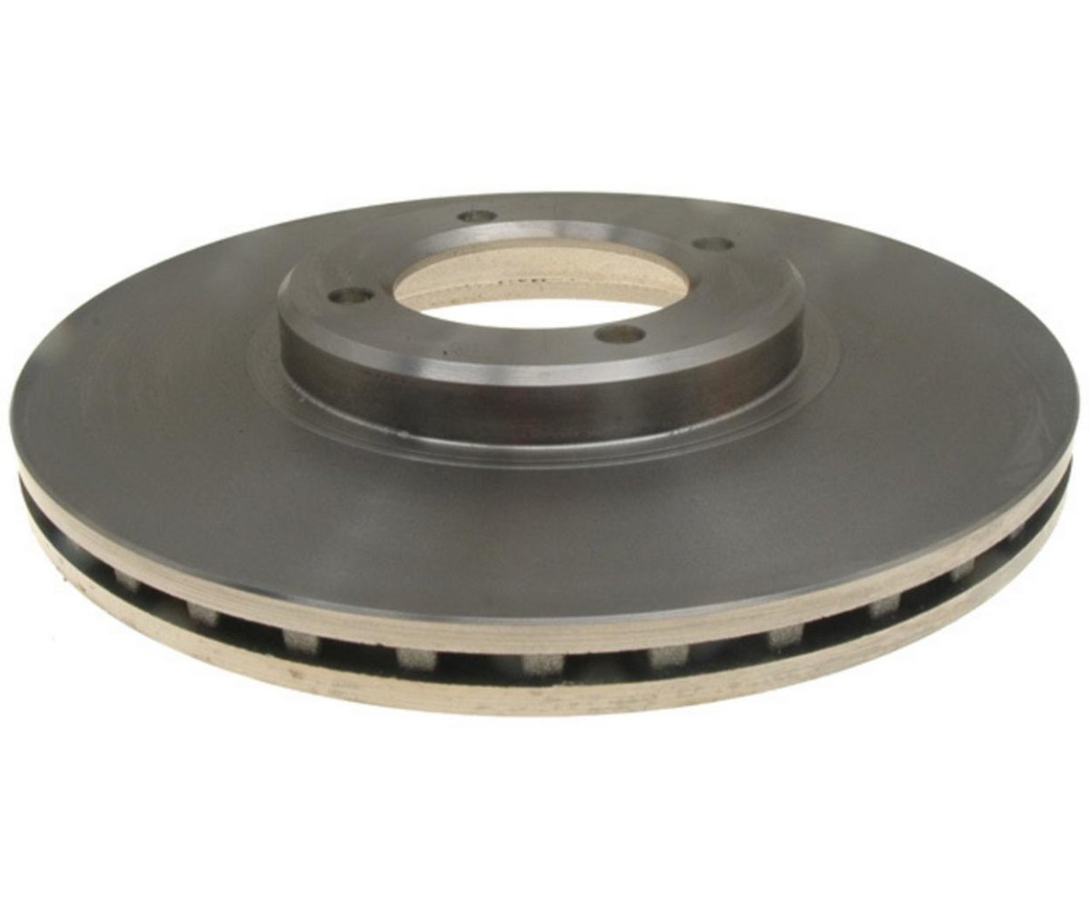

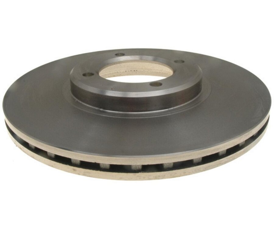

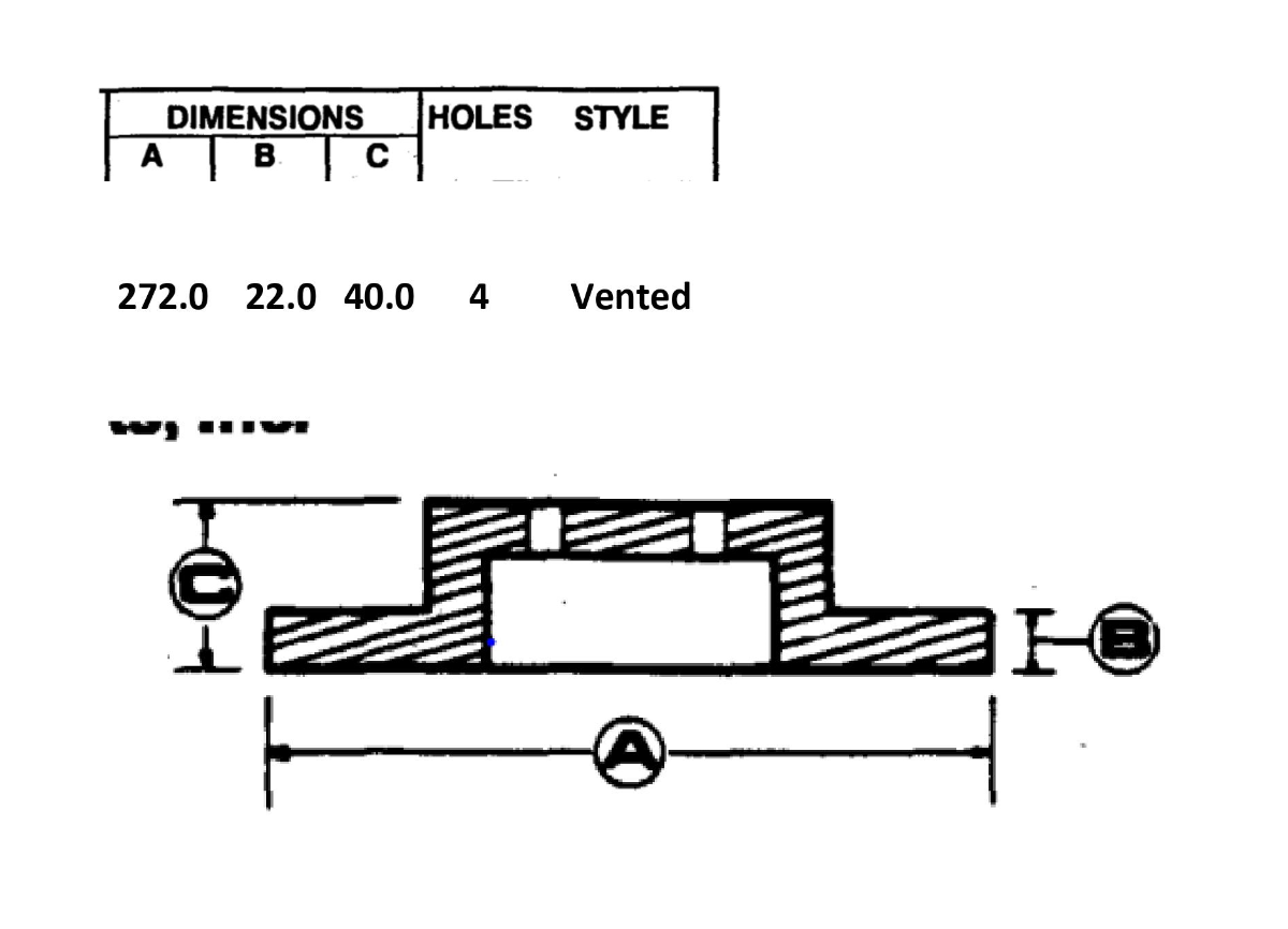

jr2 Posted December 18, 2022 Report Posted December 18, 2022 21 hours ago, JochemsTR said: The ECB discs were 20 mm wide This brake rotor may be a suitable replacement for the EBC. I have the caliper spacers and these 22 MM rotors ready for fitment, but my car is in storage. Quote
RogerH Posted December 18, 2022 Report Posted December 18, 2022 Hi, From where are they obtained? Roger Quote
