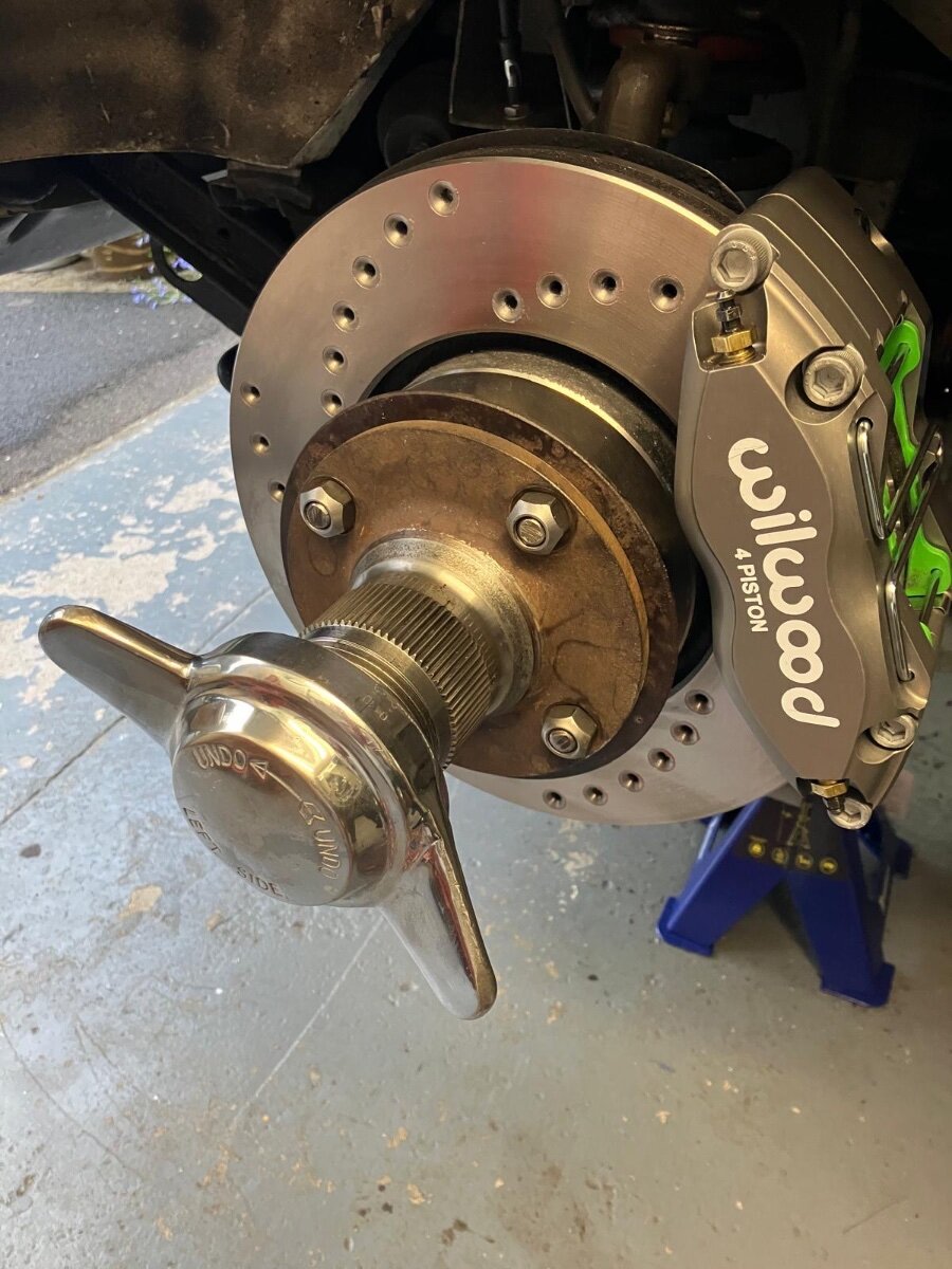

Jctr6EFI72 Posted April 30 Report Posted April 30 I have just the fosseway upgrade kit installed on my TR6….. result is to me value for money.. very nice upgrade, brakes are now very progressive so the feeling is very pleasant and provide modern security. I was afraid of too much power without ABS but you can control pressure easily Quote
PriceLes Posted April 30 Report Posted April 30 (edited) On 7/8/2023 at 1:16 PM, BaulyCars said: Has anyone tried the Wilwood/Goodparts brake master cylinder set-up, maybe that's a good upgrade in terms of pedal force/feel? https://www.goodparts.com/product/dual-master-cylinder-kit-tr250-tr6-5-8-bore/ A very old thread but no and it is the only part from their full catalogue that I have not bought off Richard Good due to having a TR4A which would have needed a TR6 pedal box and modification to the bulkhead/firewall. It is a very nice unit being dual master, adjustable bias and leverage with the option of in cabin bias adjustment. (Did anyone actually read the link, no it seems) I expect the full Wilwood disc set up (Wilwood factory kit front with drilled slotted vented rotors/Good Parts/Wilwood drilled slotted rears) to perform nicely, master cylinder to be determined including building/machining my own. Racetorations being one other option but does not have the same features. Edited May 2 by PriceLes Quote
