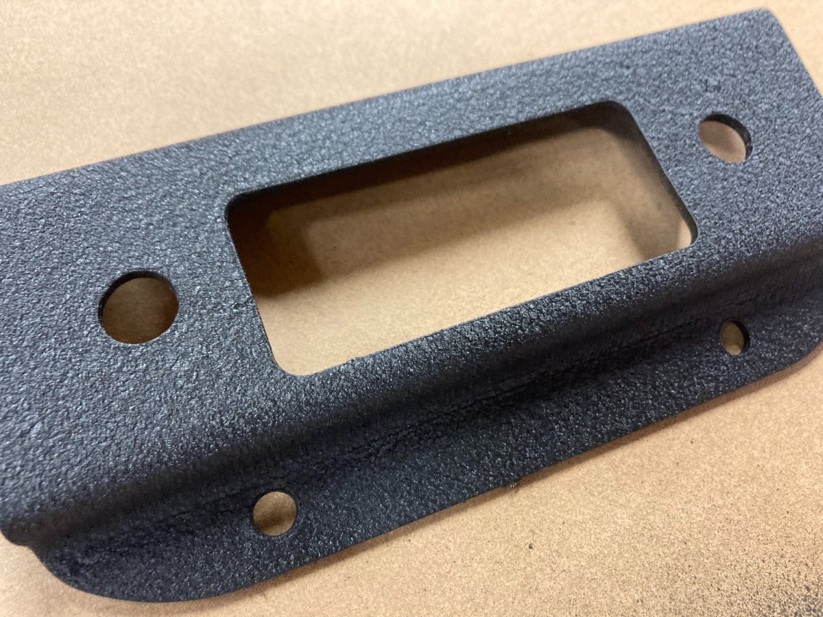

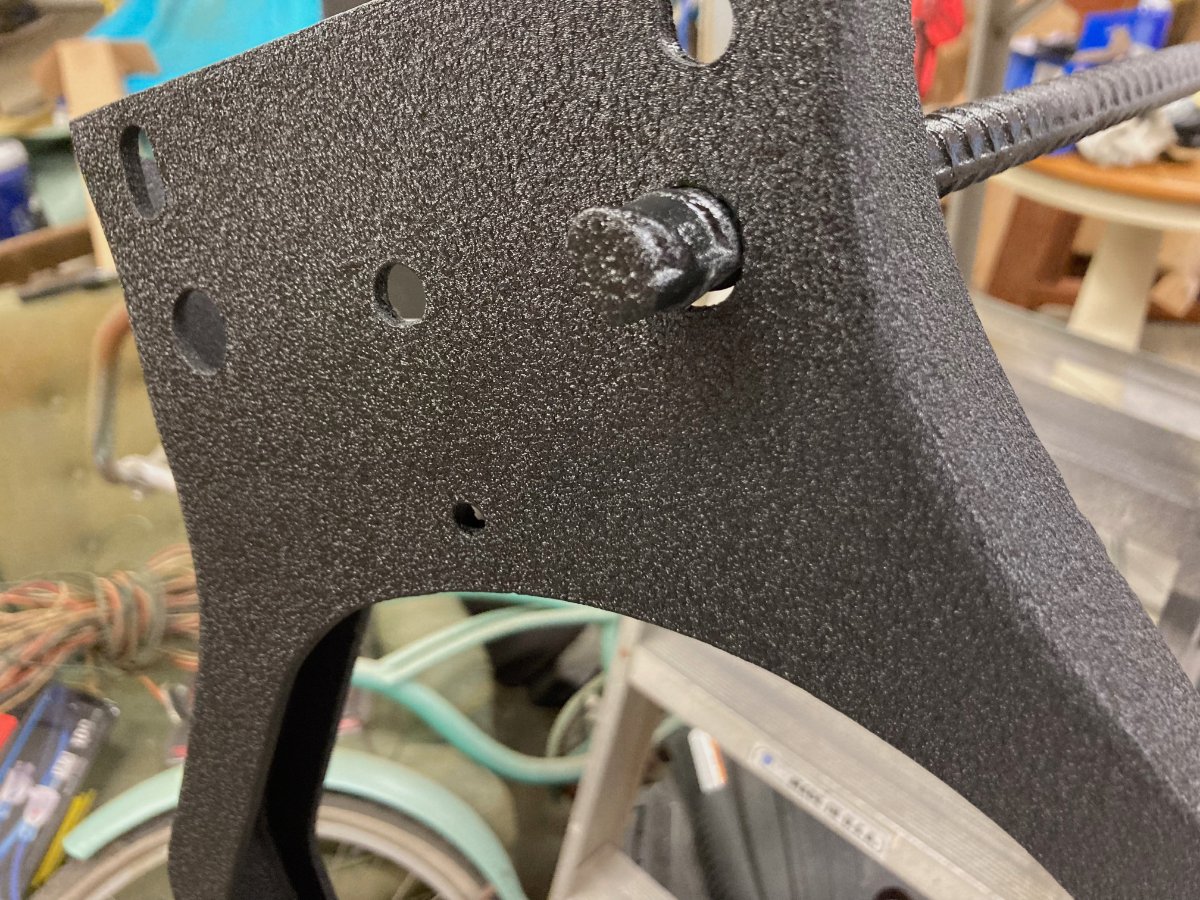

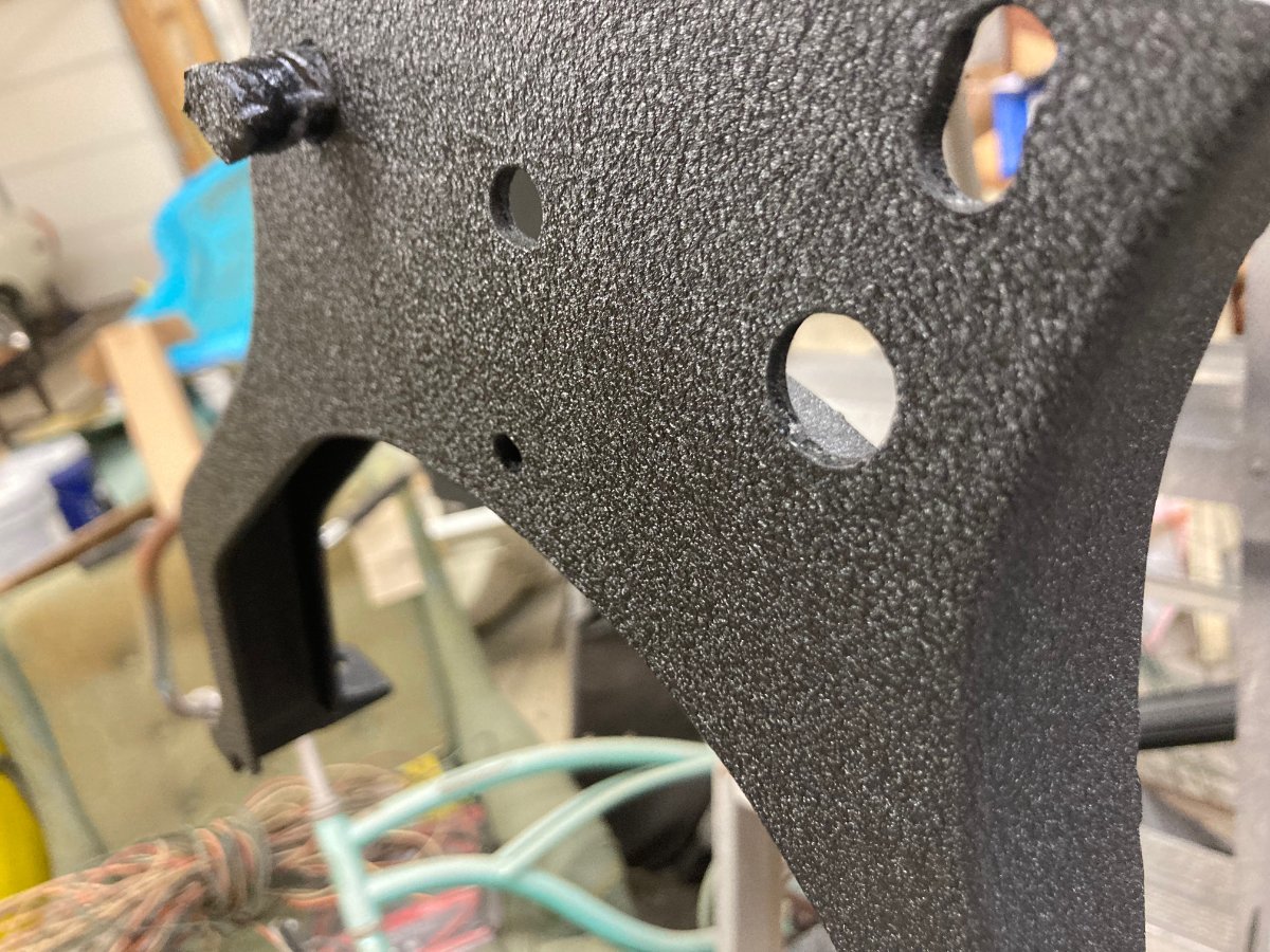

RMP NC Posted April 21, 2023 Report Posted April 21, 2023 I used the VHT for what it is worth. HOW you do it is as important as what you buy. I used a heat gun in between coats. There are nice videos showing a process that works, worked for me anyway. https://www.amazon.com/VHT-SP201-Wrinkle-Black-Coating/dp/B000CPIMXK?th=1 Quote
John Morrison Posted April 21, 2023 Report Posted April 21, 2023 Now that's a really nice job. I too have used VHT with success, mine on the centre panel of a side screen car, seems to do what it says on the can! John. Quote
