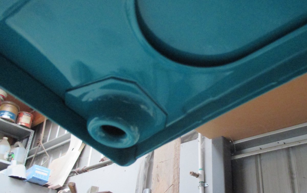

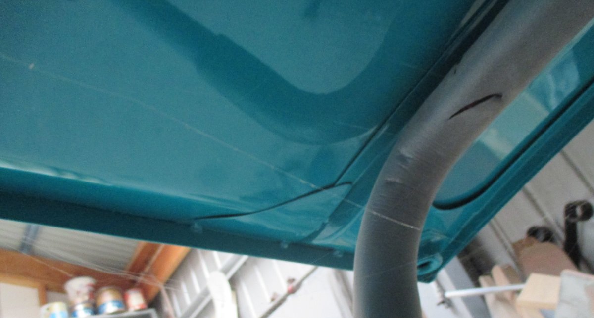

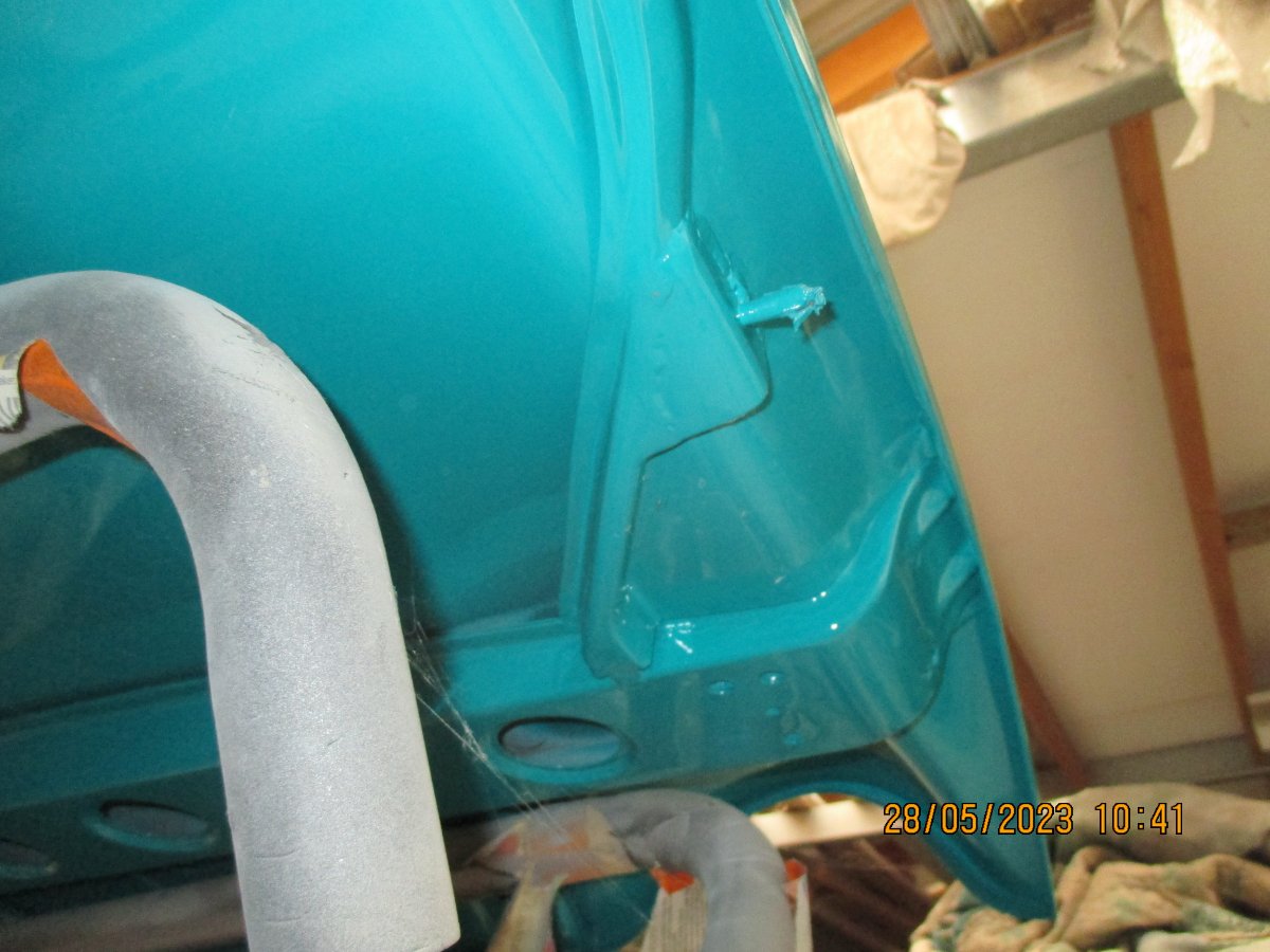

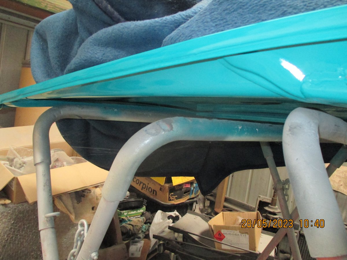

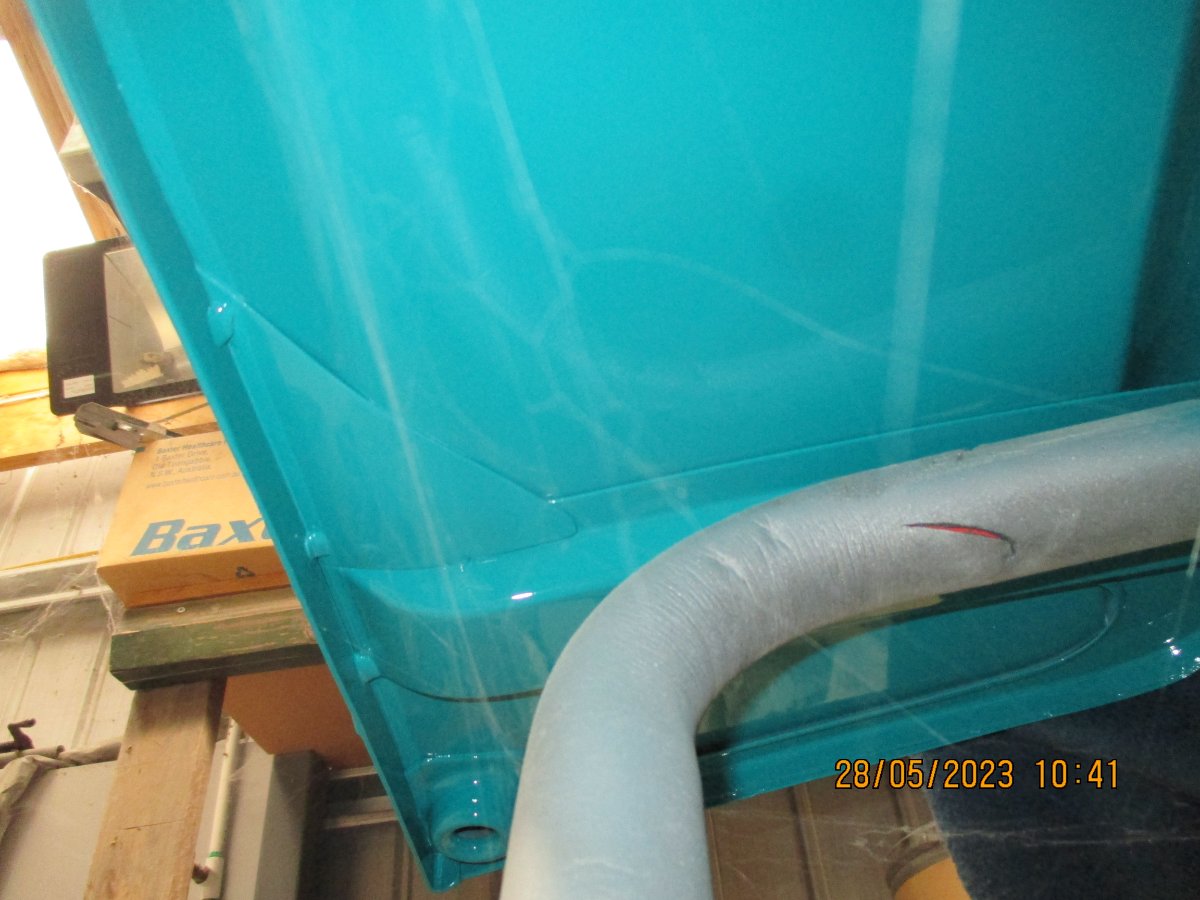

Malbaby Posted May 29, 2023 Report Posted May 29, 2023 Bonnet not on the car, so pics are sub optimal. 3mm strip welded onto the inside of the side edges..It does protrude lower than the factory edges, but gives the sides extra strength...[How many times have you seen the bonnet sides bent due to undue force applied to close it]. On one pic you can see that the welded edge strip has a small return at the back corner. Also welded in a triangular strengthening piece to connect the sides to the main cross brace. My bonnet did not need any "heat" treatment, hence no jig required, but was fitted to the car to ensure a nice fit pre/post welding. Some guys may say it's OTT Quote

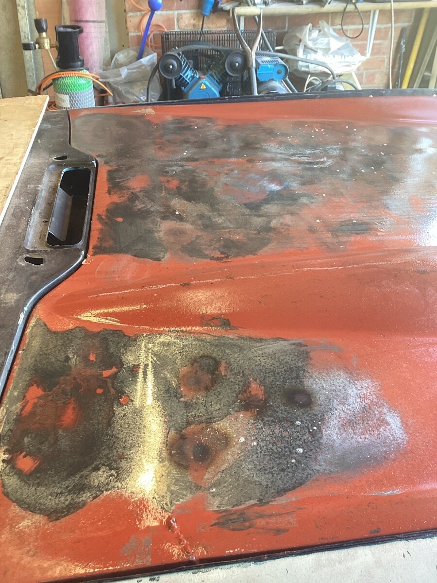

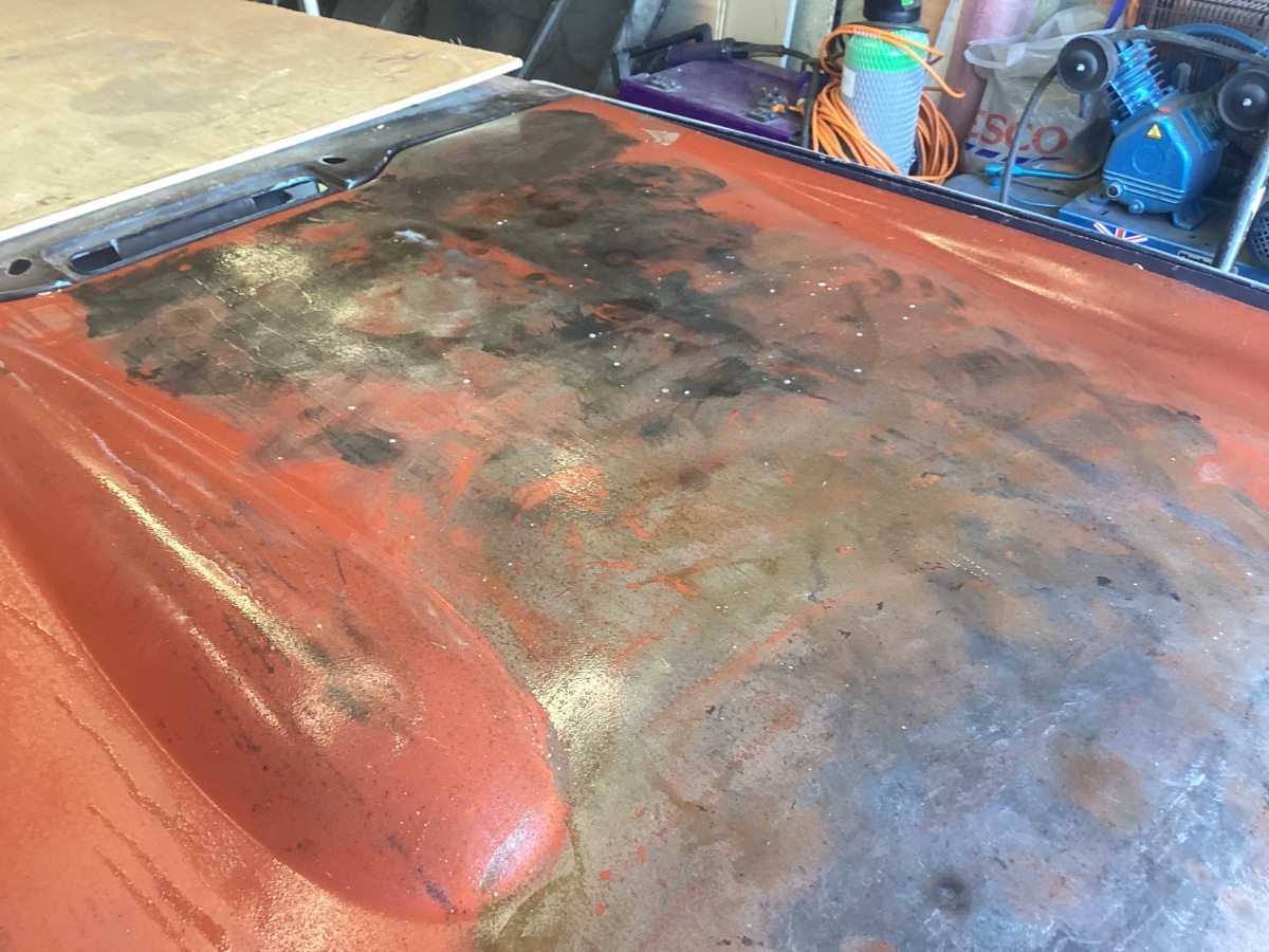

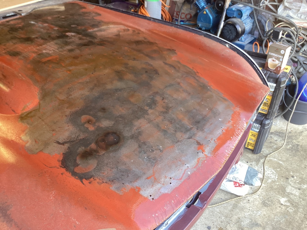

John h Posted May 29, 2023 Author Report Posted May 29, 2023 Great pictures malbaby Thanks for the encouragement I’m over the moon with results for a complete novice I’m shocked had another little go late this afternoon really pleased with the results will keep going some of the dents on the front of the bonnet just lifted out a couple of dents on the front brace our proving to be a bit stubborn, I can’t get at it because of the brace will persevere and push on thanks again for all your comments or post more pictures a little bit later Regards, John Quote

stuart Posted May 29, 2023 Report Posted May 29, 2023 I fit slightly bigger brace plates to the rear where the frame meets and it splits on the outside. They are available ready made from Revingtons at vast expense but I have a pattern for them if anyone need to borrow it. Stuart. Quote

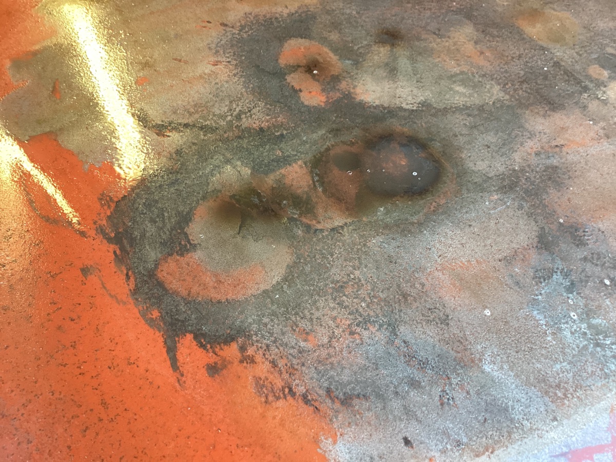

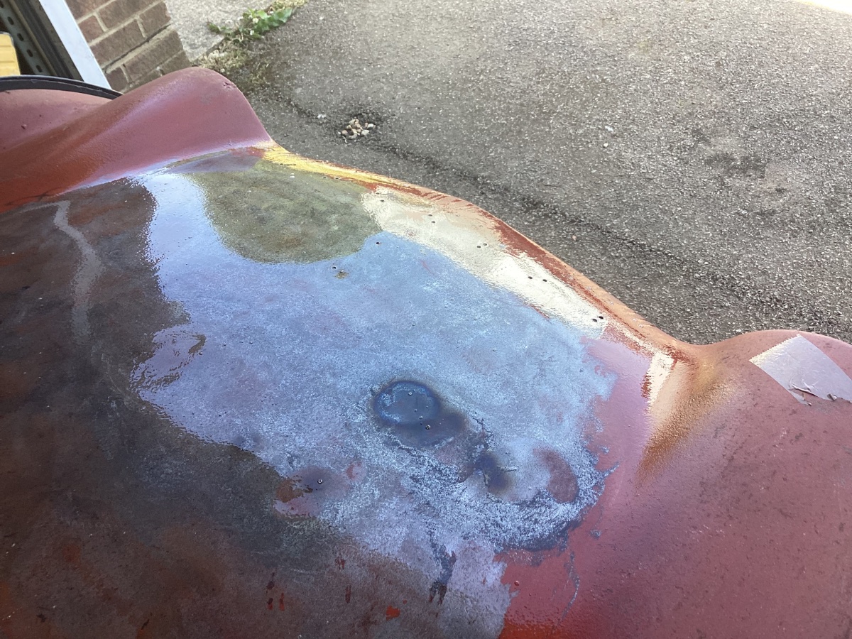

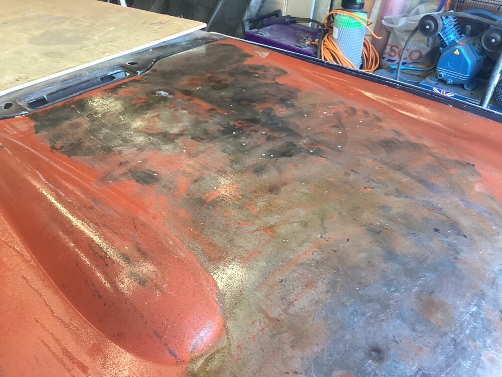

John h Posted May 29, 2023 Author Report Posted May 29, 2023 Been out in the garage again can’t leave it alone just posting cup of pictures still more to do but getting there I think there are two dents on the front brace which have been a bit awkward. Can’t get at the back of it as you can see. I’ve even tried that heat on that will have another go probably next week now I sprayed a little bit of water so you can see the reflections Let me know your thoughts. Regards, John Quote
stuart Posted May 29, 2023 Report Posted May 29, 2023 If you feel your getting close then clean off the burn marks and then stick a coat of Bondarust over the whole thing then use a long block (i.e. one that will take the width of a full sheet of production paper) and block the whole thing off, this will high light high or low spots. Stuart. Quote
John h Posted May 29, 2023 Author Report Posted May 29, 2023 Thanks Stuart, when I start to get close ill do what you said with the bondarust have not used that before I do have some is it a primer filler or both Quote
stuart Posted May 29, 2023 Report Posted May 29, 2023 2 hours ago, John h said: Thanks Stuart, when I start to get close ill do what you said with the bondarust have not used that before I do have some is it a primer filler or both Its a zinc based primer, no filling properties but it stops rust, I use it as a bare metal coat for all my panel work. Its great for keeping bare panels rust free while your working on them especially through the filler process too, then once youve filled everything stick another coat of it on and then use your 2k primer filler. Makes for a long lasting finish and thats how you get dead flat panels which are essential for dark coloured cars. Stuart. Quote
Malbaby Posted May 29, 2023 Report Posted May 29, 2023 (edited) John...Try to get the surface as good as you can before applying any epoxy primer. Are you "shrinking" the metal immediately after heating with a wet rag? Edited May 29, 2023 by Malbaby Quote
John h Posted May 30, 2023 Author Report Posted May 30, 2023 I’ve been using a water spray bottle with a little bit of washing up liquid in it according to someone on YouTube helps with lubrication, apparently once cooled just wipe it with a rag Quote
