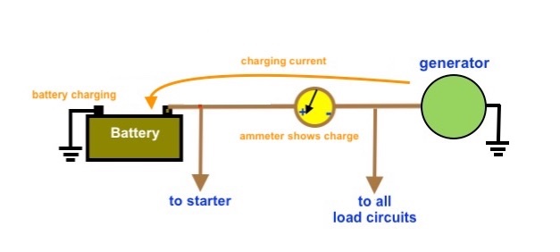

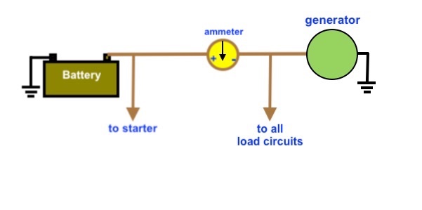

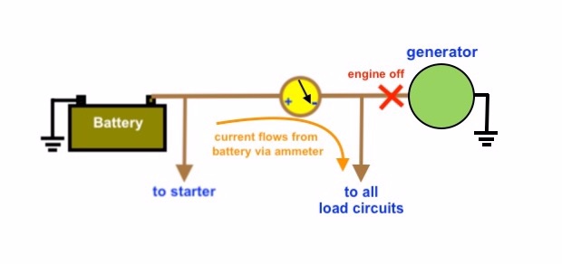

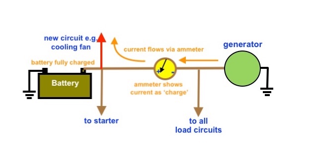

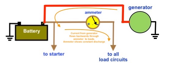

RobH Posted September 17, 2023 Report Posted September 17, 2023 (edited) There have been a couple of recent threads ( and a number of old ones) discussing ammeter problems and it appears there is a variety in the way wiring has been changed on some cars which makes the ammeter read oddly. This post is just to clarify how things are supposed to be. The ammeter is a useful instrument which can tell the user a lot about how the car electrics are functioning and what the state of the battery is. It is intended to show what current is flowing into and out of the battery and it can only do that properly if the wiring is correct. It ought to be connected like this: As the battery charges, current flows through the ammeter: Other than for operating the starter, the only time the battery supplies current is when the engine is not running and the generator (dynamo or alternator) is not working. Apart from a few minutes after starting, while the battery is recharging, the ammeter should always show zero current if all is well. A discharge is only shown if the generator is not working or is unable to supply sufficient current and power is being drawn from the battery. When the engine is running above idle speed, all the electrical power for the car comes from the generator . It follows that all connections to the car circuits, other than the starter, should be connected directly to the generator output. If loads are connected directly to the battery instead, then the current to them from the generator will flow through the ammeter and is indicated as a continuous ‘charge’. This is incorrect but extra circuits for new devices are often connected that way by owners who do not understand this, because it is convenient to make the connection there. When installing an alternator in place of the dynamo, sometimes an incorrect connection is made direct from the alternator to the battery. In this case all currents drawn during normal running will show as a discharge on the ammeter and battery charging current will not be indicated. What an ammeter can tell you: When the ignition is turned on a small irregular discharge is shown during cranking. This shows the ignition and points are working. When the engine starts there will be an initial high current charge indicated. This should reduce fairly quickly and the charge will then continue to drop at a slower rate over a few minutes until it settles at zero. That shows the generator is providing a sufficient charge and that the battery is working properly. If the current reduces very rapidly to zero the generator may not be working properly or the battery may be losing capacity. If a charge continues to be shown after some time it may be the generator is producing too high a voltage or the battery is not charging properly. If no charge is seen immediately after starting then there is something wrong with the generator or the fan belt that drives it. When driving, the ammeter should show zero current all the time. If a discharge is indicated there is something wrong with the generator or the fan belt. ( It is possible when driving at night and using lights, wipers, cooling fan etc simultaneously , that a car with a dynamo may show a small discharge. This is because the dynamo output is limited and may not be able to supply enough power for all the demand, though it may also be an indication that not all is well with the dynamo.) With the engine not running, when turning on individual loads -e.g. brake lights - the current drawn will be shown as a discharge on the ammeter, indicating that the circuit is working correctly. (If LED bulbs have been fitted the current will be very low of course and may just be a small twitch on the needle.) Edited September 17, 2023 by RobH Quote

Mk2 Chopper Posted October 1, 2023 Report Posted October 1, 2023 I wired my TR6 fuel pump via a relay direct from the battery, and of course this meant the ammeter needle wasn't at zero, once I understood what you've explained above I was able to change the wiring to allow the ammeter to work properly again. Thanks for the post, I'm sure it will help a lot of people. Gareth Quote
