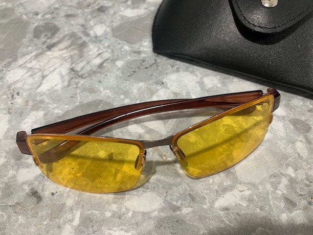

John Morrison Posted January 11, 2024 Report Posted January 11, 2024 Interesting Thread this. Personally I wouldn't leave home without mine, and I have a pair in each car. I regularly drive the A66 Scotch Corner to Penrith. If you are unlucky enough to meet a HGV climbing out of the Warcop dip, at night, in the rain, and this HGV will normally be followed by a stream of other vehicle it has slowed, then you are in real trouble of not being able to see properly. These night glasses, popped over my ordinary perscription driving glasses solve this. I endorse everything written here about modern headlights, but can't see much likely hood of a see-change here, without real positive govenment will. One tip I used for years, and this was against oncoming vehicles on full-beam, was to as the vehicle approached, to close one eye, then immediately it passed open that eye and close the other, that did work, in preventing being dazzled. John. Quote

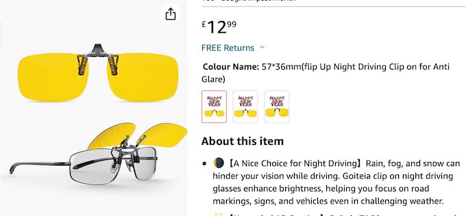

RobH Posted January 11, 2024 Report Posted January 11, 2024 1 hour ago, John Morrison said: can't see much likely hood of a see-change here I don't know whether that pun was deliberate or whether auto-correct was responsible but it made me chuckle. I've just seen these, and at the price it might be worth a try: Quote

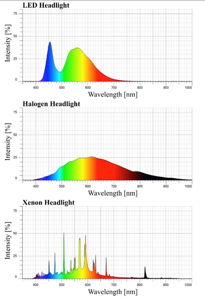

RobH Posted January 11, 2024 Report Posted January 11, 2024 (edited) 1 hour ago, Alfrom said: Surely tinted lenses simply reduce the intensity of ‘all’ light frequencies, so that the overall impression is on of less overall intensity. To an extent yes - but modern ultra-bright lamps tend to the blue end of the light spectrum which is why they look glaring white, so yellow lenses will attenuate that blue light while still allowing the yellower light from incandescent lamps to pass through. Halogen lamps produce a continuous spectrum of light which peaks at the redder end of the spectrum. LED and HID lamps give light with distinct peaks towards the blue end. The higher the 'colour temperature' the more the light tends to blue, and photon energy increases as wavelength shortens. Attenuating the blue light reduces the overall light energy markedly. Edited January 11, 2024 by RobH Quote

keith1948 Posted January 11, 2024 Author Report Posted January 11, 2024 8 hours ago, RobH said: Halogen lamps produce a continuous spectrum of light which peaks at the redder end of the spectrum. LED and HID lamps give light with distinct peaks towards the blue end. The intensity/wavelength graphs are really helpful in showing that LED headlamps have a larger peak in the blue end of the spectrum. It should be possible for headlamp manufacturers to coat their lamps with a film to reduce this peak if this is the cause of glare. Meanwhile it looks like yellow tinted specs might be able to reduce the blue light. I have some red tinted specs for use with a laser theodolite but the whole world becomes red. They would reduced blue glare but not for driving use. I am guessing but the depth of yellow colour in tinted specs will determine how much of the blue is filtered out. I don't know if a polarising filter would do anything. Somewhere I have some polarising filters for photography. I shall have to find them and see what they do if anything. Keith Quote

RobH Posted January 11, 2024 Report Posted January 11, 2024 2 minutes ago, keith1948 said: It should be possible for headlamp manufacturers to coat their lamps with a film to reduce this peak if this is the cause of glare. The blue peak is why the lights look so bright, so I very much doubt they will do that as there is then little difference from halogen. Quote
RobH Posted January 12, 2024 Report Posted January 12, 2024 I've just received the clip-on yellow lenses. The enclosed data sheet says they reduce blue light in the range 380 - 500 nm by 84% and overall light transmission, VLT, is 75% of normal. ( by contrast the quoted figures for silver-mirrored sunglasses are 86% and 11% respectively ). Sounds promising. Quote
