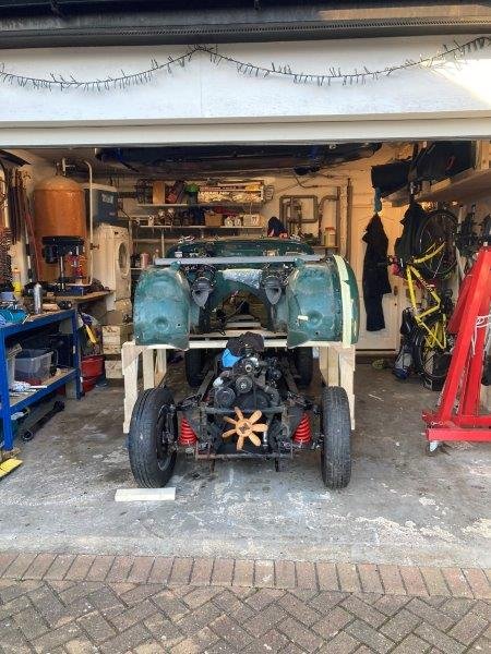

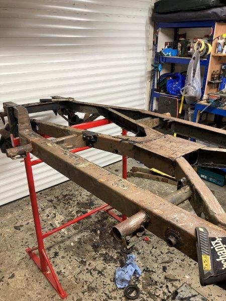

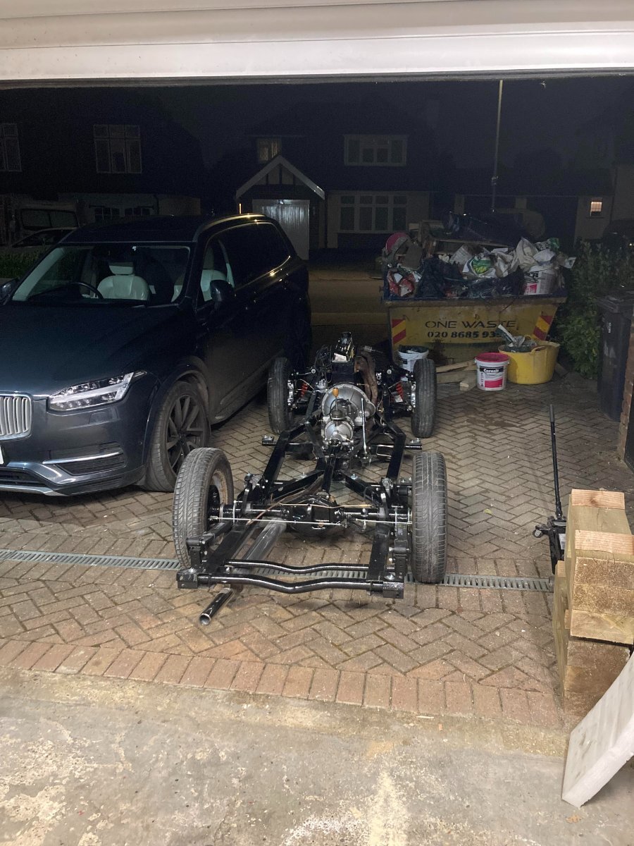

Ben Davies Posted January 23, 2024 Report Posted January 23, 2024 Hello, All. After a gap of 13 years or so I’ve rejoined the Register and bought myself another TR. Previously the owner of a TR6 (SLF 991L) that I sold on to Neil (ntc) and that was later restored by Marko at Classic Marks, I now have a TR3a. A couple of month ago I purchased 704 FTT - a car well-known to many on here as it had been in the ownership of Brian Chidwick, who sadly passed away last year, since 1977. Overall it’s in very good shape: solid, including in all the places where often they aren’t, and with a lovely patina that I don’t want to lose. It needs a suspension overhaul, new radiator and a couple of other things sorted, but the flaky chassis (a CTM unit that was powder coated when the car was restored in 2007) was going to need attention sooner or later. The coating has failed pretty much all over and is flaking; even where it hasn’t visibly failed, the surface is beginning to suffer underneath it. So I’ve bitten the bullet, taken the body off and will be giving it a decent refurb and recommission over the coming months. The good news is it’s all pretty solid… so should be a great car once done and i can’t wait to drive it. I’ve said it’ll be on the road for the summer. I’m just not saying which summer, obviously. I’ll try to post some progress reports on here as I go. And thanks in advance for all the sage advice! Cheers, Ben Quote

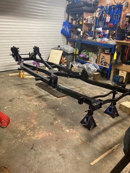

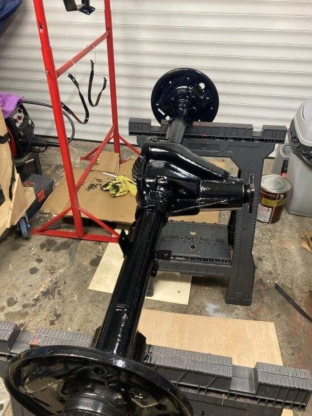

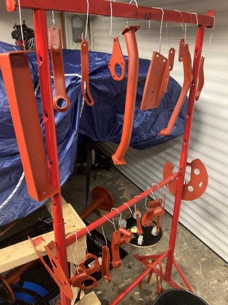

Ben Davies Posted April 16, 2024 Author Report Posted April 16, 2024 A quick update on progress with my TR3 while I wait for the rain to stop! Removed the body with no major drama. The chassis has been blasted, painted and is back on the stands being built up again. Gearbox and axle have been checked over, new seals fitted, cleaned / painted and all back together. Steering box is rebuilt and awaiting a coat of paint. Slowly working my way through painting all the brackets and fixings. Every time I think I'm done I find something I'd forgotten... Will turn to the body next but nothing major to do. A couple of minor repairs needed to the NS front inner wings (where the chassis mounting plate is sandwiched to it) and to the gutter of the OS front wing. That's the trickiest part I think: does anyone do a handy gutter repair section for the wings by any chance? Guess I might just have to make it. Thanks for all the help and advice so far! Quote

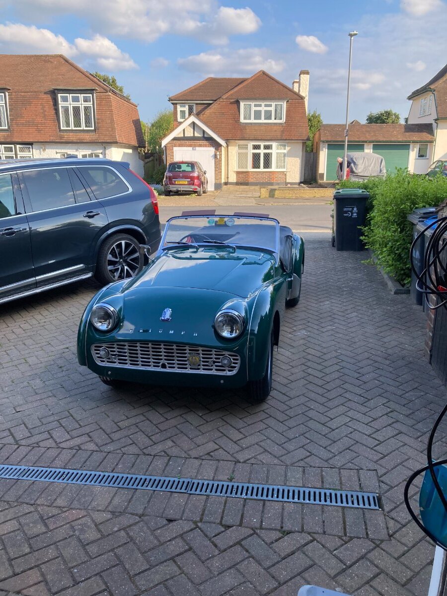

Ben Davies Posted April 30, 2025 Author Report Posted April 30, 2025 Bit of delay in posting an update on progress but it's a good one... car now finished and back on the road with a fresh MOT as of this week (bumper with number plate added since the photo). Thanks to those on here who've provided help and answers to questions - particular thanks to Rob Salisbury, who handily lives just around the corner and has been able to offer encouragement (and tools!) first-hand as he passes by walking Max the fantastic collie - cheers, Rob!! Been good fun getting it together and satisfying to get to this point. Now to put some miles on it. Hopefully see some of you out there this summer! Ben Quote
BlueTR3A-5EKT Posted April 30, 2025 Report Posted April 30, 2025 Welcome again Ben Will look out for you and the car through the summer Quote
Smithfire67 Posted April 30, 2025 Report Posted April 30, 2025 Well done done on the restoration! Car looks great. I have serious shed envy.... Clive Quote
