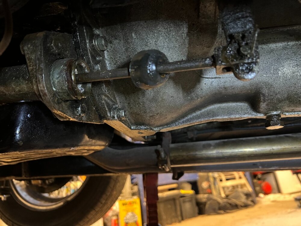

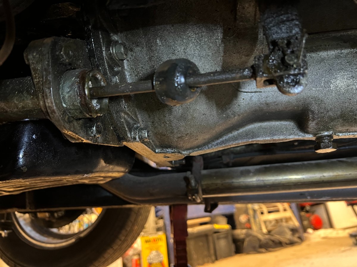

timpress Posted February 17, 2024 Report Posted February 17, 2024 (edited) Hello all, Looking for some advice on clutch hydraulics. My TR6 is a rolling rebuild and the clutch hydraulics were weeping so I decided to the hydraulics, Master and slave cylinders and as the pipe snapped both ends when removing a new hose and and pipe were also fitted. All was working ok before I did the work but now I dont have enough throw to engage the gears as can be seen by the video. Also as can be seen by the photo of the dirty slave, it was fitted the wrong side of the plate and also odd was that the master cylinder pushrod had a welded piece added. Any thoughts on what could be going on? Thanks Edited February 17, 2024 by timpress Added photo Quote
RogerH Posted February 17, 2024 Report Posted February 17, 2024 (edited) Hi Tim looking at the Moss WebCat the SC goes in from the front of the bracket. Is the push rod on the new SC the same length as the old SC!!! Should the Bracket be fitted to the front of the GB flange or the rear face !! Is it the correct SC - have you compared side by side. Roger Edited February 17, 2024 by RogerH Quote

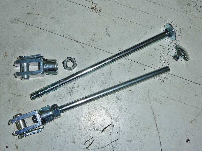

John L Posted February 17, 2024 Report Posted February 17, 2024 How is the clutch pedal free position compared to the brake pedal, is higher or lower? You may need to consider an adjustable MC pushrod, if that MC is new what is its length, the L/D drive push rod is shorter, (but same cylinder) and has been known to have been swapped, wrong part supplied. Using the adjustable pushrod will take out any wear in the hole in the pedal, and so will give you back the original stroke length for the MC. John Quote

timpress Posted February 17, 2024 Author Report Posted February 17, 2024 52 minutes ago, John L said: How is the clutch pedal free position compared to the brake pedal, is higher or lower? You may need to consider an adjustable MC pushrod, if that MC is new what is its length, the L/D drive push rod is shorter, (but same cylinder) and has been known to have been swapped, wrong part supplied. Using the adjustable pushrod will take out any wear in the hole in the pedal, and so will give you back the original stroke length for the MC. John The clutch free position seems lower than the brake before I get friction and hydraulic compression. Interestingly, this car was a European LHD many many years ago and was converted to RHD so I wonder if I have a different pushrod in the new master cylinder. I only know of adjustable slave cylinder pushrods, not master cylinder though its the master cylinder pushrod on mine that has been modified as per the photo. Seems I may need to take it all apart and do some measuring. Quote

timpress Posted February 17, 2024 Author Report Posted February 17, 2024 1 hour ago, RogerH said: Hi Tim looking at the Moss WebCat the SC goes in from the front of the bracket. Is the push rod on the new SC the same length as the old SC!!! Should the Bracket be fitted to the front of the GB flange or the rear face !! Is it the correct SC - have you compared side by side. Roger I beleive I have the SC on the correct side based on other photos and feedback. The SC pushrod is the original one so no issues with that though I may well go down the adjustable SC push road route. I havent checked the SC side by side but it was from rimmers and was a britpart with the correct Triumph part number. I think it a general part used an many vehicles based on my looking around, just with different OEM part numbers. Quote
RogerH Posted February 17, 2024 Report Posted February 17, 2024 Hi Tim, is the bleed screw at the 12-o-clock position on the SC. If not you will not be able to bleed it fully. Roger Quote
PodOne Posted February 17, 2024 Report Posted February 17, 2024 Hi Tim Here's my saga after I fitted the SC the correct way around it might give you some ideas. Andy Quote
Z320 Posted February 18, 2024 Report Posted February 18, 2024 Hi Tim, ask your wife of friend for assitance: how much way of travel does the lever on the clutch shaft? Take the rubber off from the slave cylinder --> does the stop clip limit the way of piston travel? To test this, don't push the pedal too strong. Where does the pedal stop? On the floor or before? Ciao, Marco Quote
JohnC Posted February 18, 2024 Report Posted February 18, 2024 (edited) 16 hours ago, RogerH said: looking at the Moss WebCat the SC goes in from the front of the bracket. My original Repair Operations Manual shows the opposite - the slave cylinder is inserted into the bracket from the back of the car. When mine was the other way round it was marginal - at full travel the slave piston was close to falling out of the bore. Now it's fine. But slave pushrod length has nothing to do with travel unless it results in the piston popping out. Cheers, JC Edited February 18, 2024 by JohnC Quote
RogerH Posted February 18, 2024 Report Posted February 18, 2024 Hi John, the MOss WebCat suggests that the SC goes in from thew front but the bracket is fitted to the rear of the GB flange https://www.moss-europe.co.uk/shop-by-model/triumph/tr5-6/clutch-transmission-drivetrain/clutch-systems/clutch-system-tr5-6-1967-76.html Roger Quote
JohnC Posted February 18, 2024 Report Posted February 18, 2024 (edited) 6 minutes ago, RogerH said: the MOss WebCat suggests that the SC goes in from thew front but the bracket is fitted to the rear of the GB flange I'm not disputing that. But the ROM shows the opposite. Really, it does. But my original Leyland Triumph TR6 Sports Car Parts Catalogue exploded diagram *implies* that the slave is inserted from the front (and its internals are inserted from the rear - go figure). My point is that the ROM has a sketch showing the slave in its installed position. JC Edited February 18, 2024 by JohnC Quote
RogerH Posted February 18, 2024 Report Posted February 18, 2024 Hi John, I'm sure I read somewhere that there was a conflict in the pictures but not sure which was correct. Roger Quote
JohnC Posted February 18, 2024 Report Posted February 18, 2024 (edited) 9 minutes ago, RogerH said: I'm sure I read somewhere that there was a conflict in the pictures but not sure which was correct. Fair enough. I can't claim the ROM is correct. As you say, it conflicts with the parts catalogue. And my slave came with a machined face on the back (i.e. "insert from the front") but that didn't work for me. But knowing that one has a choice may help somebody. FWIW my Haynes manual also has a sketch showing the slave inserted from the back. I'm not sure if that's good or bad! [edit} and it shows the bracket in front of the engine back plate! Cheers, JC Edited February 18, 2024 by JohnC Quote
RobH Posted February 18, 2024 Report Posted February 18, 2024 Operationally it doesn't matter how it is mounted - it just means the rod length needs to be different, to suit. I expect Tim fitted the new one the same way as the original - which worked with that altered rod. Quote
RogerH Posted February 18, 2024 Report Posted February 18, 2024 Hi John I have picture here numbered 33.15.01 where the SC is being bled and the SC is on the rear of the bracket. Also 33.35.01 is on the rear. Fitting as per the ROM makes sense as the bolts are simply locating and not taking all the pressure Roger Quote
JohnC Posted February 18, 2024 Report Posted February 18, 2024 5 minutes ago, RogerH said: Fitting as per the ROM makes sense as the bolts are simply locating and not taking all the pressure I hate it when somebody brings logic to an opinion party! That was a joke BTW. Good point. And same to Rob. If it works, chill... JC Quote
Z320 Posted February 18, 2024 Report Posted February 18, 2024 (edited) 57 minutes ago, JohnC said: My original Repair Operations Manual shows the opposite - the slave cylinder is inserted into the bracket from the back of the car. When mine was the other way round it was marginal - at full travel the slave piston was close to falling out of the bore. Now it's fine. But slave pushrod length has nothing to do with travel unless it results in the piston popping out. Cheers, JC It can’t popp out, there is a stop clip. If the slave cylinder is to far in driving direction, or the rod too short, the way of travel of the piston is limited by the clip. Simple to make an individual rod with a M8 fork head and a M8 bolt to push the piston deeper in the slave. Not to the end, stop 6-8 mm before fully in for the wear out of the friction plate! If this is the problem!!! Ciao, Marco Edited February 18, 2024 by Z320 Quote

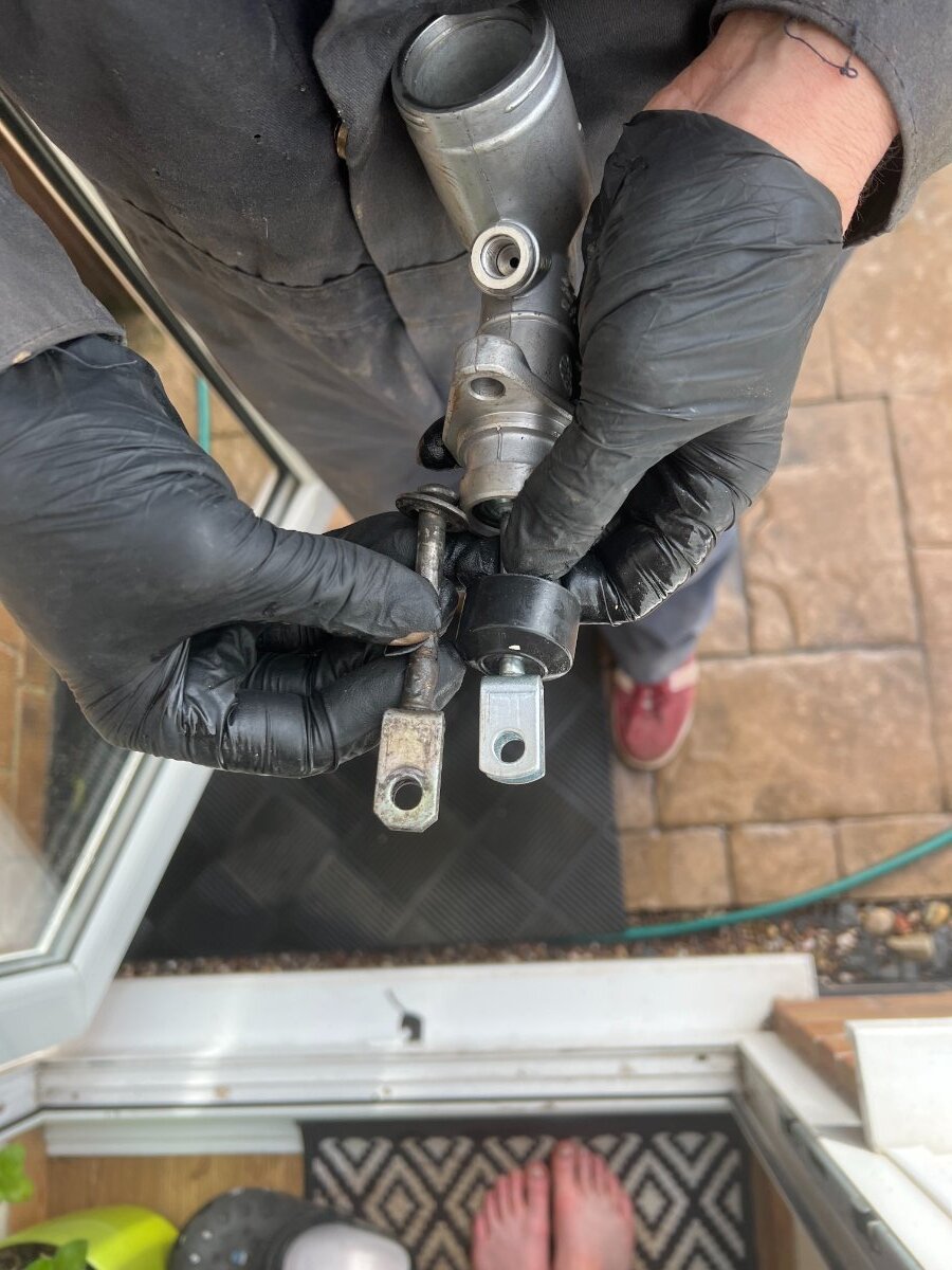

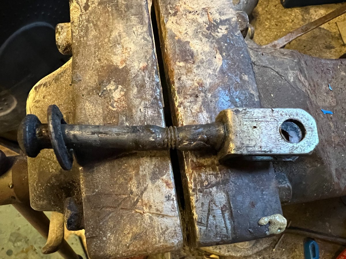

timpress Posted February 18, 2024 Author Report Posted February 18, 2024 (edited) Thought I'd bring closure to the topic now I fixed it and let all know what got it working. I needed to use the original modified master cylinder push rod as it was around 10mm longer (see photo) and engaged the pedal at a higher position. The photo is before I removed the new pushrod and measured but this quick check proved my thoughts. Not sure why the master cylinder pushrod was modified but clearly whoever had the car in the past had to work on the hydraulics and had the same issue and modified it. Any way, all good now and thanks all for the advise. Edited February 18, 2024 by timpress Quote
