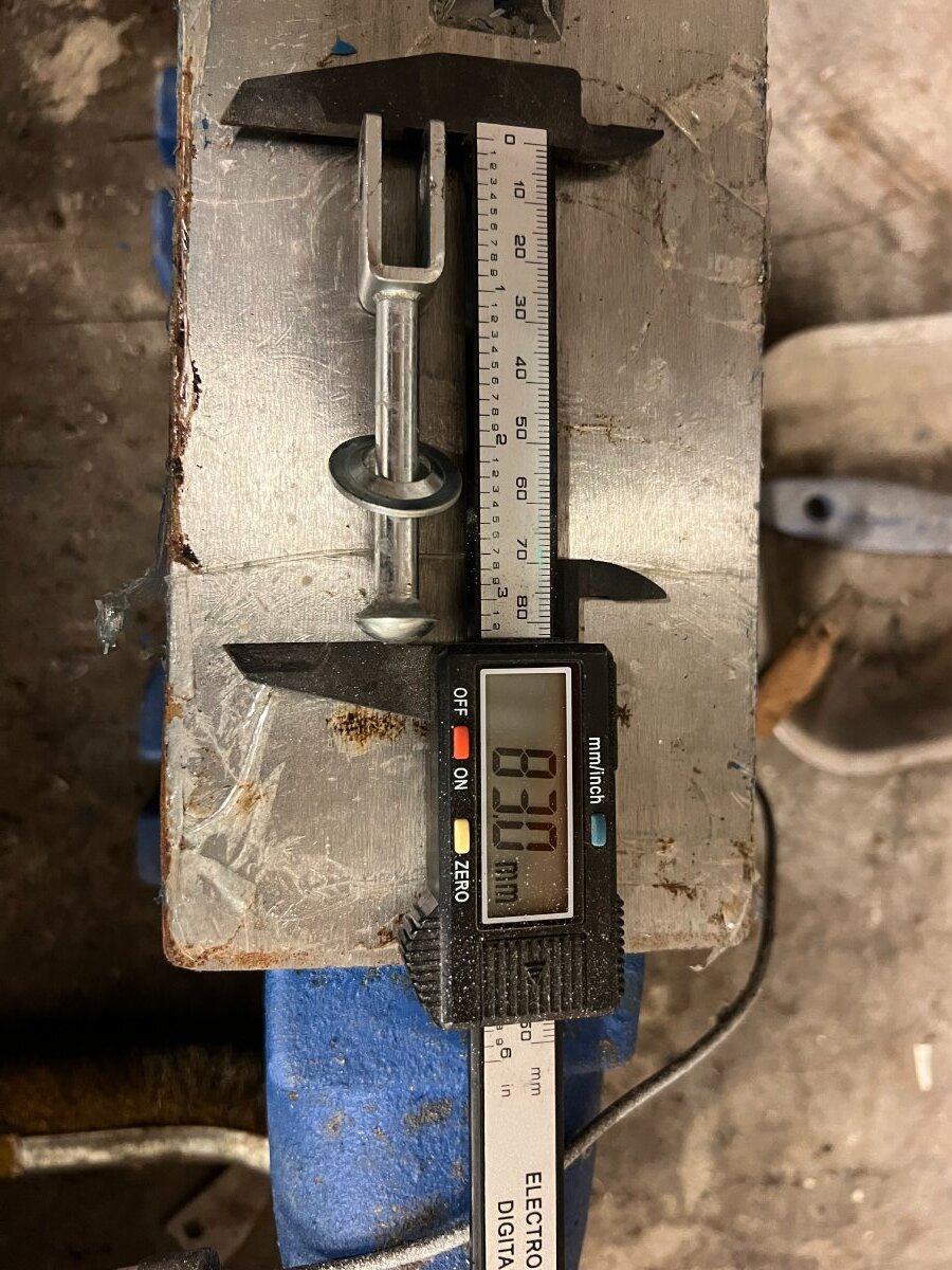

John L Posted February 18, 2024 Report Posted February 18, 2024 Could you measure the 2 pushrods please, it would be good to have a locked topic on this issue of the clutch parts for the 5 & 6, left and right hand drive as this does seem to come up quite often. Quote

CharlieBubbles Posted February 19, 2024 Report Posted February 19, 2024 15 hours ago, timpress said: Thought I'd bring closure to the topic now I fixed it and let all know what got it working. I needed to use the original modified master cylinder push rod as it was around 10mm longer (see photo) and engaged the pedal at a higher position. The photo is before I removed the new pushrod and measured but this quick check proved my thoughts. Not sure why the master cylinder pushrod was modified but clearly whoever had the car in the past had to work on the hydraulics and had the same issue and modified it. Any way, all good now and thanks all for the advise. Interesting following the paths of POs in this area. I changed a ‘wrong’ 0.75 master cylinder for a ‘correct’ 0.70 and immediately realised why the PO had done it as the reduced clearance exposed a knackered clutch plate! Things happen for a reason… Quote
timpress Posted February 19, 2024 Author Report Posted February 19, 2024 (edited) 15 hours ago, John L said: Could you measure the 2 pushrods please, it would be good to have a locked topic on this issue of the clutch parts for the 5 & 6, left and right hand drive as this does seem to come up quite often. Unfortunately I have it all assembled with the my 'old' modified pushrod now back in place but with information sharing key to keeping these machines on the road and as asked, please find the new (unused) push rod length +-83mm and the old one about 10mm longer at +-93mm. It made the world of difference. Edited February 19, 2024 by timpress Quote

John L Posted February 19, 2024 Report Posted February 19, 2024 (edited) Could the moderators please make this a fixed topic in the 6 forum please. Clutch Information. Clutch master cylinder pushrod length for R/H drive should be overall length 93mm either 0.75" or 0.70" Clutch master cylinder pushrod length for L/H drive should be overall length 83mm Slave cylinder bracket should be mounted on the front of the engine backplate. The slave cylinder should be inserted from the rear of the bracket, with the bleed screw uppermost for effective bleeding The slave cylinder push rod should be from the end to the centre of the pin hole 14,5mm 138572. John Edited February 19, 2024 by John L Quote

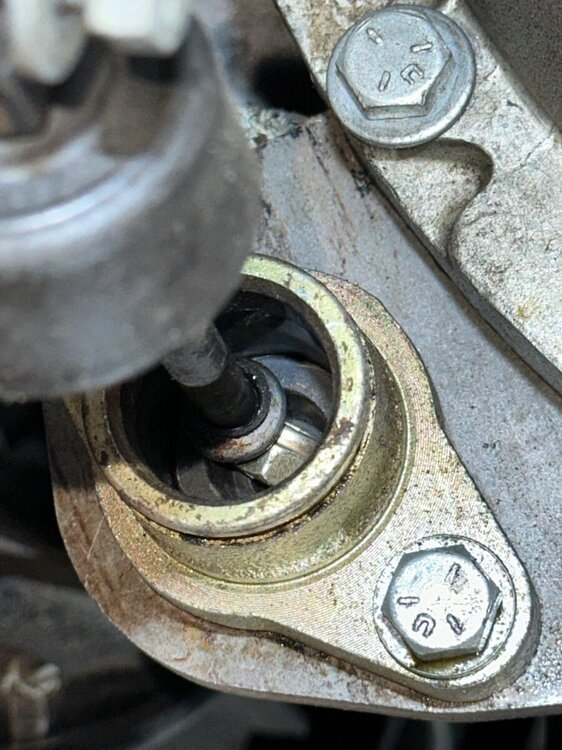

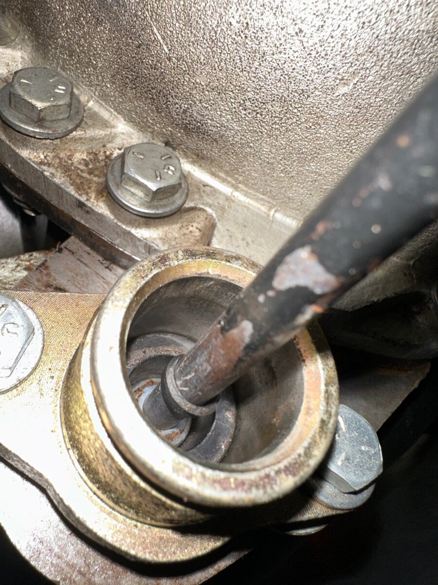

BaulyCars Posted March 7, 2024 Report Posted March 7, 2024 (edited) May or may not be the same cause as your issue Tim, but I found an 'additional nut mod' inside my SC, without which the clutch/gearbox would crunch. I removed it but just ended up having to space out the SC using a bunch of washers... No doubt not the right way, but a temp fix. Edited March 7, 2024 by BaulyCars Quote
Z320 Posted March 7, 2024 Report Posted March 7, 2024 I see no clip or washer to hold the push rod and piston back in the slave cylinder…. Quote
BaulyCars Posted March 7, 2024 Report Posted March 7, 2024 (edited) 15 minutes ago, Z320 said: I see no clip or washer to hold the push rod and piston back in the slave cylinder…. I missed it too at first, but there was a nut in there..., actually quite a nice nyloc one, which I kept for other things Or you mean its missing something else (apologies if I'm misunderstanding) Edited March 7, 2024 by BaulyCars Quote
BaulyCars Posted March 7, 2024 Report Posted March 7, 2024 (edited) I don’t see one, the bore wall is smooth without any recess. When fixing it I was freely able to remove both the rod and the cylinder. I suspect this is wrong? Edited March 7, 2024 by BaulyCars Quote
stuart Posted March 7, 2024 Report Posted March 7, 2024 4 hours ago, BaulyCars said: I don’t see one, the bore wall is smooth without any recess. When fixing it I was freely able to remove both the rod and the cylinder. I suspect this is wrong? A lot of TR6 type slave cylinders are like that. When Pinky burnt his clutch out on the way to Malvern one year he lost that much throw on his slave cylinder the rod did drop out. I managed a temporary fix in the car park by changing the slave cylinder to the back of the mounting plate and re-bleeding the system and he got to the show and back home with his clutch bite point on the floor. When stripped the clutch plate looked like a metal fan as all the lining material was gone! Stuart. Quote
BaulyCars Posted March 7, 2024 Report Posted March 7, 2024 4 hours ago, stuart said: A lot of TR6 type slave cylinders are like that. When Pinky burnt his clutch out on the way to Malvern one year he lost that much throw on his slave cylinder the rod did drop out. I managed a temporary fix in the car park by changing the slave cylinder to the back of the mounting plate and re-bleeding the system and he got to the show and back home with his clutch bite point on the floor. When stripped the clutch plate looked like a metal fan as all the lining material was gone! Stuart. OK so mines probably normal, good to know. Haha, superb! Quote
Z320 Posted March 7, 2024 Report Posted March 7, 2024 On my TR4A the slave had the groove, spring wire clip, washer, adjustable push rod. Clutch problem is mainly a TR6 problem. Ciao, Marco Quote
87bor Posted March 21, 2024 Report Posted March 21, 2024 Have you checked any play at the master cylinder. The pushrod should be 81mm from end of spigot to the centre of the clevis pin hole. Also there may be play in the pedal lever. The hole become oval over time and you lose 5 to 10mm of throw on the pedal. The photo proves my point. New master cylinders are sent out with the wrong length push rod. You can go round and around incircles before realising this could be your problem. Because it's new you assume it must be OK. Your issue could also be down to a dodgy clutch assembly. I live in New Zealand and many of us are reliant on Rimmer Bros for our parts. Unfortunately the quality of their items has gone downhill over the years to the point that we are afraid to order from them anymore. We search for old parts at the Vintage Car Club and restore them whenever possible. You can put up simple things like ill fitting dashboards and door cards, radiator overflow bottles with no thread (so the lid won't stay on), but when you buy their clutch kit and spend months bleeding the hell out of the system trying to get the gears to engage it can become extremely time wasting, frustrating and downright depressing when faced with having to pull the gearbox out again. Luckily we have a clutch specialist in Christchurch who can rebuild clutches to a standard better than the original. I would recommend anyone with the option to use someone like this as opposed to buying new. Doesn't matter if it says Laycock or Borg and Beck on the box, that junk comes from China and you will be playing Russian Roulette. Maybe it works and maybe it doesn't. If you lay an old original borg and beck clutch against a new one you can see the difference in quality. The pressure plate is lighter and the fingers are thinner. Release bearings are again a low quality reproduction. I was so fed up with sticky clutches in my TR6 that I ripped the Triumph gearbox and clutch out and installed a Toyota W58 five speed conversion. It transformed the car. That was 13 years ago and it has been maintainance free ever since ......and no oil leaks! Just like you, a friend of mine has been going through hell with a new Rimmers Clutch in his newly restored TR5. The car is undrivable. Having just installed a brand new interior he has to rip the gearbox out and find out why the clutch is so hard and snatchy and won't engage cleanly. He should take the clutch to the specilist and have it assessed and if it is shown to be substandard consider suing Rimmers. I have always been suspicious that they send seconds or returned items overseas because they know we won't pay the courier fees to return them. Go onto the Trustpilot website and look up Rimmers and you can see how dreadful their reviews are. https://nz.trustpilot.com/review/rimmerbros.com. Just like Booking.com any positive reviews are most likely fake. Quote
