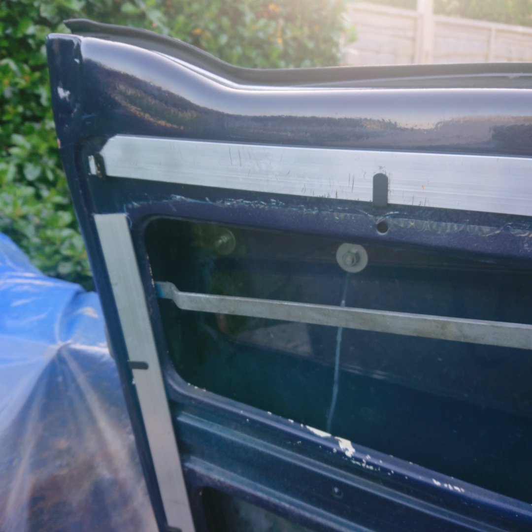

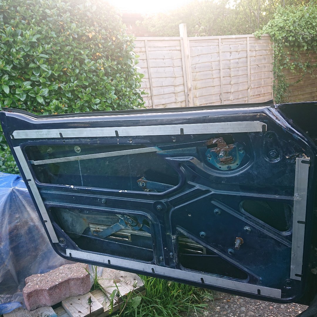

Anyway,   I thought it sounds good, so I'm giving it a try.   Today's effort in pictures, to be followed by glueing tomorrow.

Right then.   What I have learned:-
gorilla contact adhesive is useless, unless it goes somewhere you don't want, then it is excellent.
Evostick works well.
The corners of the card leave a bit to be desired because they are not fixed to anything. Maybe some other ali strip fitted to the main ones (not sure how).
 If you have piping on the trim,   this needs to be very securely fitted to the main card covering, because the piping is the main bit sticking to the aluminium strips. Probably best to stick the piping all down with evostick before doing the main fitting.   The little staples fixing the piping on my card are popped out all over the place.
In the WSM it shows two screws fixing the ends of the door card pocket onto the door frame.   Not sure if this is just a 4 thing or should be on a 4A, anyway they were missing on mine, but I'm putting them on because the end of the pocket was not particularly well fixed to the card (the little staples again).
I've fitted the passenger card, all seems well. The proof will be when I need to take it off again, hopefully all the clips and ali strips and card  will all come off in one piece.
