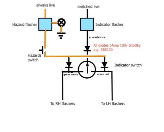

RobH Posted May 25, 2024 Report Posted May 25, 2024 (edited) Pretty easy to do Jim with minimal change to the existing wiring - new electronic type flasher unit, switch , 3 diodes and a warning lamp. New wiring shown orange. You would need a diode as shown inserted in the green/brown wire from the existing flasher to the indicator switch. This stops a back-feed if the indicator switch is operated when the hazards are on: Edited May 25, 2024 by RobH Quote

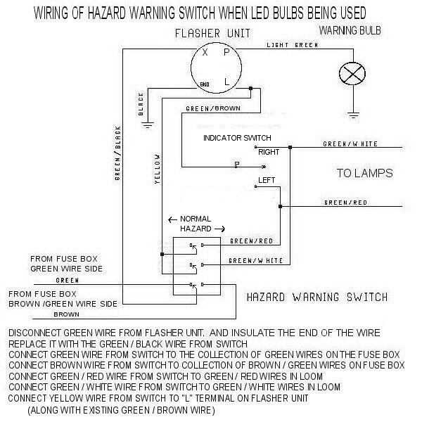

Lebro Posted May 25, 2024 Report Posted May 25, 2024 If you have led indicators, or, even just an LED compatible flasher unit all you need to do is this: Add one toggle switch 3 way change over (https://www.ebay.co.uk/itm/131898614717, or https://www.ebay.co.uk/itm/264269001947) and wire in as shown above. Simples Bob Quote
Tr4aJim Posted May 25, 2024 Author Report Posted May 25, 2024 Ah, Bob I forgot to mention that I do have LED indicators. Oh, and “simples”?!?! You have no concept how quickly I can turn wiring into a “dog’s breakfast”! Would the fact that I’m using LED bulbs impact any of the other suggestions (thanks for those), or is Bob’s diagram the only workable alternative for LEDs? Also can I use the same type flasher I’m using for the indicators, or does the hazard function require a different type? Thanks, Jim Quote
RobH Posted May 25, 2024 Report Posted May 25, 2024 My circuit works with LEDs provided you use a suitable flasher unit - and yes you can use the same type of flasher unit as your present one. Quote

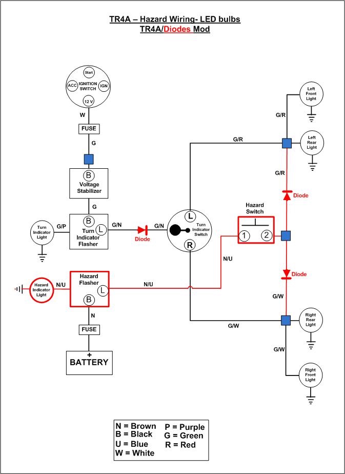

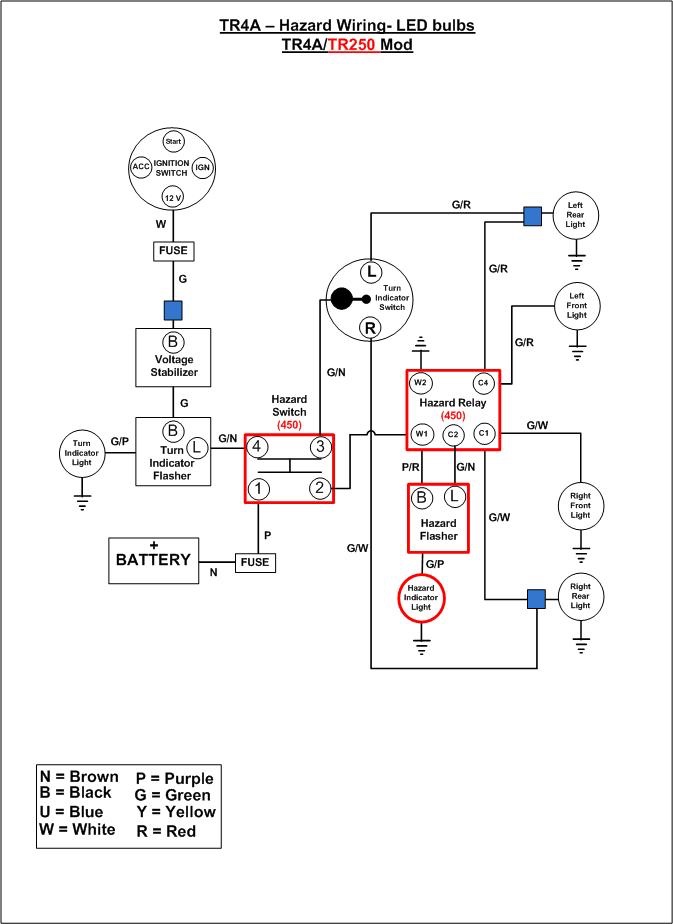

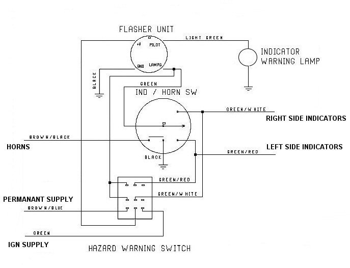

Tr4aJim Posted May 26, 2024 Author Report Posted May 26, 2024 Well here are my first attempts of trying to decipher wiring plans for adding hazard flashers to my 4A. The first picture is my attempt to merge the 4A wiring with the TR250 hazard wiring. The reason I tried this route was I figured I could buy an off the shelf 250 hazard switch and relay (and buy another flasher unit like I’m using currently for indicators). The second picture is my attempt to redraw the diode based diagram Rob provided. As I mentioned previously, I didn’t understand how the diagram Bob provided would interface with the 4A wiring, so that’s on hold. Anyway, please give these a look over and see if I’m anywhere near a viable option. BTW - I contacted two sellers on eBay.US that we’re offering the Lucas type kits. Both were based in the UK, and neither would ship to the US! Did we somehow offend the UK postal system? thanks! Jim Quote

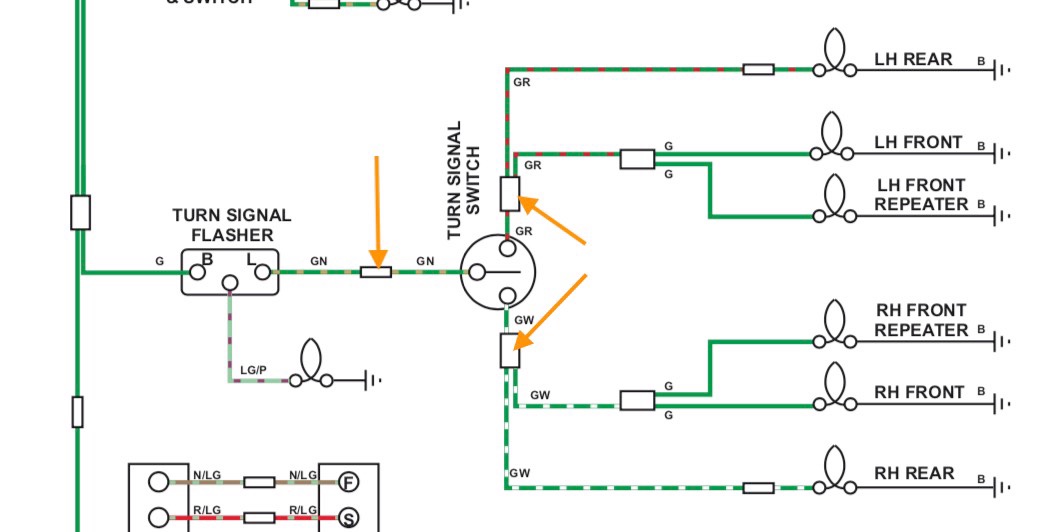

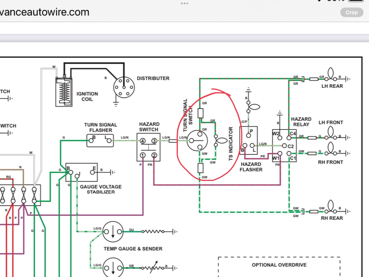

RobH Posted May 26, 2024 Report Posted May 26, 2024 This is part of the Advance Autowire schematic. The oblong blocks arrowed are existing bullet connectors and are easy break-in points to the wiring. You can simplify your first drawing a bit if you use those. I don't know where they are located on a '4A though. Quote

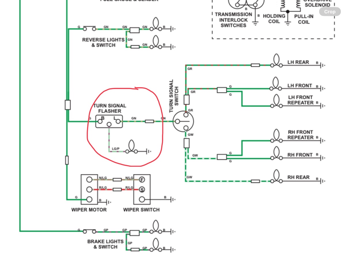

Tr4aJim Posted May 27, 2024 Author Report Posted May 27, 2024 (edited) Rob, yes thank you. I have the Autowire 4A and 250 diagrams. I tried to merge the two, and that’s how I came up with my 250 based diagram. Right now it’s more of a “flow tree”, but once the circuitry paths make sense, I’ll use as many existing connectors as I can. One thing I did notice was the 4A has the turn indicator light connected directly to the turn signal flasher (first diagram). However the 250 has the turn indicator light connected off the turn signal switch (second diagram). Not sure why the 250 moved it off the turn signal flasher, unless it had to do with the hazard switch being between the flasher and the indicator switch. cheers Jim Edited May 27, 2024 by Tr4aJim Quote

Lebro Posted May 27, 2024 Report Posted May 27, 2024 (edited) You realy don't need any form of kit, or special "hazaed" flasher unit. With your existing set up all you need is some simple switching to connect the left & right side bulbs together, & also to the output of the existing flasher unit. All you need to obtain is a switch & perhaps some wire. The diagram I showed above is how to wire into the "standard" TR3 circuit showing the existing horn push etc, I can see it could be confusing. Try this one ! I hope that makes it clearer. (wire colours are optional, these are colours I used recently to provide a kit to a fellow TR owner over here) Bob Edited May 27, 2024 by Lebro Quote
RobH Posted May 27, 2024 Report Posted May 27, 2024 8 hours ago, Tr4aJim said: Not sure why the 250 moved it off the turn signal flasher, Triumph went to a two-terminal indicator flasher unit for the '250 and '6 - presumably because it was a few pennies cheaper - but that meant they had to use an odd arrangement for the dash tell-tale lamp (which doesn't work if you swap to LED bulbs and needs a work-round) . Nothing to do with the hazard flasher. It won't affect what you want to do - there's no need to change to that arrangement. Quote
