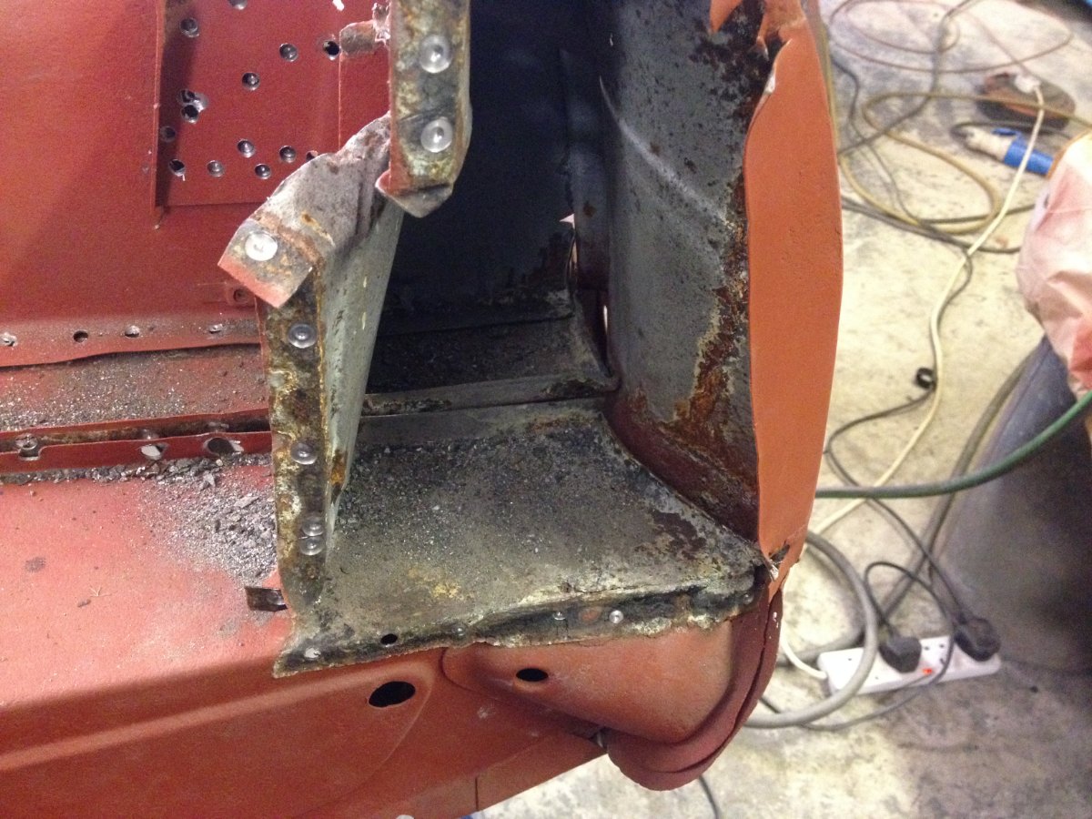

stuart Posted September 9, 2024 Report Posted September 9, 2024 1 hour ago, roy53 said: Are they not acid not the heat system? They do the heat then acid dip, Ive had a couple of shells done there but what I found was all the paint/filler debris after the dip collected in the box sections and in between seams. Luckily both of them I had to nigh on dismantle the whole shell to repair anyway so cleared it all out but I dont know how inert that would be in the long run if left. Stuart. Quote

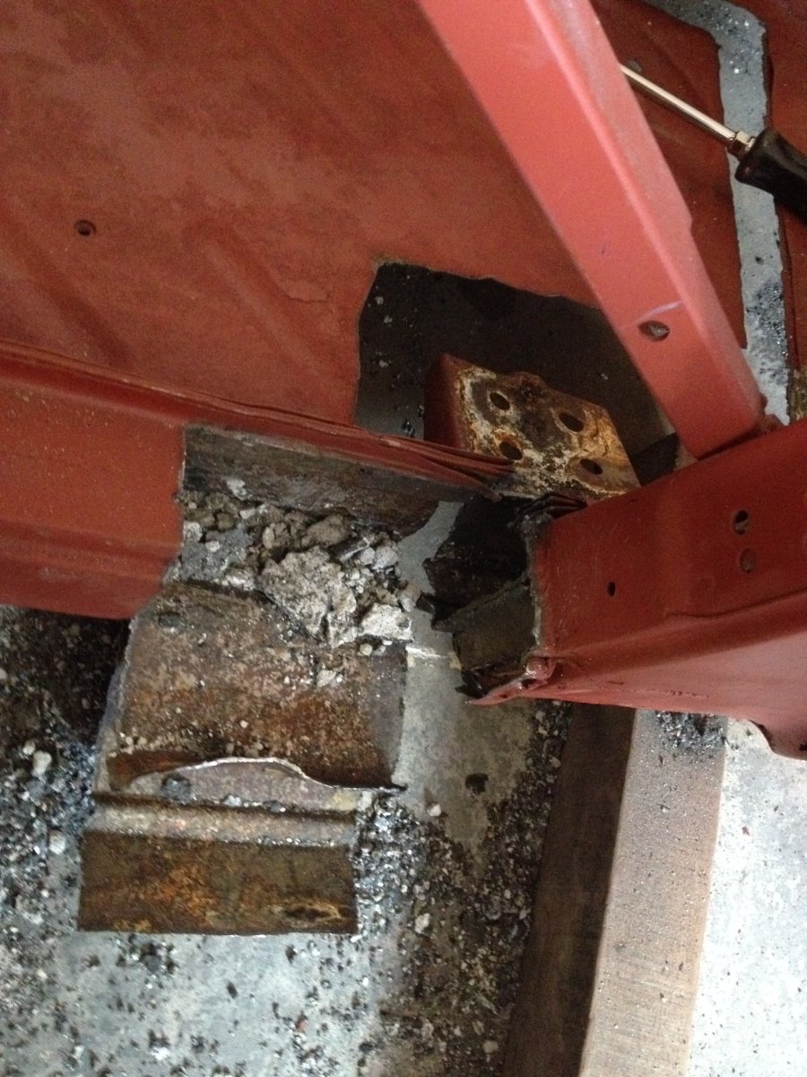

TR4Tony VC Posted September 9, 2024 Report Posted September 9, 2024 11 hours ago, stuart said: They do the heat then acid dip, Ive had a couple of shells done there but what I found was all the paint/filler debris after the dip collected in the box sections and in between seams. Luckily both of them I had to nigh on dismantle the whole shell to repair anyway so cleared it all out but I dont know how inert that would be in the long run if left. Stuart. I found similar inside a chassis in various places and had to hook it all out with a long rod and a wood chisel. Quote
stuart Posted September 10, 2024 Report Posted September 10, 2024 12 hours ago, TR4Tony VC said: I found similar inside a chassis in various places and had to hook it all out with a long rod and a wood chisel. Problem is whether that debris is still holding any chemicals from the dip and whether in future any water ingress would then leach it out as your never going to be able to open all of the enclosed box/panel sections to be able to get it all out. Stuart. Quote

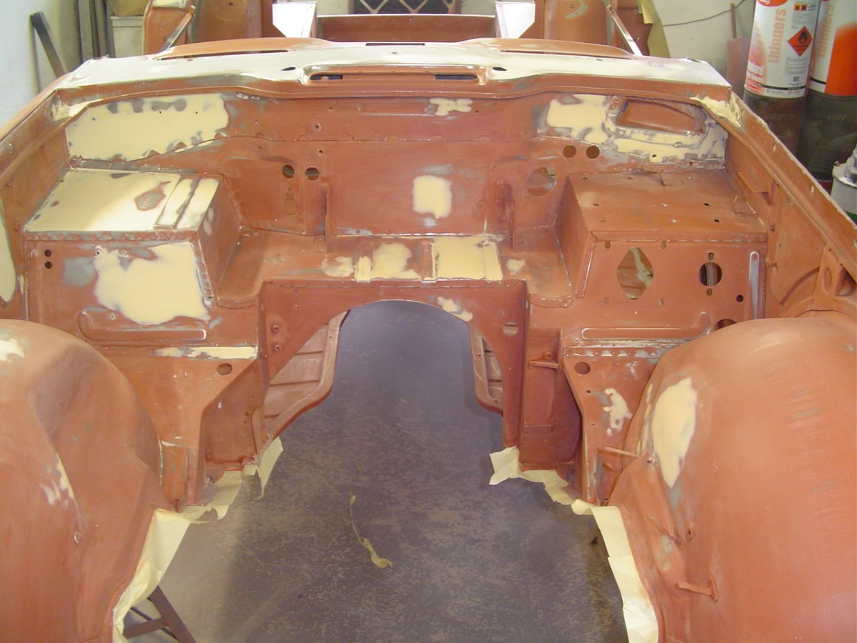

John Morrison Posted January 6, 2025 Report Posted January 6, 2025 Following on from the wisdom imparted here. Two quick questions, can you put a blocking coat of fillerover keyed Bondarust, and does anyone have a recommendation for which filler to buy/or not to buy? John. Quote
stuart Posted January 6, 2025 Report Posted January 6, 2025 21 minutes ago, John Morrison said: Following on from the wisdom imparted here. Two quick questions, can you put a blocking coat of fillerover keyed Bondarust, and does anyone have a recommendation for which filler to buy/or not to buy? John. Yes you can, its what I do, I stick with UPOL products, I use UPOL D for main filler and their EPOXY 3 for fine finishing. Stuart. Quote

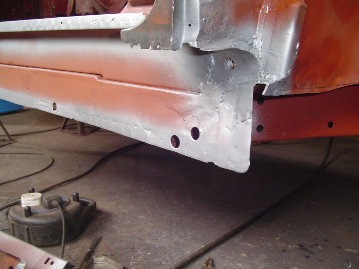

TR4Tony VC Posted March 5, 2025 Report Posted March 5, 2025 Hi Dave I think using a weld thru primer like NOVOL works well as you don’t have to remove it to weld in repairs. Bondaprimer is very good, but you need to get it off to weld reasonably, so I’d say put that on after repairing so that there is a good coat of primer on there. NOVOL (as most etc primers I think) is very porous, so metal will go off eventually. Regards Tony Quote
