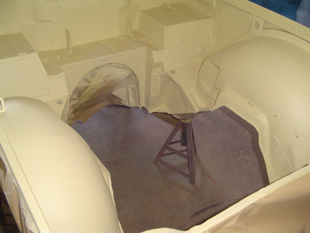

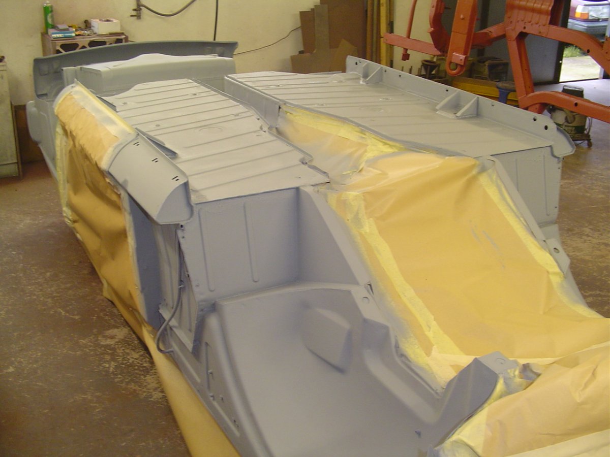

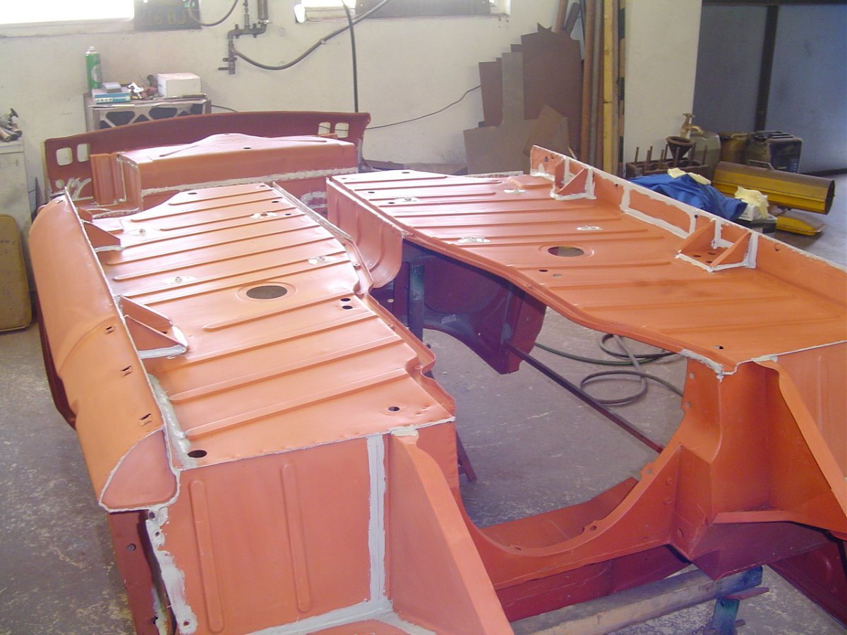

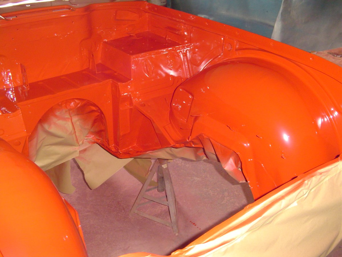

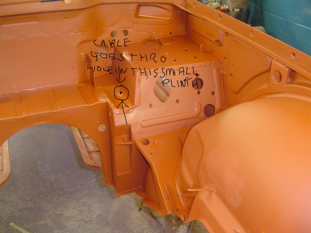

This is how I do it.

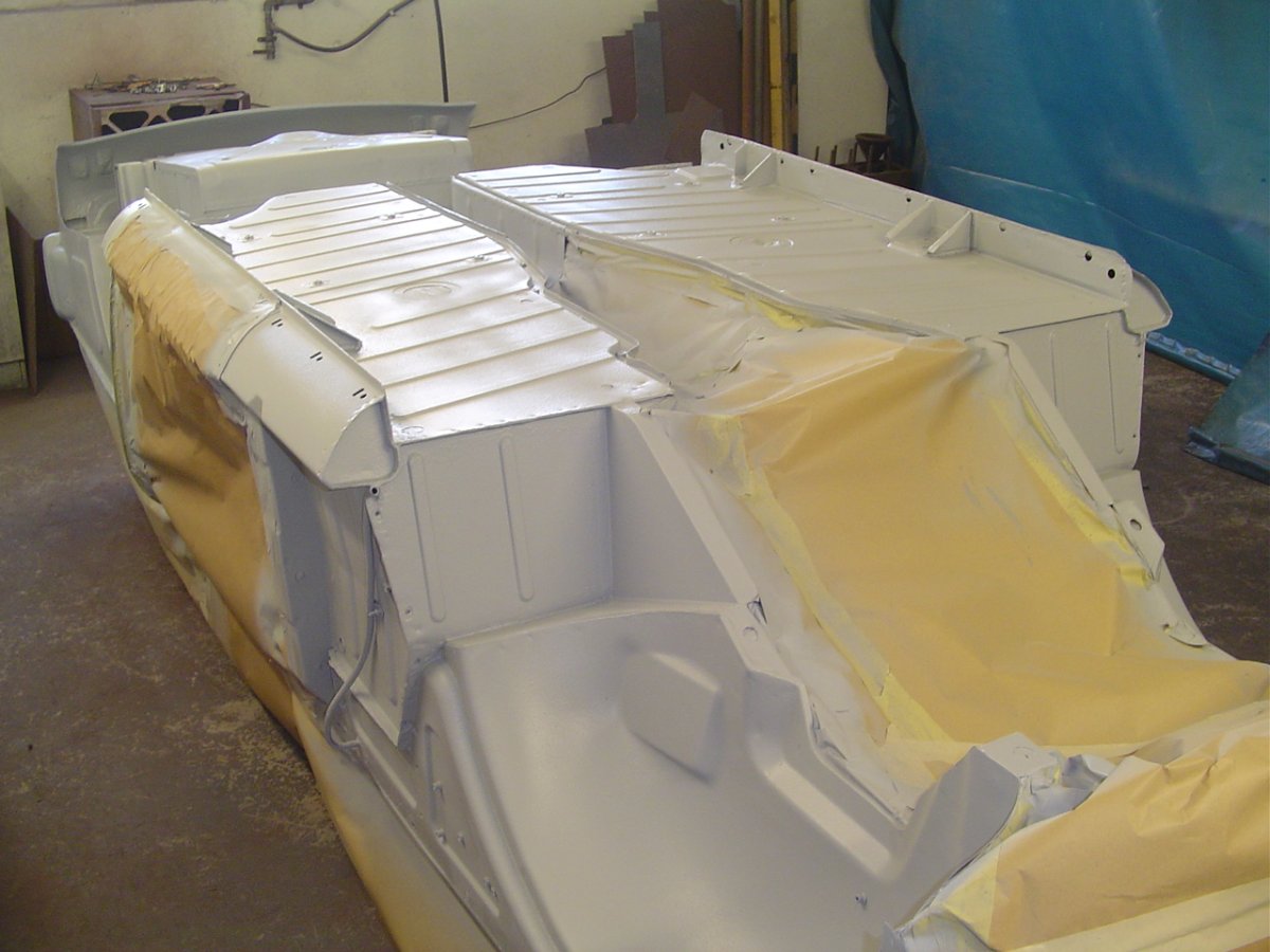

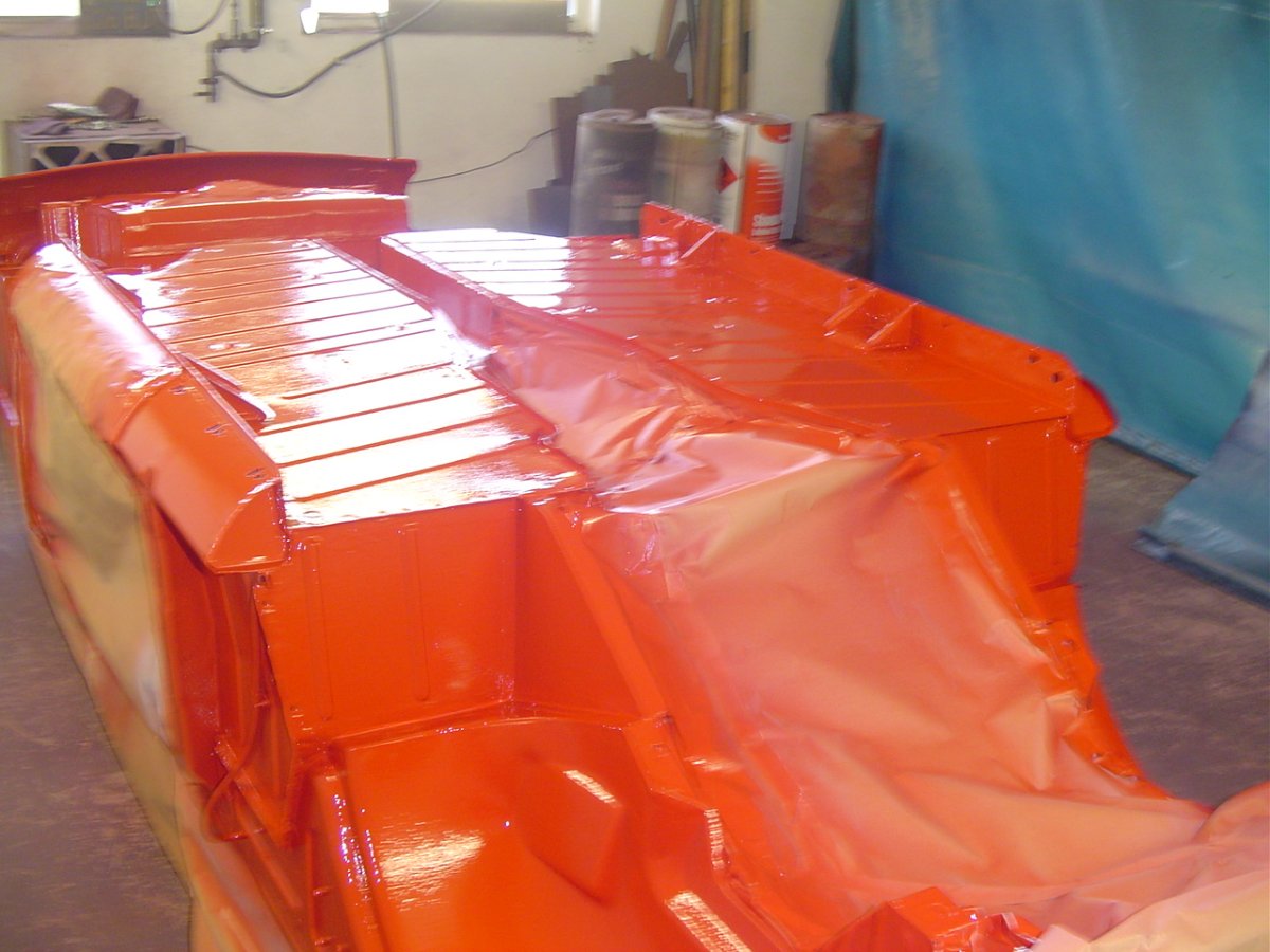

Bondarust all over first so it goes into all the seams etc then seam seal everything, I prefer to brush it on so you can get it right into the seams and then smooth it out. Then stone chip then 2k primer then top coat.
