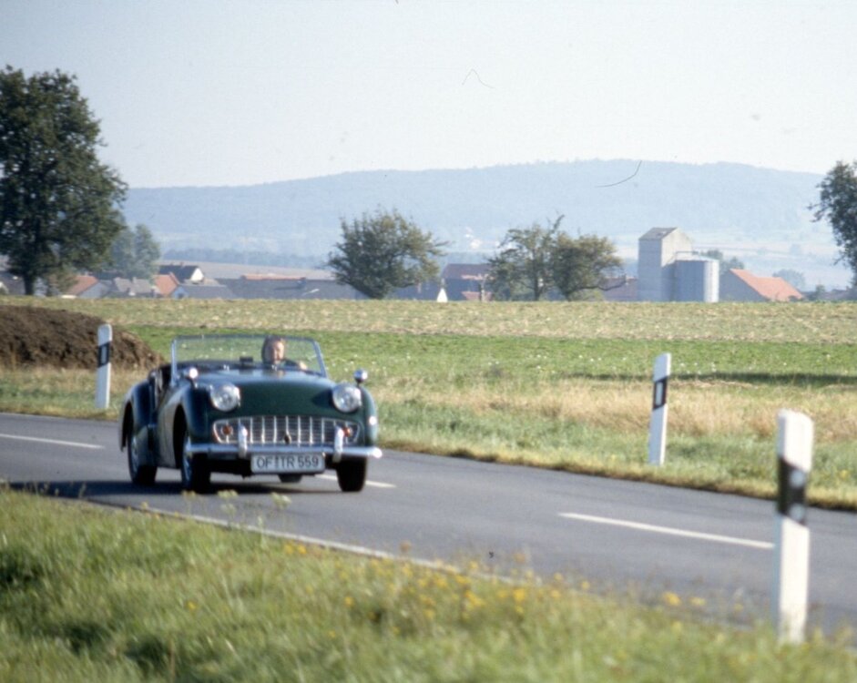

My wife Birgit and I were looking for a new "used" car in 1984. My wife's work colleague at the time had a lot to do with old cars, furniture and flea market items and suggested we look for a classic car.
We really liked the idea and it soon became clear that it had to be an English Vehicle.
After delving into the classic vehicle scene and the prices at the time, we chose a Triumph TR3.
The search began. We drove all over Germany for half a year, even going to Milan in Italy to find our TR3. We finally found it just 15 km from our home in Frankfurt. There we had the choice between a TR3 and a TR3A, which had just been imported from California. At the time we gave the TR3A priority over the drum-braked TR3 because of its disc brakes.
Arrived at home
Now that we were the owners of a TR3A, we had to complete all the official procedures to be allowed to drive the TR on German roads. The German TÜV (MOT) was the biggest obstacle, but this was solved after a few repairs to the wiring harness, tuning the engine and converting the headlights to German standards.
Our TR adventure could begin.

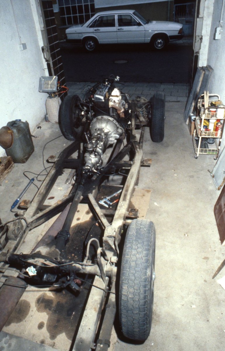

The first restoration!

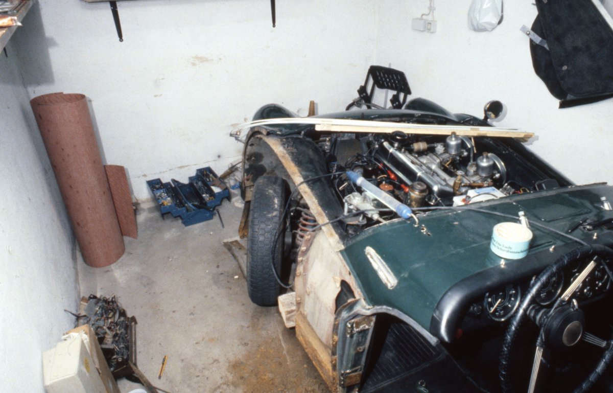

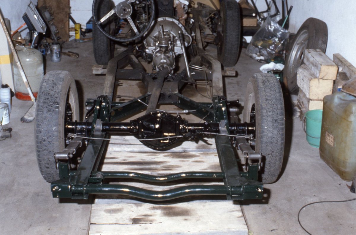

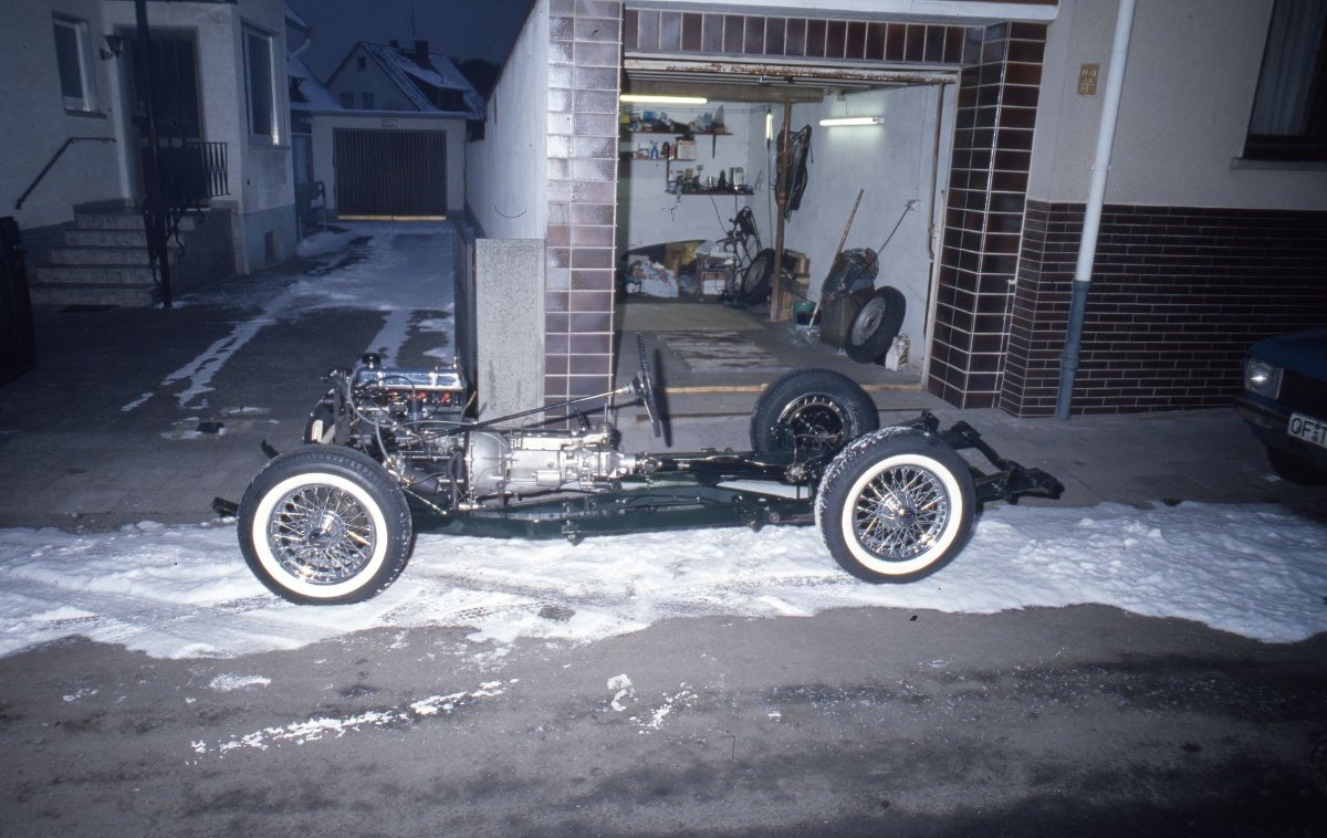

I was 27 years old at the time, had always tinkered and worked on cars, but a restoration like this was new to me and a challenge.

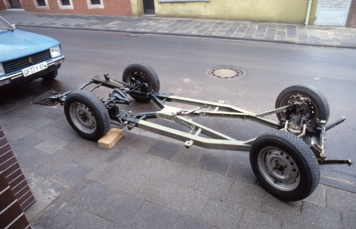

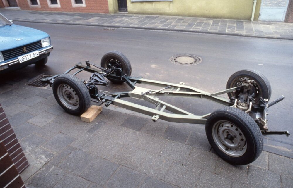

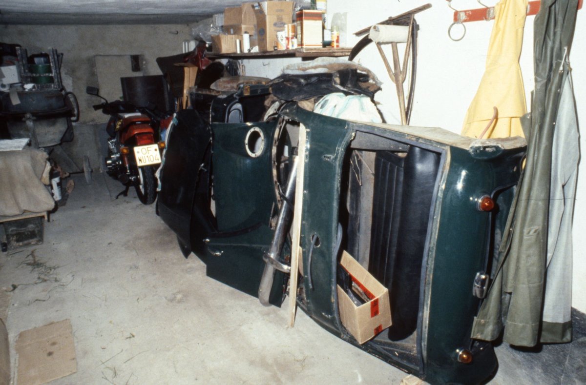

It started in the fall of 1985 and would take a year. The TR3 was disassembled, and the frame and all parts were cleaned (with a wire brush, a lot of manual labor and sweat). Afterwards, a particularly resistant "truck primer" was applied to the frame and then painted black with a brush.
At that time, I met a lot of people my age who had also recently bought a TR and were also restoring it. This meant we could exchange ideas.
Looking back, we did a lot of the work in a very amateurish way, but it took us across Europe for 40 years.

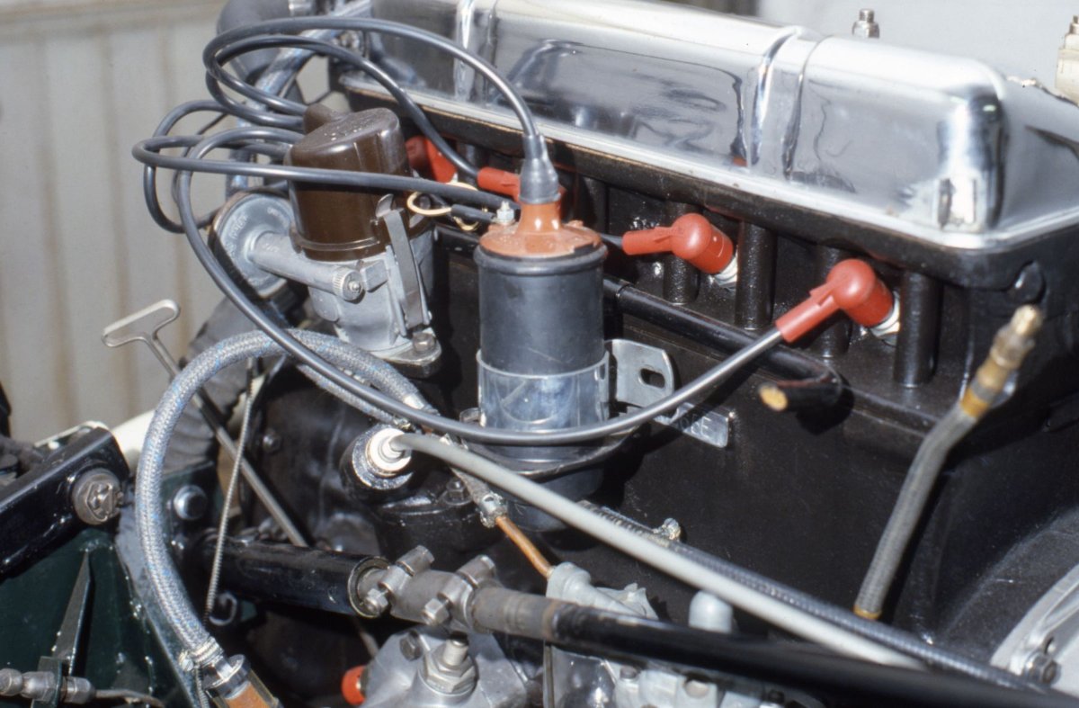

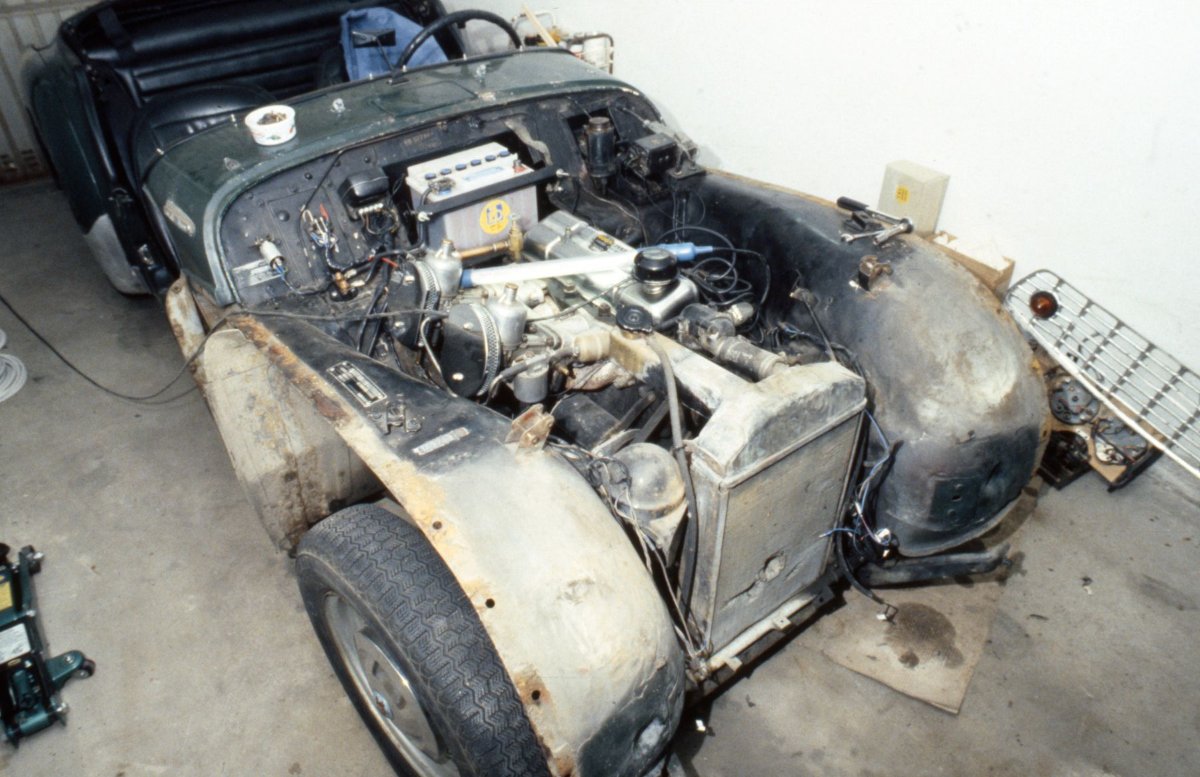

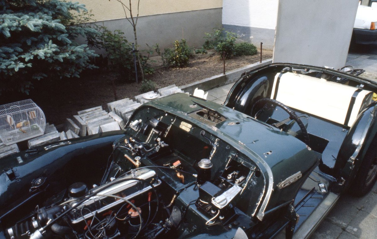

At this point I had not overhauled the engine, only cleaned and painted. Only auxiliary units such as the water pump etc. were replaced and of course all bearings, brakes and steering have been overhauled or checked. When I bought the car I had already replaced the gearbox with a sedan gearbox with J-overdrive.
50423637_15-Restaurierung1-topaz-sharpen-lighting-a.thumb.jpg.b827c7b68ed2128df2614f42f3ca599a.jpg

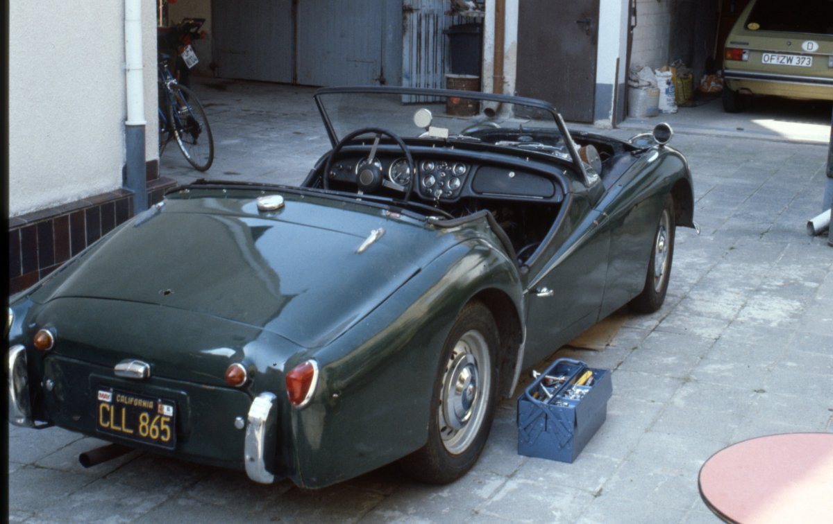

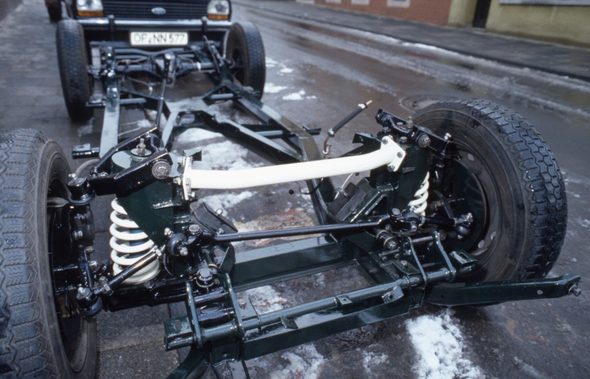

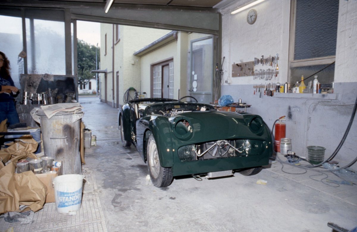

I painted the vehicle interior as well as the engine and trunk myself. Afterwards the body was put back on the chassis.
Edited by Speedy

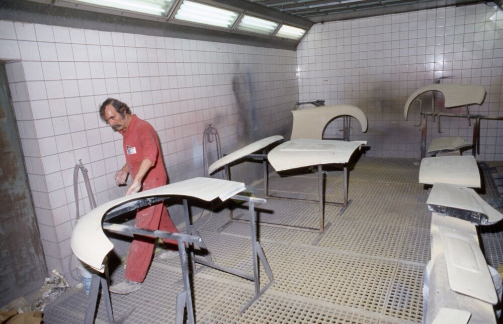

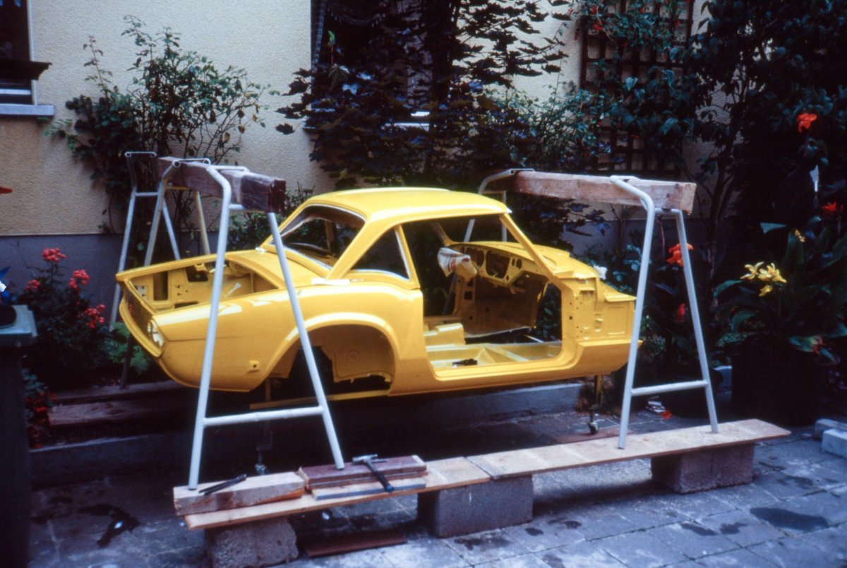

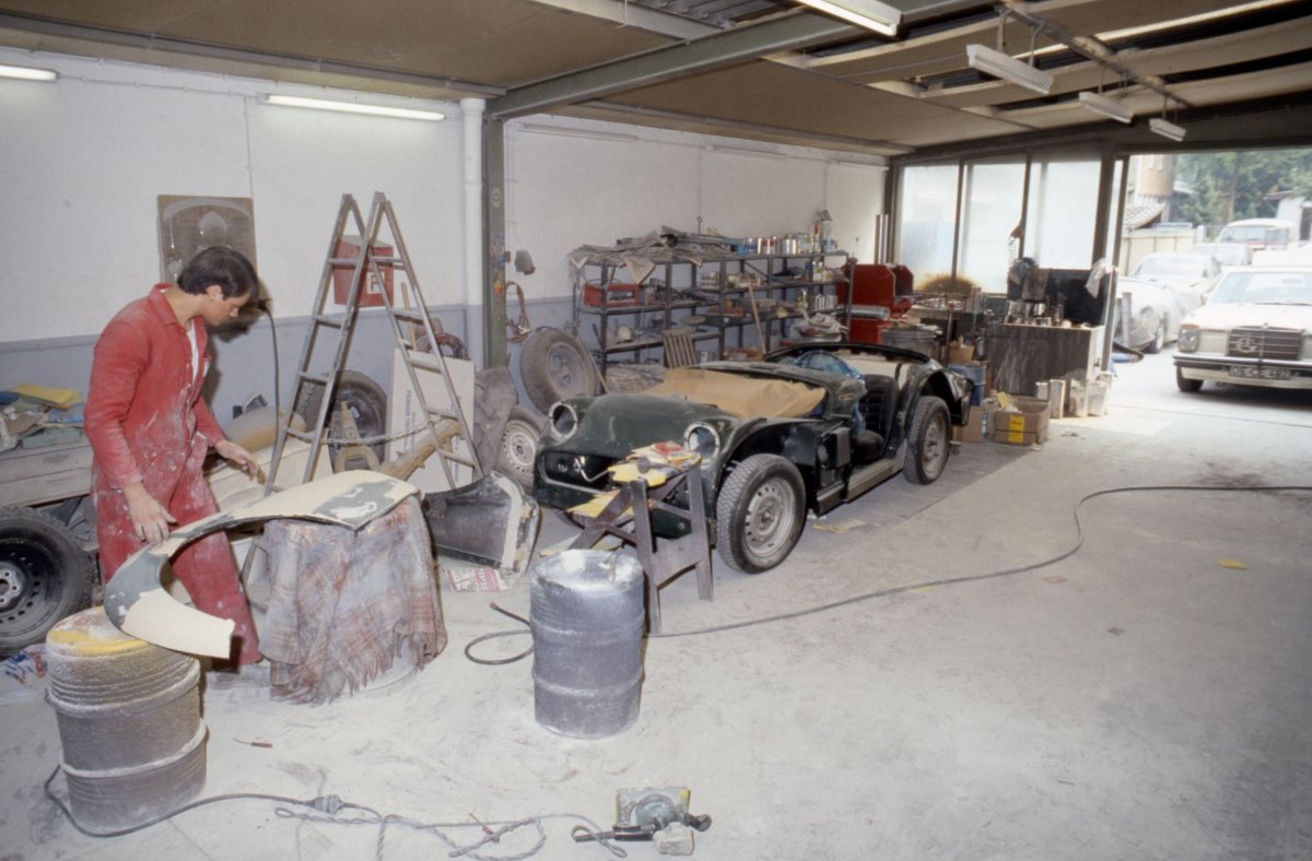

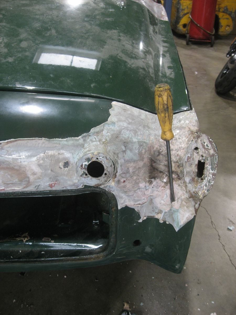

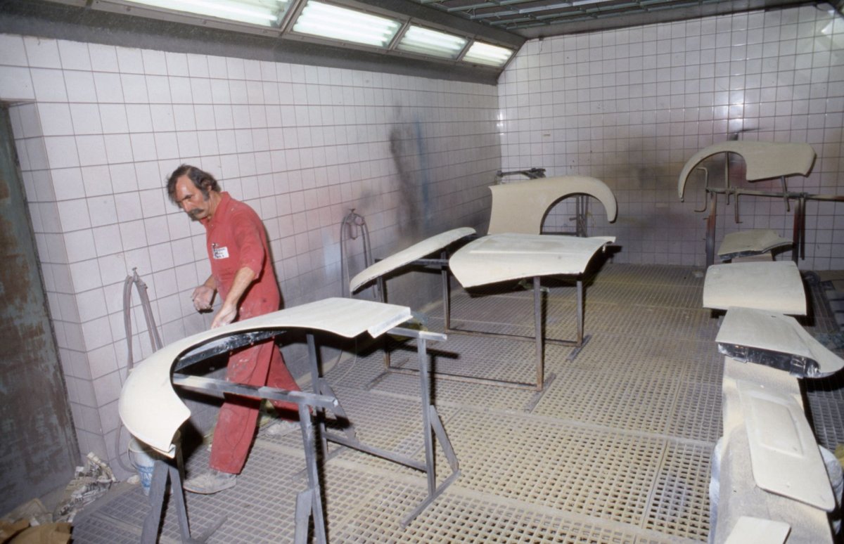

I had never done any bodywork before, so I left it to the "professionals". I didn't realize what that meant until 40 years later.
The outer sills were replaced and the front apron repaired on the body. To my horror, I saw in the old pictures that there is still an ugly piece of metal under the grille (it came from America). The two front fenders were so corroded at the bottom that new sheets of metal had to be made and welded in.
So the Triumph went to the painter.

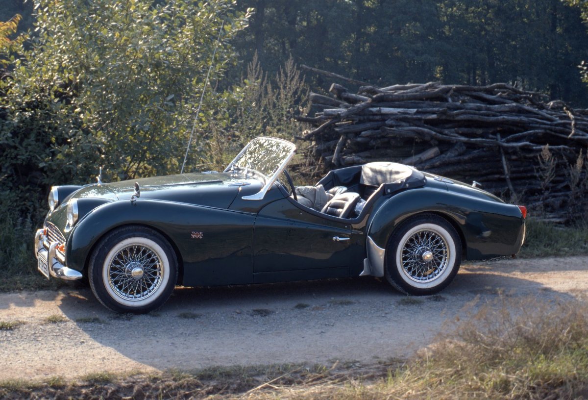

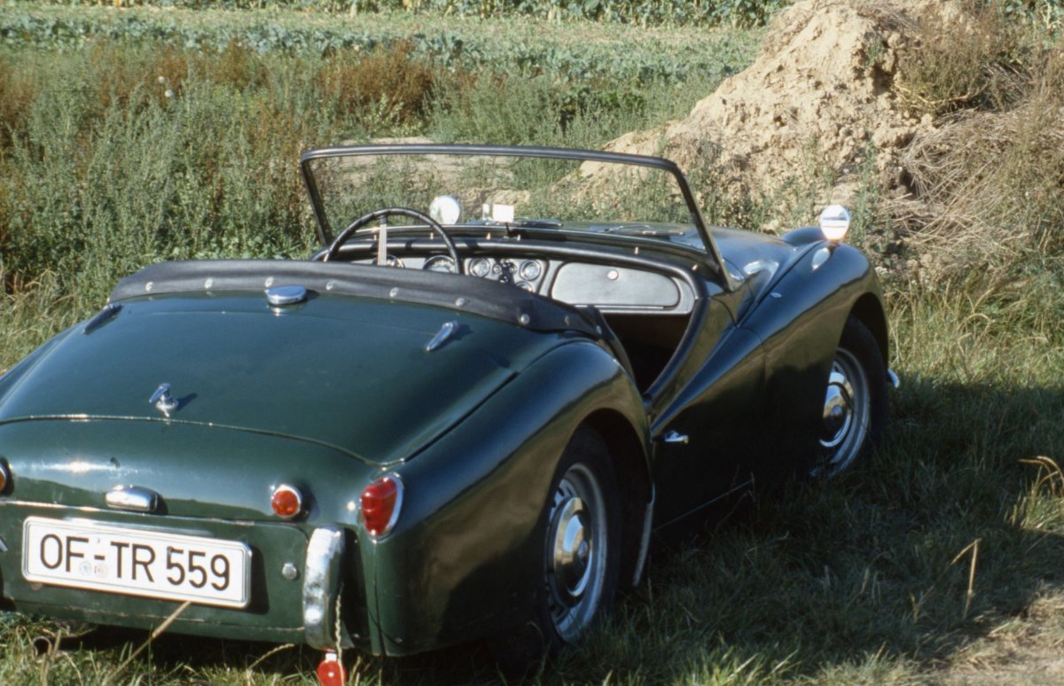

1880456088_20-Restaurierung1-topaz-sharpen.thumb.jpg.ca95f18809f7e7e068791989d87e2016.jpg
That was right after the restoration in 1986 with new wire wheels and  still with white wall tires.

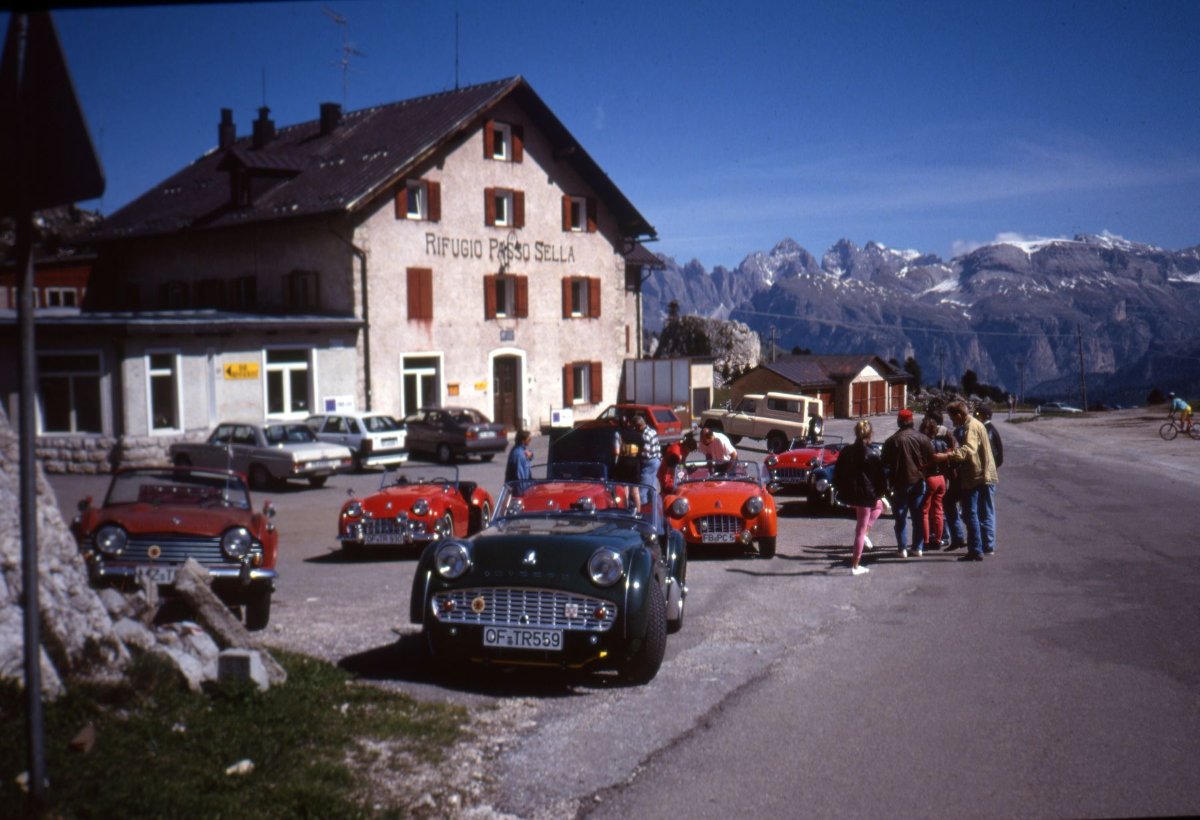

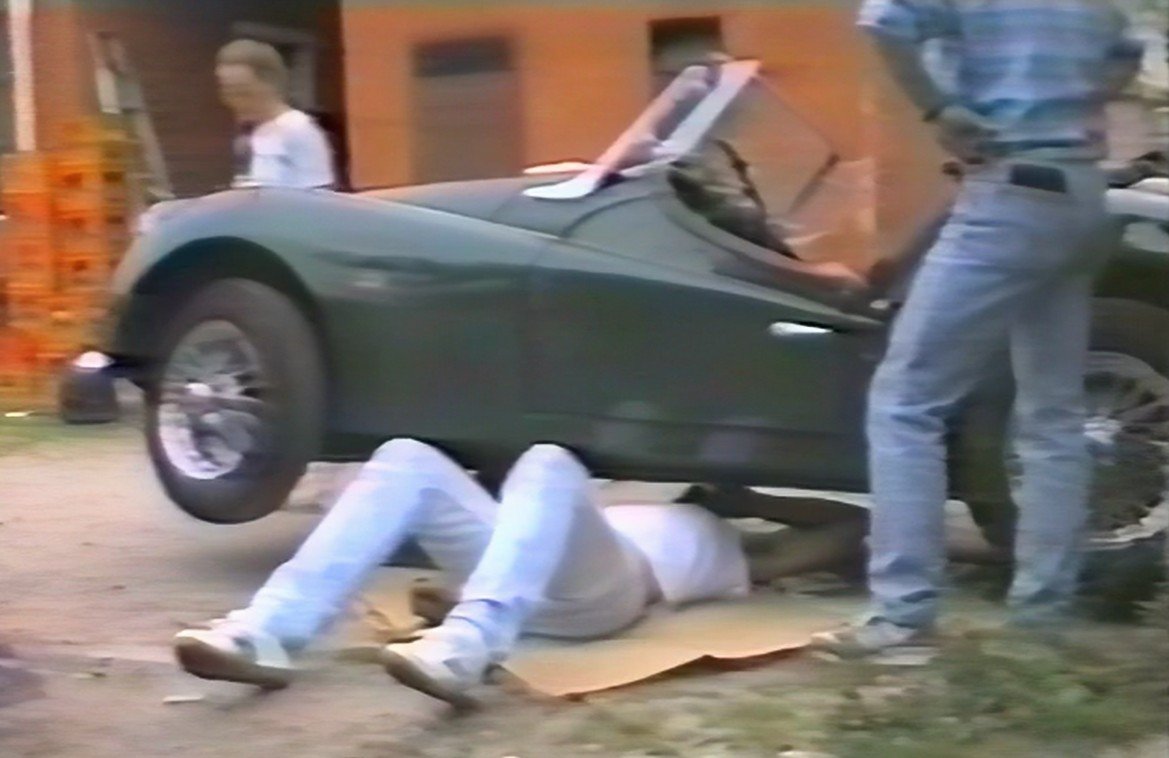

 In June we drove to the Alps/Dolomites with some TR friends. I can no longer remember what happened with the police at the beginning of the trip.

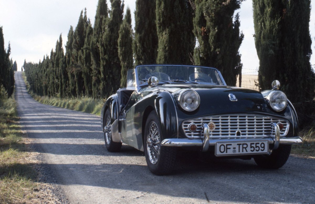

Tuscany/Italy 1988. We had a bit of trouble with the OD, but it was only the ground connection that had come loose.
Tuscany 1988

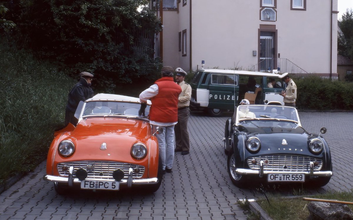

On the way home to Germany, there were three of us in the TR. In Tuscany, one of our group members unfortunately had a small accident with his TR5, which meant he was no longer drivable. But his co-driver was determined to continue driving the TRs. During the day in our TR3, in the evening when it got cooler in a TR4A with the hood down.

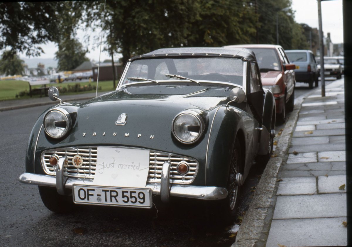

1158757890_28-Hochzeitsreise88-topaz-denoise-sharpena.thumb.jpg.9b9a41d214d6cfda5ec5f2cf8dbe9441.jpg
The highlight of 1988 was our trip to Scotland, where we got married.

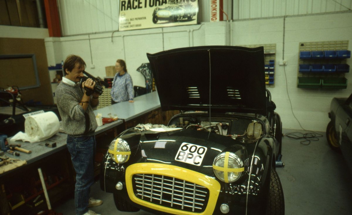

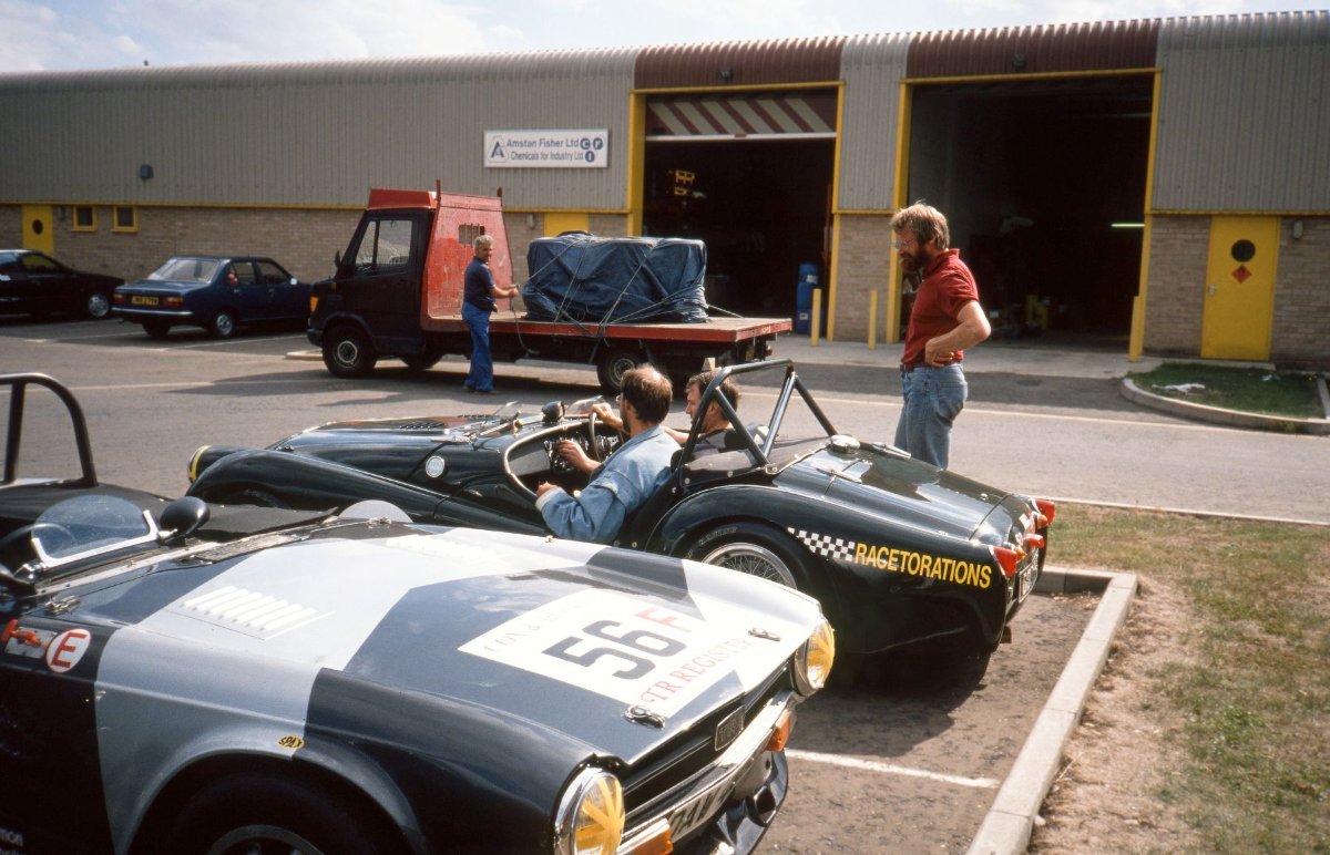

The first of many visits to Darryl Uprichard, owner of Racetorations, in Gainsborough.

592256637_31-Racetorations89-topaz-sharpena.thumb.jpg.0f2f3784d4fb2831b8ab05402bbaab6c.jpg
Another trip to Racetorations 1989 with a test drive in 600BPC

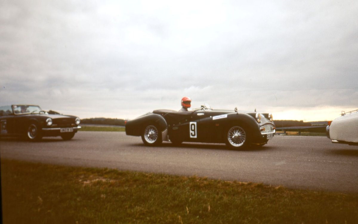

Racing on the circuit Colmar Berg / Luxembourg 1991

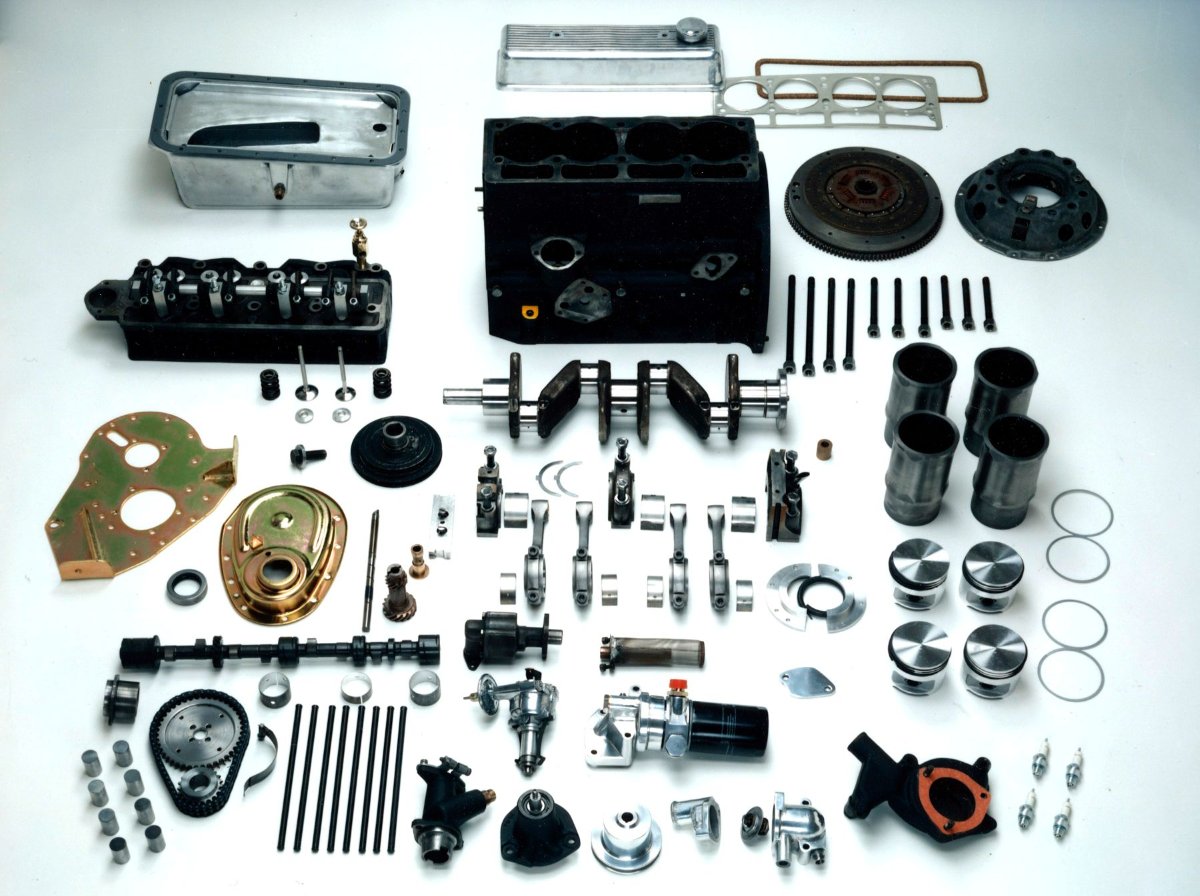

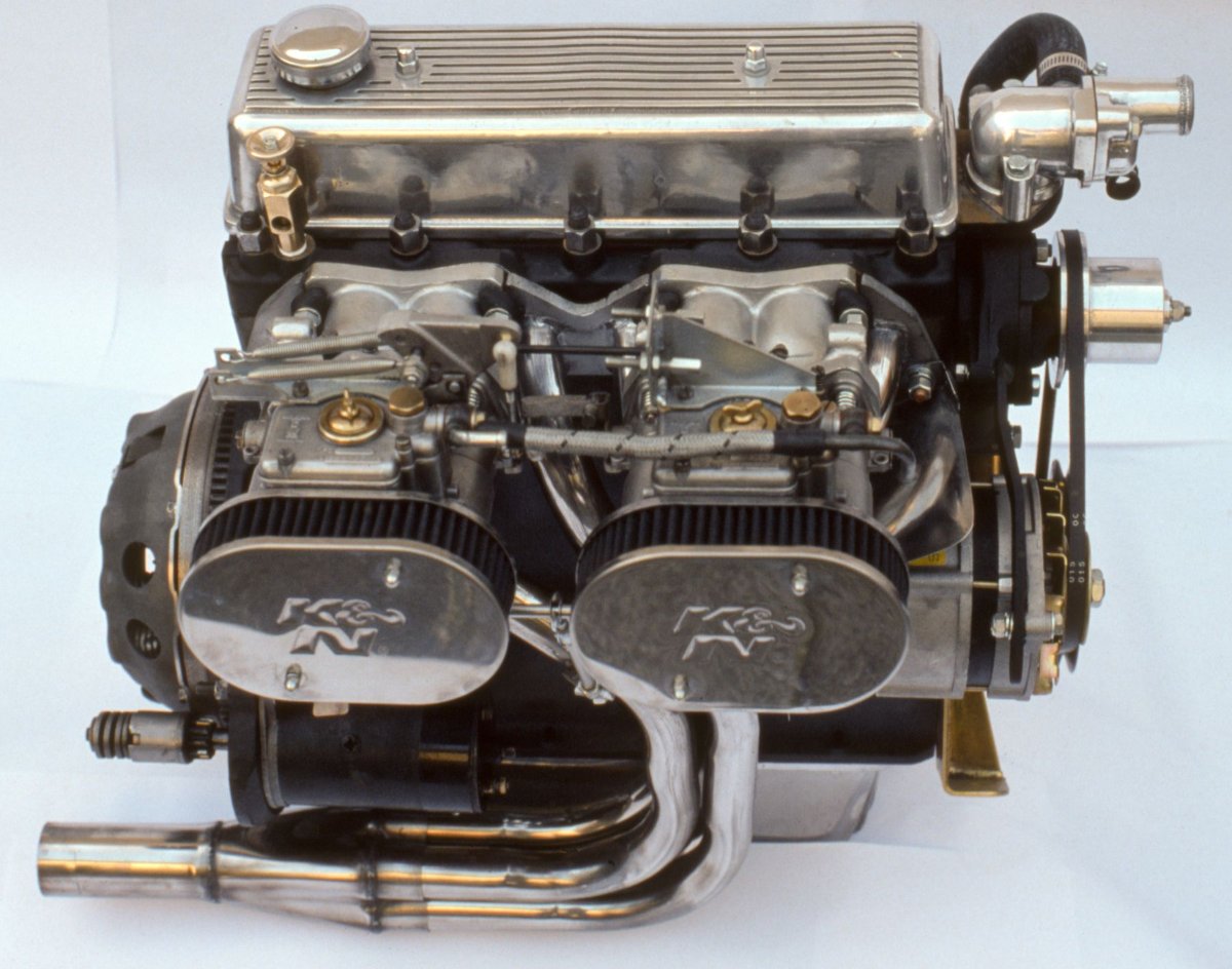

At the end of 1992, the original engine was rebuilt. I had bought enough spare parts from Darryl

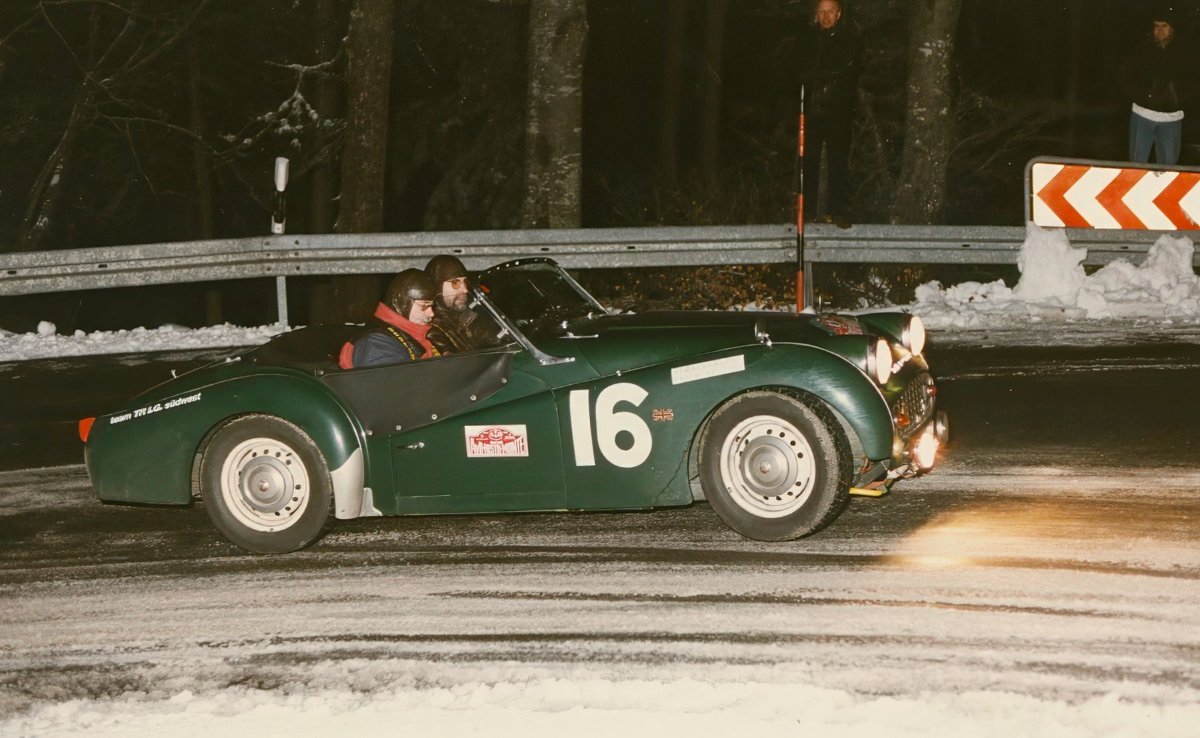

In 1997 and 1998, in January/February, I drove the Histo Monte Carlo with my brother. Open, of course.

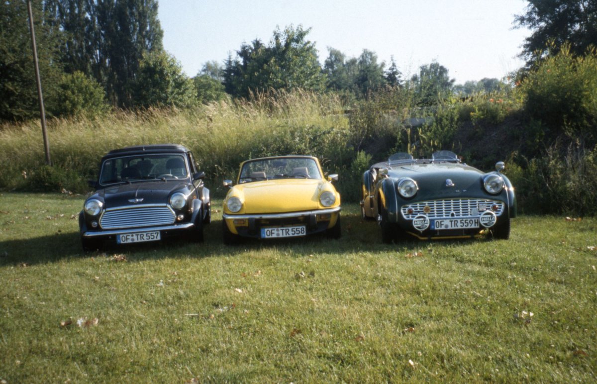

1999 - Now we have two kids. The fleet had to be expanded a bit. My wife used the Spiti as her everyday car for 2 years. Instead of the passenger seat, I installed a Maxi Cosi for our son. Later he was strapped into the "back seat" with a lap belt and the daughter in the Maxi Cosi. It was good that the "big car" was finally purchased - the Mini!

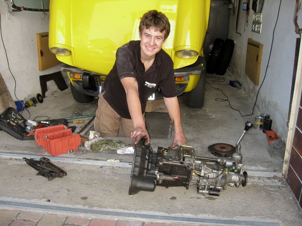

2011 - Time passes so quickly, my son Colin has grown up to be a mechanic and is already helping me a lot.

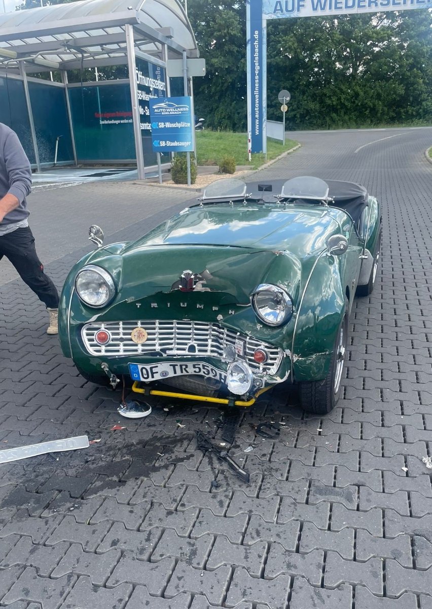

At the end of May 2022 we had our first accident with the TR. Luckily it was just a dent in the bodywork and not that big either. The frame was not damaged at all. The other car was an Audi A5 and it didn't look good either.
After 38 years of driving in the summer heat, in the winter in snow and ice, on gravel roads, etc. ... the bodywork was no longer in the best condition. There were small cracks in the paint here and there and the color had faded in places and I had known for a long time that the bodywork needed a new coat of paint. But I also knew that it would be a lot of work and very expensive, so I had no desire to tackle it.
Now the opportunity was there and we got started.
Edited by Speedy

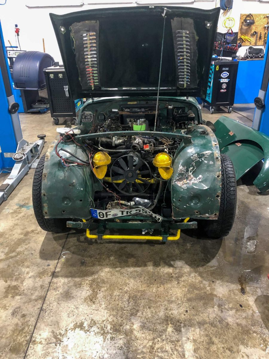

Such an accident is of course always very annoying, but the first inspecition at least did not reveal a catastrophe. It remained just a sheet metal damage, here is the first line-up:
• Front Apron ruined and not salvageable
• The grille also scrap
• Headlight broken (unfortunately the good Lucas - no longer available)
• Lamp rim broken
• TR3 emblem bent
• Fender dented but salvageable
• Inner fender ditto
• Oil cooler broken
 • Water radiator bent and leaking
• Kenlowe fan broken
• Hella fog light broken
The expert prepared a damage report = economic total loss!!!
That surprised me and even more so the amount of damage determined: estimated repair costs around 32,000€.
For us, however, the question of not repairing the TR never arose, especially since the frame was not damaged. Since our TR has now become a generational car and son Colin has been tinkering with it for years - and drives it himself - the project is being carried out by both of us, especially because he has an excellent background and network.

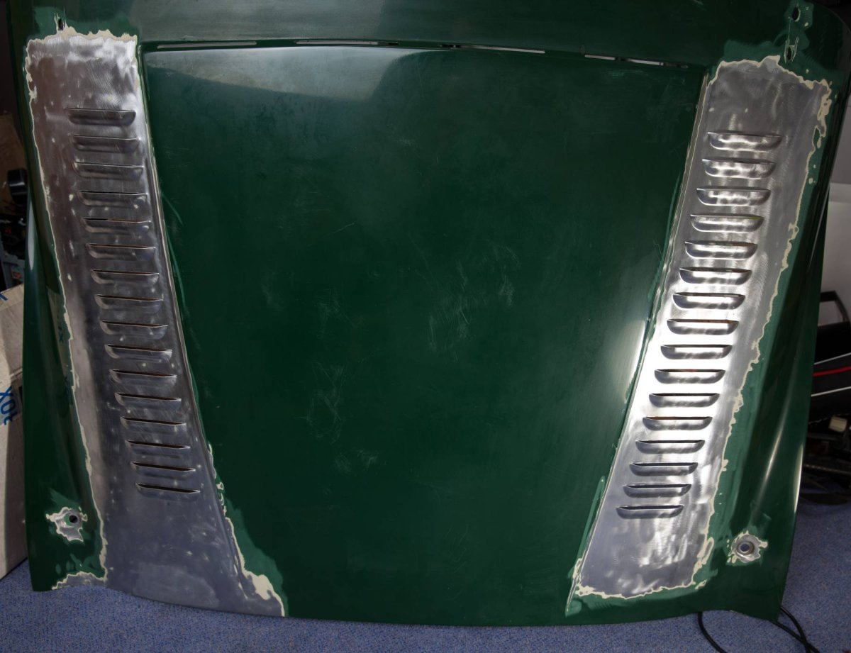

The bonnet had hardly any damage, but we wanted always Louvers which are embossed in a specialized company.

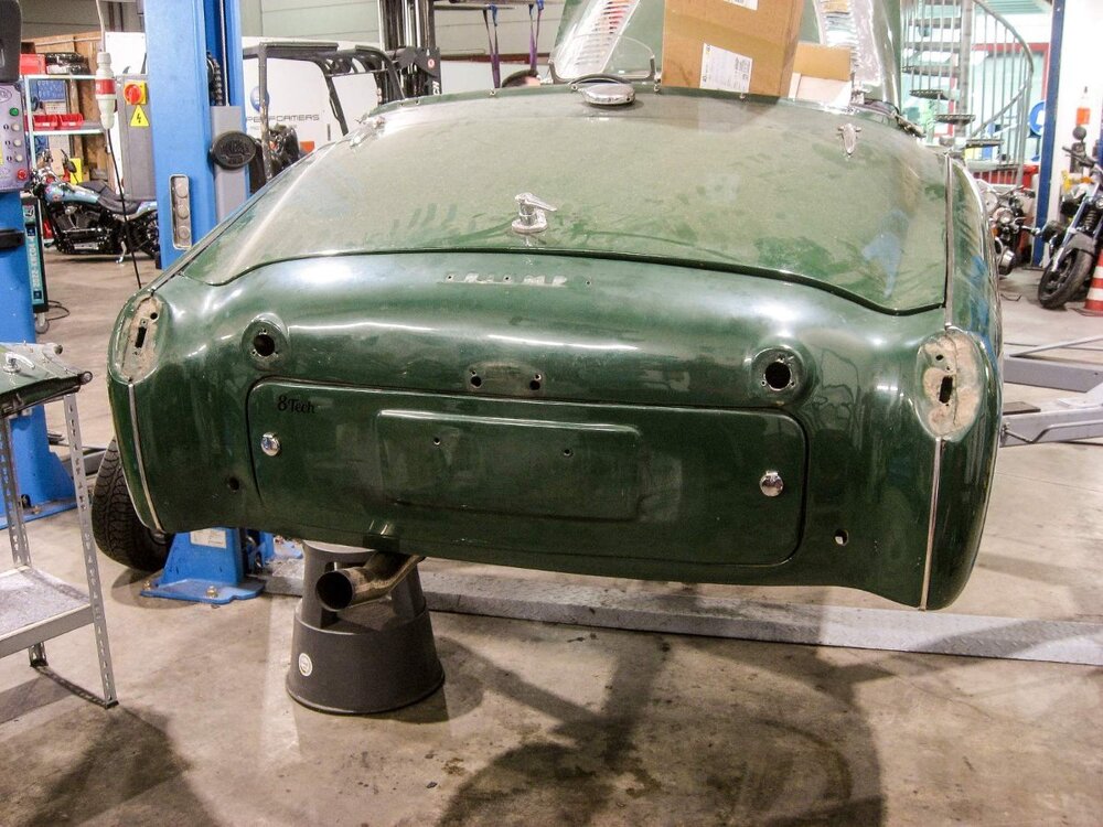

As the whole bodywork is being checked or reworked, let's take a look at the rear. It looks OK so far.

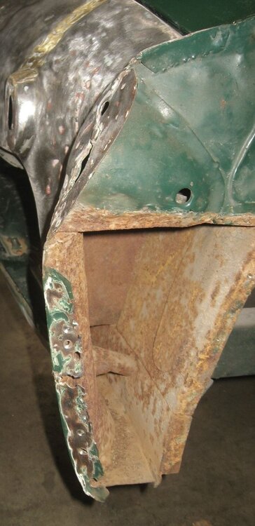

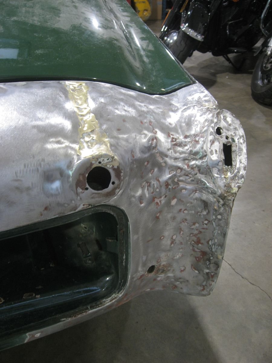

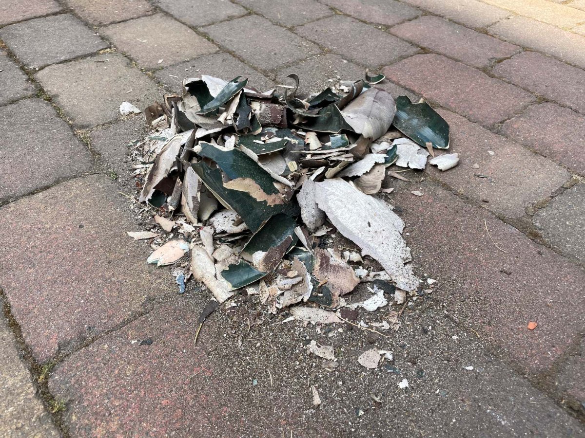

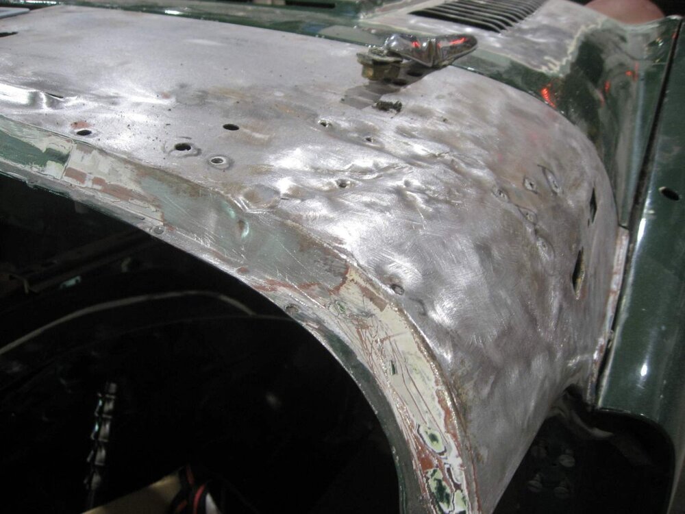

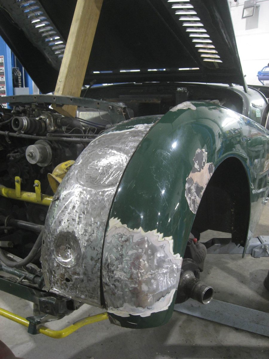

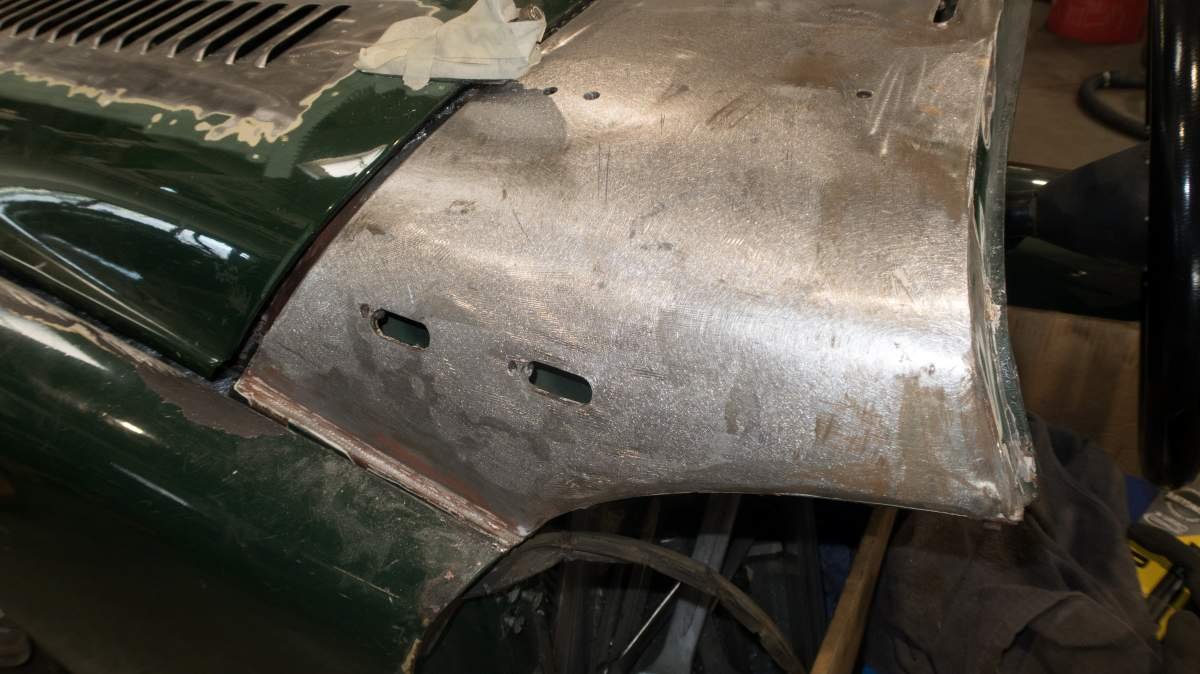

We noticed that quite a lot of filler had been applied in various places. That was from the Americans. My painter, who painted the TR in 1986, didn't bother with it either (it has held up until now).
After removing the paint and filler, this was what came to light:
And not only on the right side it looked like this, but also on the left side.
That looks better now.

That is some great panel bashing :D

Then I can show you much more :lol:

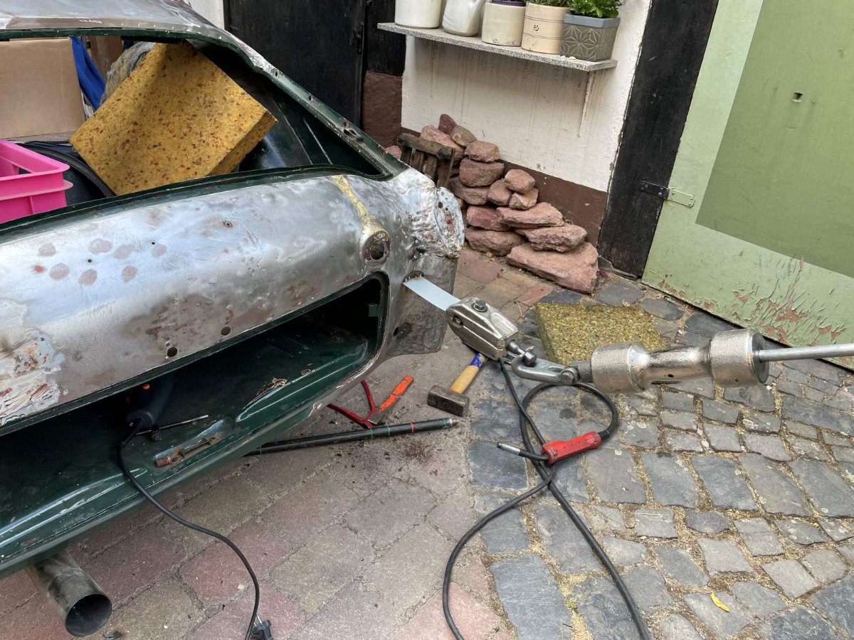

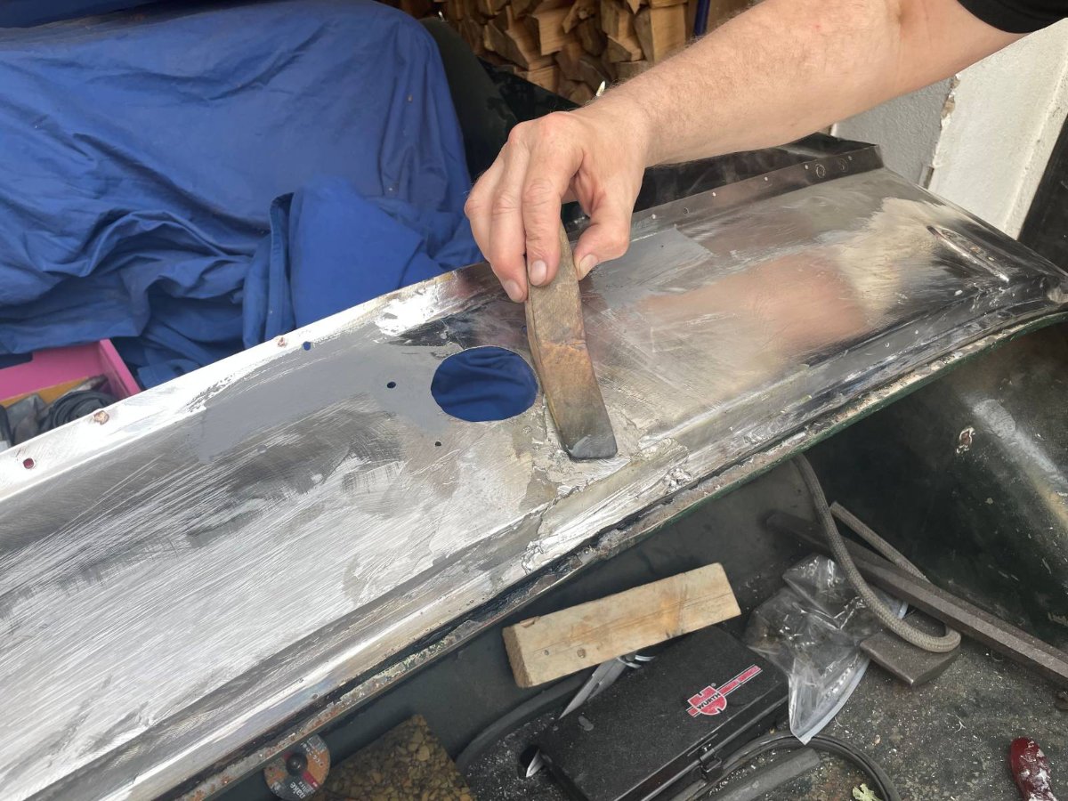

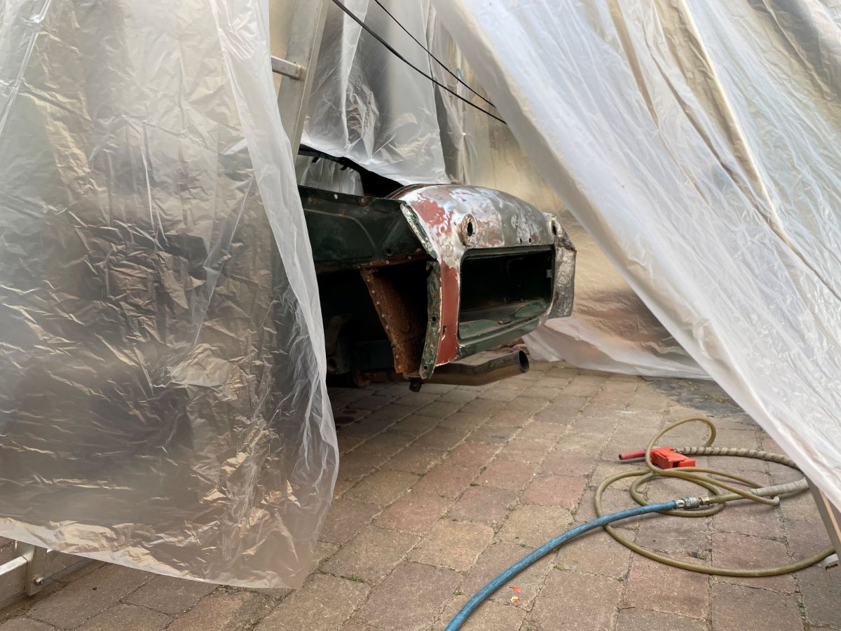

What did I write above: “The rear looks pretty good”. We suspected there was a lot of filler on the right rear, which unfortunately turned out to be true after removing the paint. It must have taken a good hit on the back.
284402804_52-DieAmishabennichtmitSpachtelgegeizt.thumb.jpg.3800f626272f36b819b3f0b3be18a56c.jpg

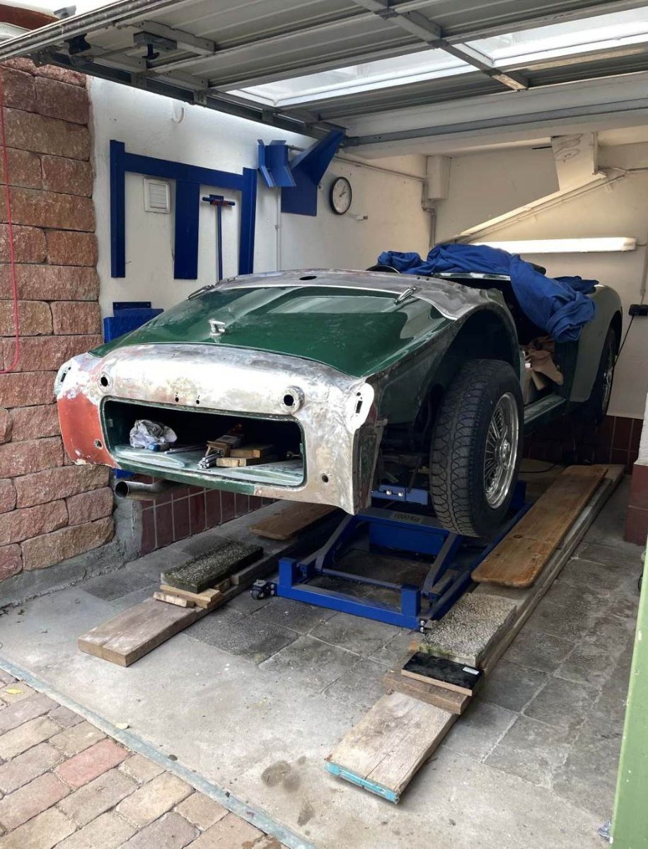

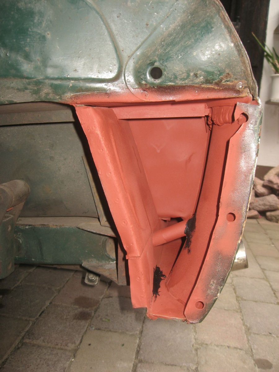

We have now brought our masterpiece home from the workshop (due to space and time) and we are continuing step by step. Always looking for surprises.
The cavities were opened, blasted, treated against rust and closed again.
Improvised sand blasting cabin.
And pounds of american Bondo.

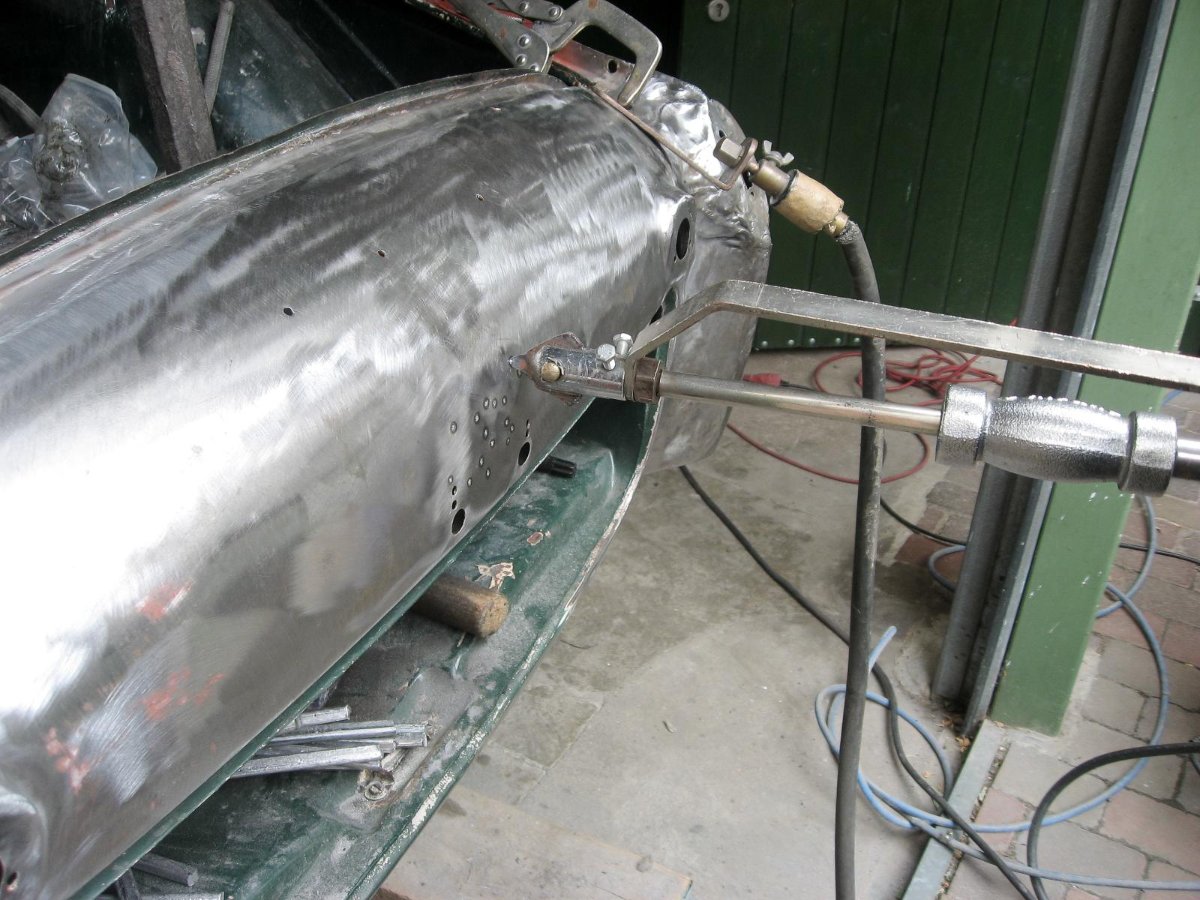

It takes dozens of hours, to get the rear end back into shape. Very frustrating at times and then happy again when I see the result.

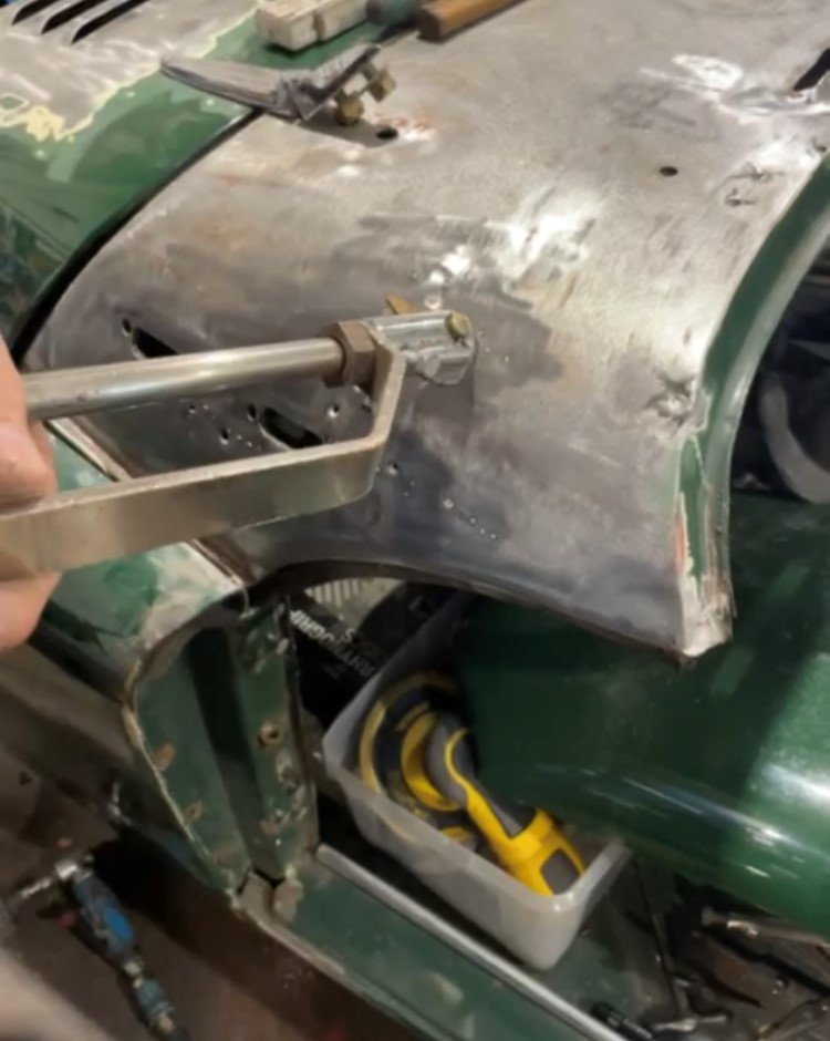

All special tools were procured or borrowed to achieve the best possible result. Here is a spotter in action.
Do you know how expensive bodywork tin is these days?
My motorbike lift has been converted into a wonderful TR lift
