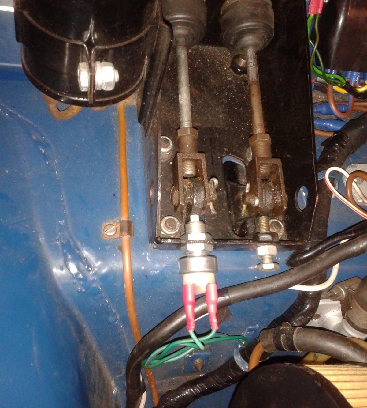

Biggles Posted March 29 Report Posted March 29 The brake switch on my TR3a has failed again which is irritating, because it's a bit of a pain to reach. Last time I replaced it with one from Moss (https://www.moss-europe.co.uk/en-gb/switch-brake-light-uprated-13h3735x). They're not expensive but are there any better ones to buy? Quote

Biggles Posted March 29 Author Report Posted March 29 3 hours ago, RogerH said: The hydraulic ones suffer from high temp in the working environment. They all fail early. Get the BMW switch and fit it against the master cylinder pedal. Do not get the Moss plastic switch. Roger I'm trying to avoid messing up my neat and tidy pedal box. Quote
Trumpy3 Posted March 29 Report Posted March 29 Very nice and I understand the desire to keep it that way. Your choice is unreliable hydraulic switch or a well installed and reliable mechanical switch. I have never had a good mechanical switch fail in my TR3A in the past 24 years since restoration. I initially fitted an hydraulic unit but it failed in less that a year so fitted a mechanical one. Brian Quote

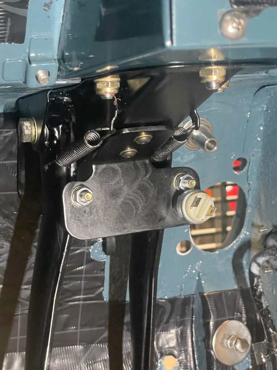

Speedy Posted March 30 Report Posted March 30 9 hours ago, Biggles said: I'm trying to avoid messing up my neat and tidy pedal box. Here is another way to install the switch without it being visible. Quote
Ralph Whitaker Posted March 30 Report Posted March 30 I used the original hydraulic one that was on the wreck (cant call it a car, it had sat for years in a US scrapyard before I got it), it was caked in filth but it was during covid lockdown so I gave it a clean and put it on. I think it was probably the original Lucas one. Anyway it worked, and is still working now, although it is now only switching Bob Lebroc`s LED conversion brake lights, so probably handling a lot less current. People used to slate Lucas stuff, and still do, but it seems better than anything around now. Ralph Quote
John Morrison Posted March 30 Report Posted March 30 52 minutes ago, Speedy said: Here is another way to install the switch without it being visible. That's very tidy, like that. John. Quote
Z320 Posted March 30 Report Posted March 30 Hi Rainer, this pedal stop bracket is selfmade? I have never seen this part before. Ciao, Marco Quote

Speedy Posted March 30 Report Posted March 30 3 hours ago, Z320 said: Hi Rainer, this pedal stop bracket is selfmade? I have never seen this part before. Ciao, Marco No, you can't buy that. Through my TR3 restoration I'm constantly on the lookout for improvements and new ideas. Whenever I see something, I take a photo of it and maybe I'll use it on my own and rebuild it. I have also seen so many new things through this forum and I've built a few things into my TR. Or I let myself be persuaded to install something “great” - as I did just a week ago with the Steering Geometry kit from Revington. This is a very expensive forum here. Quote

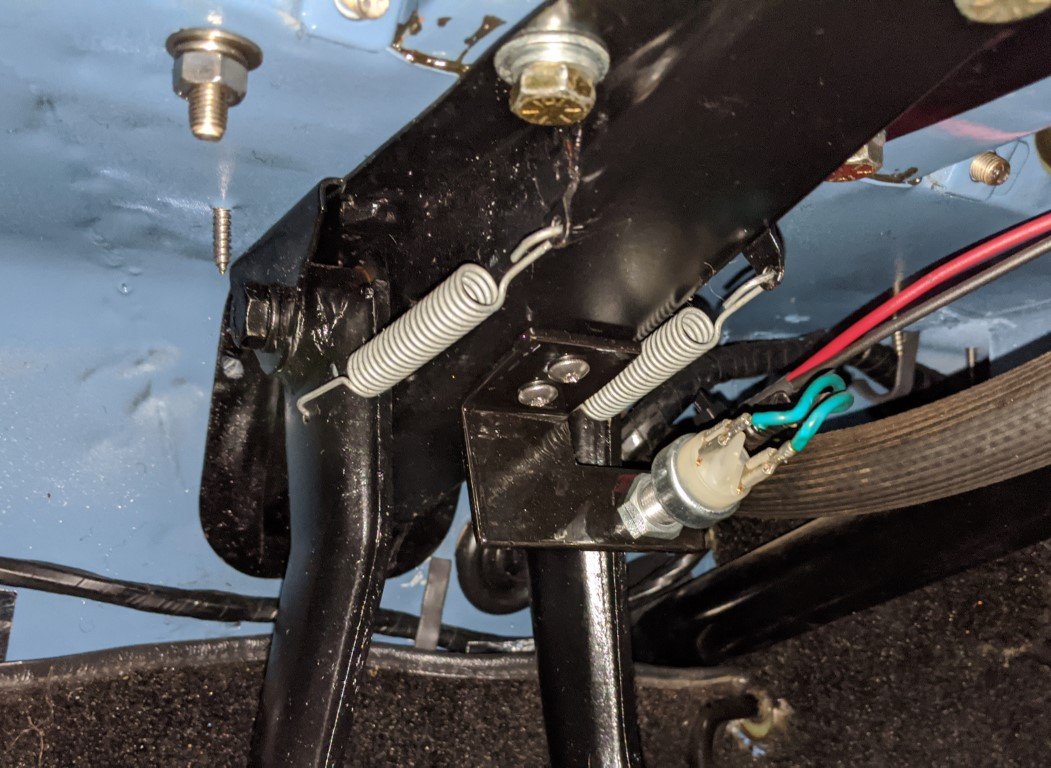

Mike Graham Posted March 30 Report Posted March 30 I also changed over to a mechanical switch on the foot pedal so that it was not easily seen. Cheers, Mike Please wait while image is uploading... Quote

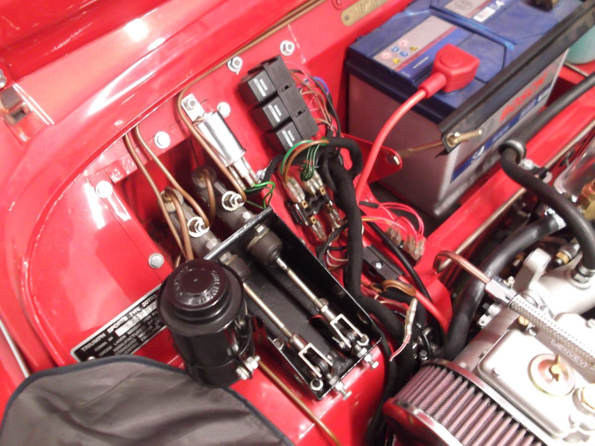

Richardtr3a Posted March 31 Report Posted March 31 After reading this I went out to the garage looking for my brake light switch. There is no sign up by the master cylinder and the pedals under the dash have no switch. Mine has been there since 1986 and is no problem now. I can not remember where I fitted it, it but I need some advice on where to look. I am jacking up the front tomorrow to check the steering and will look for it at the same time. Richard & B Quote
RobH Posted March 31 Report Posted March 31 31 minutes ago, Richardtr3a said: I went out to the garage looking for my brake light switch. If it is the standard hydraulic switch it is in the engine bay, in the brake-lines down on the chassis rail, behind the wheel on the driver's side. Quote
