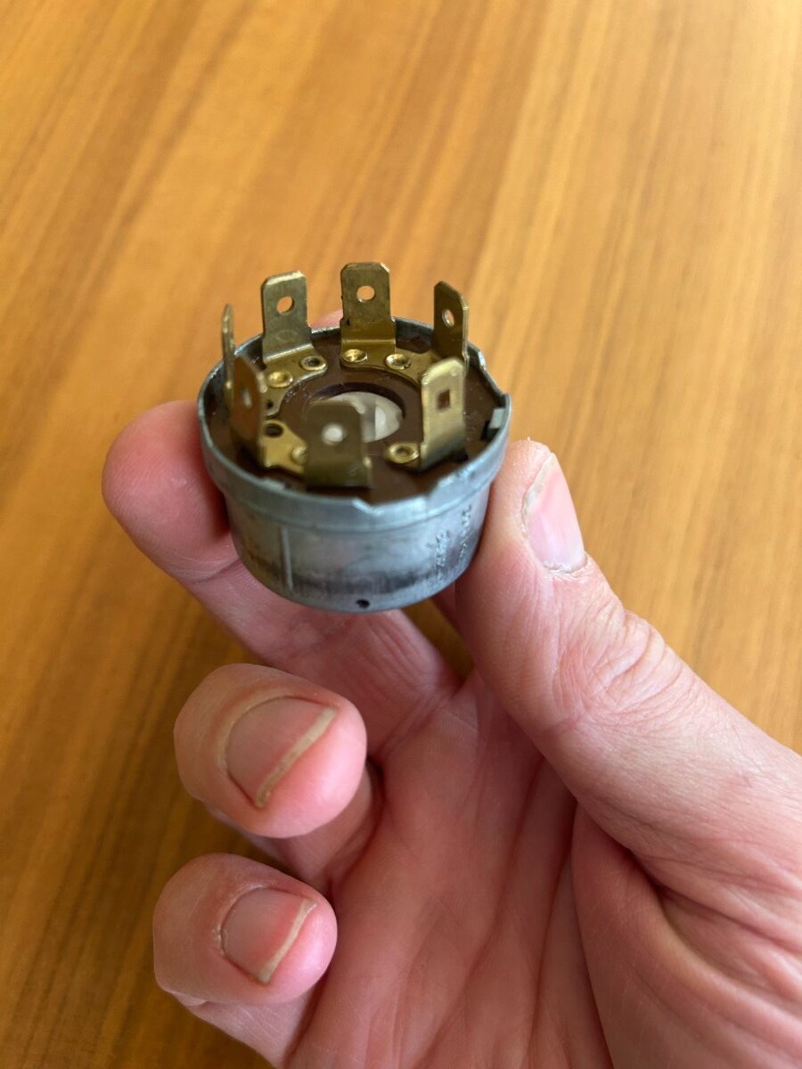

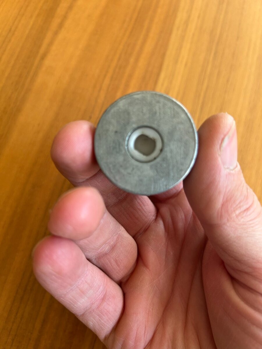

nickw71 Posted April 6, 2025 Report Posted April 6, 2025 Just did this very same job yesterday. The springs eventually let go in the electrical switch barrel. The new ones are quite pricey for what they are but they come in a little Lucas box just to make you feel they are the real deal. I found taking the seat out and then lying down in the footwell with a head torch is the only way to do this. Glad of the yoga classes! Also taking off the ventilator tube that runs left to right also makes the job a hell of a lot easier. Mine had a tiny retaining screw which I just replaced. Easy job and very worth doing. I have another issue with the steering lock which I'll put on a fresh thread. Nick Quote
