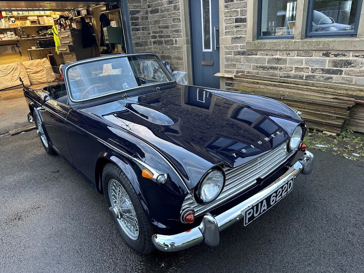

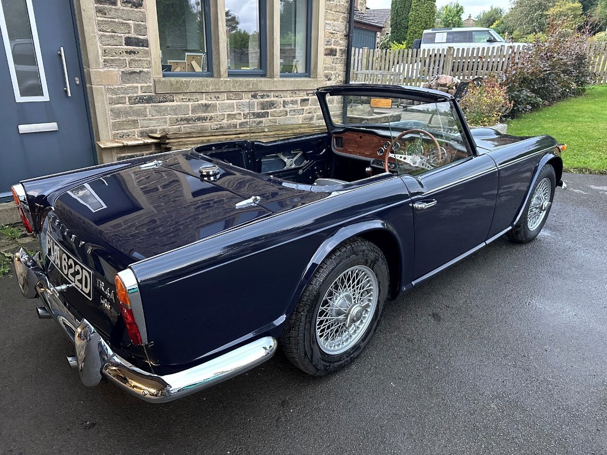

Steven Whitaker Posted August 21 Author Report Posted August 21 So, I got her running (albeit roughly) after the full nut/bolt rebuild of the entire car/engine etc. and this morning at 6:30am I drove her to a garage to set the carbs and ignition up better. I was incredibly nervous that she would end up on a trailer, but we got there (15 miles) under our own steam in a steady 45 mins. Very pleased. Thanks to everyone so far, for helping me on my first TR restoration. Please wait while image is uploading... Quote
