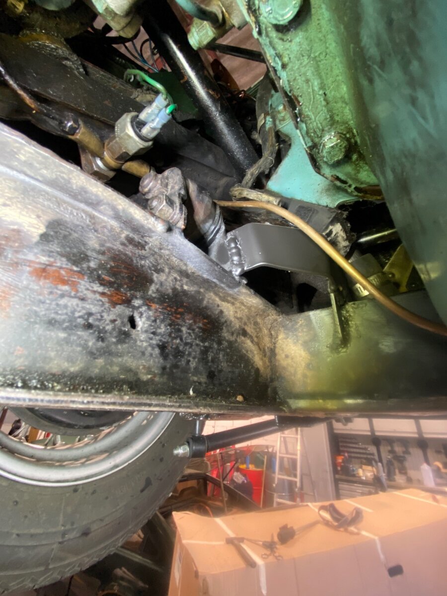

Nigel C Posted May 23 Report Posted May 23 On 5/6/2025 at 4:28 PM, BlueTR3A-5EKT said: I have a space saver steel in the spare wheel hole from a Volvo V40. It was cheaper than a replacement 155/80/15 tyre fitted. https://www.ebay.co.uk/itm/176248232037?mkcid=16&mkevt=1&mkrid=711-127632-2357-0&ssspo=eyeY9bbVRs2&sssrc=2047675&ssuid=GBORZ5kJRNS&widget_ver=artemis&media=COPY Like the idea Pete, I did the same thing with a 4j steel and 155 ...I don't have the problem with it fitting in the spare wheel aperture but wanted to gain more boot space. BUT have you ever thought how you undo the adapter wheel nuts on the front when you're on the side of the road...on your own? I have. I made a "peddle stick" that reaches from the seat bracket to the brake peddle and is hinged by way of a nut and bolt in the centre. when you push down it expands and presses the peddle down until it is in a straight line then you push a pin through a corresponding hole and it locks it in place. then you can undo the spinner nuts and fit the steel. By hinging in the centre it also fits in my bag with the scissor jack and winding handle...... Quote
BlueTR3A-5EKT Posted May 24 Report Posted May 24 10 hours ago, Nigel C said: Like the idea Pete, I did the same thing with a 4j steel and 155 ...I don't have the problem with it fitting in the spare wheel aperture but wanted to gain more boot space. BUT have you ever thought how you undo the adapter wheel nuts on the front when you're on the side of the road...on your own? I have. I made a "peddle stick" that reaches from the seat bracket to the brake peddle and is hinged by way of a nut and bolt in the centre. when you push down it expands and presses the peddle down until it is in a straight line then you push a pin through a corresponding hole and it locks it in place. then you can undo the spinner nuts and fit the steel. By hinging in the centre it also fits in my bag with the scissor jack and winding handle...... That’s a good idea. I don’t have wire wheels so don’t need to be worrying about locking the hub to remove the adaptors. To jam the brake pedal I have used a Krookloc type device before now. Quote
TR Rob Posted May 24 Report Posted May 24 17 hours ago, Nigel C said: Like the idea Pete, I did the same thing with a 4j steel and 155 ...I don't have the problem with it fitting in the spare wheel aperture but wanted to gain more boot space. BUT have you ever thought how you undo the adapter wheel nuts on the front when you're on the side of the road...on your own? I have. I made a "peddle stick" that reaches from the seat bracket to the brake peddle and is hinged by way of a nut and bolt in the centre. when you push down it expands and presses the peddle down until it is in a straight line then you push a pin through a corresponding hole and it locks it in place. then you can undo the spinner nuts and fit the steel. By hinging in the centre it also fits in my bag with the scissor jack and winding handle...... The adaptor wheel nuts are a nightmare to remove as they are ‘recessed’ into the spacer and as a consequence the bearing surface to get a socket on is very reduced. I can’t even imagine removing them at the roadside. It was extremely difficult removing them at my local garage with an impact wrench and a full garage backup. Quote
rcreweread Posted May 24 Report Posted May 24 23 minutes ago, TR Rob said: The adaptor wheel nuts are a nightmare to remove as they are ‘recessed’ into the spacer and as a consequence the bearing surface to get a socket on is very reduced. I can’t even imagine removing them at the roadside. It was extremely difficult removing them at my local garage with an impact wrench and a full garage backup. You need to use a 6 sided socket and grind the face of the socket back by about 1 mm or whatever the internal chamfer of the socket is, and then you will get maximum connection between the socket and the nut - then it will be no problem cheers Rich C-R Quote
