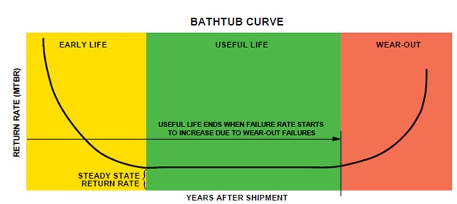

BlueTR3A-5EKT Posted May 13, 2025 Report Posted May 13, 2025 (edited) My view is if it’s working don’t touch. Definitel take replacement spares if you doubt certain items. Fitting new bits is not a guarantee of reliability Be sure you have the right tools to do the job at the roadside. And double check what fuel you are putting in the tank! Remember the bathtub curve of reliability.. Most likely to fail when new. Edited May 13, 2025 by BlueTR3A-5EKT Quote

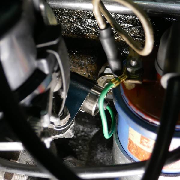

Z320 Posted May 30, 2025 Report Posted May 30, 2025 (edited) Btw you can fit any condenser from any classic car OUTSIDE the distributor, like most producers did, but Lucas not. Edited May 30, 2025 by Z320 Quote
