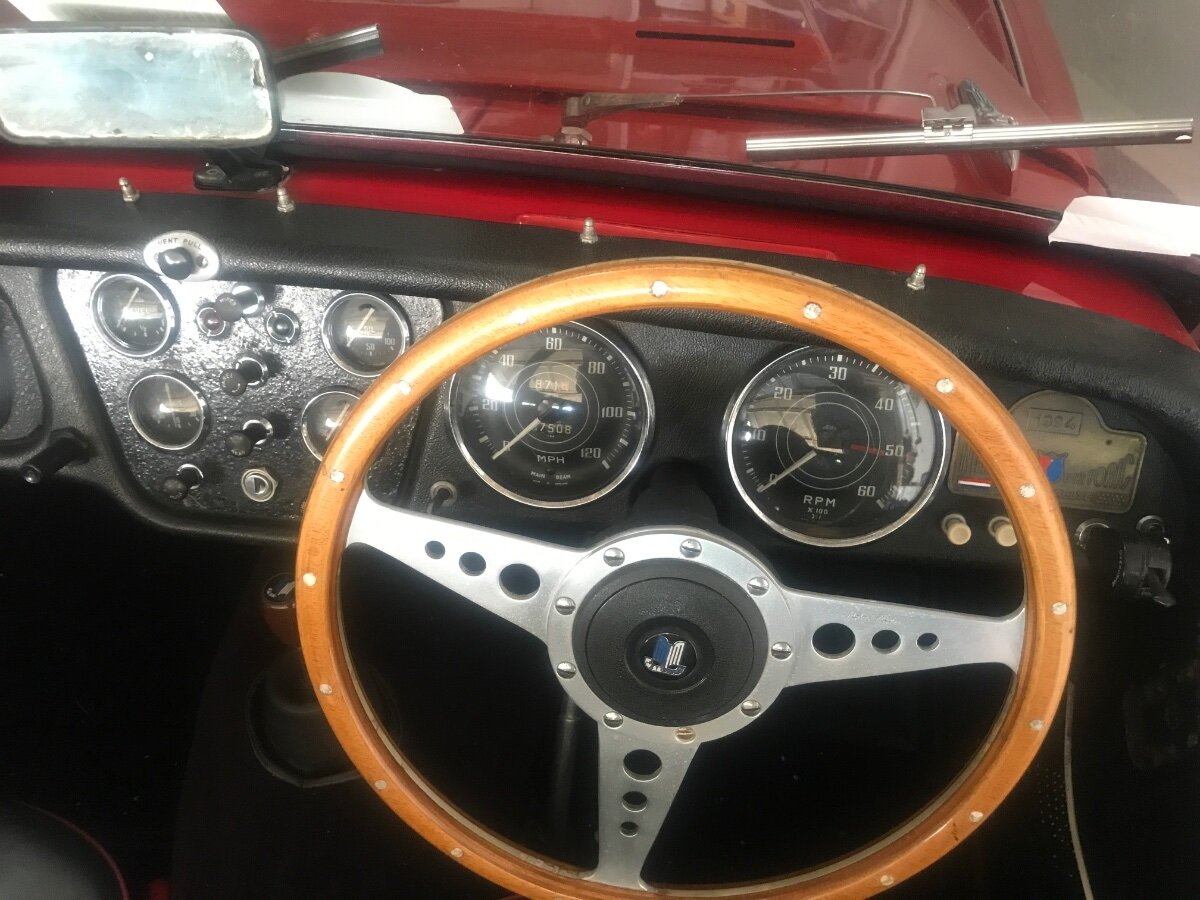

ERNGOR Posted May 15, 2025 Report Posted May 15, 2025 Can some one tell me if windscreen washers were fitted as standard on the TR3A. I am in the process of buying an Ex California car which has been returned to the UK converted to RHD and fully restored. I cant see any evidence under the bonnet of washer bottle etc. I have not seen the car in person. Also where would the washer switch/pump be located As an aside can someone post a picture of the dash layout showing all switches etc Would this washer kit be required by UK MOT Standards Thanks Gordon Quote

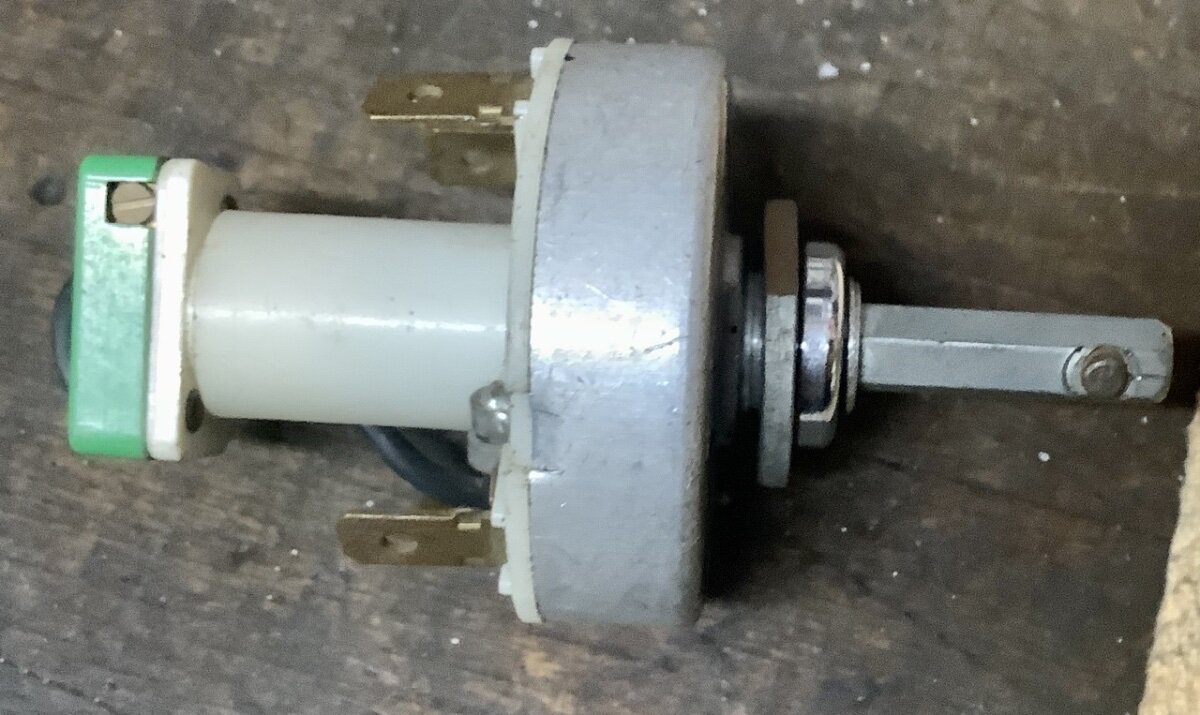

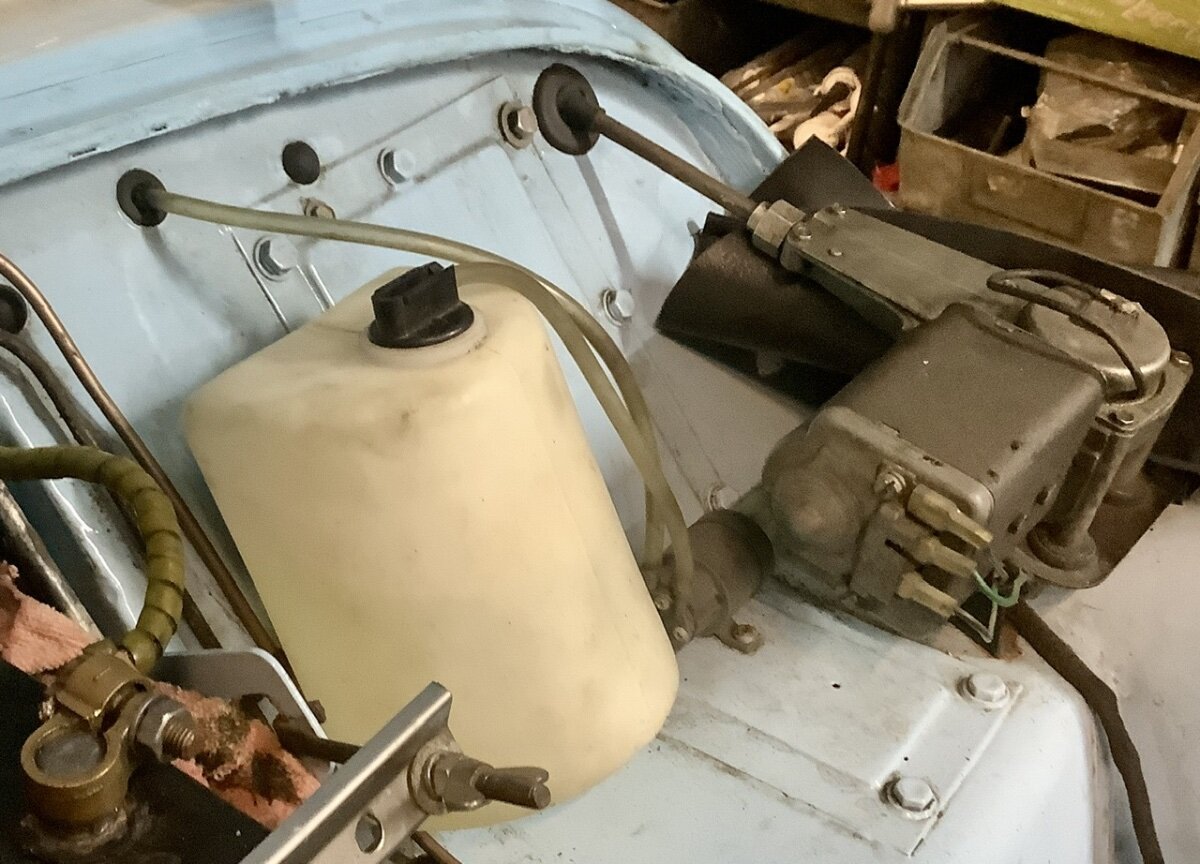

BlueTR3A-5EKT Posted May 15, 2025 Report Posted May 15, 2025 (edited) As the car has a detachable windscreen, therefore washers are supposedly not compulsory, take it for MOT with aeroscreens fitted. That said I have electric pumped screen washers with two jets fitted to my car. The switch is a combined wiper switch with push to wash electric switch from a Land Rover. My container sits by the wiper motor, attached to the bulkhead. My brother’s TR2&3 uses this bottle sat in the battery box next to the battery, very tidy. https://www.holden.co.uk/p/bottle_type_electric_screen_washer_kit my bottle, with pump under the wiper motor and switch type used Edited May 15, 2025 by BlueTR3A-5EKT Quote

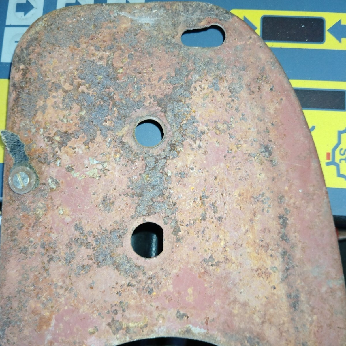

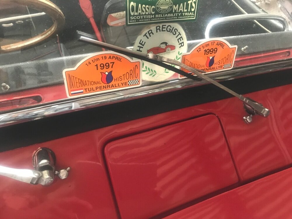

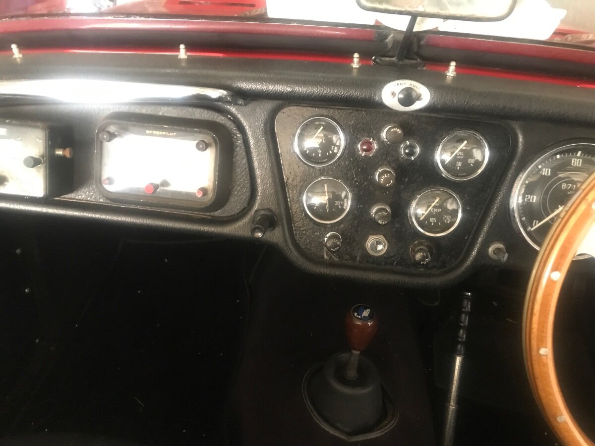

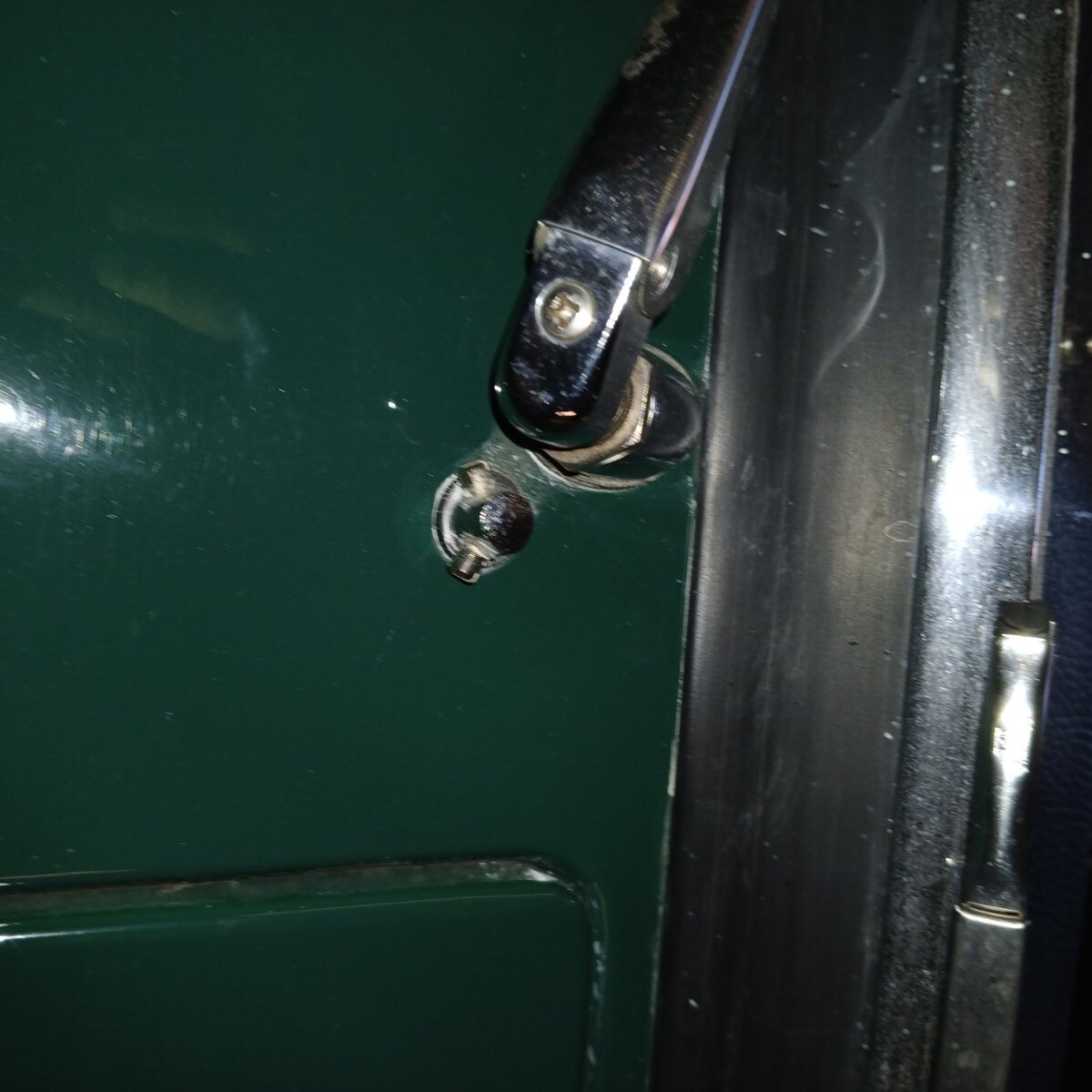

Ralph Whitaker Posted May 16, 2025 Report Posted May 16, 2025 They could be factory fitted, they are on the build sheet for my 3a which was supplied from the factory direct to Japan. Don`t know if it was a Japanese requirement, or at the request of the person who ordered the car who was presumably an American as he ordered left hand drive and dip to the right headlamps, and the car came back from America when I bought it. I still have the left hand drive dash panel, but the car had been comprehensively robbed of instruments and switchgear when I got it so I can only guess at where the washer switch went, there is another hole drilled in the dash panel at the side of where the O/D switch went, so presumably this was for the washer switch originally. I don`t even know whether they were electric or just a rubber bulb pump type, which is what I have fitted now. I moved my choke to the main dash panel so I didn`t have to disconnect it every time the centre panel is removed, and used the old choke hole to take my plunger type washer pump. One thing that puzzles me is why they fitted the washers so close to the wiper spindles, although they do squirt under the wiper arms and are quite effective. Again I don`t know if there was a standard place for them, or this was just the whim of the apprentice that was given the job of fitting them. Ralph PS, I am now getting the trouble others have had in that the site seems determined to rotate my pictures when I upload them, never happened before. Quote
Tony_C Posted May 16, 2025 Report Posted May 16, 2025 Yes, further to Ralph’s post above, my 3A was one of the last half dozen off the production line and came with ‘every possible extra’ including the screen washer - It’s situated furthest away from the driver near the glovebox. The dash is original apart from the toggle switch (indicators when I changed the wheel) and possibly the two white pull switches (spot lamps) under the rev counter, I acquired the car in the 70’s and they certainly appeared to have been in place for some time. The jet position would appear to be standard Ralph although, I’m not sure how well thought out it was? Welcome Gordon and well done with your choice of car, they are brilliant cars and great fun. - Let me know if you want any under bonnet photos of the original setup? Quote

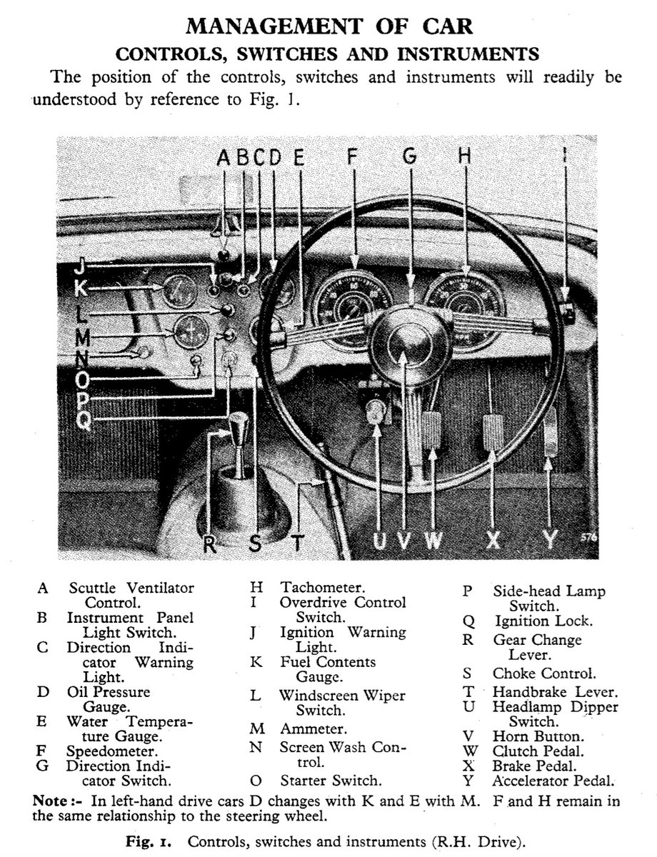

Deggers Posted May 16, 2025 Report Posted May 16, 2025 2 hours ago, Tony_C said: It’s situated furthest away from the driver near the glovebox. Yep, that looks about right Tony, as confirmed in this illustration from the 'Triumph Sports Car Instruction Book'. (see "N: Screen Wash Control") However if there isn't already an original push washer fitted and originality isn't a burning priority, I suppose really it comes down to personal preference. A previous owner of my 3A mounted one to the right of the steering wheel, and as I'm right handed, that's rather fortuitous . Incidentally, I happened to see this TR2 at an auction in Moretonhampstead yesterday, which also has the same arrangement. Cheers, Deggers Quote

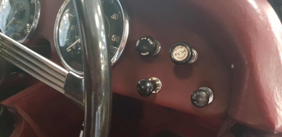

Ian Vincent Posted May 16, 2025 Report Posted May 16, 2025 FWIW, I fitted my manual washer pump on the RHS of the steering wheel directly below the heater control. Rgds Ian Quote

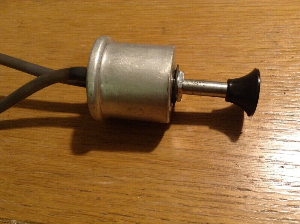

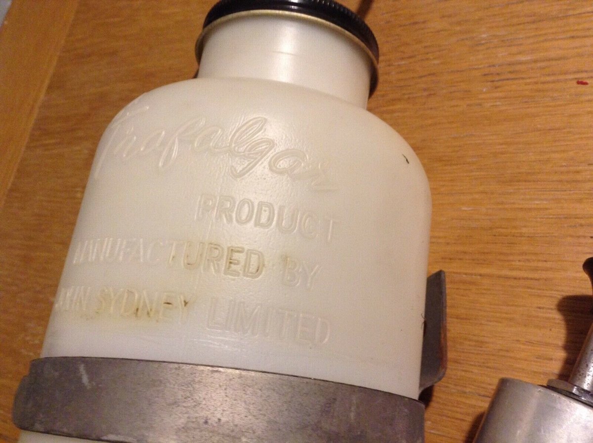

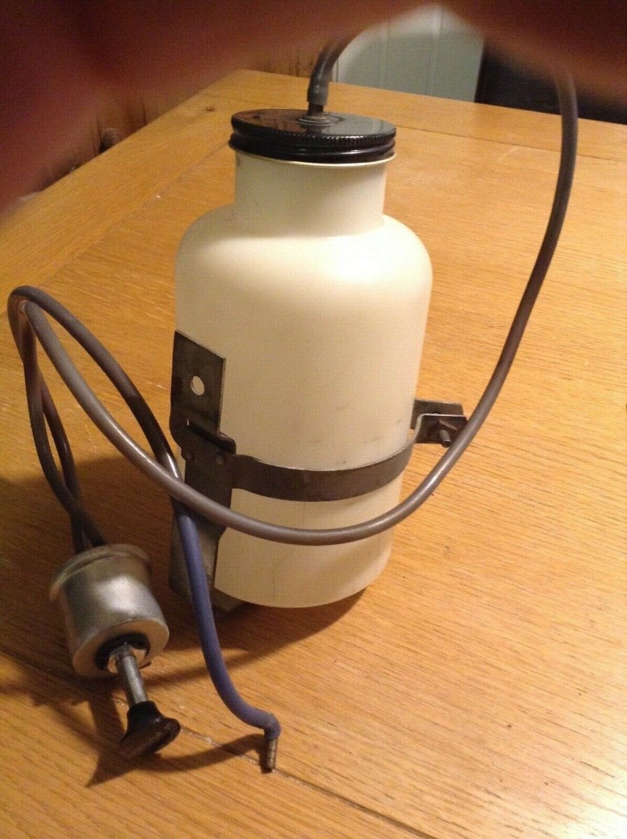

Black Forest TR3A Posted May 17, 2025 Report Posted May 17, 2025 There is some evidence that the "most original" washer pump was manufactured by Trafalgar and looked like this: (which I bought NOS some years ago): Quote
Lebro Posted May 17, 2025 Report Posted May 17, 2025 I'm using one of those bottles as my rad overflow bottle Bob Quote

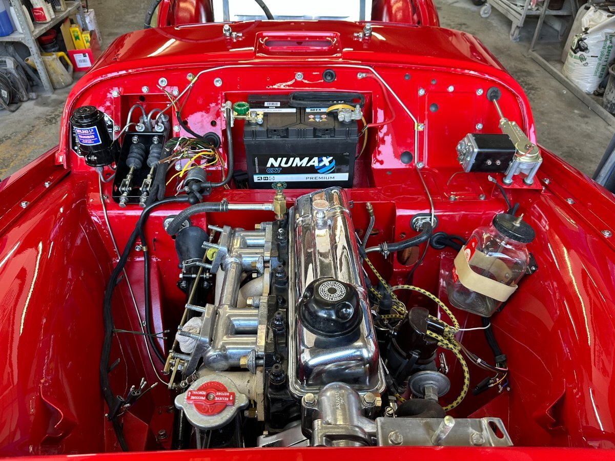

Nobbysr Posted May 20, 2025 Report Posted May 20, 2025 (edited) Have fitted a Trico glass bottle and support bracket which is year appropriate but I'd to purchase a knob and pump identical to Chritians unit. The pump i have is a Trico pump withe a black MGA knob cheers steve Edited May 20, 2025 by Nobbysr Quote
BlueTR3A-5EKT Posted May 21, 2025 Report Posted May 21, 2025 Nice view Steve. Why the pedal stop bolts though? I thought they were for Lockheed systems only. Pedal height being adjusted by the threaded Girling push rods. Quote

Nobbysr Posted June 1, 2025 Report Posted June 1, 2025 On 5/21/2025 at 9:53 AM, BlueTR3A-5EKT said: Nice view Steve. Why the pedal stop bolts though? I thought they were for Lockheed systems only. Pedal height being adjusted by the threaded Girling push rods. Hi Peter, the car had them fitted when i purchased it some 30yrs ago so I refitted them but I checked with a few Photos online as well, but to be honest i wasnt aware that they could be used without stops . I assumed that they were to stop the seals getting damaged by going too far in the cylinder ??? cheers Steve Quote
BlueTR3A-5EKT Posted June 1, 2025 Report Posted June 1, 2025 (edited) Hi Steve. The piston in a Girling master cylinder is retained by a circlip That is not the case with the earlier system. The circlip works as the stop for the piston and pedal height is set by the adjustable push rod. Edited June 1, 2025 by BlueTR3A-5EKT Quote
