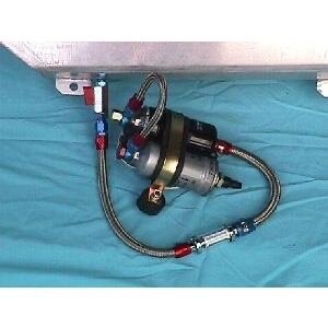

Chris Hale Posted May 21, 2025 Report Posted May 21, 2025 5 minutes ago, Rogcastle said: Looking at your clip it looks like your filter has been connected between the the Tank and the pump. This is incorrect as it should be connected after the pump Sorry Roger that is not correct The filter should be before the pump Above pic from Revington website and even better pic from Moss website https://www.moss-europe.co.uk/en-gb/fuel-induction/tanks-pumps-pipes/pi-bosch-fuel-pump-kit-tr5-6-tgk125--gp where you can see the high pressure hose coming off the pump to go to the PRV Quote
Waldi Posted May 21, 2025 Report Posted May 21, 2025 It is important to protect the pump against particles that could be sucked in from the tank. That’s what a suction filter does. A discharge filter would not harm (if the correct type is used and installed correctly), but not needed in my humble opinion. The Triumph engineers designed it like this. There is still a course nylon filter basket at: - the PRV inlet. - MU-inlet and - Injector inlets (if still present in your car). Waldi PS: My car cavitated because of a partially blocked tank-outlet, so if removing the plastic (redundant) filter does not solve it, that is worth checking. Quote

Chris Hale Posted May 22, 2025 Report Posted May 22, 2025 (edited) Bosch pumps don’t suck though that’s why they are mounted below the tank and the filter sits on top of the pump Edited May 22, 2025 by Chris Hale Quote
Chris Hale Posted May 22, 2025 Report Posted May 22, 2025 2 hours ago, Rogcastle said: Chris if you look carefully at the Remington picture you can clearly see the pipe going from the tank to the Pump and not the filter, Roger Below is an extract from Revington’s fitting instructions NOTE 5: Also consider hose RTR4048 from the pump kit to the Pressure Relief Valve (PRV) which helps to reduce resonance. Resonance is when the PRV fluctuates at a resonant frequency with the pulses generated by the fuel pump and an unpleasant droning noise is produced. This phenomenon is unlikely to occur with the original Lucas pump but is very likely when an axial (Bosch style) pump is fitted. A longer soft hose RTR4048 from the pump to the original PRV usually cures this (a stainless Steel braided hose will make it worse) but brings with it another bit of bad news. As modern fuels are much more volatile than older fuels they can permeate through rubber hose and create an unpleasant smell in the boot. If this is unacceptable there is a definitive solution to all this. We supply a modern PRV, part number RTR4456K which works on a different principle to the original type of PRV and does not resonate. The good news is that with PRV RTR4456K fitted, a Teflon lined Stainless Steel braided hose (either 215642SS or RTR4048-1) can be used from the pump to the PRV which will greatly reduce petrol smells in the boot. Advising which is in there opinion the best hose to run from the kit as supplied to to PRV therefore the pipe from the tank must be going to the filter first Quote

TR NIALL Posted May 22, 2025 Report Posted May 22, 2025 8 hours ago, Rogcastle said: Chris if you look carefully at the Remington picture you can clearly see the pipe going from the tank to the Pump and not the filter, Roger But they also have a small glass filter fitted between Tank and Pump I’ve used something similar (Glass not Plastic) but have drilled out the inlet/outlet to give it a better flow and I do agree the larger Filter is fitted after the Pump. Quote
stuart Posted May 22, 2025 Report Posted May 22, 2025 17 hours ago, Chris Hale said: Filter before a Bosch pump you don’t need one after it Absolutely, Big Sytec filter first. Stuart. Quote
trchris Posted May 22, 2025 Report Posted May 22, 2025 Agree filter pre pump but if you decide to fit one after then make sure it’s a high pressure filter as the one before doesn’t need to be Chris Quote
