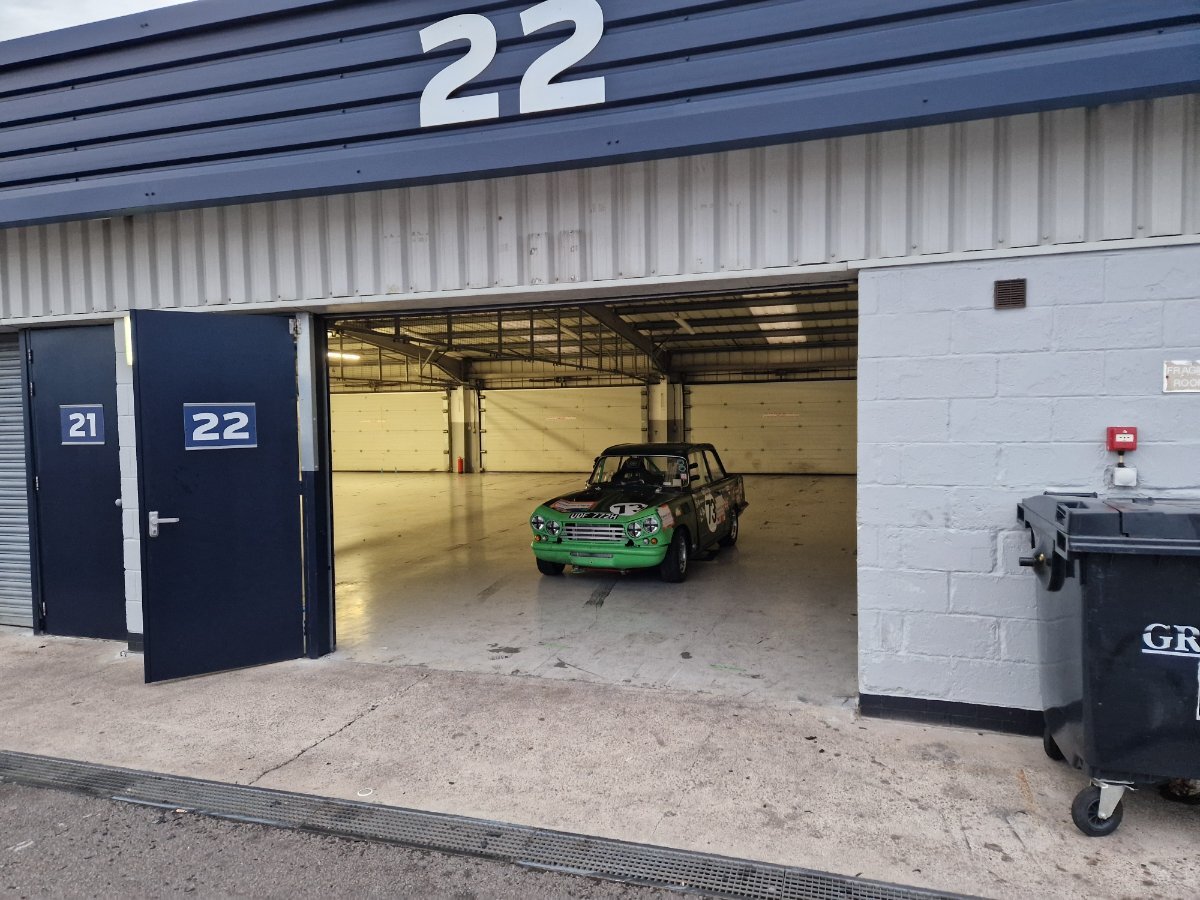

john.r.davies Posted June 13 Report Posted June 13 (edited) On 6/11/2025 at 9:41 PM, Dave McDonald said: Tom, we’ll be spectating at Silverstone this weekend. See you there? Hoping to have my 6 ready for Bailey to race at Snetterton 6th July. Dave McD You'll be welcome in Garage 22! The Swinging 60s have the pit lane garages this weekend! Edited June 13 by john.r.davies Quote

john.r.davies Posted June 15 Report Posted June 15 (edited) Please note the "HoneyBadger Racing" entry. Two lads, a Spitfire they rescued from twenty years in a barn, and all their own work, they are future of Triumph motorsport! John Edited June 15 by john.r.davies Quote
roy53 Posted June 15 Author Report Posted June 15 1 hour ago, john.r.davies said: Please note the "HoneyBadger Racing" entry. Two lads, a Spitfire they rescued from twenty years in a barn, and all their own work, they are future of Triumph motorsport! John My mistake John Roy Quote
