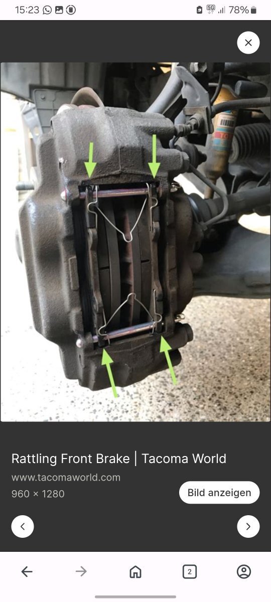

My mistake years ago:
to get Green Stuff pads in the calipers I had to remove paint with a file - and did to much.
The pads had radial play in the calipers, moved down (--> back) while driving and forward while braking with a clonk against the calipers.
The clonk was not while braking, mostly short before stopping and again slightly off the brake pedal.
To avoid this you could use a German (ATE) Speizfeder or any other spring to avoid them moving back.

My car had a dreadful clink and rattle from the front until I installed the anti rattle springs. Now no noise

With or without…?
It makes no difference with or without if they are too weak…
